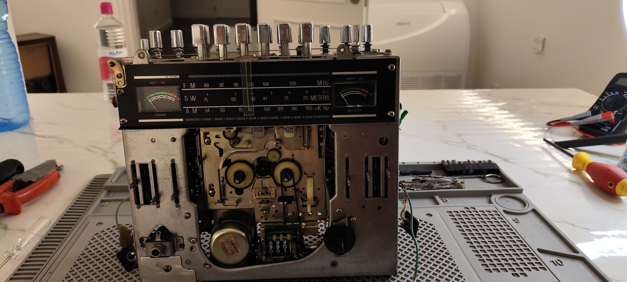

    Tape Section
    Playback:
    The mechanism uses a 2-head design (combined record/playback head and a separate electromagnetic erase head), delivering classic 1970s stereo cassette sound quality with clear and well-balanced output for its category.
    It also includes an auto-stop function, which automatically halts operation when the tape reaches its end.

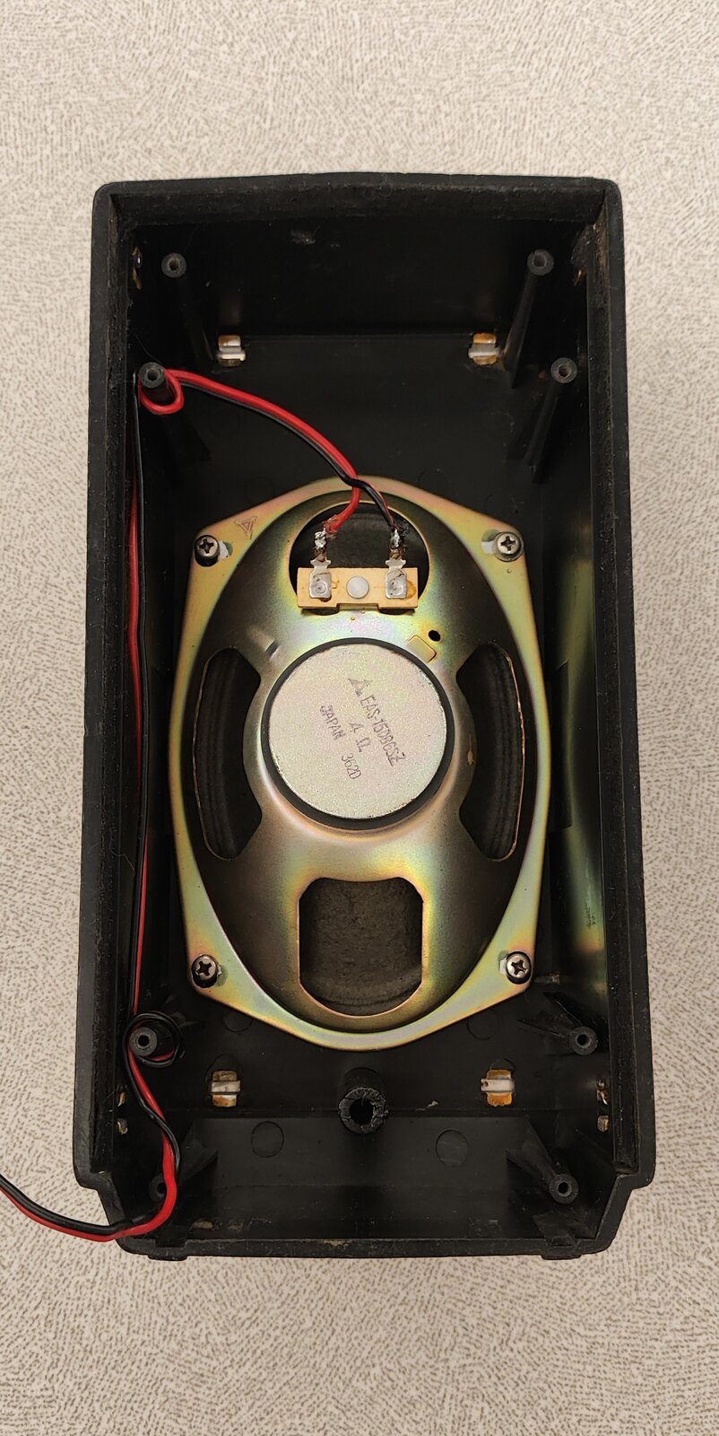

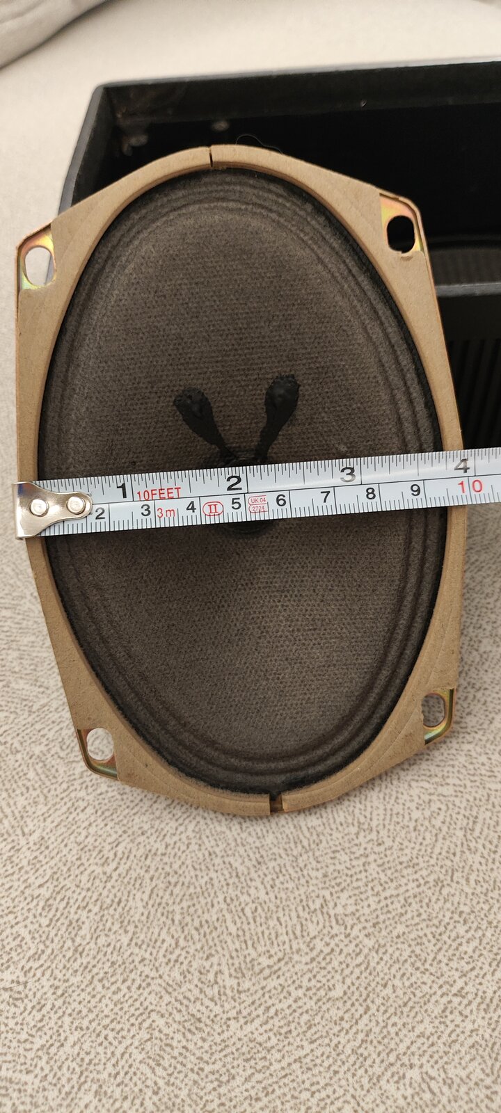

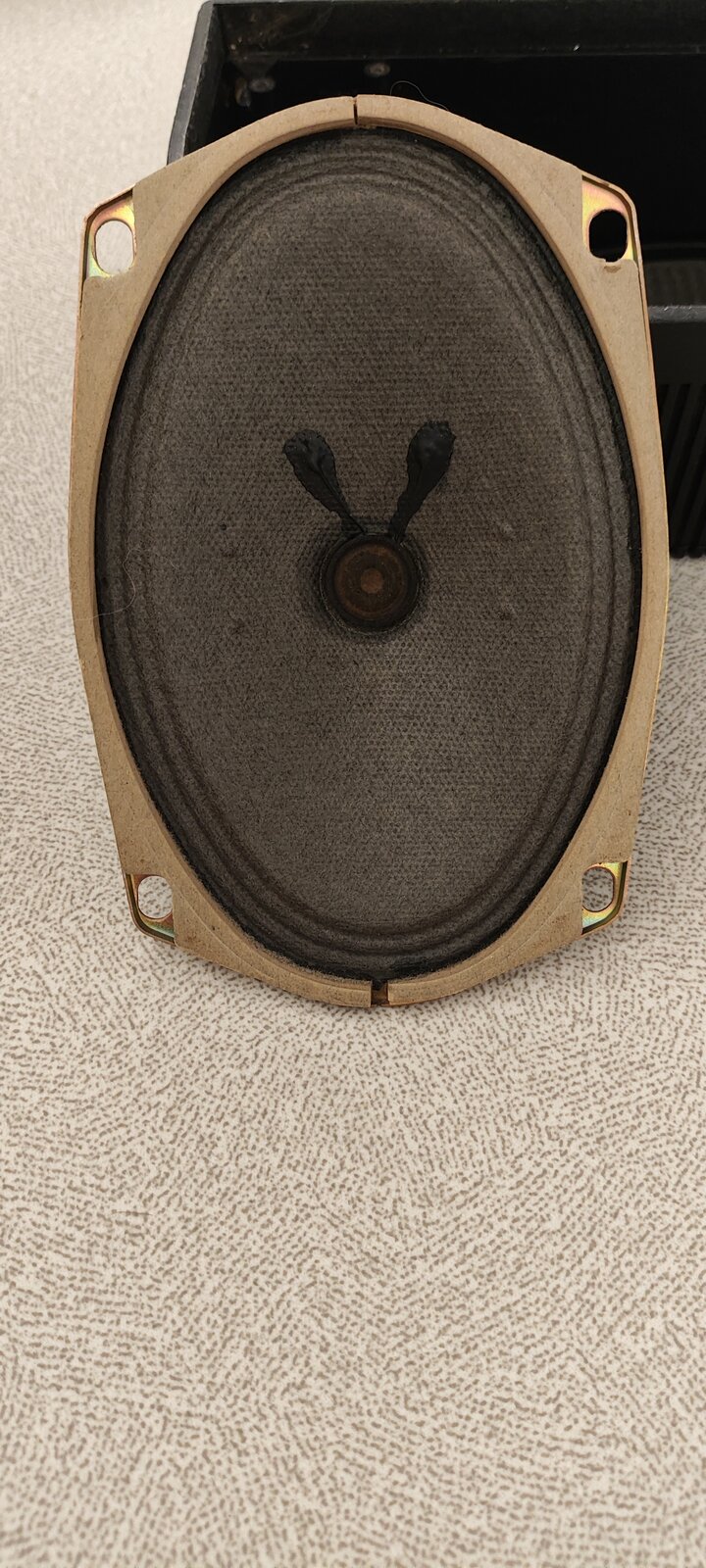

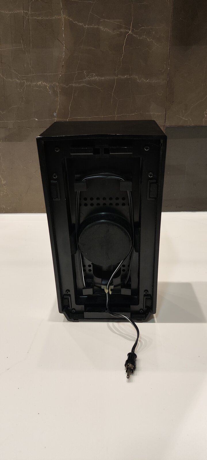

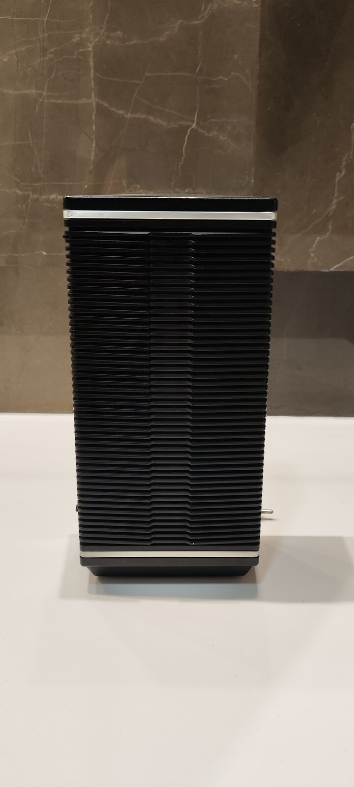

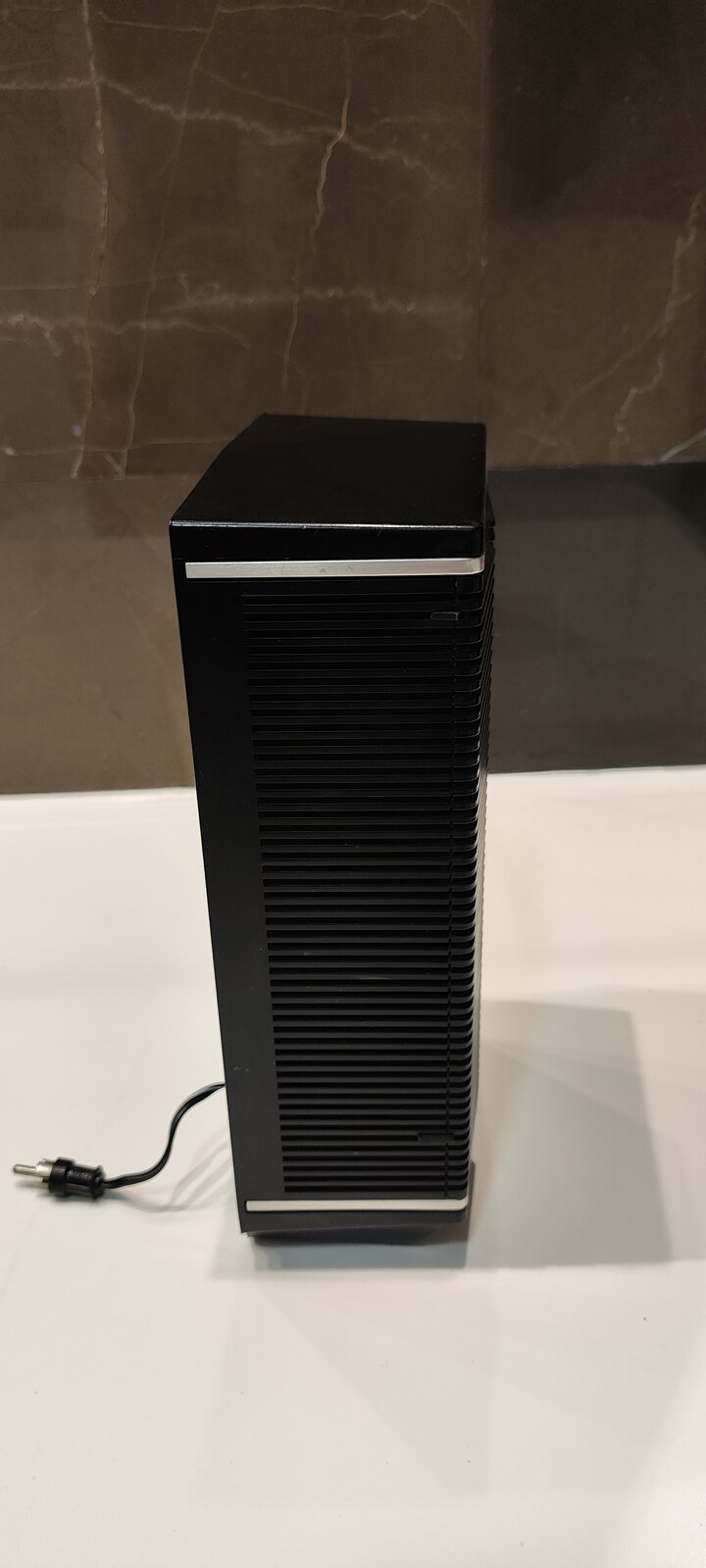

    Speakers:
    Two detachable speakers fitted with oval-shaped Matsushita Electric drivers (model EAS-15D86SZ), rated at 2.5 watts and 4 ohms, deliver good performance for indoor use.

    Speaker dimensions:
    – Height: 15 cm
    – Width: 10 cm

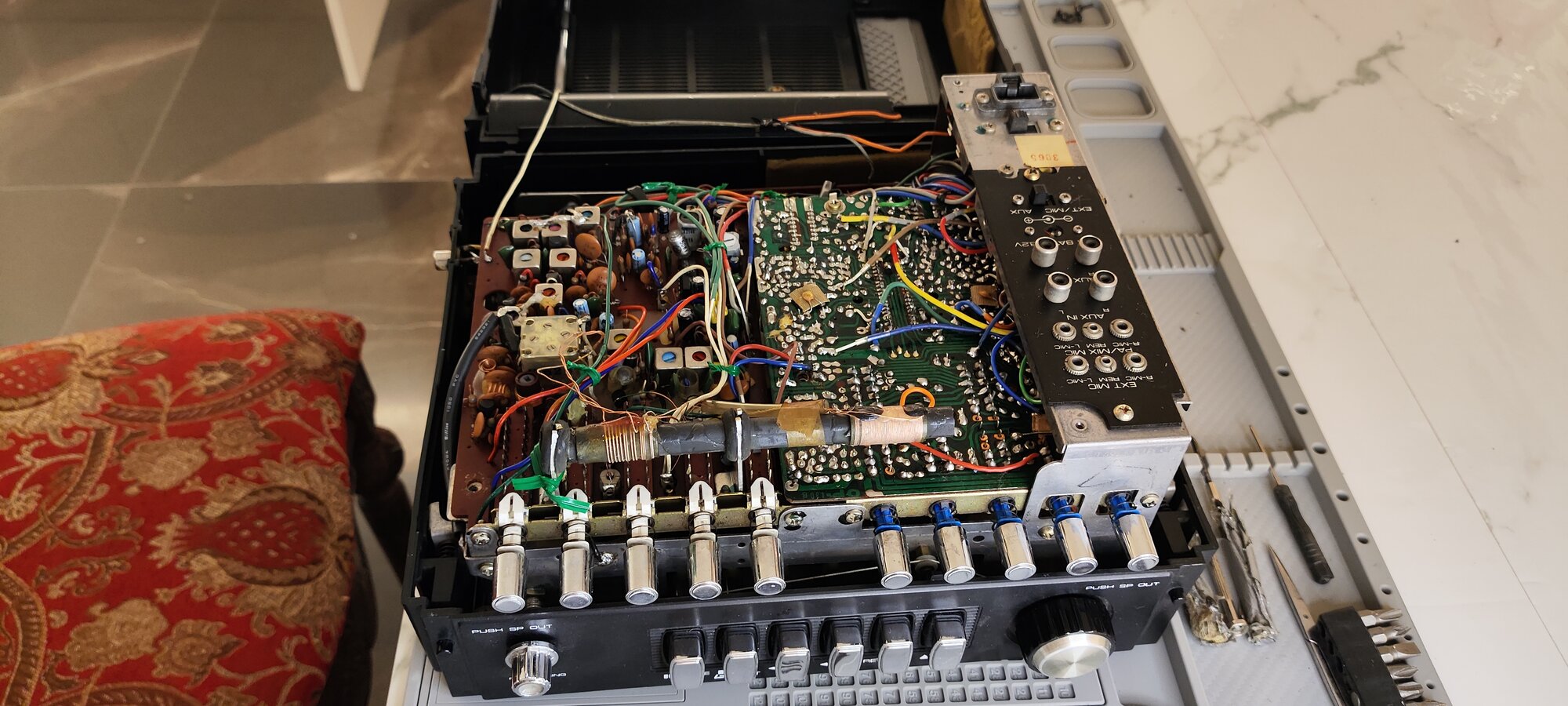

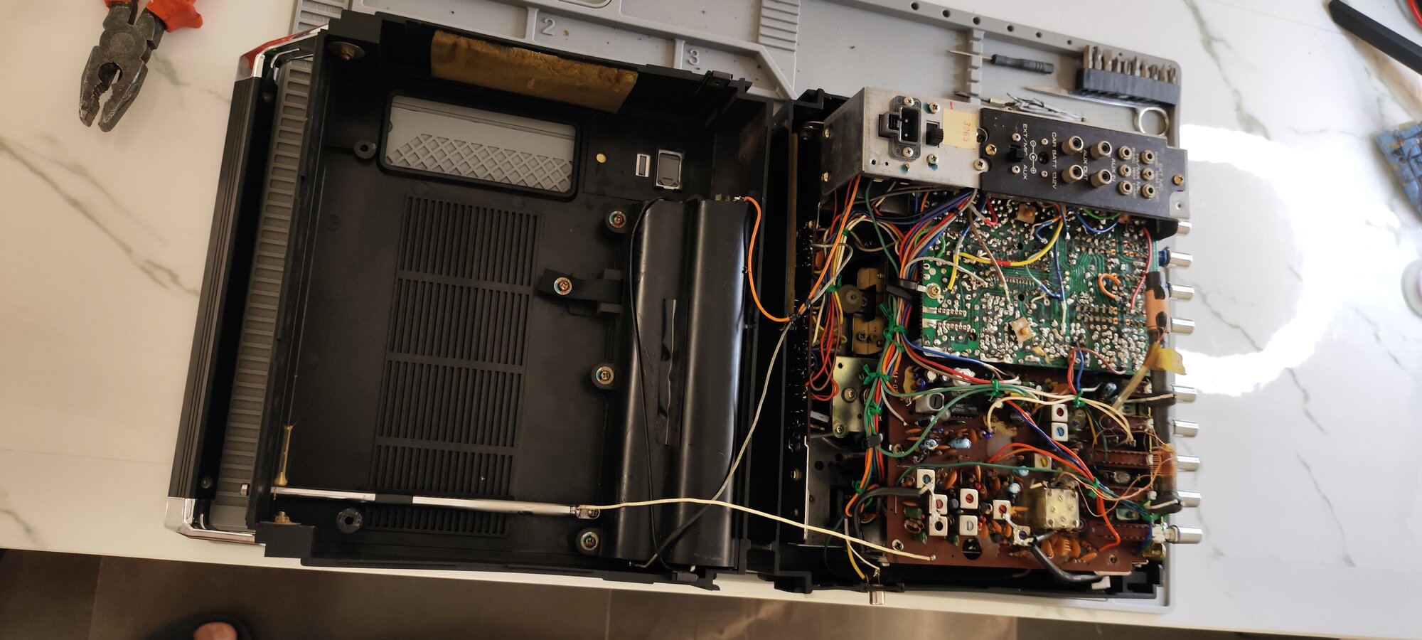

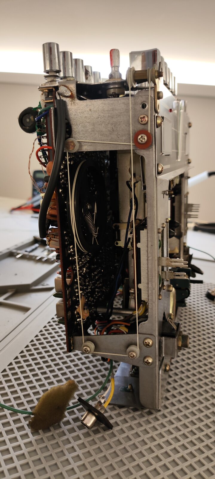

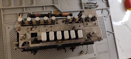

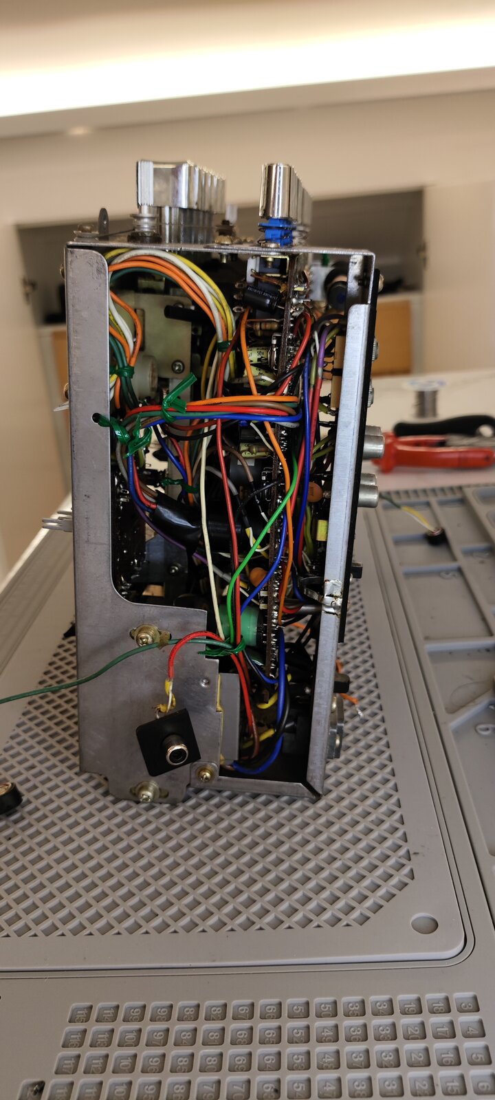

    Build Quality & Serviceability
    Internally built on a metallic chassis, the device has a solid and dense construction.
    While the design is durable, it is not service-friendly:
    Belt replacement requires significant disassembly.
    Early production units of the Orion P-ST appear to use OSCAR electrolytic capacitors, while later units are commonly found with Rubycon capacitors.
    Both brands are reputable Japanese manufacturers known for their reliability.
    Most units still operate well with their original capacitors, due to the high quality of components used at the time, contributing to long-term stability.
    Both the 9V
    motor (Orion NF925R01 60701-A) and the transformer are branded and marked as Orion components.
