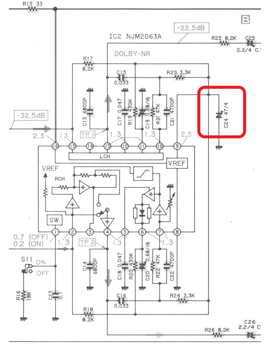

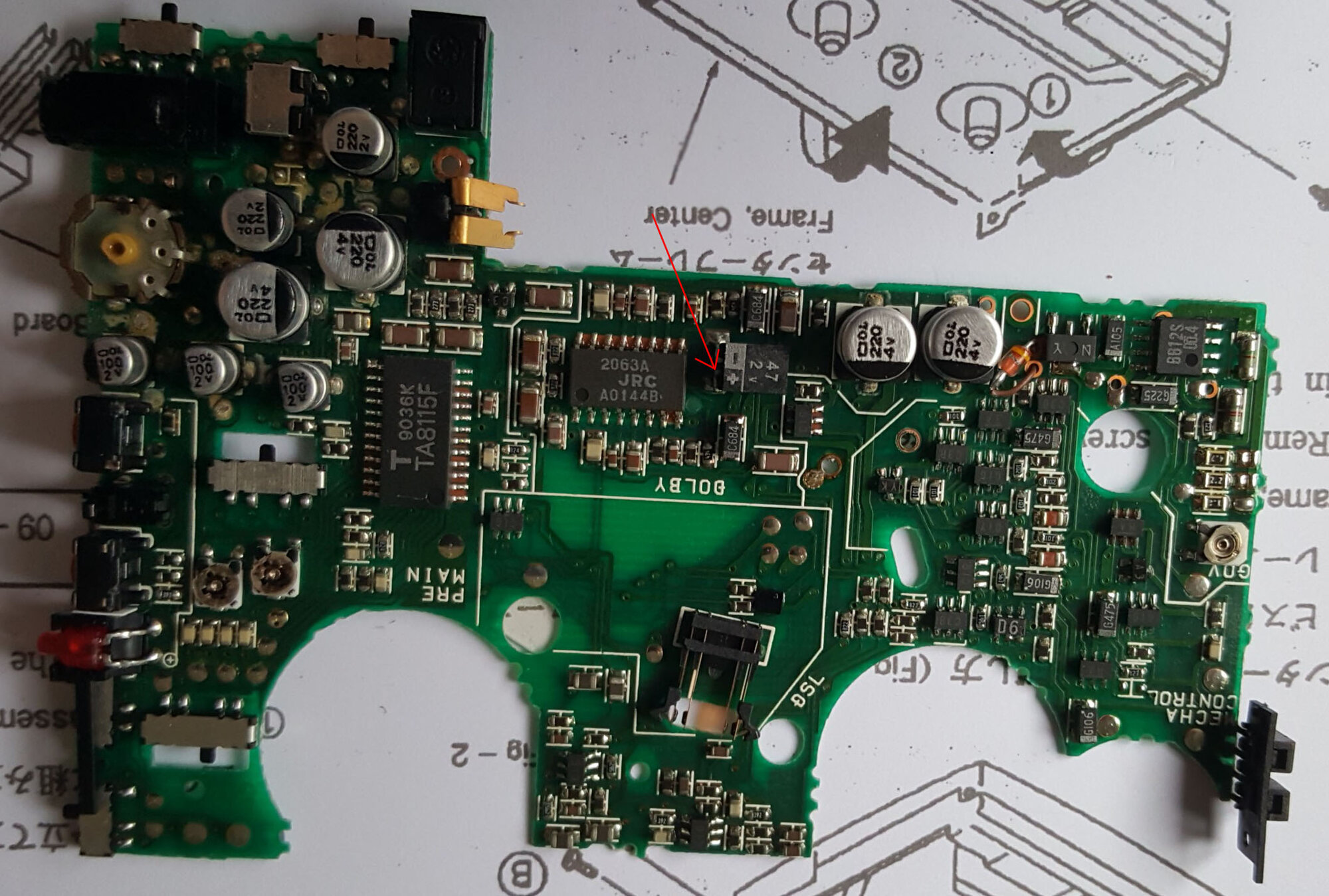

    What is likely to be causing this? I notice there is a square flat shaped capacitor 47 2v quite large next to the IC on the PC board marked as Dolby see red arrow on photograph. Would this need to be replaced perhaps?

    I would definetely replace that 47uF capacitor. That kind of surface mount capacitors tend to be leaky. I repaired a CASIO DA-7 DAT last year which is was full of capacitors like that and absolutely all of them were leaked on the board.
    The NJM2063A is the Dolby IC, so, in theory, it could be related. Try that first and if the problem persists make a recording of the sound and put a link here, because it's hard to visualize what you describe as loud continuous pitch sound.

    Not having the p505 scheme I rely on another aiwa .... In fact that capacitor controls the vref and could be the culprit
