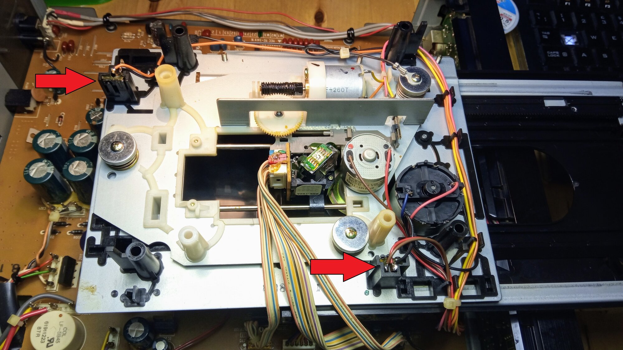

    Sorry to be a thread hijacker extraordinaire but while I have the attention of a few of you in regards to this player I'm having a tricky time rectifying the opening and immediately closing CD tray issue.
    I had wrongly assumed that it would be a single position sensor/sender as in 'most' CD players but then I should have realsied that Nakamichi don't do like 'most' other manufacturers and hence, on removing the top panel for a butcher's inside that the CD assembly uses 2 contact switches fore and aft, triggered by the tray stopping position at either end of the travel.

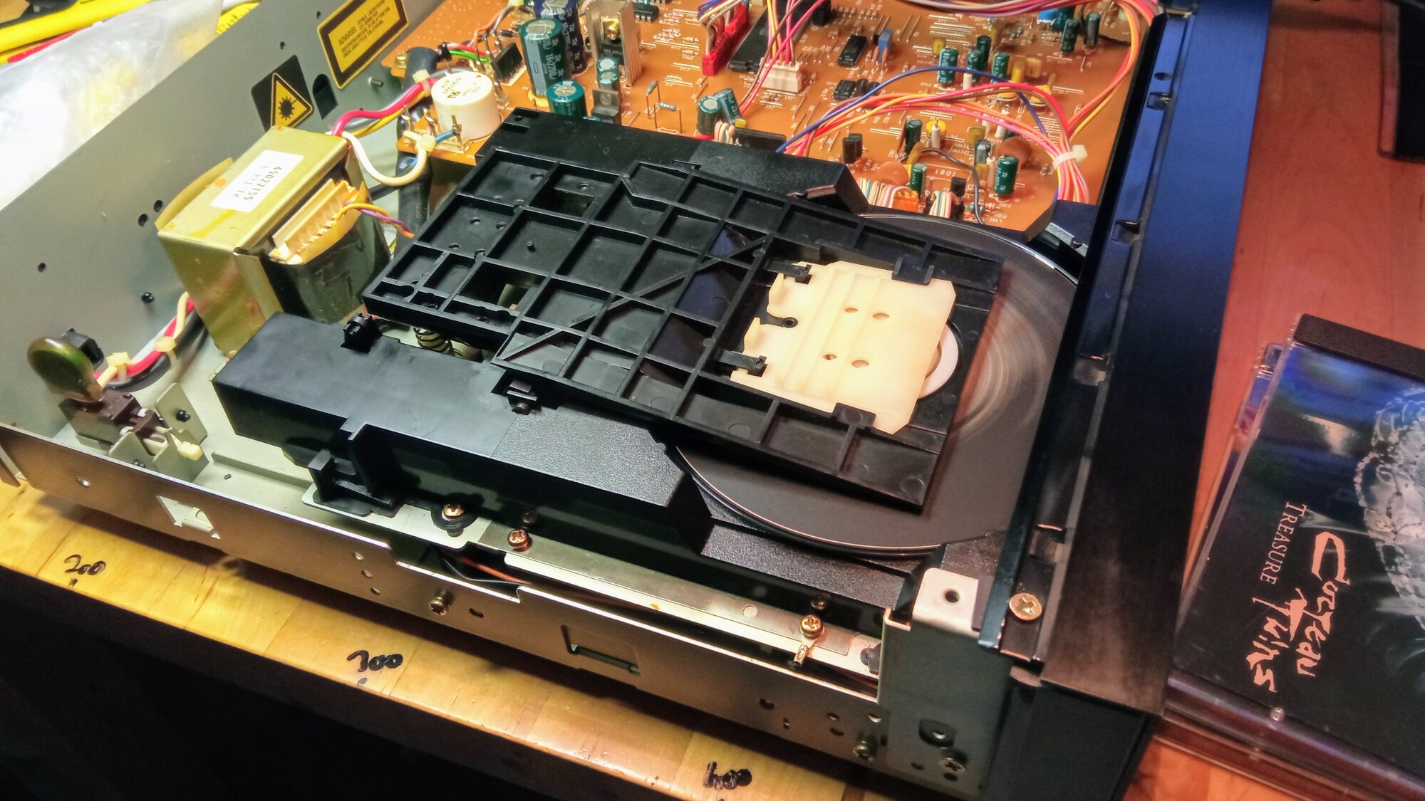

    The position sensor at the ejected position is obscured by the top of the tray assembly that looks like an absolute chew to remove. The manual talks about taping various parts in position before removal of other parts, presumably to maintain a datum position or such. What a faff.
    In any case, that's the sort of procedure I know I'll make a total ballsup of so I'm not going to attempt it just to clean the contacts...just to find out the problem will most probably be something totally different.
    Any ideas? Or do I just bite the bullet and go for the upper assembly removal?
    I suppose it's character building type stuff - diving into the unknown. God knows I've had to do that with various cars over the years so it won't be an entirely new experience.
    :ohno2:
    Alternatively, I could just learn to live with it and use Granville's technique with grabbing the change from Arkwrights cash register -I have about 2 seconds to either take a CD out or put one in. With concentration and dexterity I could possibly manage it. LOL
    :loldiag:
    Position sensors arrowed red

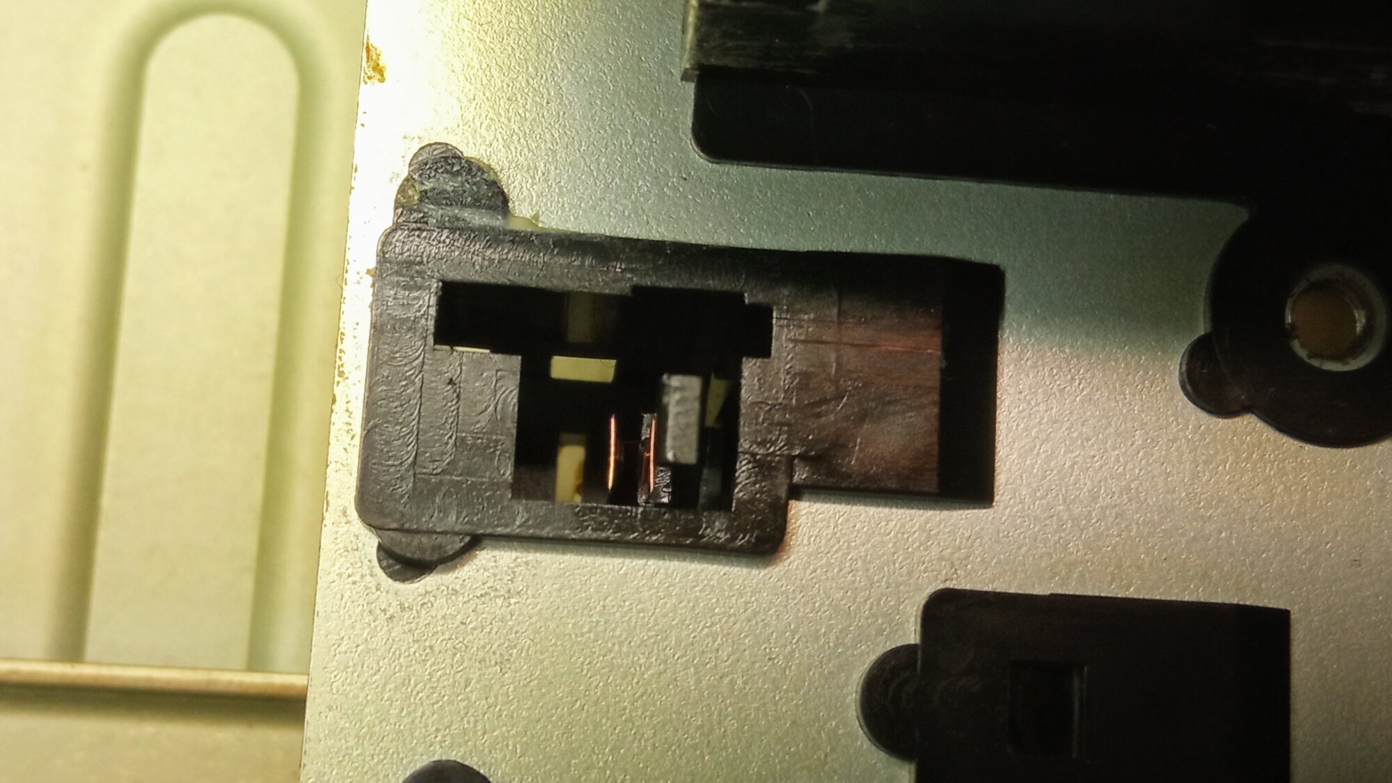

    Close up of the topside aft sensor
    Removing the top of the tray assembly. Yay or nay?

    That is an awkward design. I had the problem you describe with a Denon drawer loading cassette deck, and the position sensing switch contacts were easily accessible on the side of the mechanism. It took longer to take the lid off than to clean them and restore normal operation.
    In your case have you tried a quality contact cleaner like Electrolube or Deoxit? They usually come with long tubes to reach hard to get at places. Looking at your photos you might want to position the deck upside down or on its side so it drips into the contacts rather than onto other parts.

    Thanks for the suggestion. However I would need to get to the top-side of the forward sensor to clean the switch contact surfaces effectively. Squirting from underneath won't be effective and it's not ideal anyway.
    It's not even possible to use a long straw to squirt in contact cleaner as it is totally obscured by the black plastic tray.
    I use Kontakt PRF 6-68 and 7-78 usually.
    I will live with the issue for now and maybe I'll eventually get around to addressing it.
    I noticed when cleaning the case with IPA that there was tar stains on the cloth afterwards but the unit doesn't have that usual smoker's stench. It's actually not even an unpleasant odour that's been left behind so I'm assuming the previous owner was burning joss sticks or something. Idk what the oil/tar content of those things is but they definitely left a light residue over everything and I presume this is what may be casuing the tray issue.

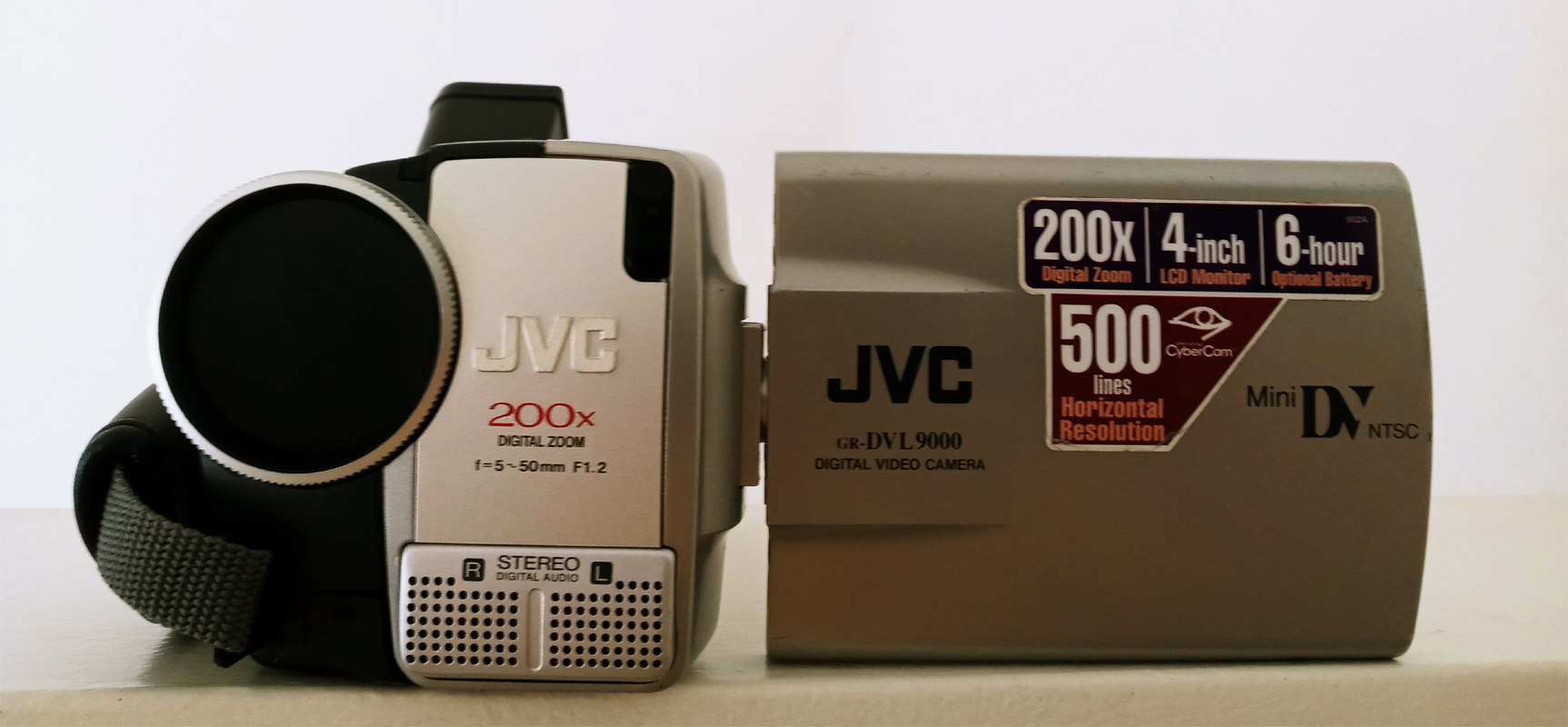

    Finally, I made a video about the JVC GD-DVL9000. :)
