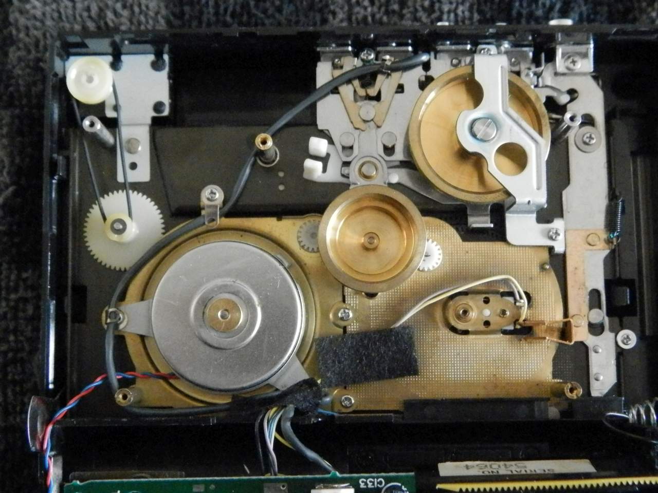

    edit: so i dove into the depths and found a video on YT from some Japanese guy fixing the WA-2000...in his video he also showed the WA-2001 and waddayaknow the boards of the 2000 and 2001 are identical. So did a search on 2001 and there is a service manual on elektrotanya of the WA-2001! Yes! With the WA-4000 i also got a WA-2000 but this is only giving me static on both radio and tape....can faintly hear tape playing but now i can take some measurements.....

    Build quality of the WA2000 is like in WM-B10, B12 etc...plastic frame mounted on the pcb and clamped between the plastic housing, mech is also plastic, plastic hubs and flywheels....so budget model...also was cheering to soon, WA2001 has different chip set then WA2000. Boards look identical but are electrically different.

    Check the inside of the WA-4000....1986 quality build...brass baby, brass
