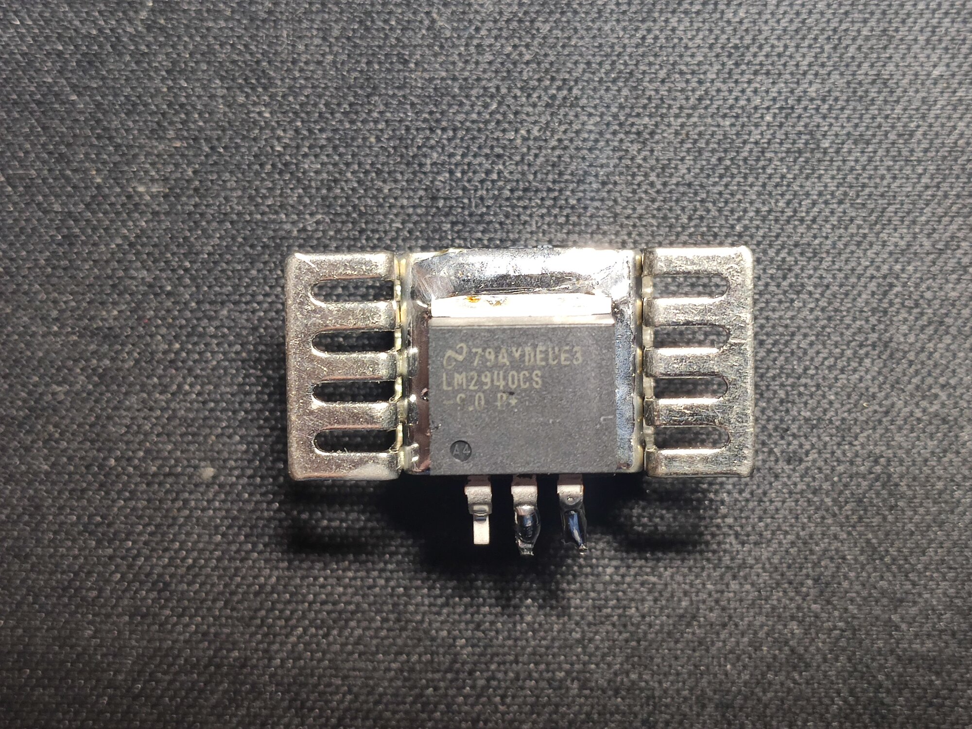

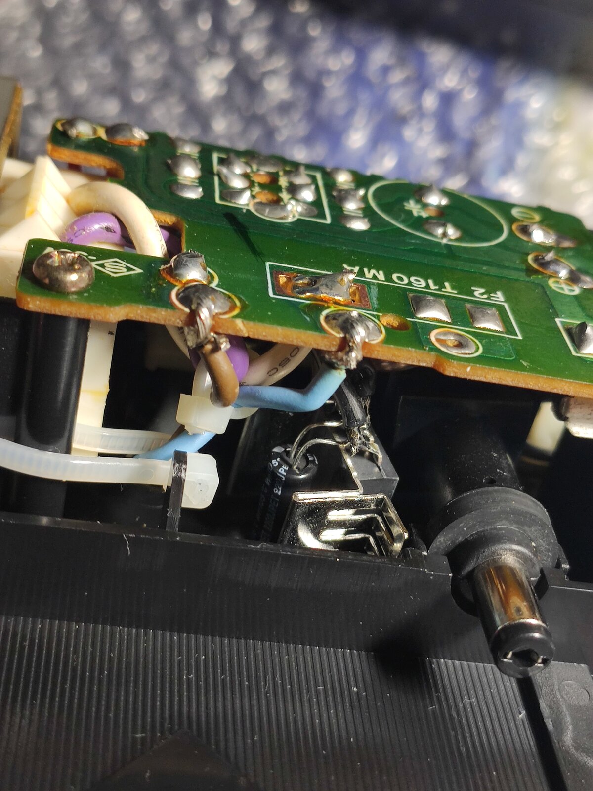

    The mod is very simple requiring only 3 components: a voltage regulator, a heatsink and a capacitor.
    The regulator I chose is LM2940-9 because it has a dropout of only 500mV at the maximum current of 1A.
    So even if the situation where the mains voltage goes down, the regulator will still be able to regulate, as at 400mA (which is close to the operating current of 440mA) the dropout is only ~220mV.

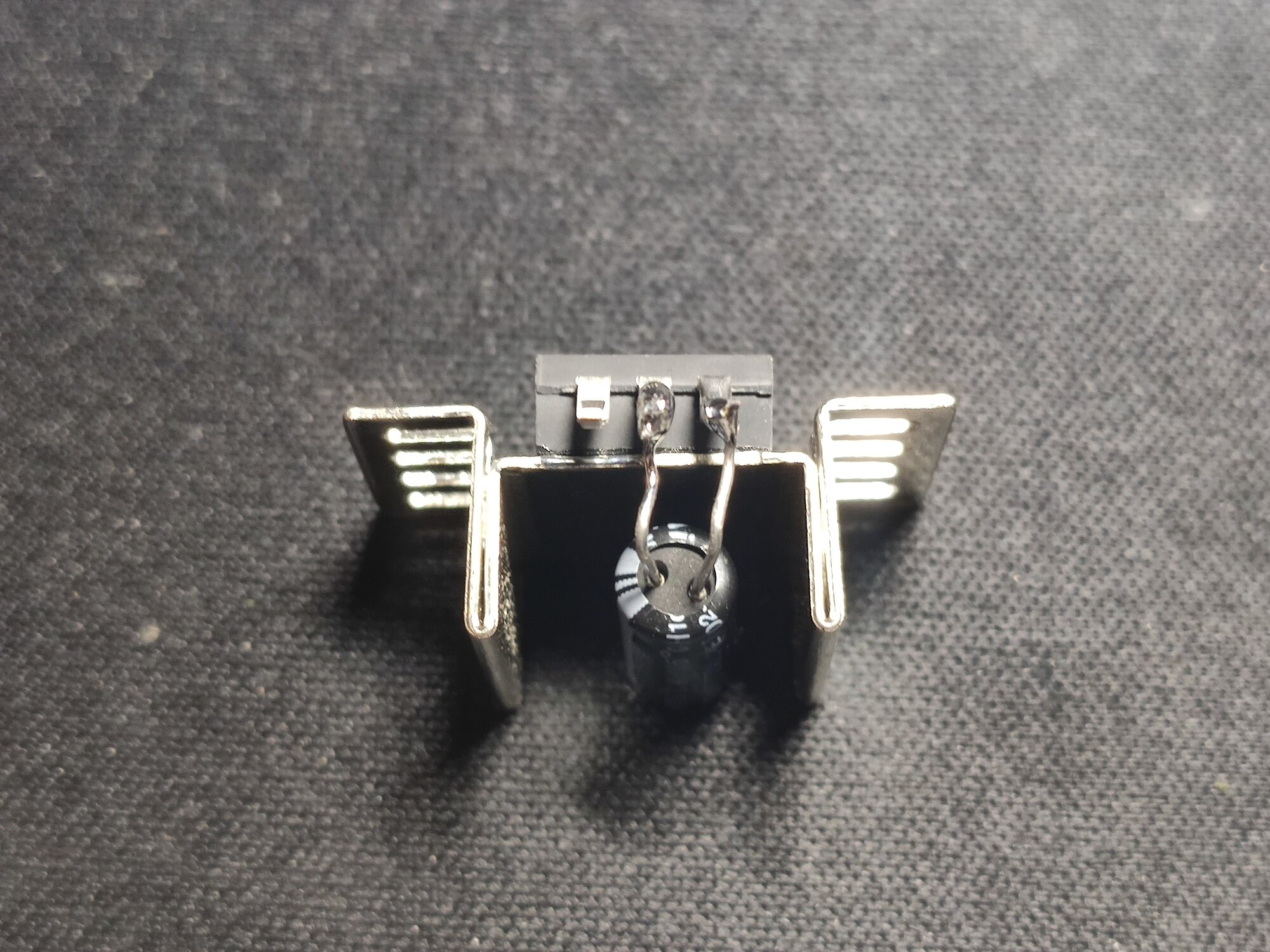

    NOTE: This regulator requires an output capacitor of at least 22μF for stability.
    Despite the device already has a 330μF inside in parallel with the input, you still need the 22μF one as the internal one is too far away from the regulator connected with wires/traces that have parasitic inductance.
    NOTE2: The popular LM7809 will not work as it will require a minimum voltage drop of 2V, so even in a best case scenario there is not enough input voltage under load to make it work.
    Heatsink I used is ATS-PCB1073, which despite not very large maintains the regulator at a reasonable temperature (well within the datasheet spec).
    I recommend doing this mod on your D-50 supply or AC930A for peace of mind. I did it on my 2 x AC930A as well that I use on my D-150 and D-250 Discmans so I don't worry anymore about leaving them plugged in.
