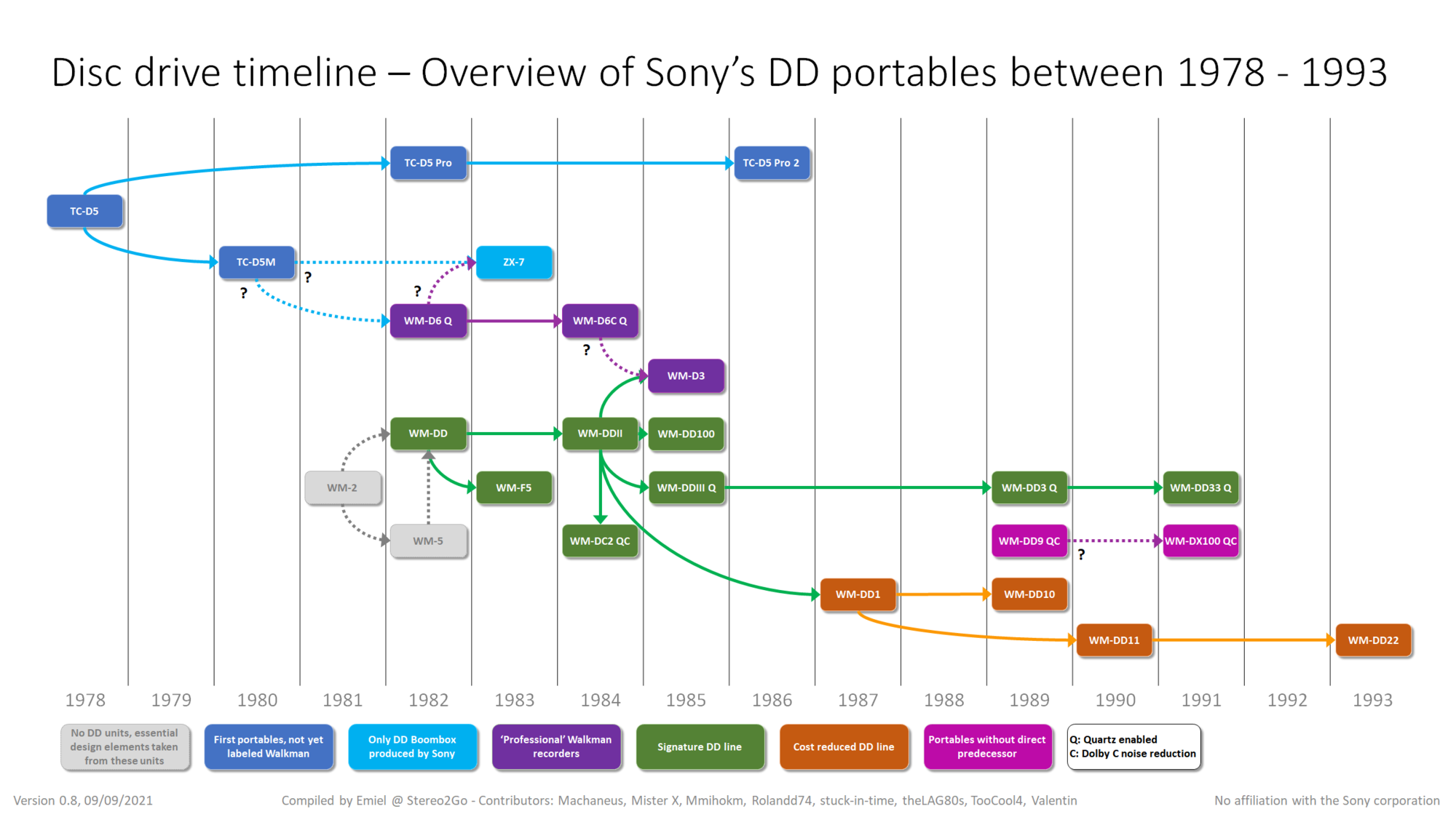

    There is another unit that can be included in gray (essential design elements taken from these units). A unit that I have completely disassembled for repair and I also happen to have in my collection: the SONY TC-150.
    Mechanism of this unit is extremely similar to the one used in the TC-D5/D5M/D5Pro and judging by the construction the TC-150 seems to be older than the D5. The only major change that was done to the mechanism is the disc drive system.
    Same thing with the D6/D6C, where the mechanism is almost identical to the TPS-L2/WM-3, to which a DD system has been added. The TPS-L2 mech comes from the older TCM-600.
    Another thing that comes to mind about the WM-DD1/DD10/DD11, is these cost reduced units do not use a center gear type mechanism anymore, but a much more simpler belt system. This info could be added in the small orange rectangle at the bottom.

    Excellent update @Valentin, I will add notes to the relevant devices in the overview table too.
    I will post new versions of both files during the weekend.

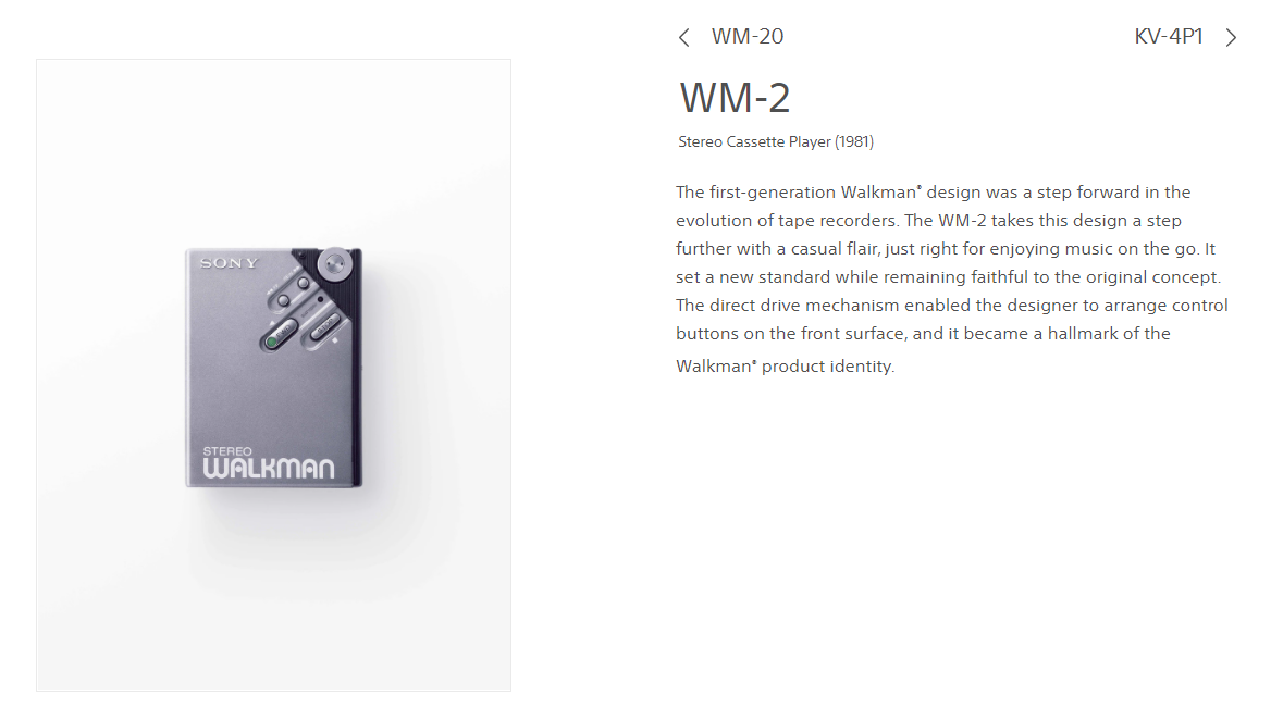

    I know that, and did look up the mechanism in the service manual.
    The words Sony chose to describe the WM-2 are, well, a bit peculiar.
    I was referring to the exterior design from the WM-DD when I listed WM2 -> WM-5.

    The WM-2 is the only one that has a much thicker center gear that does not break, unlike the other center gear type mechanisms;

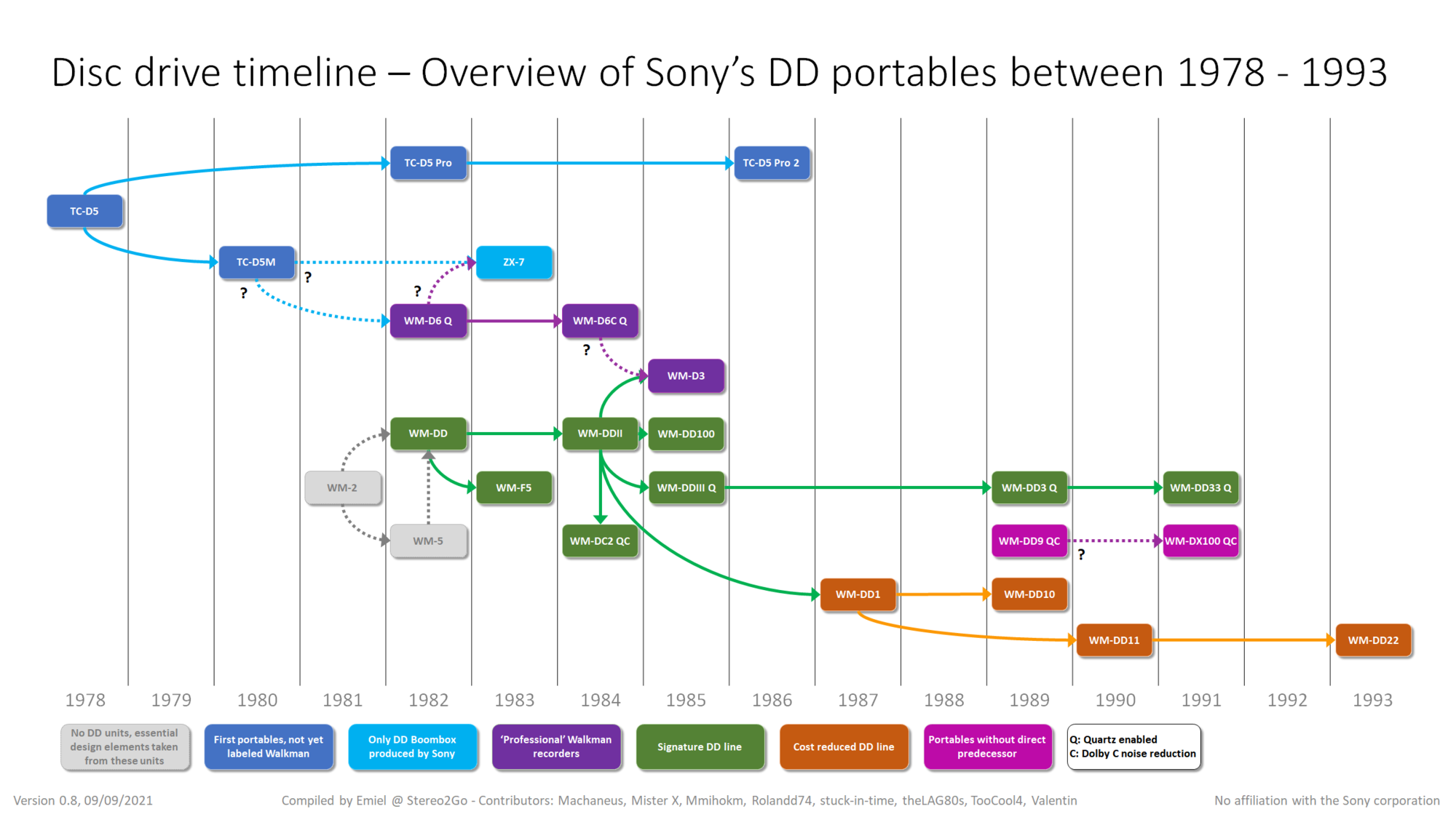

    Beautiful time map, Emiel!
    One thing I would change is the position of the DD10 - for me it's located between DD1 and DD11. If this was already mentioned here, I'm sorry for not reading everything by now.
    Great work!!!
  12. Emiel
    1,115
    Thanks for reviewing the files and providing feedback, really appreciated!
    The reason why I drew the line from DD1 to DD11 is the following reference from the service manual:
    Model name using similar mechanism WM-DD1 (not WM-DD10).
    However, upon closer examination of the DD11 PCB it seems that the optimized PCB was used as base for DD11:
    capacitor moved away from motor connections, reduced number of test pads - as reported by @Machaneus in the DD1-DD10 thread.
    I'll therefor change the timeline and table accordingly.
    The DD1 actually is a complete new PCB with less components than WM-DDII, and it is also using a new mechanism. The relation to the WM-DD(II/III) is not quite clear to me at the moment.
    Thanks again, keep posting!
