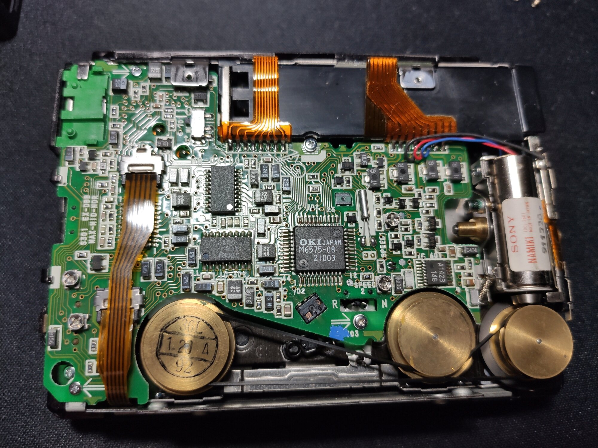

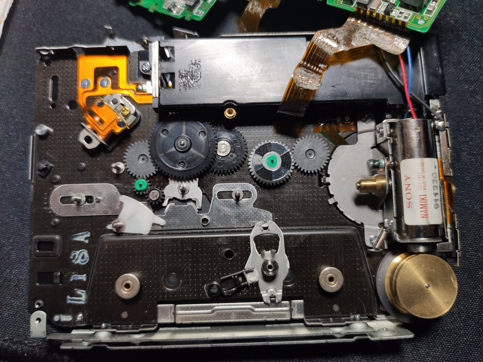

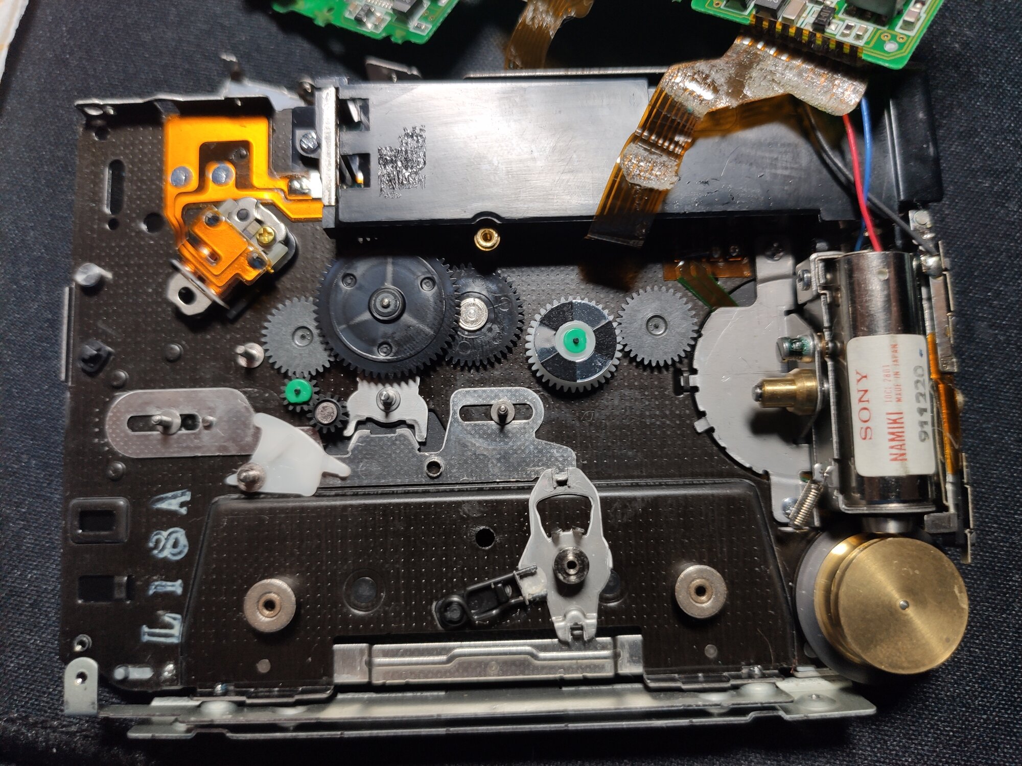

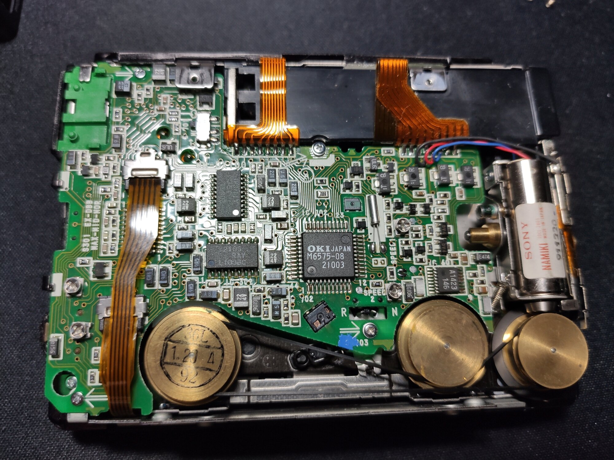

    The mechanism features the DD system: the disc driven brass rotor (bottom right) is driving a belt that takes care of the rest of the mechanism.
    It seems a bit complex and appears to have only been used by Sony for DX100, and perhaps the WM-EX99R.

  9. Valentin
    1,699
    Given how this device is constructed, I won't consider it a DD unit, although a DD system is used, but not for driving the capstan directly. Capstan flywheels are belt driven, hence I consider this to be a belt driven unit.
    My observations when I repaired this devices were:
    1. The motor is very small compared to the typical MNF1600B; given how small it is (this was done to make the device very slim overall), an FG coil could not be fitted inside the motor, as it was the case with MNF1600B;
    2. The FG coil is underneath the brass disc (a flex cable going to it can be seen in the pictures); newer walkmans would abandon this system in favour of a 3 phase brushless motor (which is simpler and also more cost effective);
    I have only 2 more relevant ones, besides the one you already posted. In the one above, the only things missing are one of the flywheels and the belt.
