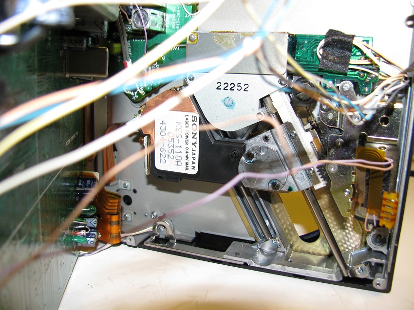

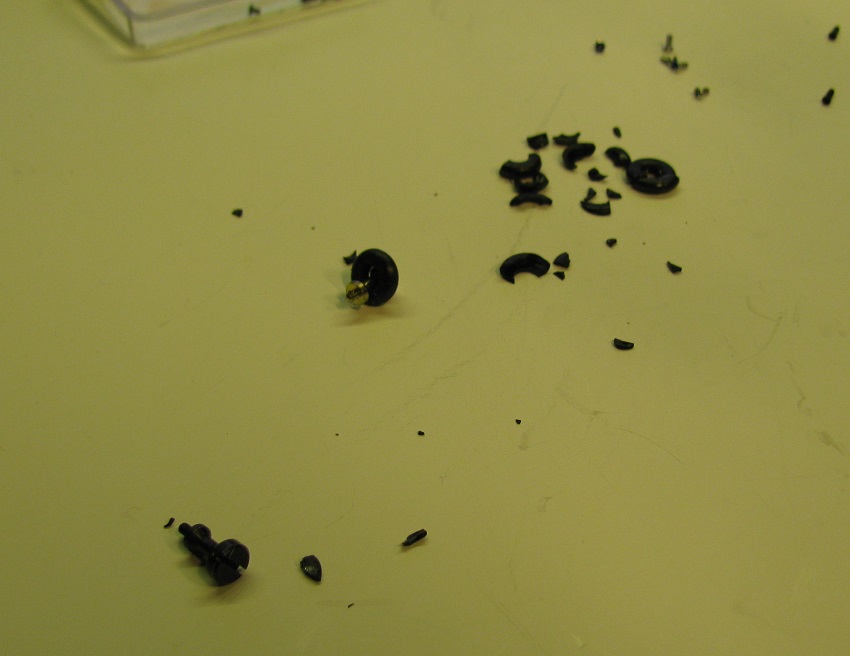

    BTW, mine also came faulty :( - it started but almost immediately stopped, couldn't read tracks,
    and my first thought was that the laser was dead. Bummer!
    Those KSS-110A transports are very hard to come by nowdays.
    But I was luck to find a good tech who agreed to take a look, he never saw inside namely D-50
    and was simply interested.
    And.. Hurray! Laser was alive and quite strong,
    hmm, they call D-50 a "Tank" but even tanks in 35 years
    may require TLC and some repair. :)

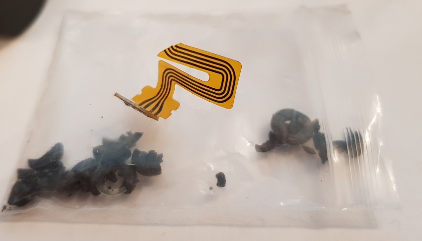

    What it was - please see pics -
    - transport rubber dampers simply fell apart.
    And more importantly one of short flat cables just broke with age -
    the tech simply placed 4 wires instead.
    Otherwise all insides are sound and shall we say shiny. :)

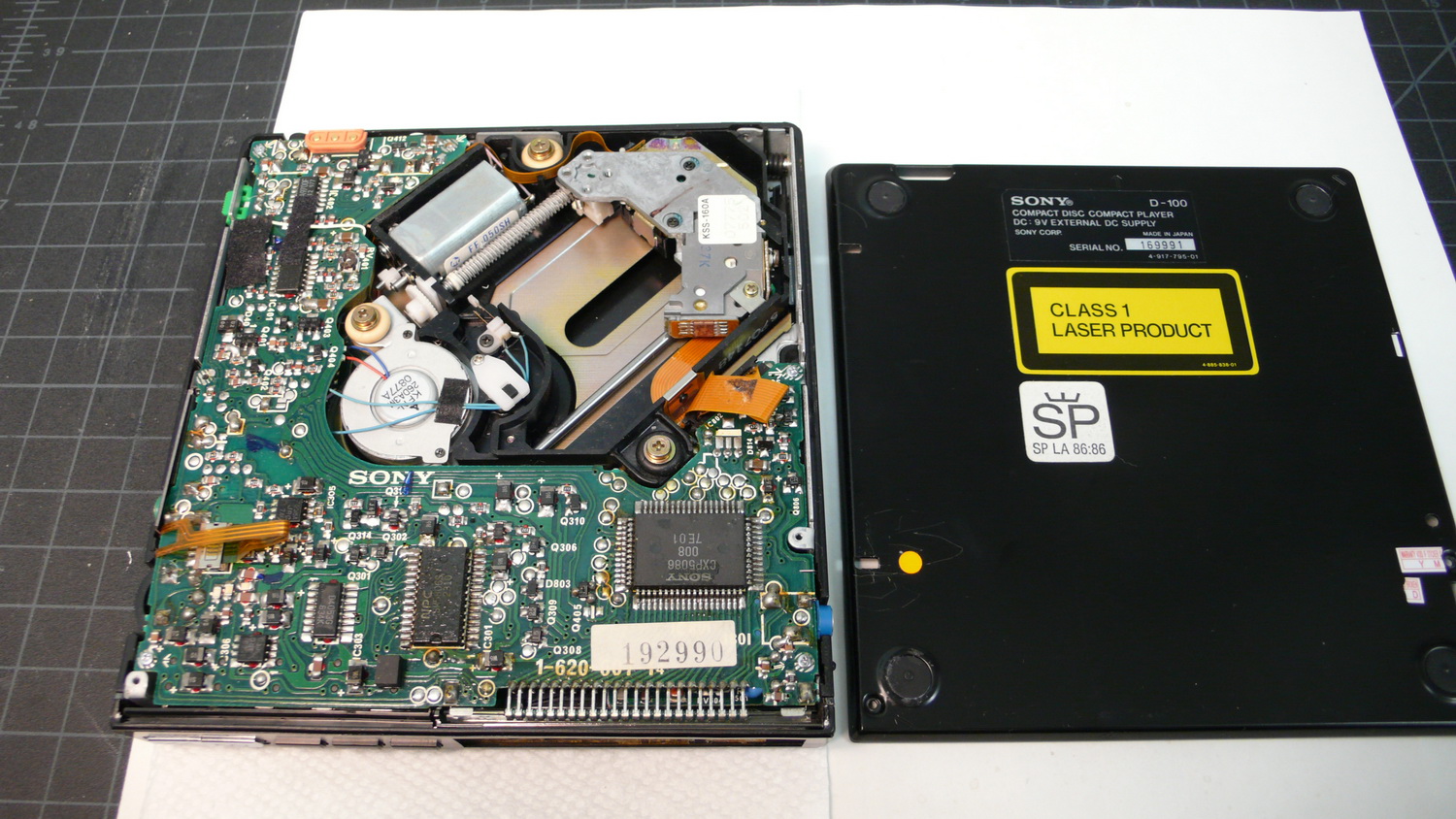

    Hi Mystic Traveller. So glad you were able to get that beauty repaired. So many people seem to say the laser is dead but quite often it just requires other mechanical parts to be looked at a d rubbers of course. In all myunits the lasers are perfect. Is the D-5(50's)headphone out 30mw the same as the D-100?. My D-100 spins up but doesn't read the disc. Could be a simple fix or something more serious. A fellow member did send me some photos of the internals but unfortunately I have forgotten his name and somehow deleted the photos. Anyway congratulations on getting that beauty sorted out a d I hope you enjoy it. Another classic saved from the scrap heap. Regards, Derek.

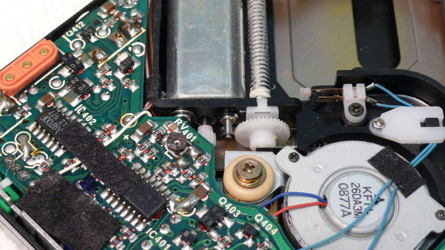

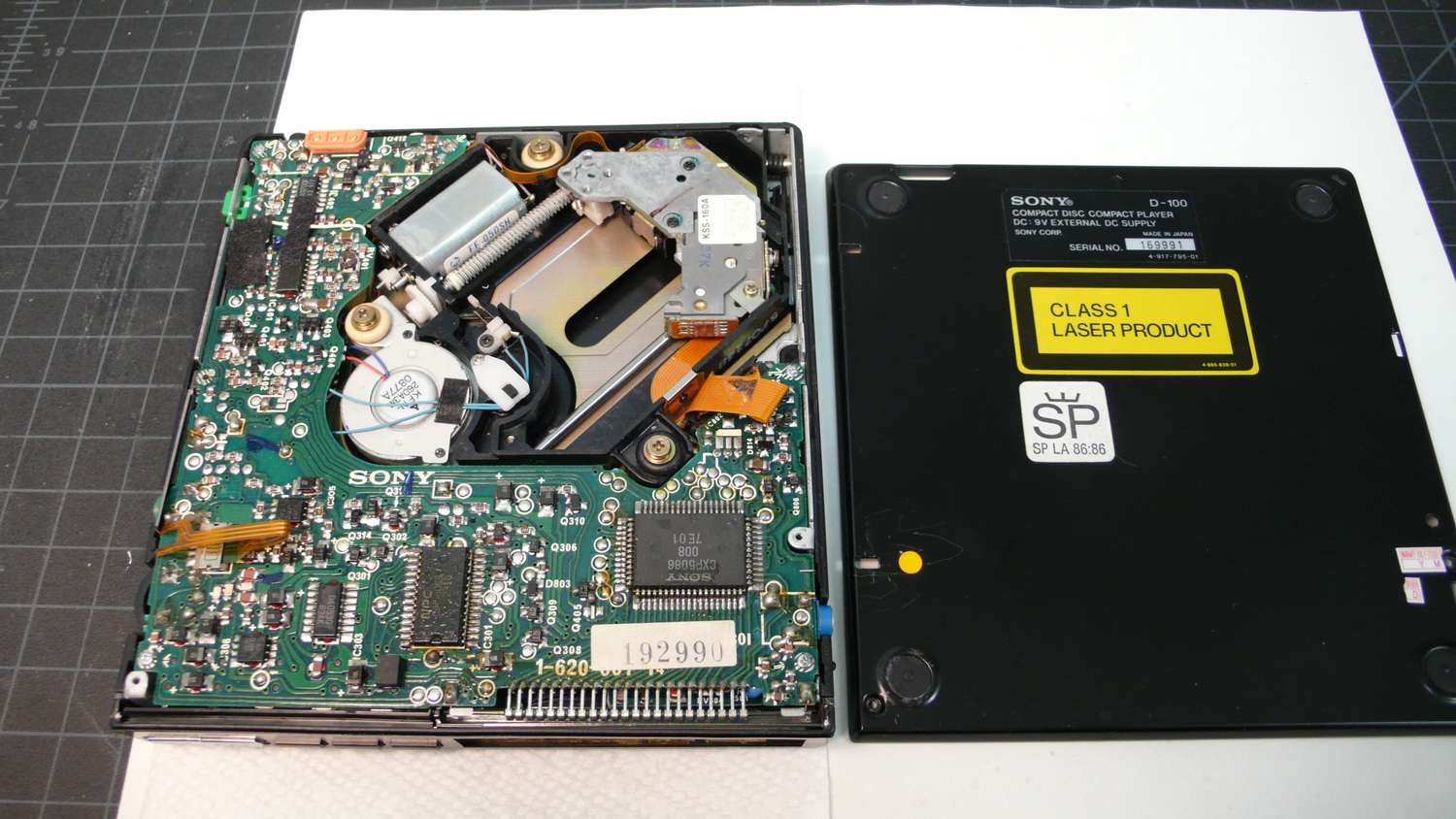

  15. Jorge
    1,794
    two photos of D-100 with bottom plate removed:
    You can see that the infamous "middle gear" (connecting motor and sled worm) crumbled into small pieces and disappeared. This would be the first thing to check, new gear for D-10/D-100 available off eBay.
    According to "Master Gu" (kaosuncd.com), D-100 is the best-sounding Discman ever.

    Hi Jorge. Thanks for sending the photos. I don't know how I managed to delete them. Thanks again, Derek.
