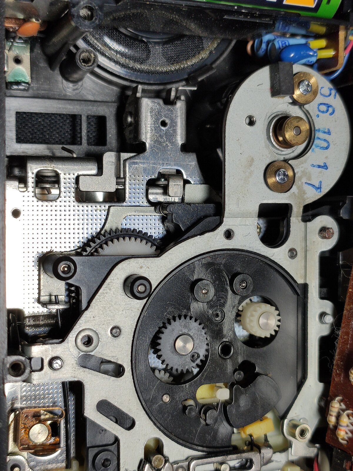

    1. You need to remove the outer casing. The metal part of the casing slides out towards the play/rec buttons after screws are removed;
    2. Remove the plastic part near the jacks;

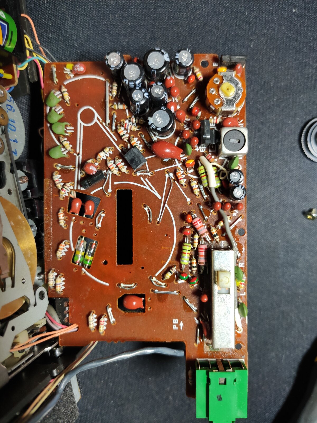

    3. Remove the tape sticking the wires to the PCB and tilt the PCB after removing its screws;
    4. Remove the flywheel retainer plate;

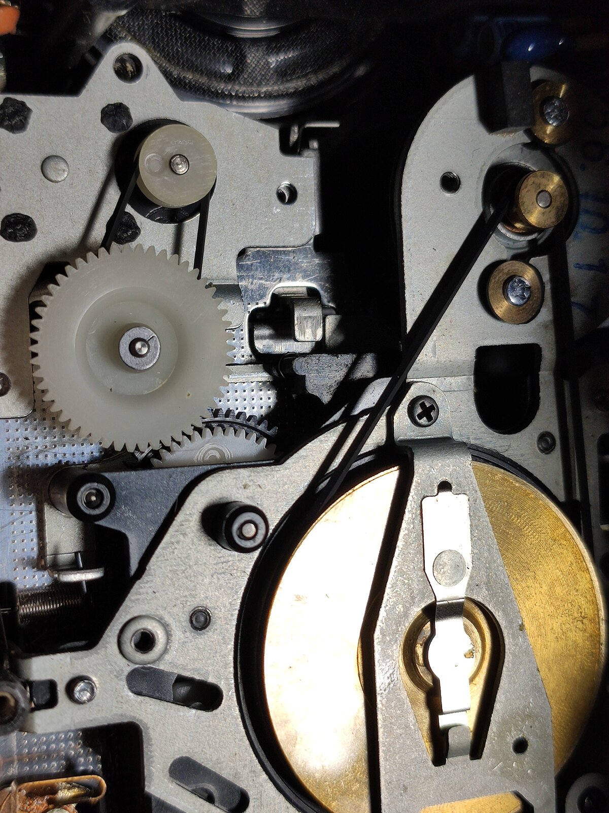

    5. Remove the belt and the flywheel;

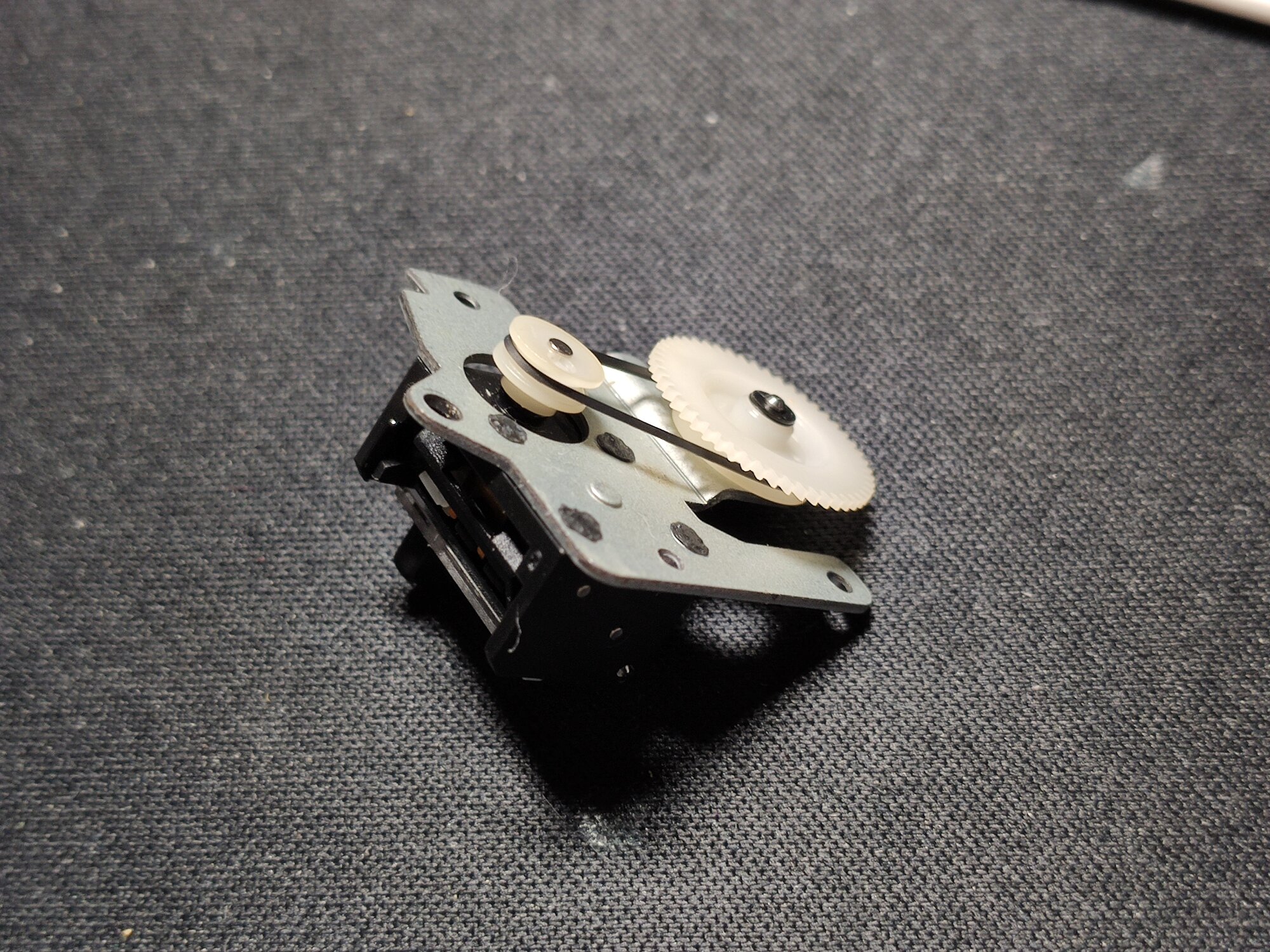

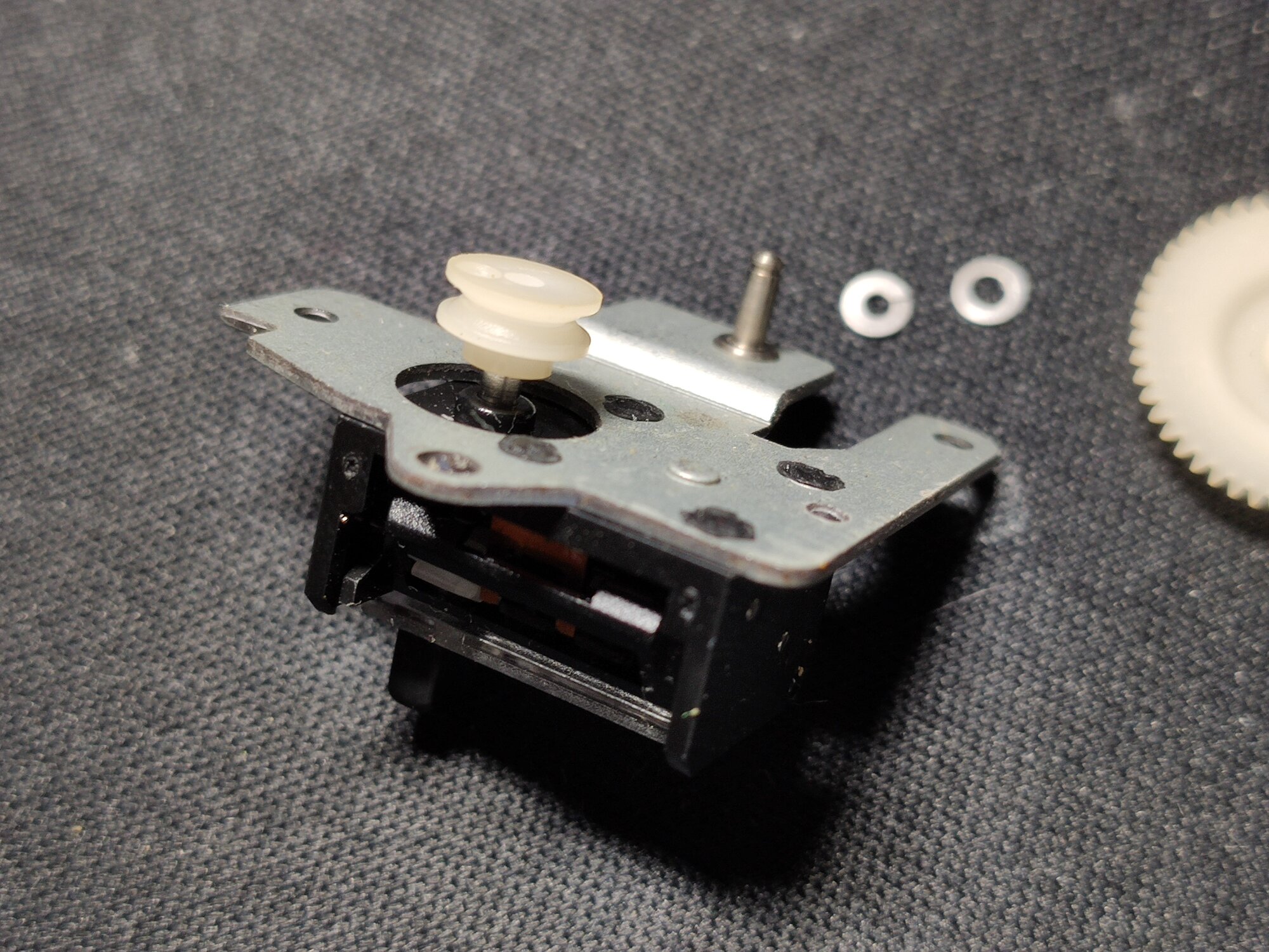

    6. Remove the counter assembly by removing its screws. It is recommended you lubricate the shaft of the counter assy as shown in pictures before installing the new belt;
    7. After installing the new counter belt, counter assy can be reinstalled;
    8. Add some oil to the motor top bushing while moving the shaft up and down, so oil gets inside;
    9. Clean the pulley's grooves from old belt residue; If sanding is needed, power the unit on and keep a twisted small piece of sandpaper (800-1000 grit) inside the grooves until they have no residue left; Clean with IPA after;
    Chances are some sandpaper residue will fall under the pulley: clean that with a coton swab and IPA.

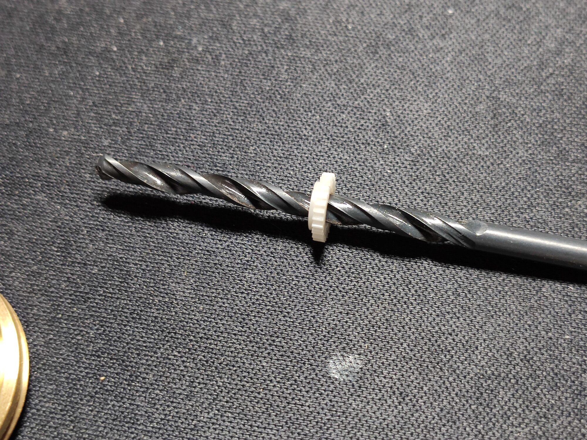

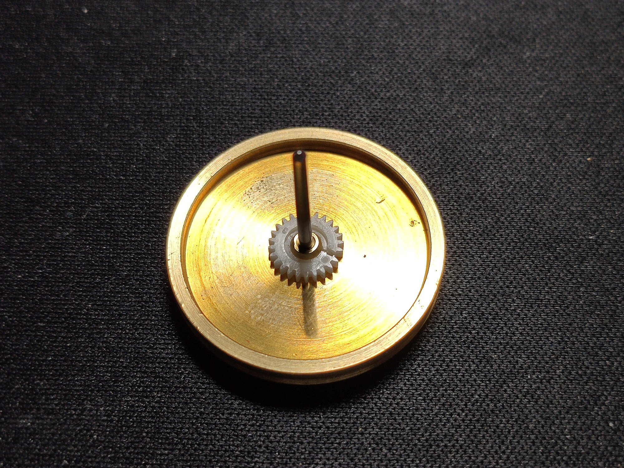

    10. Remove the white gear on the flywheel and enlarge its hole with a drillbit. Fit on fywheel should be a tiny bit loose, as glue will occupy the remaining space.

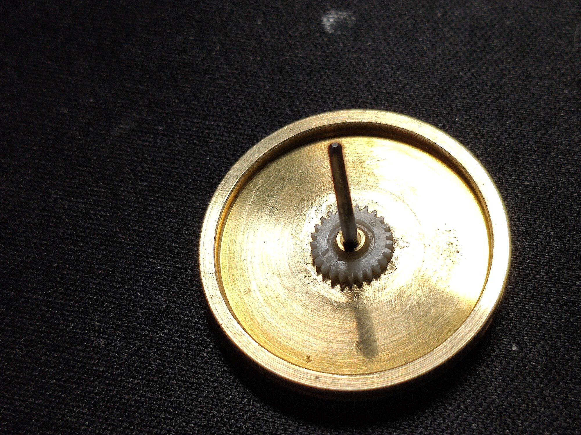

    11. Glue the gear to the flywheel, while keeping it pressed with a pair of pliers (covered in electrical tape) until glue dries. Final result should be equal distance between all teeth of the gear as shown in picture.
    12. Oil the capstan bottom part and reinstall the flywheel and belt; Make sure to clean the capstan and pinch roller of any oil residue before playing a tape !
    13. Put grease on top pin of the flywheel and reinstall its retaining bracket;

    Cyanoacrylate super-glue is what I used to glue the gear to the shaft.
    Roughening the metal surface with 800 grit sandpaper is a good idea to make the glue grip better.

    Two part epoxy resin is too thick for these repairs in my opinion.
    Cyanoacrylate glue works just fine if the surfaces are roughened before. The inside of gear is already roughened from the drillbit and the brass you do with sandpaper.
    It's also important to clamp the gear until the glue cures, otherwise there will be a gap between the teeth where the crack is.
