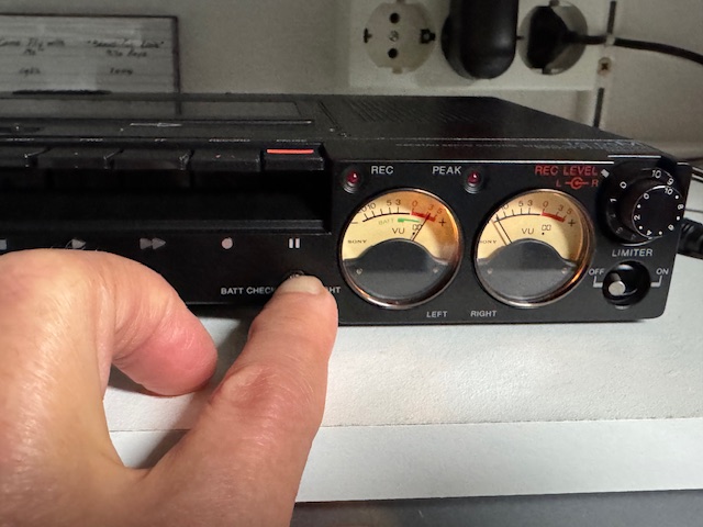

    This recorder also activates the electronics when only the record button is pressed. It remains silent, the motor doesn't run, but it does consume power. Could it be that the internal switch for the record button isn't releasing properly? Testing is easy. In that case, the meters will illuminate when the light button is pressed. It's not something I've experienced in practice, but it's worth checking.

    "Testing is easy. In that case, the meters will illuminate when the light button is pressed."
    That's the case!! The light's go on when I press the Light Button. And the left meter goes completely to the right. So it must be the left channel that is not releasing properly. Record level 'zero'.

    Left VU-meter acts as battery level check (see the green marking), that's why only the left needle moves.

    When you press the light button, a single meter acts as a voltage gauge. That's why it deflects to the right. It indicates the battery status.

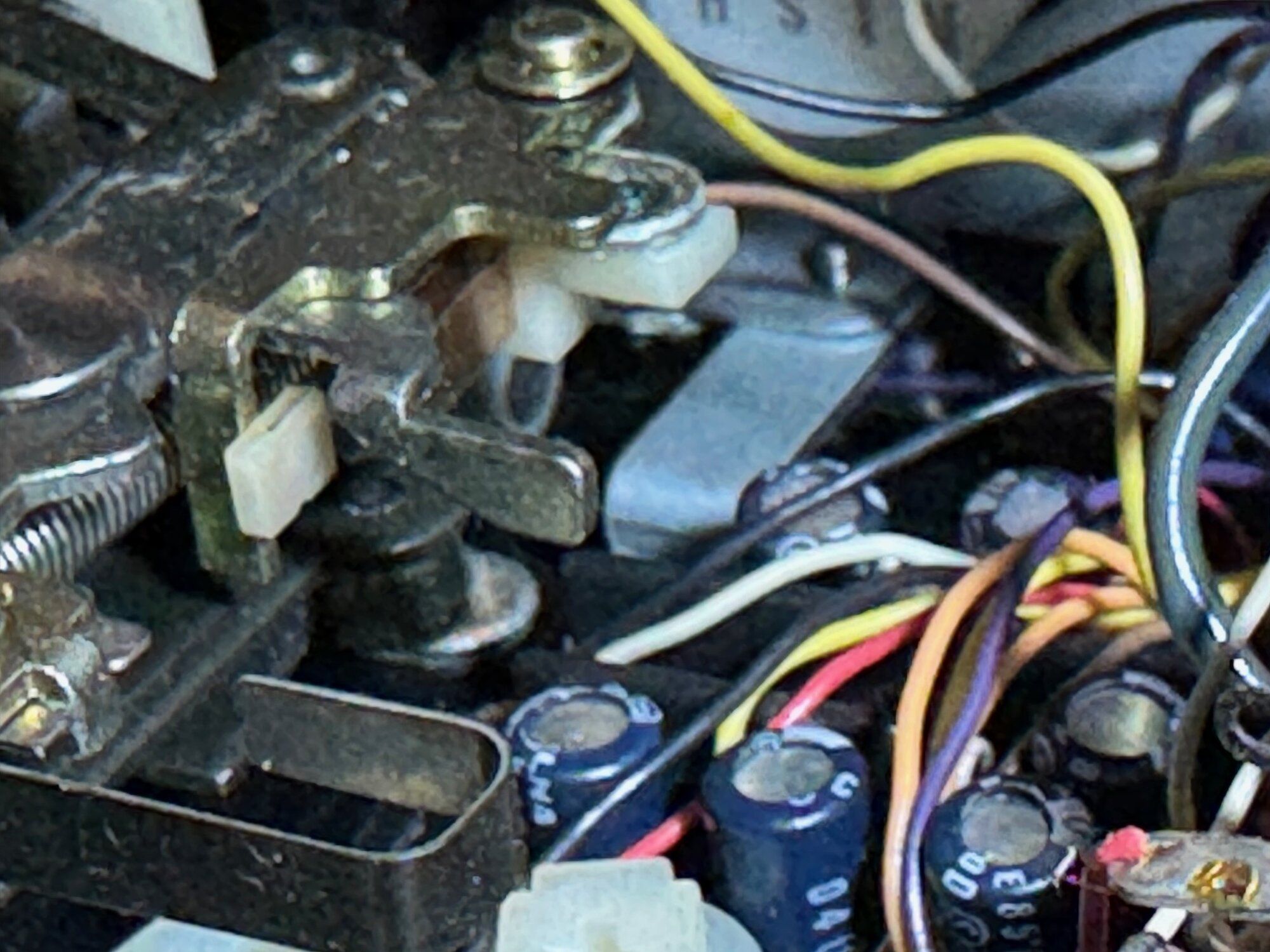

    I checked the four leaf switches in my D5. All are working as mentioned in the service manual. So there must be another component that is causing the high current in stand-by.
