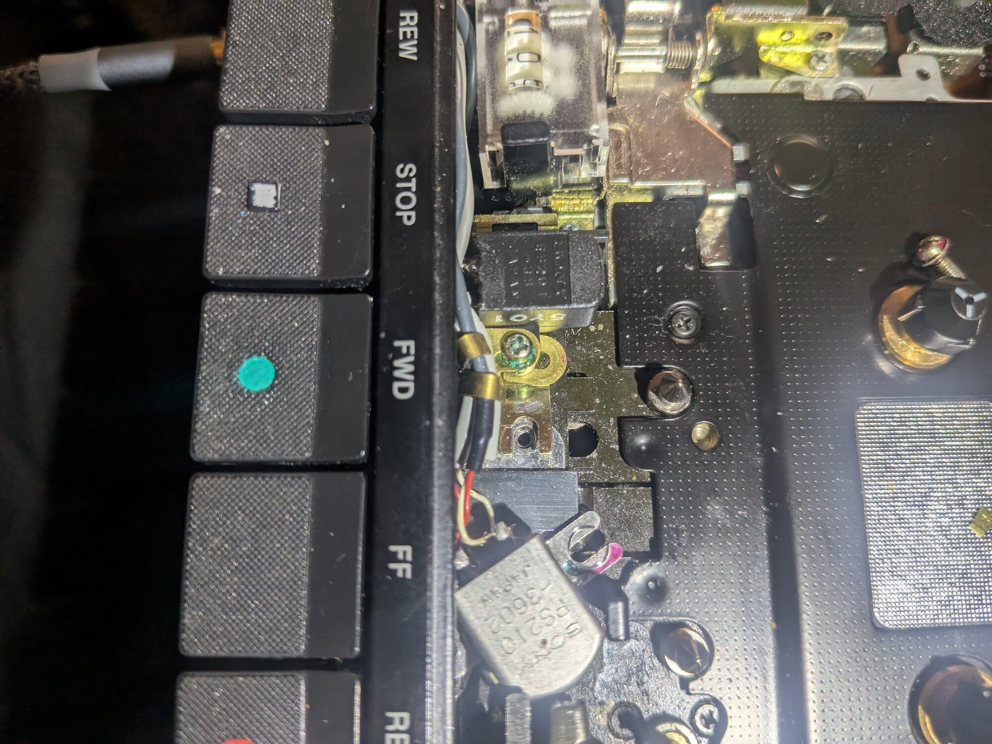

    Hello people, first of all I'm not sure where the TC-D5M fall into as of categories, so if this is in the wrong place I do apologize.
    I can't keep my self from fiddling with things that are probably perfectly fine as is. I keep trying to find ways to improve something, even if it's not necessary (I know it's a problem), it's just that I'm a modification maniac.
    Now, onto the question at hand. What is the head that's in the TC-D5M? From what I've read it seems that it's sendust. How is the frequency response of this head? How does it compare to a ferrite head from the Sony TC-158SD?
    I had the chance to buy some NOS heads and one of those is a Sony PF145 3602 A Ferrite head. I compared the two heads and they seems to have pretty similar dimensions and it seems it will fit int he D5M pretty nicely.
    My question is would it be worth it to try to do it? Or is the only way to find out is to do it and do some measurements?

    HF response limitation is from the head, specifically how fine the gap is. Electronics have HF response that goes significantly above 20kHz. In order to keep the response flat at 20kHz, the -3dB point is moved further away.
    Low frequency response is a combination between the head (how good tape/head contact is) and electronics (FR of preamplifier).
    As far as TC-D5 series go, the TC-D5M sendust head is a bit better (30Hz - 17kHz) than the ferrite heads used in TC-D5, D5 Pro and Pro II units (40Hz - 16kHz), although difference isn't that significant.
    The actual FR obtained will depend a lot of more on wear and proper alignment than one head or another.
    Here it's to be kept in mind ferrite heads DO wear and they're much harder/impossible to re-lap when it happens.
    In your particular case, it makes sense to swap a worn head with a new one, assuming you can't re-lap the old one.
    Do keep in mind there is an adjustment shim under the right screw, which is used to set the head height. This should be checked when installing the new head.

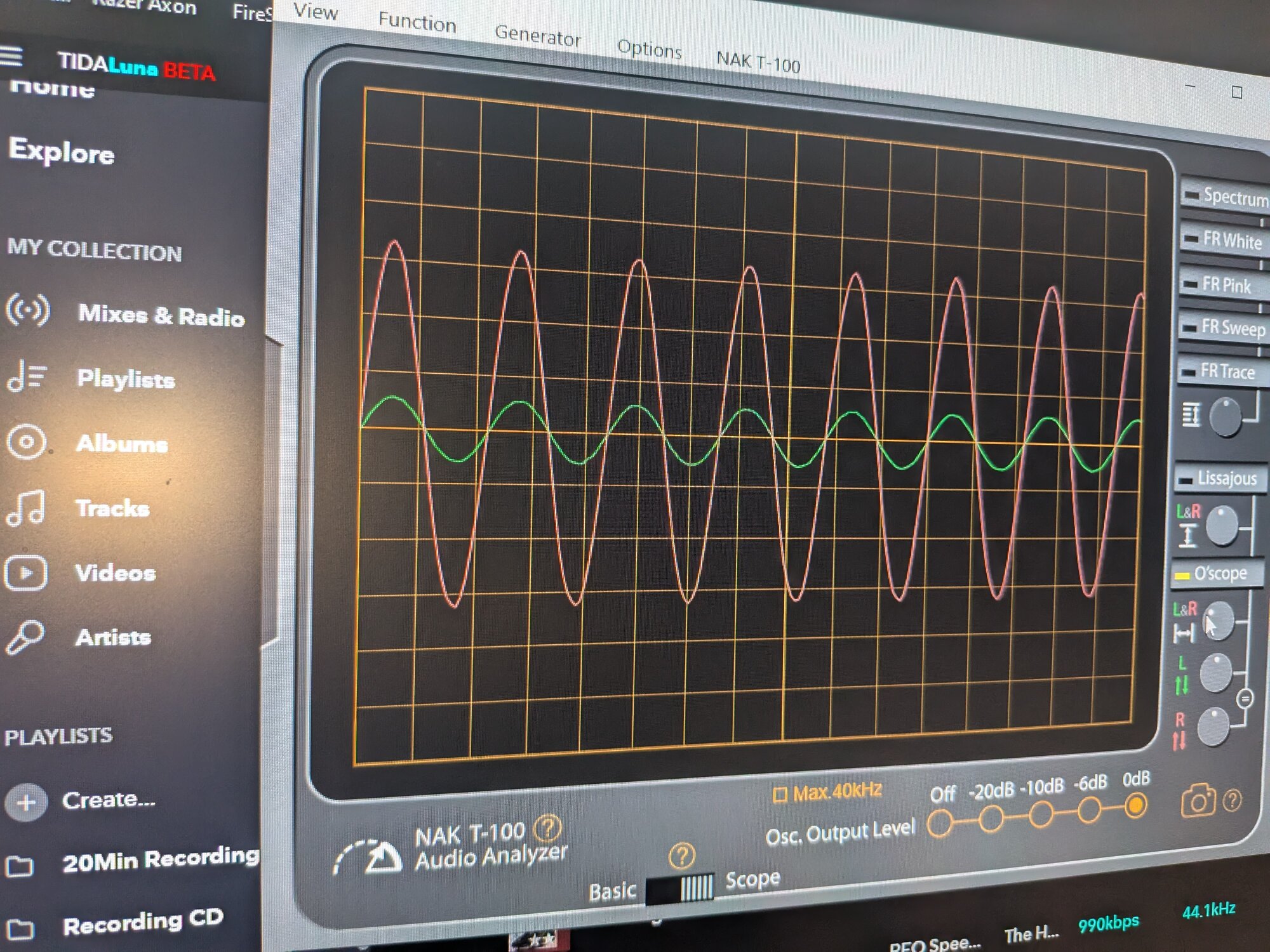

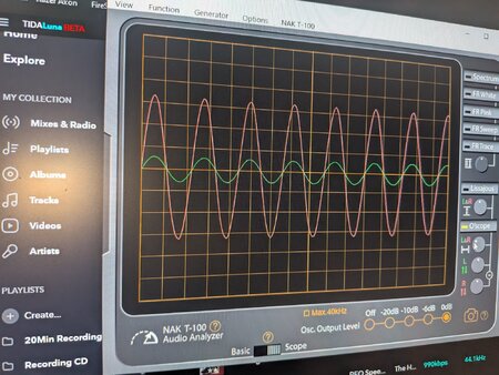

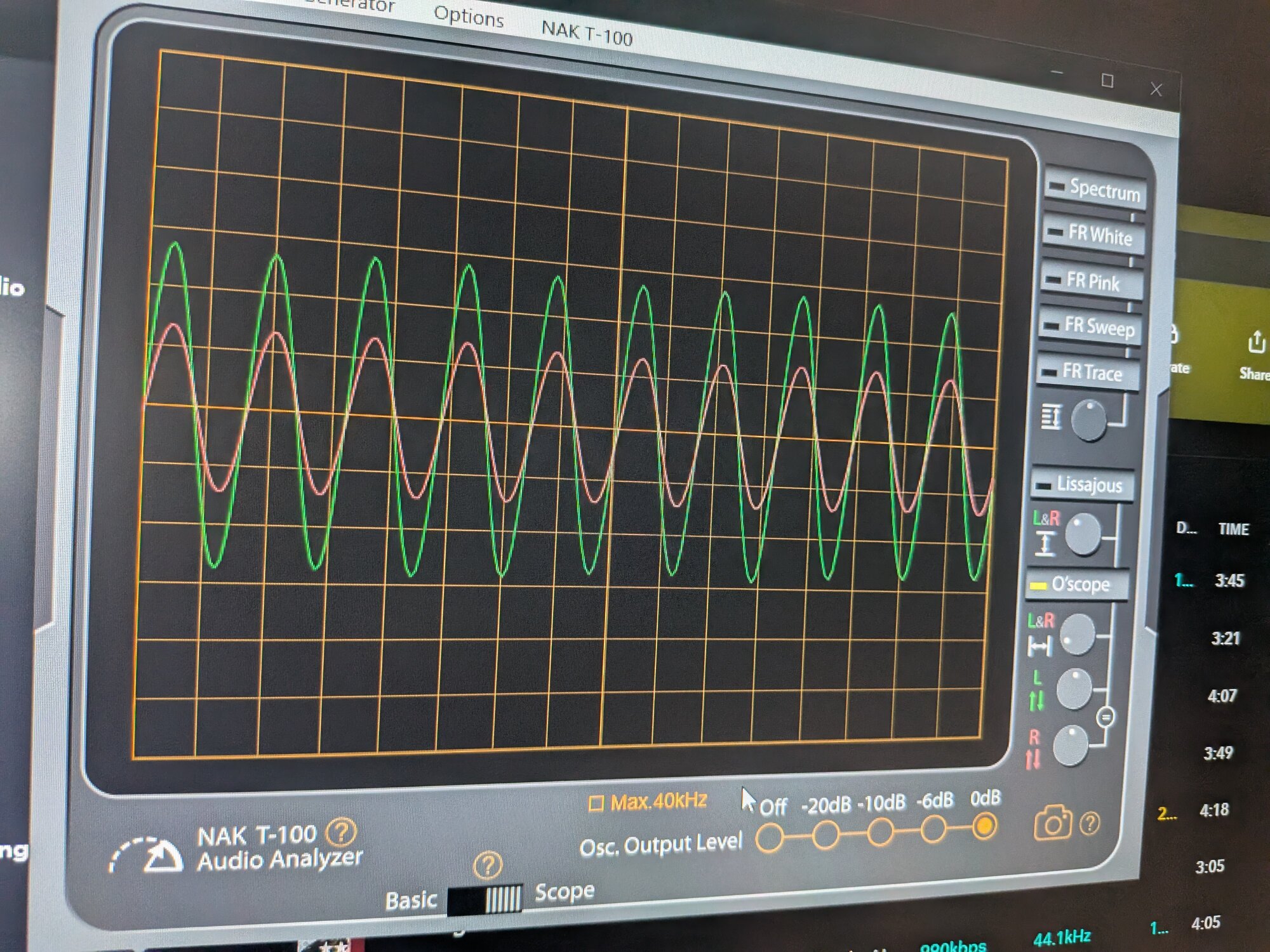

    A little update. Here is something very odd. Before changing the heads, after running Azimuth, head height and level checks, azimuth and level checks are good, but getting no signal from left channel when using head height test tape. Odd. After changing head(ferrite head), head height and level are good, but azimuth looks like this. What could this mean? Measured from line out.

    This is what it looks like when using head height tape with the original head
  13. Valentin
    1,994
    Assuming the unit works perfectly in both playback and record ? Can the bias be set to match input/output levels at 10kHz ?
    Would also be interesting to see a frequency response measurement with white noise tape.

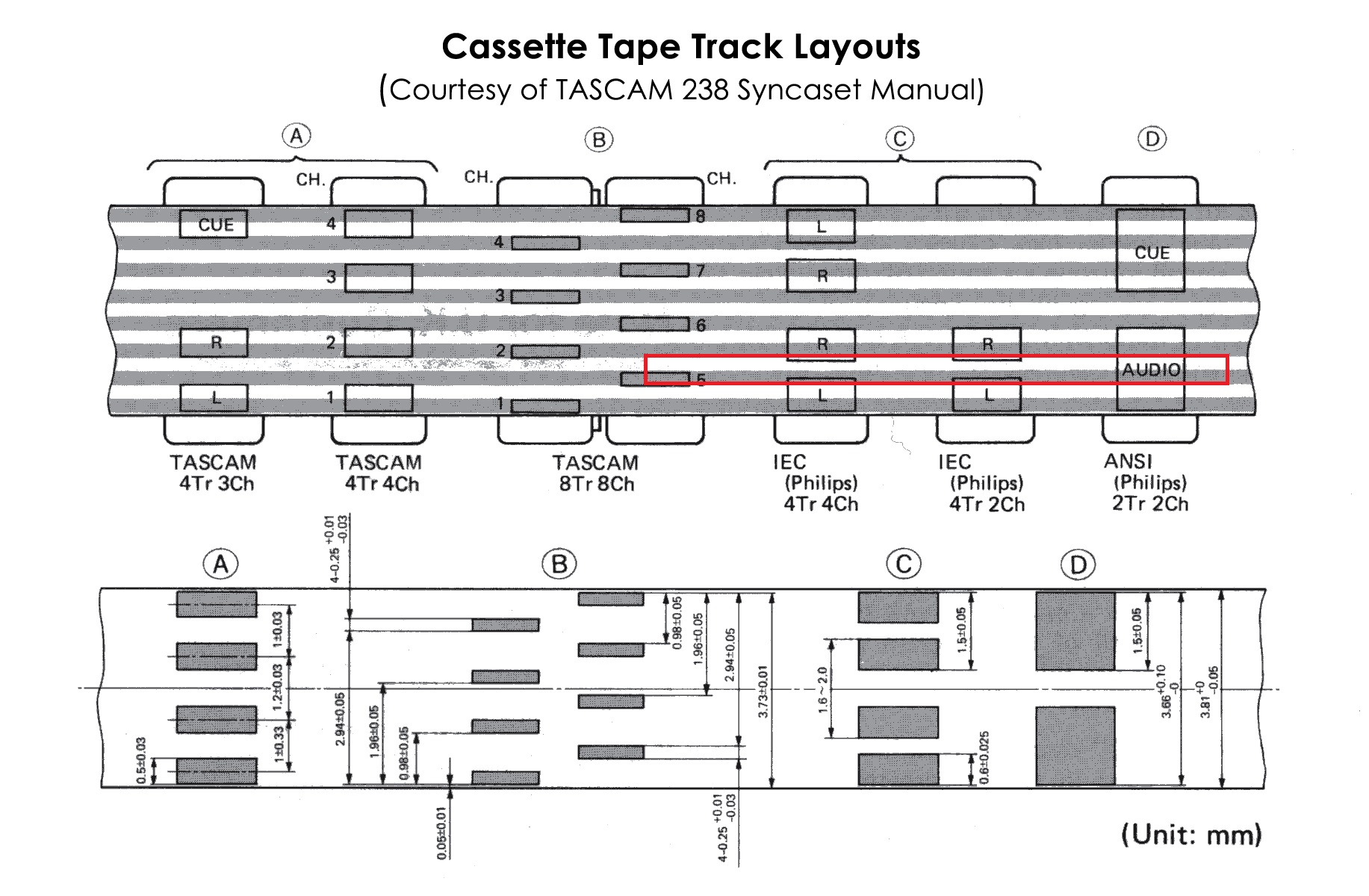

    Goal of this adjustment is so the outputs are at a minimum. This type of tape has a track in between the 2 normal audio tracks (see picture attached), so fact L channel is higher indicates the head sits a bit high.
    On the old head it's the opposite: head sits a bit low causing R channel to have high output, while L being very low.
    However, what I would do before even checking this is check the height of the tape guides: erase head and REC/PB head. You would need an M300-like gauge to do this check.
    What's important here is not the absolute height (as most cassettes machines tend to be little bit off anyway), but that the 2 guides heights match. Otherwise tape won't run straight.

    Thanks again for the reply. Unfortunately I don't have the gauge as of right now. are there any alternative methods to check? I have tried to fold the shim under the head to increase its thickness thus gaining height, it helped, but i don't think it's quite enough. I don't see a way of adjusting the tape guide heights however, which makes this pretty frustrating...

    Ok, after a bit of more fiddling I have found another piece of identical brass shim under the erase head. Reading the SM shows nothing should be there. Should there be another piece of shim there?

    So, turns out there were two pieces of shims under the erase head. They are about the same thickness, but around double the thickness of the one under the play head...hmm...

    Ah, ok, Thanks for the clarification. I did some more fiddling and ended up switching the head to the ferrite one. I found that the Sendust head was unevenly worn, near the left side bottom, there was a ridge that I could feel with my fingernail, that ridge is not there on the right side. That would explain why the sound was odd, because the tape was trapped in the ridge(at least that's what I figured). I installed the ferrite head without any shims, and it performs alright, azimuth and level can be achieved, and height is almost there. If I listen to it, I can't really complain about how it sounds. It was better than before for sure. Thanks again, I will update if events occur. Cheers!
