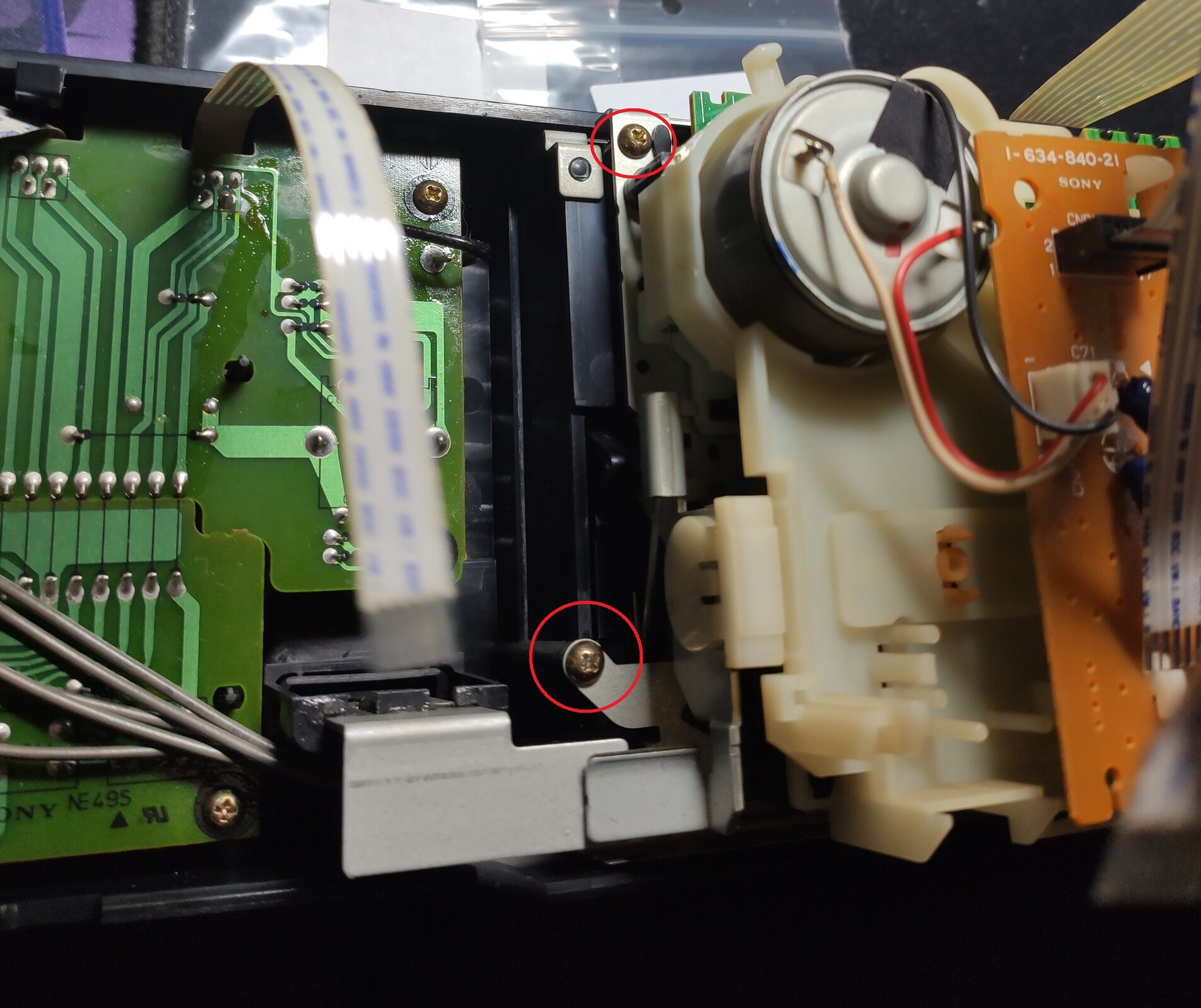

    MECHANICAL SIDE:
    1. Start by removing the top cover held on by 4 screws;

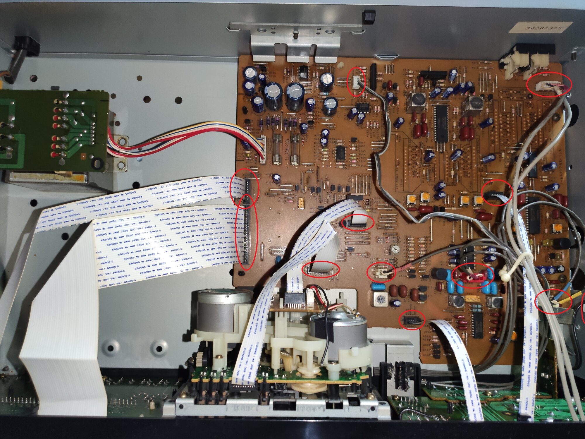

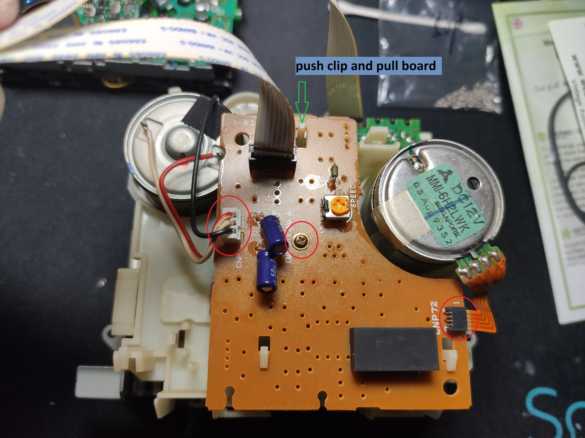

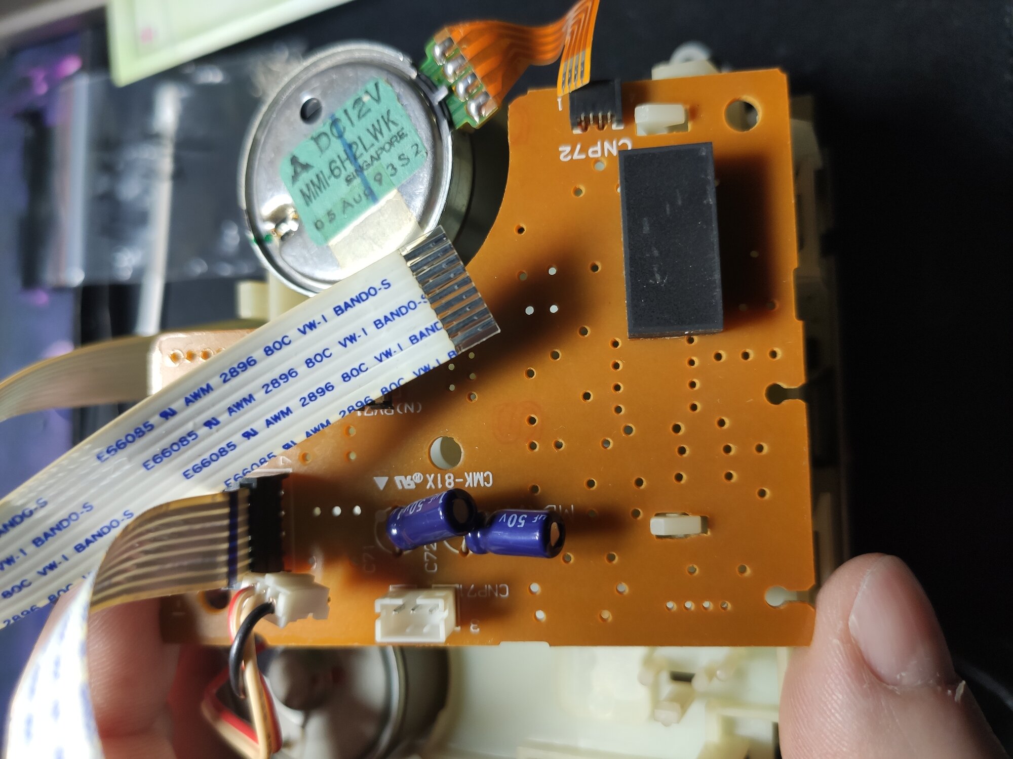

    2. Remove all the cables going from the front panel to the PCB (marked in red on picture);
    3. Remove the screws holding the front panel on;
    4. Remove the front panel;

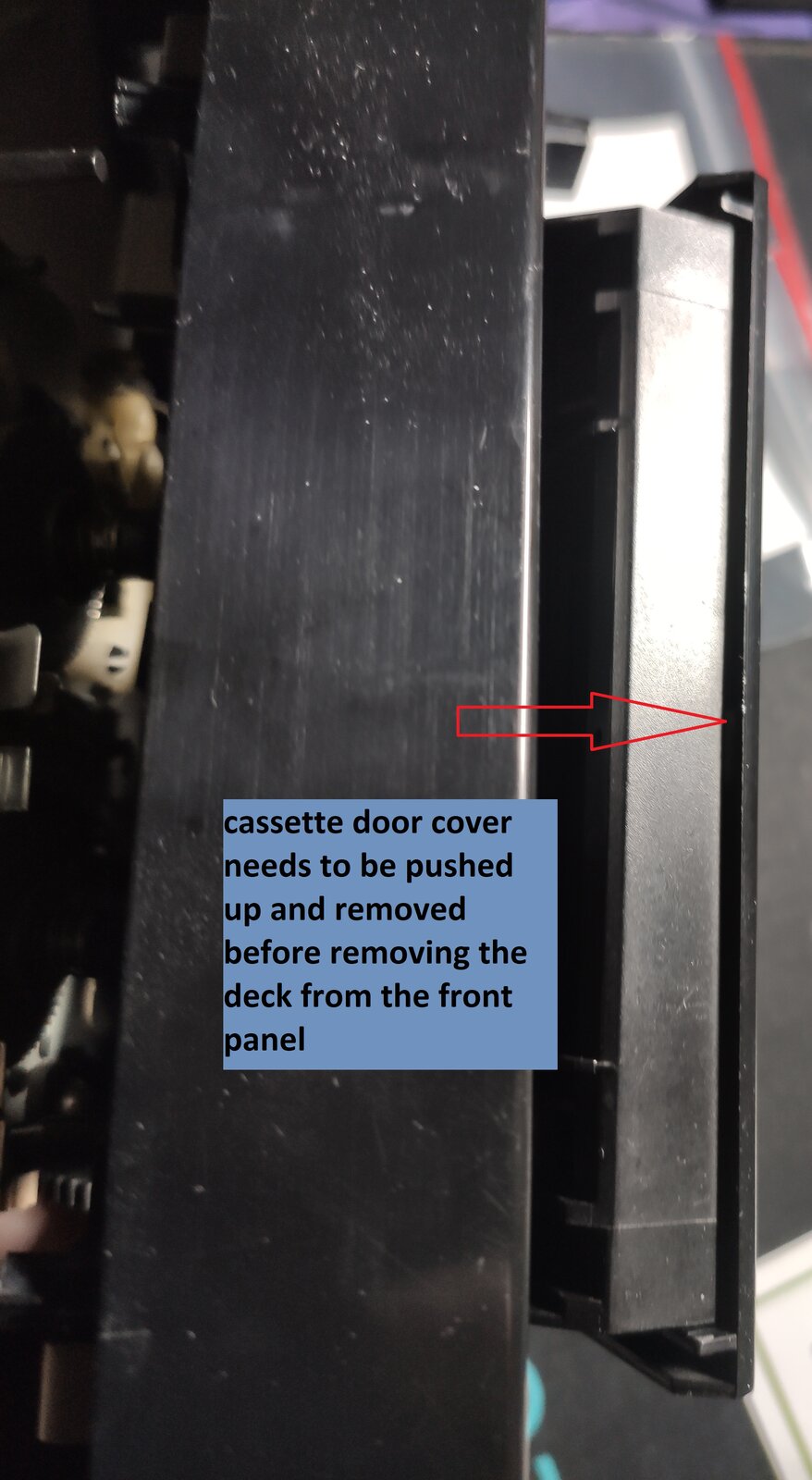

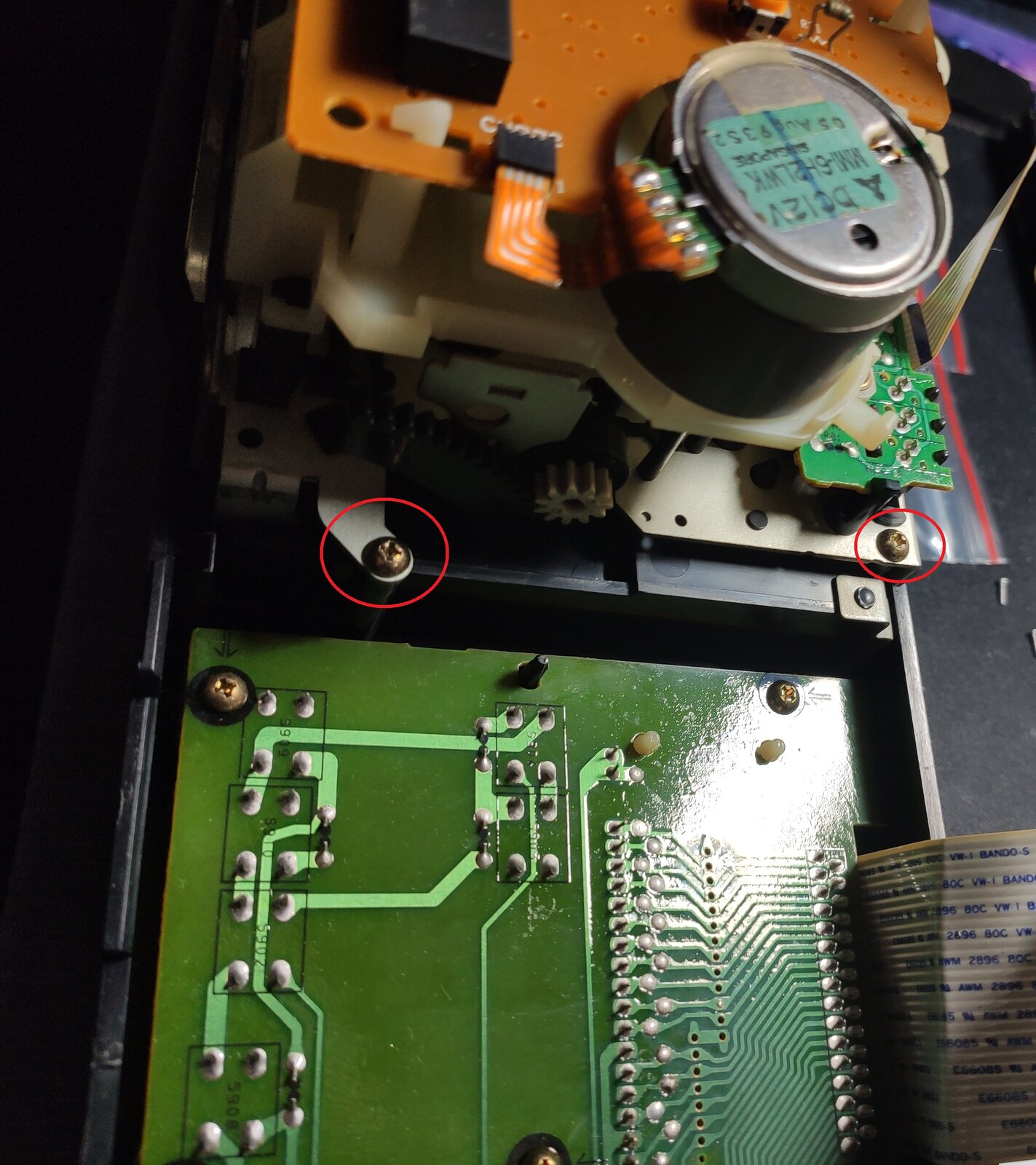

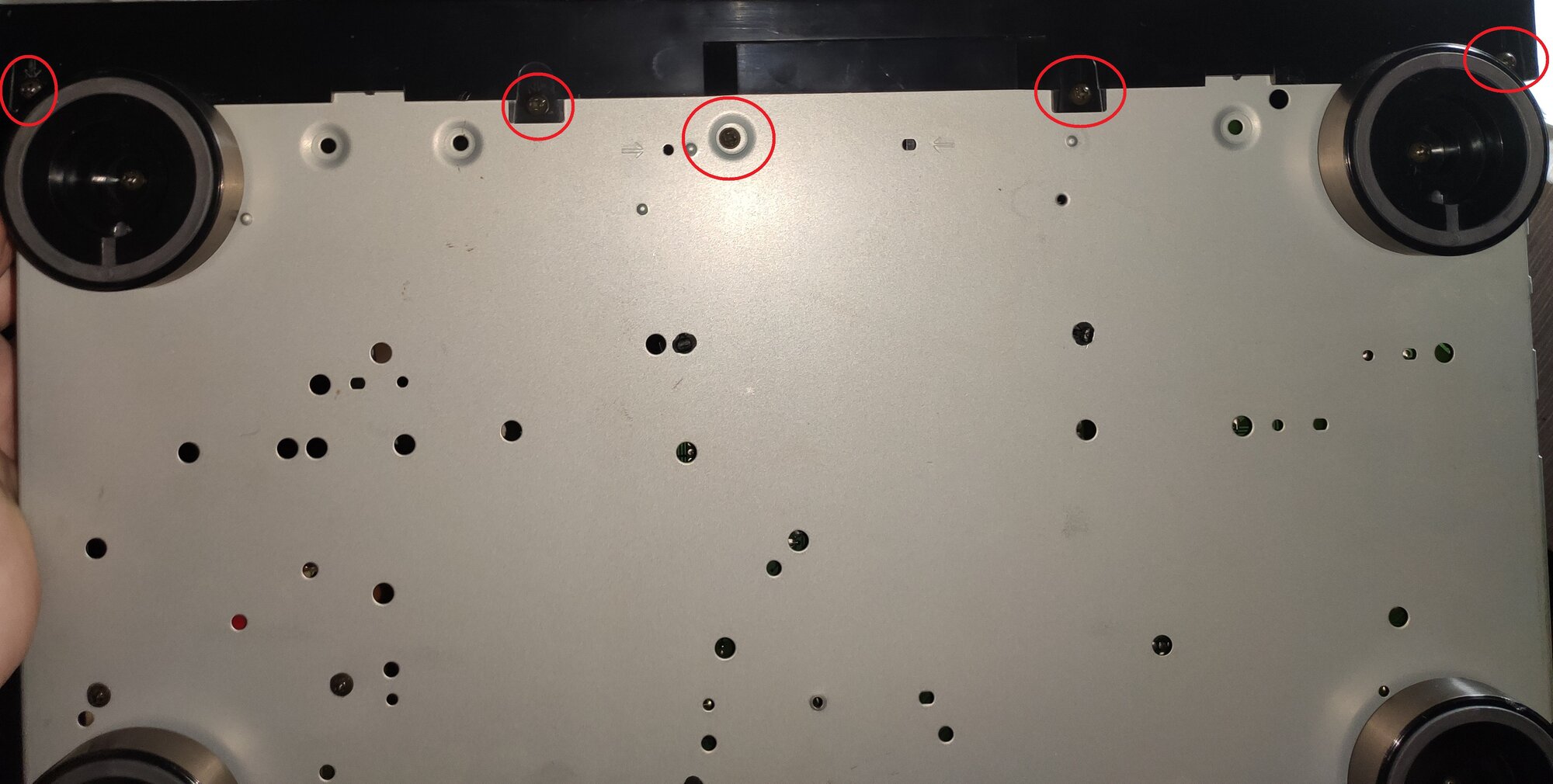

    5. Remove the deck itself from the front panel (it's held by 4 screws + the cassette door cover);
    6. Remove the top PCB from the deck;
    7. Remove the motors assy from the deck;

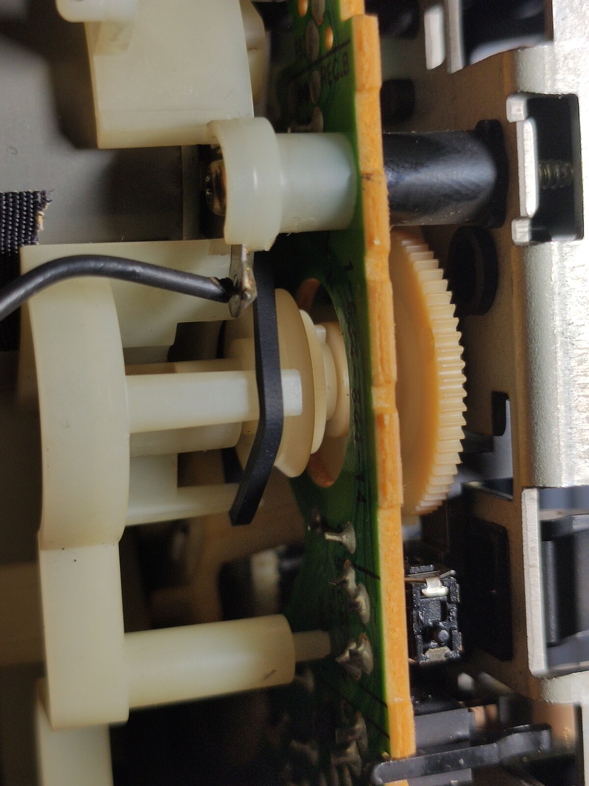

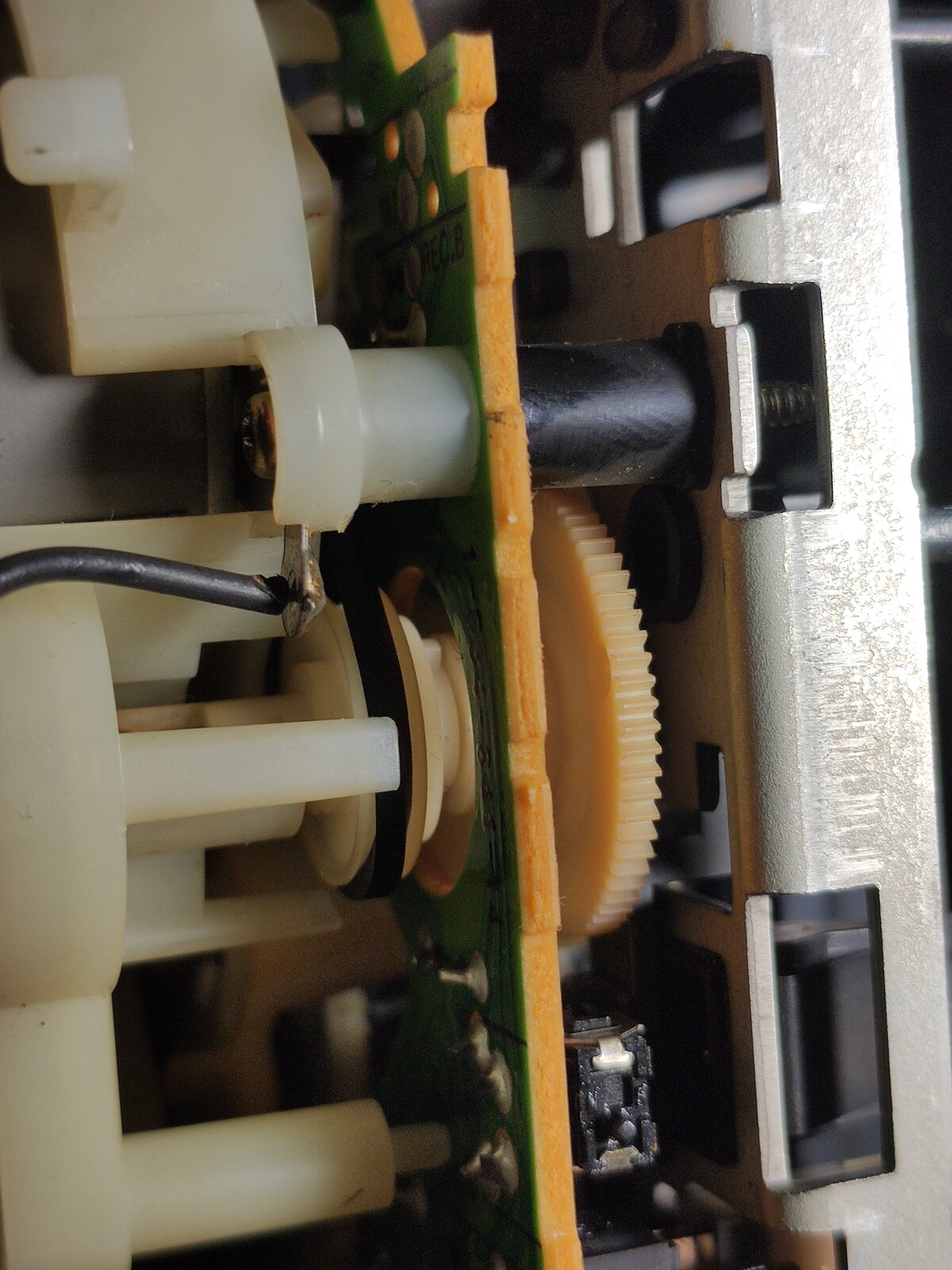

    9. Lubricate the capstan bearing (pay attention there is a plastic washer on the opposite side);
    10. Lubricate the motors top bushings;

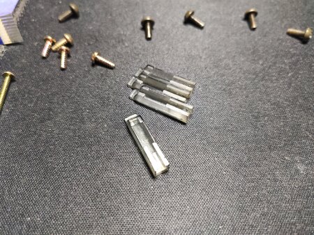

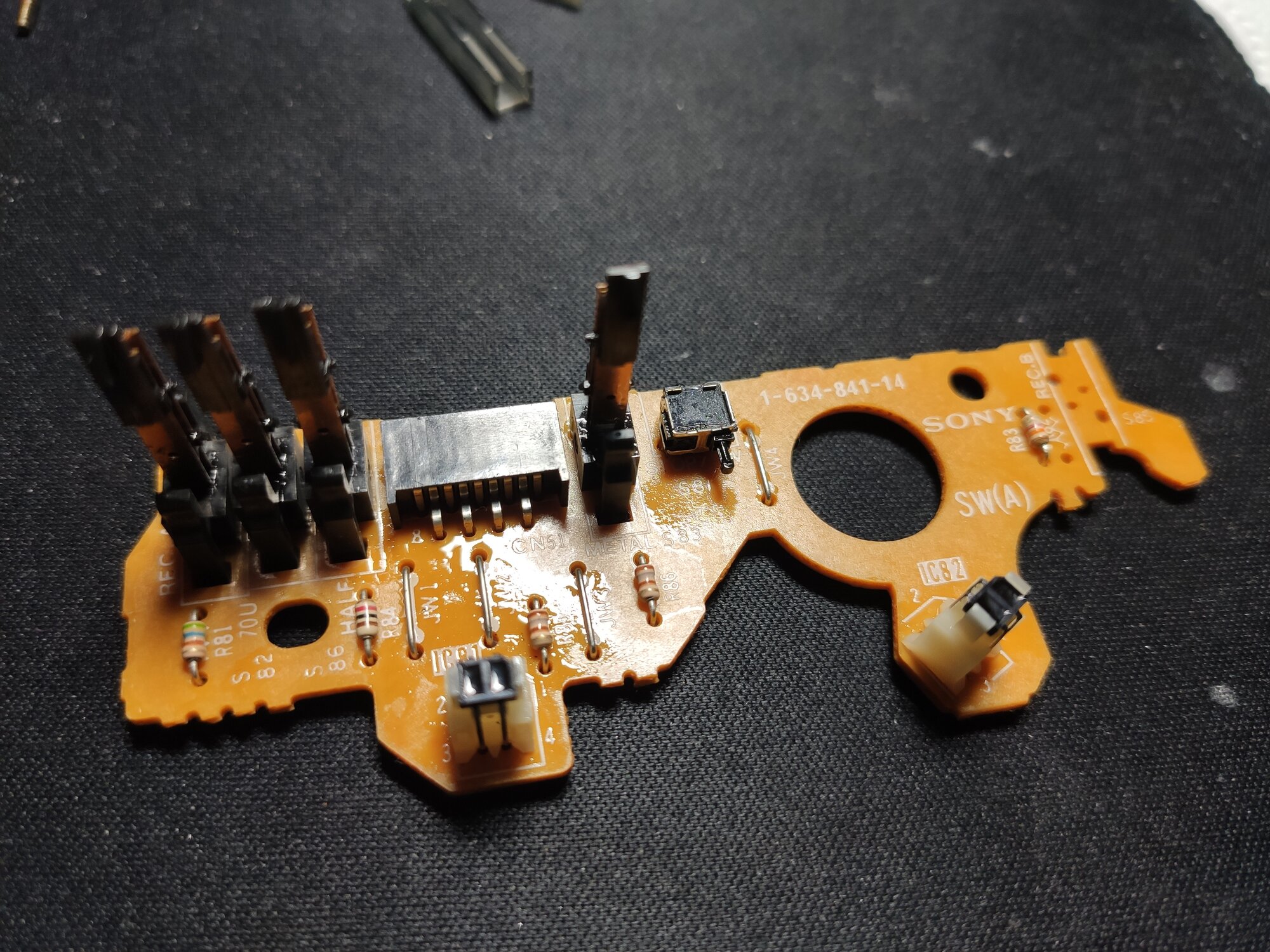

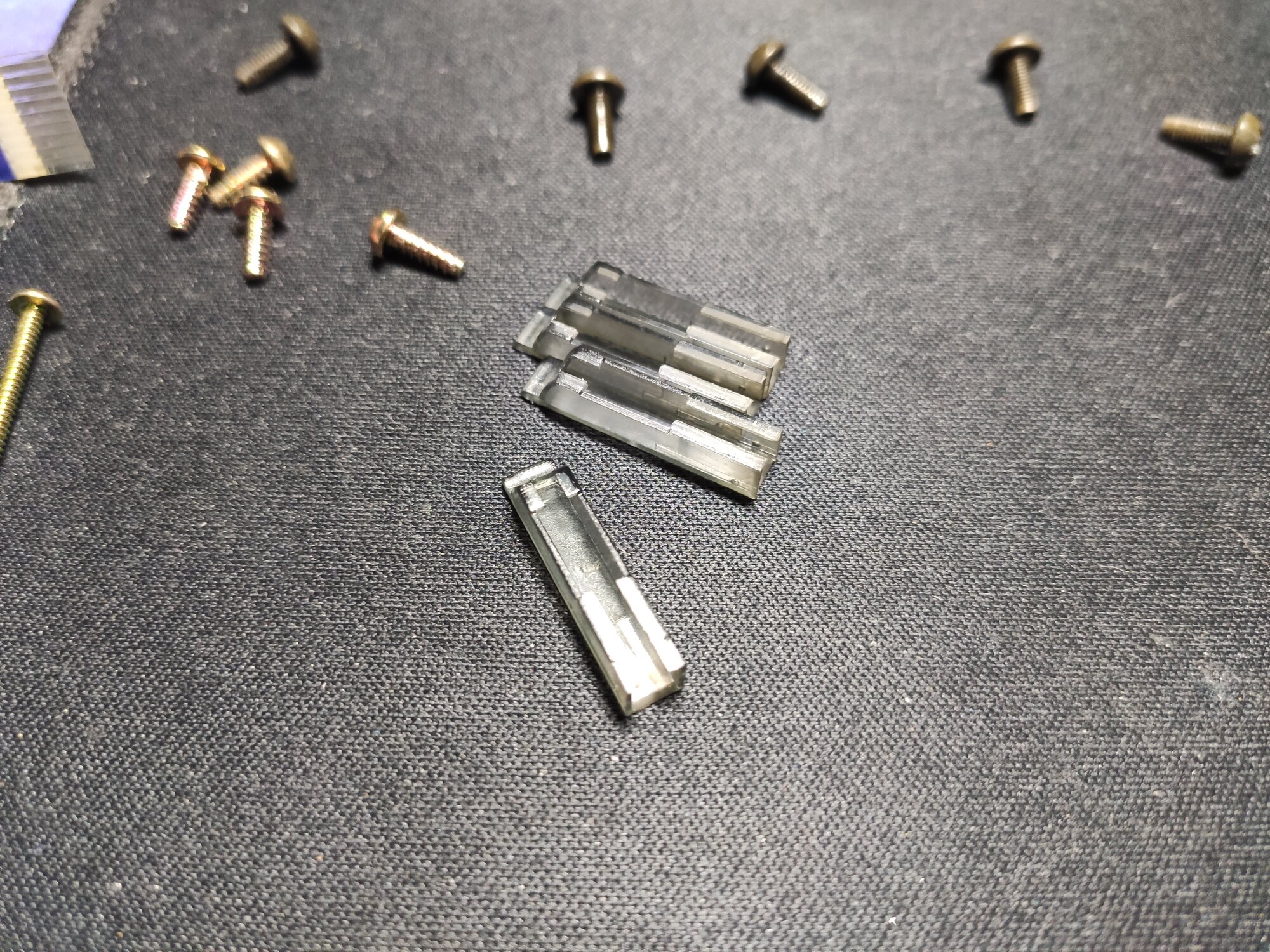

    11. Take the PCB with switches out, remove the plastic covers on leaf switches and clean them with contact cleaner and cotton swab;

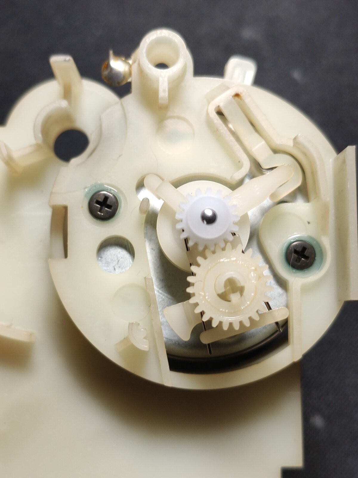

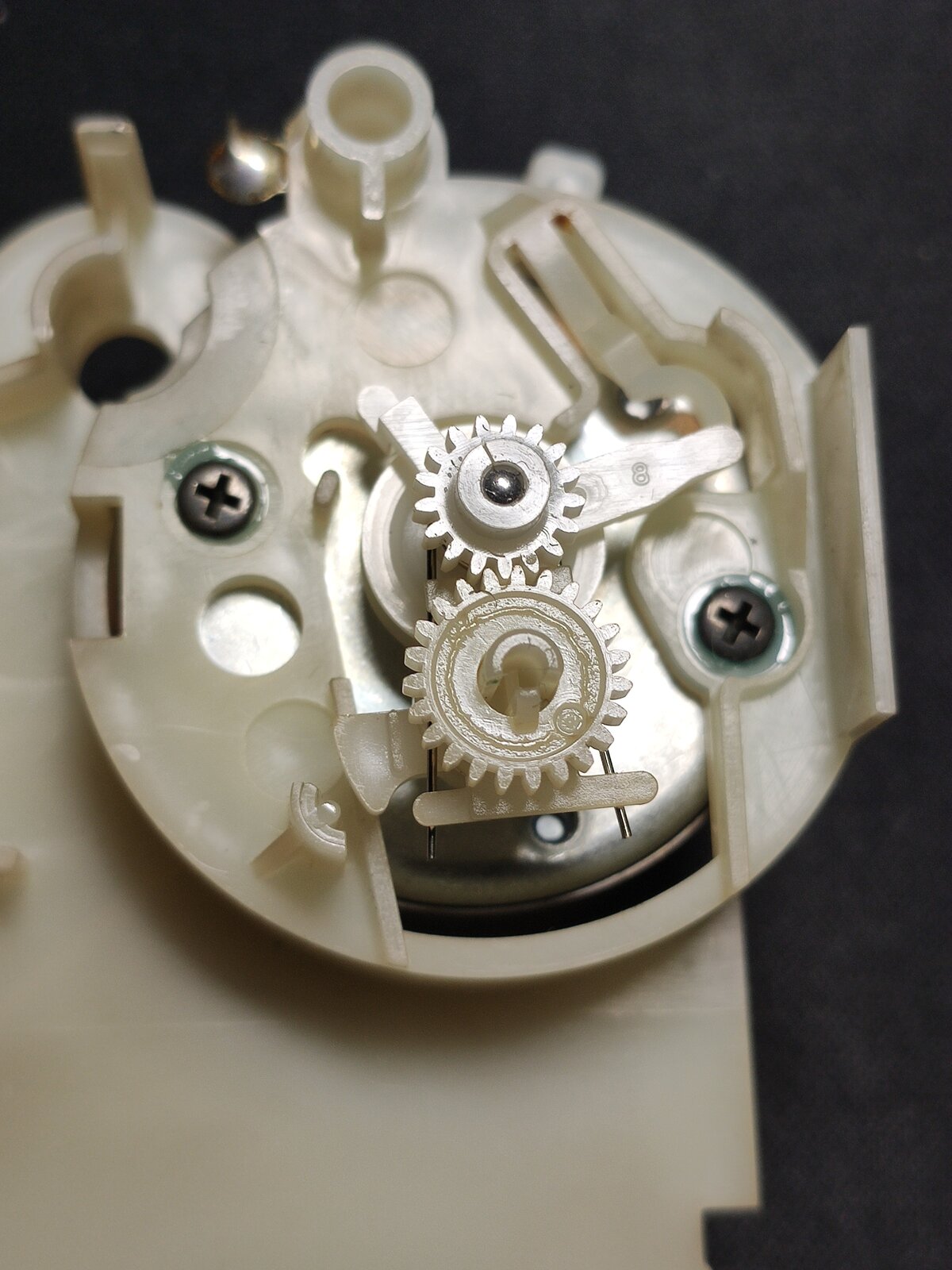

    12. Replace the gear on the secondary motor (should be replaced even if not fully broken);

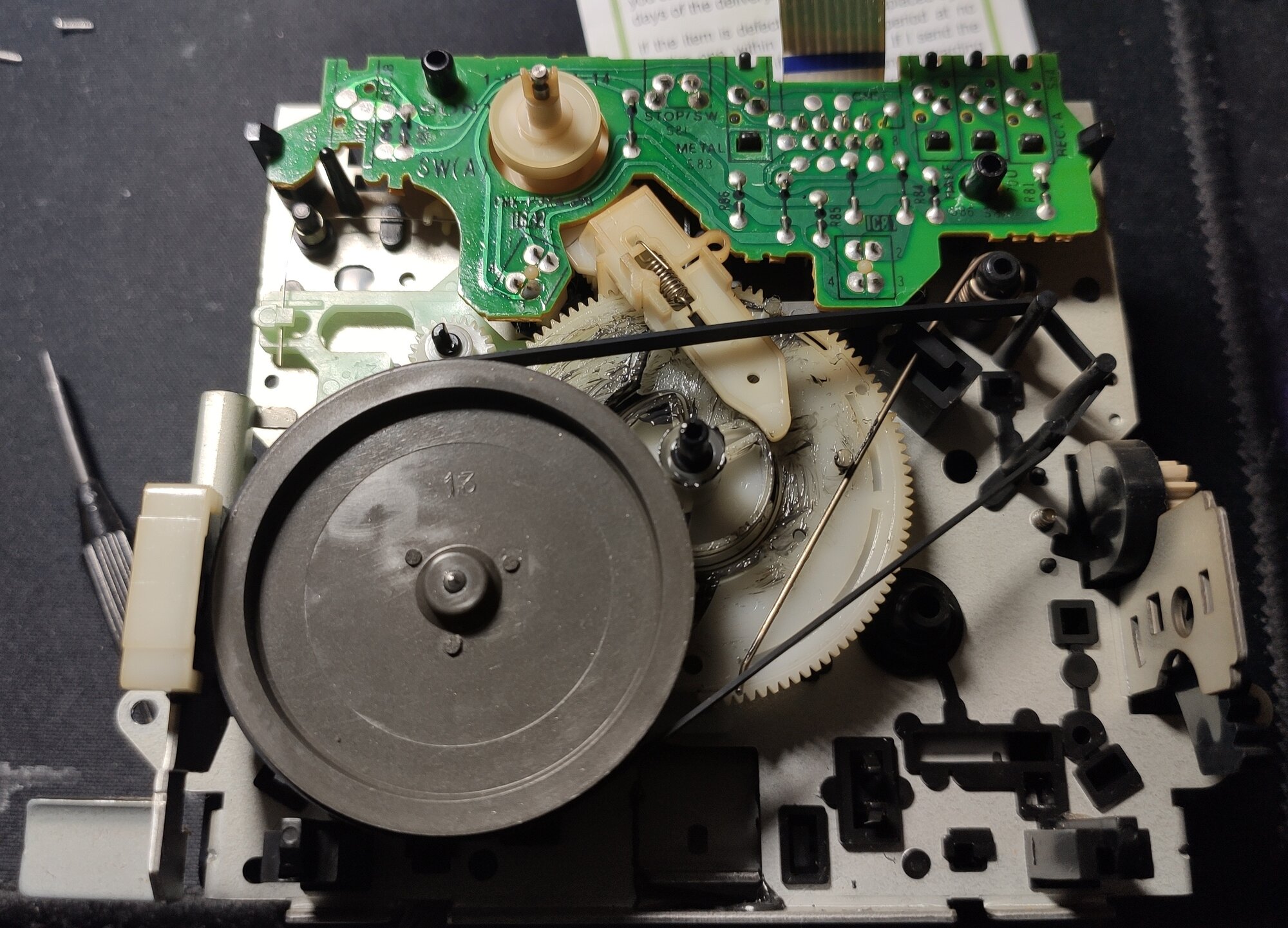

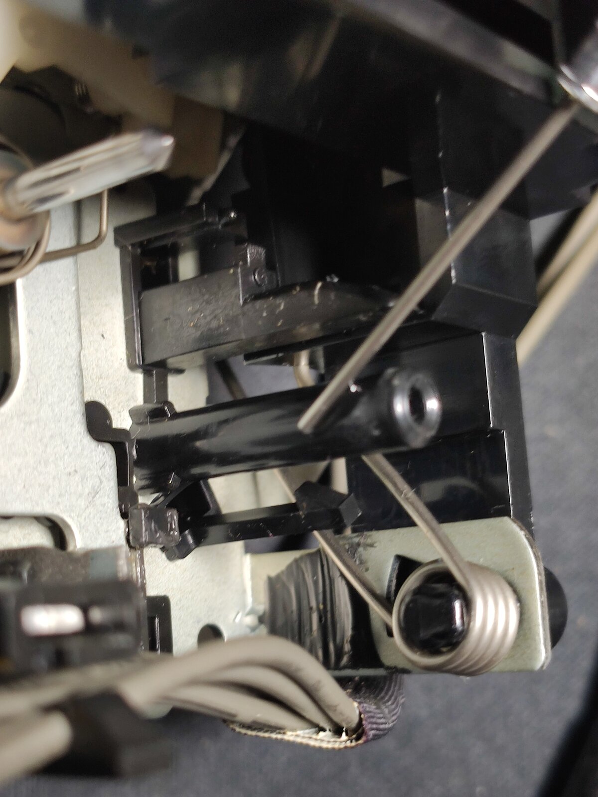

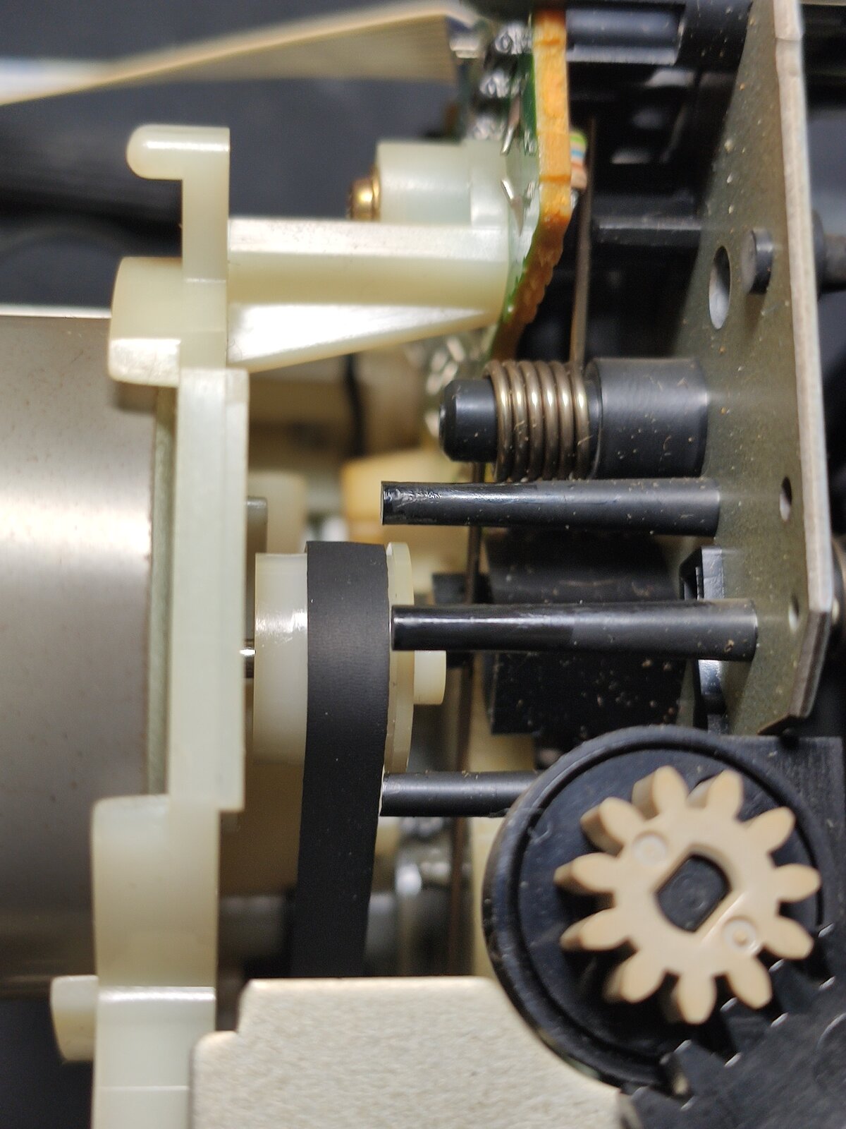

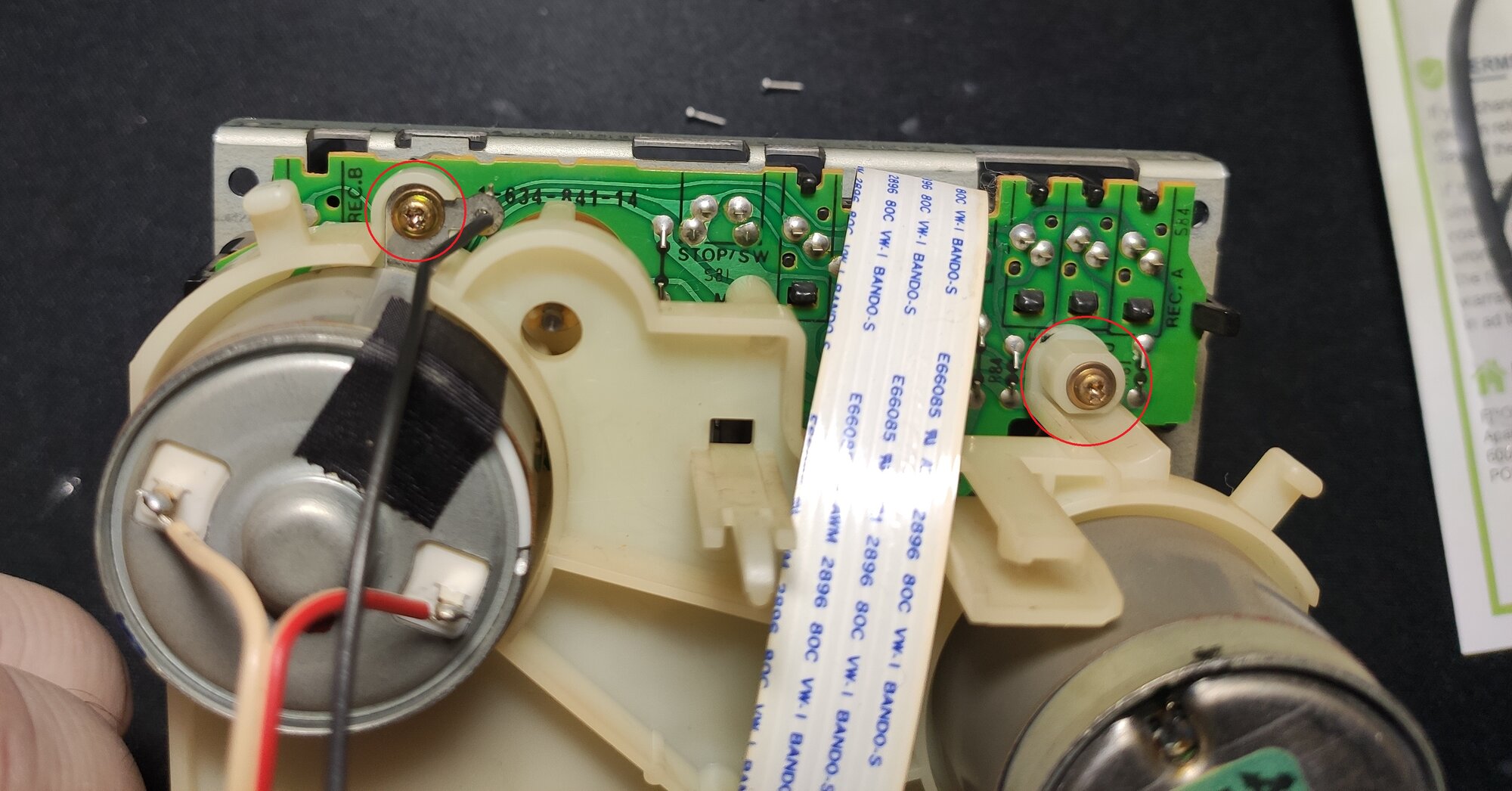

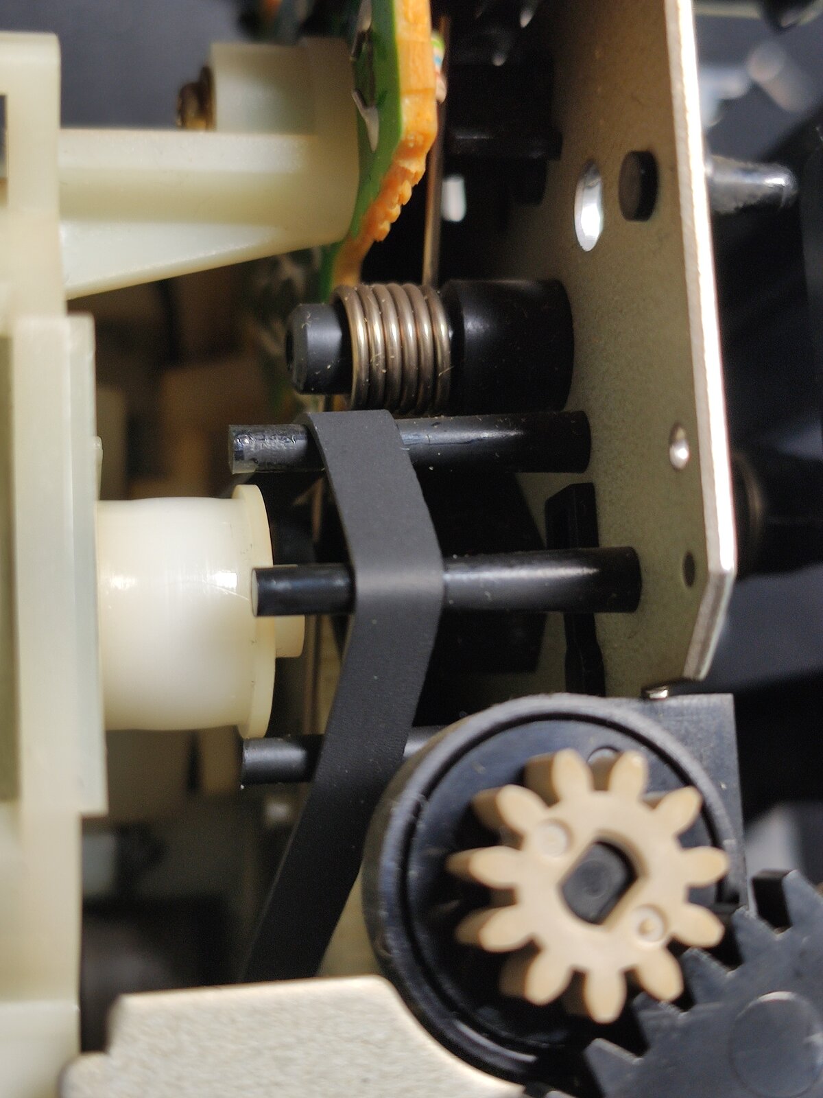

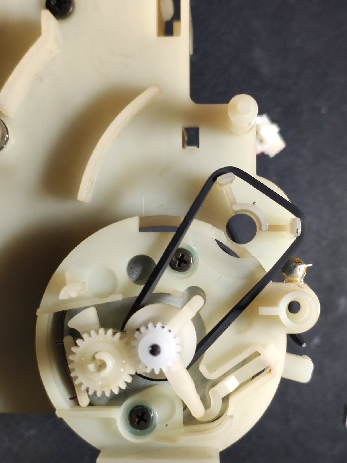

    13. Put the new belts as indicated on pictures;
    14. Reassembly the motors assy and slip the new belts back onto their respective pulleys;

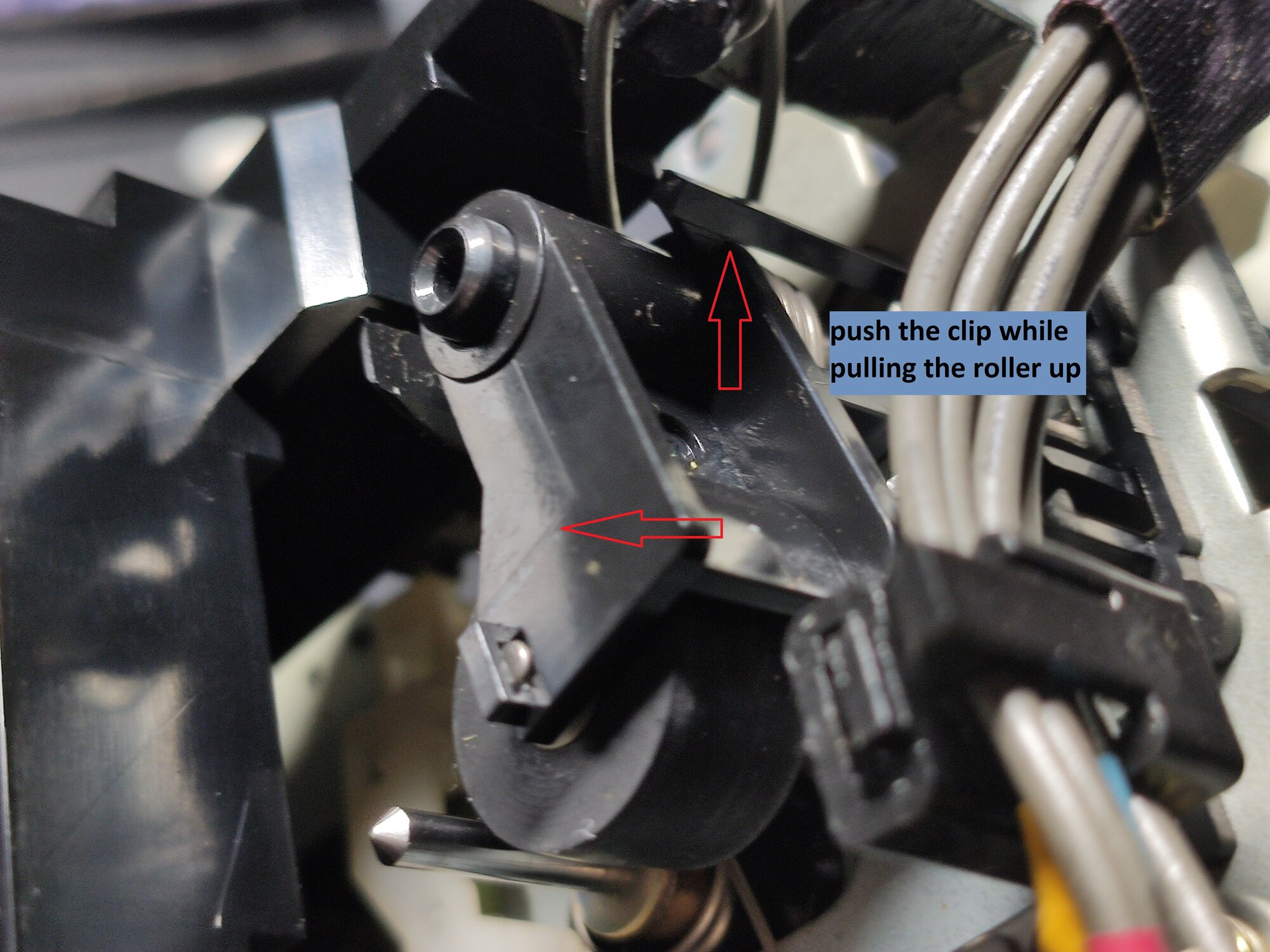

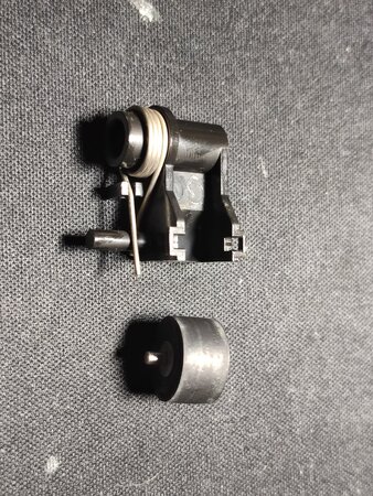

    15. Replace the pinch roller as indicated in pictures;

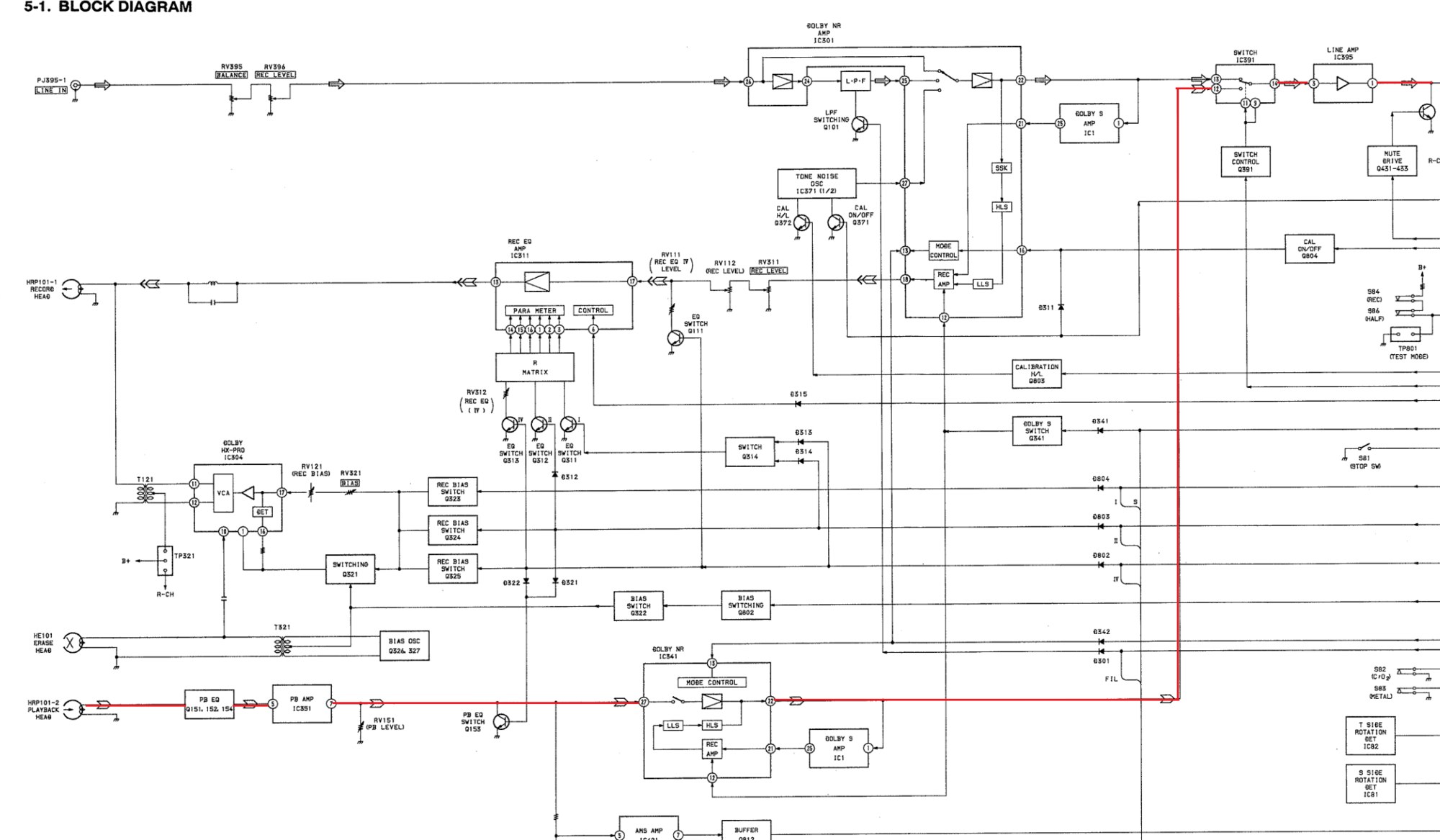

    ELECTRONICS SIDE (note adjustments should be made in the order presented):

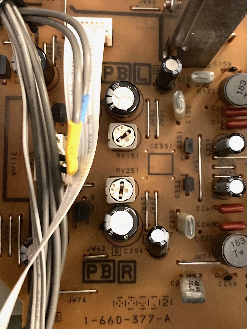

    1. Playback level
    SONY specifies the playback level on the LINE OUT (loaded with 47k) should be 320mV RMS with P-4-L300 tape (160nWb/m DIN).
    This translates into a 437mV RMS when using a Dolby level tape (200nWb/m ANSI), which is what I recommend using.
    Note it is very important to load the LINE OUT with 47k, otherwise your levels will be incorrect.

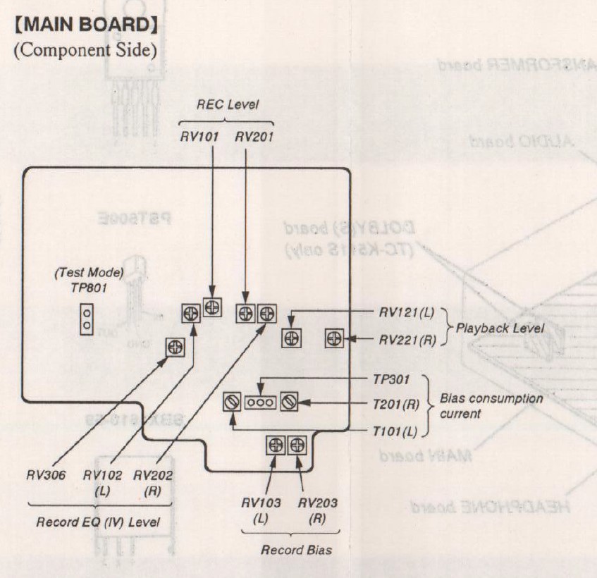

    TRIMPOTS: RV121 (left channel) and RV221 (right channel).
    EDIT
    : Due to inconclusive results regarding posts below, I recommend adjusting levels at the Dolby IC instead.
    With 200nWb/m ANSI tape, levels should be 388mV RMS at RECORD OUT pins (no load).

    Adjsut the internal trimpots so the TAPE has the same level as the source on both channels.
    TRIMPOTS: RV101 (left channel) and RV201 (right channel)

    Adjust the internal trimpots so the TAPE has the same level as the source on both channels.
    TRIMPOTS: RV103 (left-channel) and RV203 (right channel).

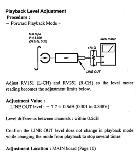

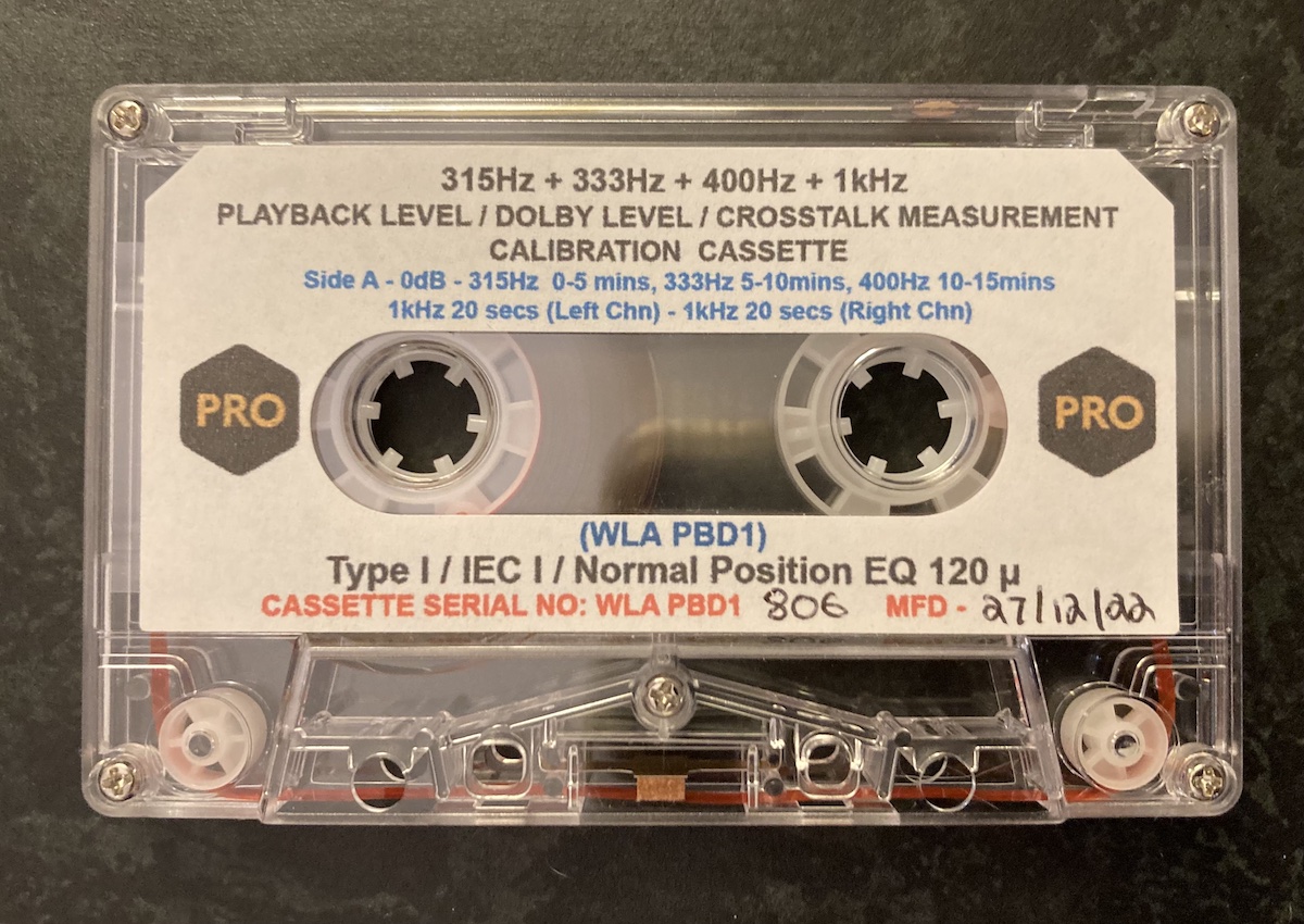

    Hey Valentin, I have been following this excellent tutorial in order to tune up a Sony KA1ESA deck, which has a similar mechanism and electronics to the K411.
    To set the playback levels, I'm using a Dolby level tape (see image) that I believe you had recommended in another thread. Loaded with a 47k resistor, I was able to get .42V on the digital oscilloscope, but the left tuning pot on the deck was at the very limit of its range in order to reach that.
    The resulting sound is good, but I am noticing that the level meters on the deck show the signal to be several dB hotter than they appear on my D6 (which I recorded the music on).

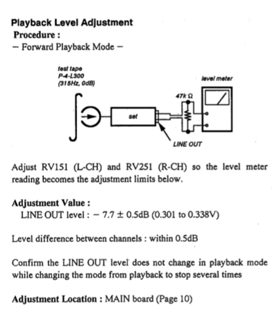

    The service manual for the KA1ESA states a Line Out level of -7.7dB for Level Adjustment. Is that essentially 0dB with the 47k load? And the 0dB 315hz tone on the Dolby tape should translate to 421mV, same as your K411 example?

    Fact you need to turn the trimpots close to the max setting to get the desired value indicates something is wrong.
    There are a couple of things that can be wrong including: line amp level dropping too much when loaded, incorrect line amp gain or even an error in the service manual (which seems unlikely in this case, but possible).
    As far as that WLA-PBD1 tape goes, would no longer recommend it since the one I used had some imbalance between the L and R levels. Besides, this tape is no longer made.
    HPR tapes are a better choice, the 218nWb/m (position 5 on the list): https://www.ebay.com/itm/176013927759
    These tapes are DIN, so the 218nWb/m DIN corresponds with 200nWb/m ANSI.
    What I would do in this case is measure the level at the output of Dolby IC to eliminate some of the potential problems mentioned.
    Levels at the IC should be 388mV RMS at RECORD OUT pins.

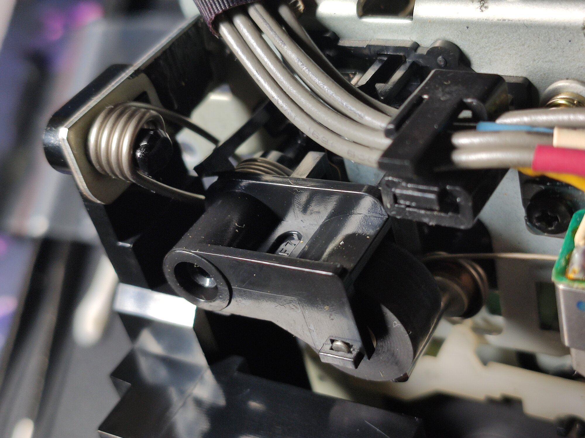

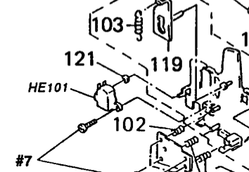

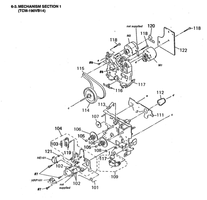

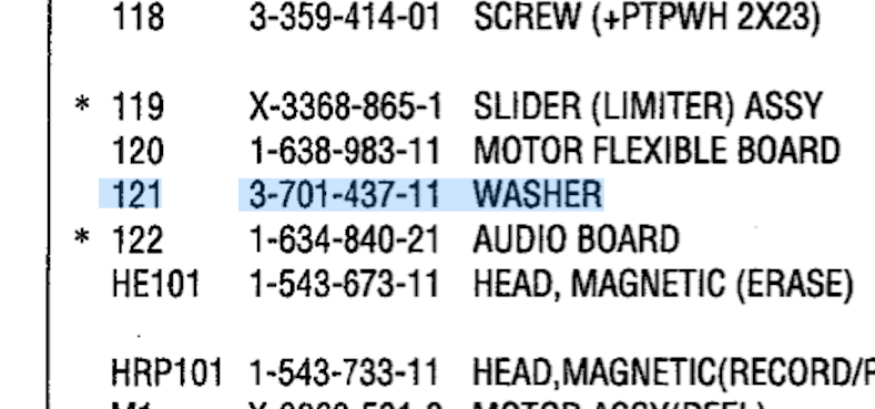

    Also, unfortunately I found a small plastic washer (clear, slightly pink color) after I had reassembled the tape mechanism and have no idea where it came from. It is not the capstan washer (which is installed) and the only other washer on the mechanism is indicated as Part 121, the same in the TC-K411. I can't quite make out where the SM is indicating that this washer goes - have you any idea?
    Screen Shot 2025-06-28 at 11.30.54 PM.png Screen Shot 2025-06-28 at 11.31.34 PM.png Screen Shot 2025-06-30 at 11.57.20 PM.png
  10. Valentin
    1,985

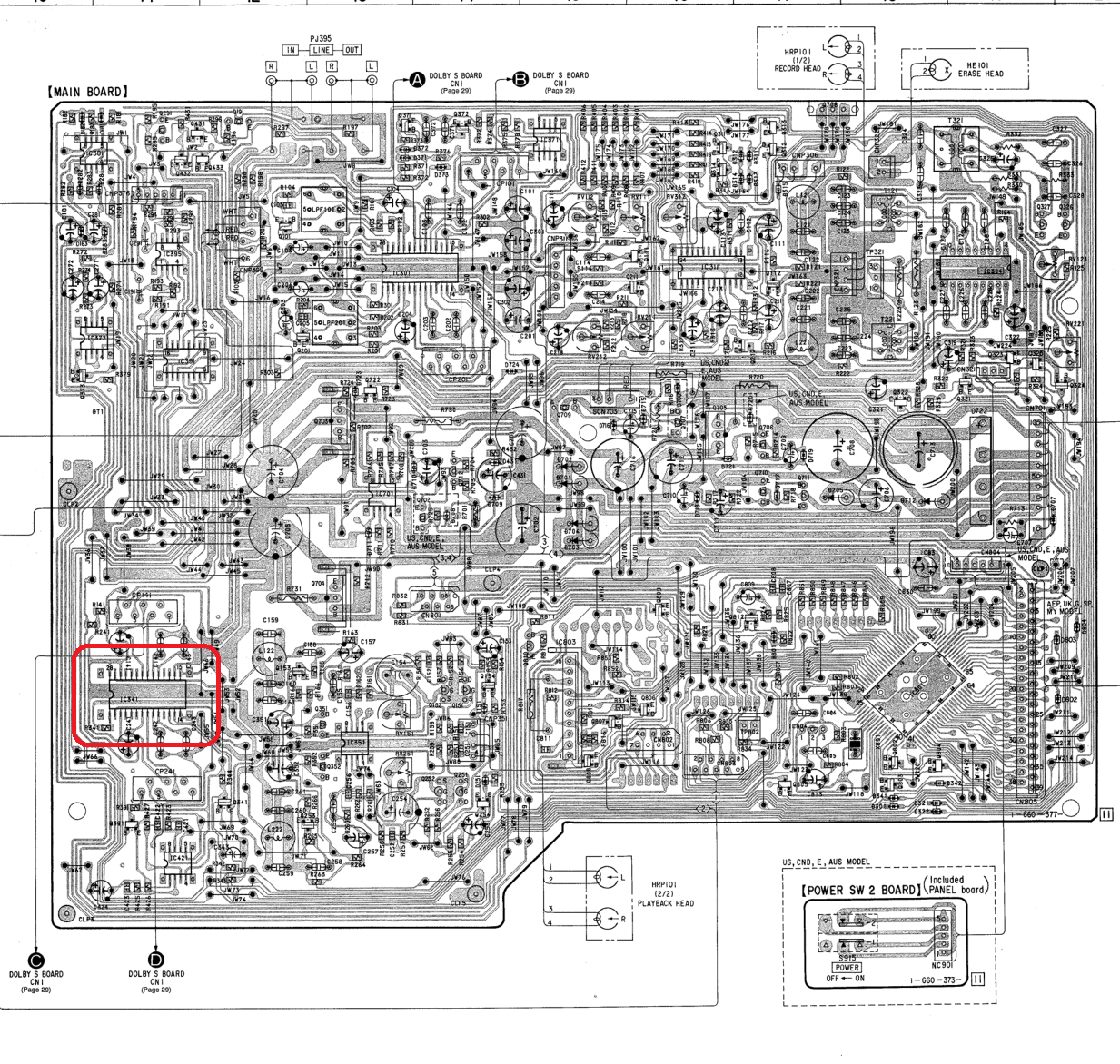

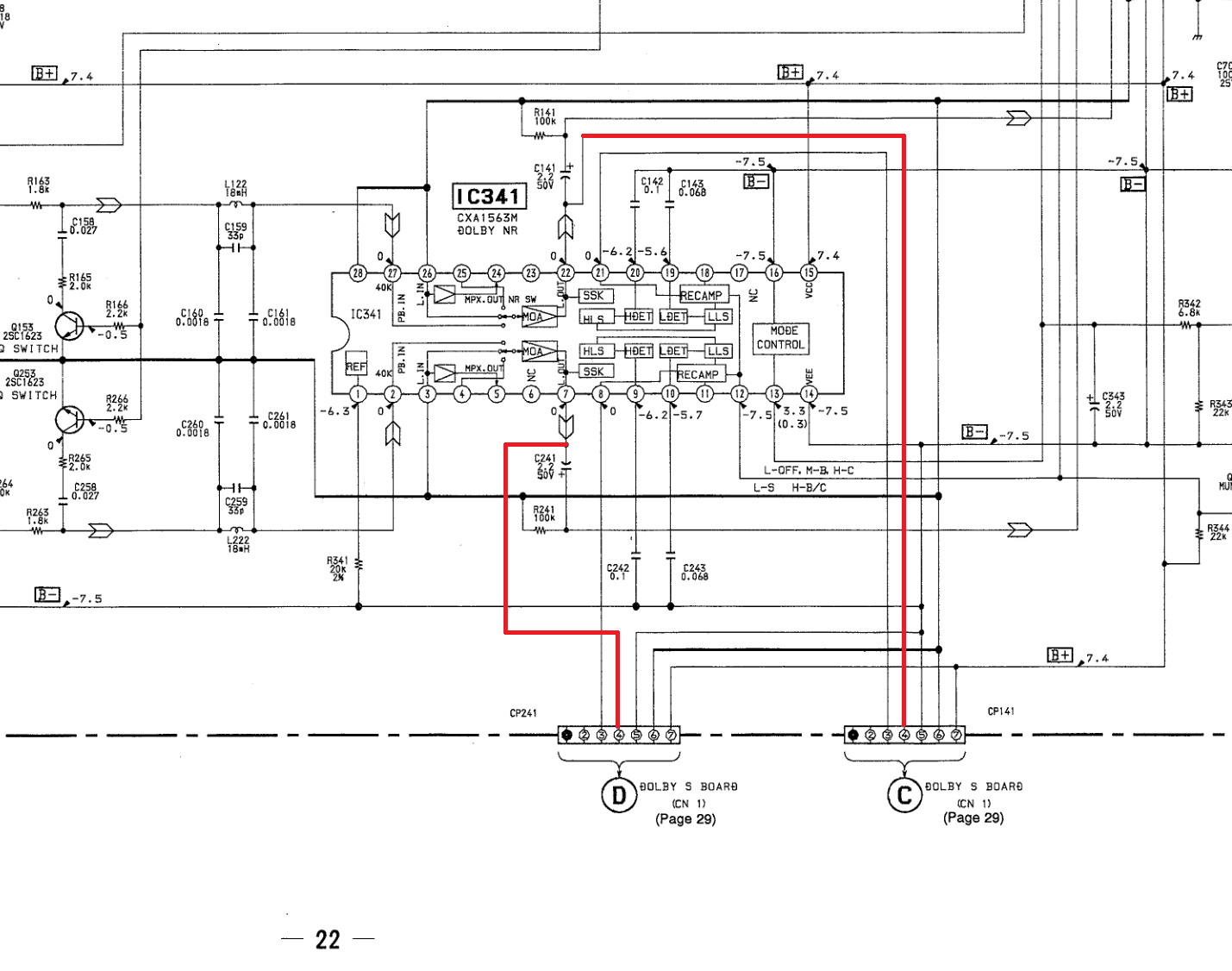

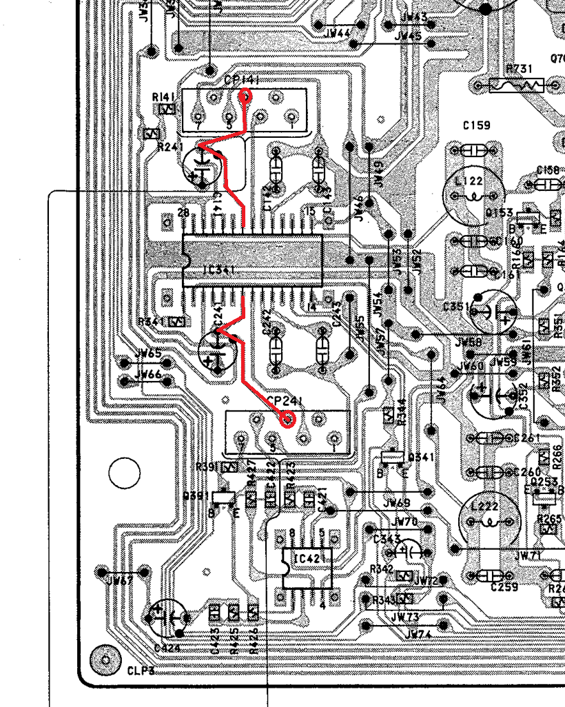

    Part 121 looks like a shim to adjust erase head height or a cable holder. Would assume you didn't remove the erase head, so your washer is likely coming from somewhere else.
    As far as the adjustment goes, measurement is done at pins 22 and 7 of IC341, which I realise in on back of the board SMD.
    However the output of this goes to pin4 of the Dolby S daugter boards, so you can measure there instead. See pictures attached.

    No, didn’t touch the erase head, so quite confused about where this washer came from. I did pull out a bag of spare parts I have from an old disassembled deck to replace one of the leaf switches on the KA1ESA - right before I found the washer - so there’s a chance it came from there. I still don’t see what Part 121 is meant to be though.
    Thank you for the detailed indication on taking the reading from the Dolby chip. My service manual is a black and white copy, so hard to read what is top and underside of board! I will check that with the Dolby tape.
  12. C83
    C83 Member
    42
    NY

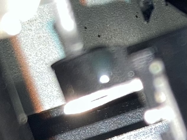

    Ok, i see this now. Rather hard to photograph, but the washer behind the erase head is clearly in place.

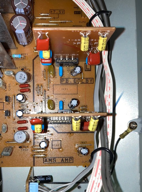

    Hey Valentin, so, as you kindly advised, I tried measuring off pin 4 on the Dolby S daughter boards while playing the WLA-PBD1 Dolby cassette. I was getting crazy VRMS readings on the little digital oscilloscope I have: like 7.4V RMS on each of the channels. I adjusted the Playback pots and got that down to around 3.24V, before realizing that was still x10 times too high for the target of 324mV!
    I have a Fluke multimeter that is non-RMS, but that has a mV range, so thought I would try that: it actually gave readings close to 324mV directly off the Dolby chips with nothing plugged in to the line out on the cassette deck. And interestingly, the meters on the front of the deck showed the channels right at the Dolby mark on the VU when I had this 324mV reading with the multimeter. But when I play back a known good tape, the volume (and dB on the VU) are noticeably too low!
    I can wait to troubleshoot further when I get the HPR calibration tapes. And in the meantime, I'll take a look at the oscilloscope and double check it is calibrated correctly. Thank you again.

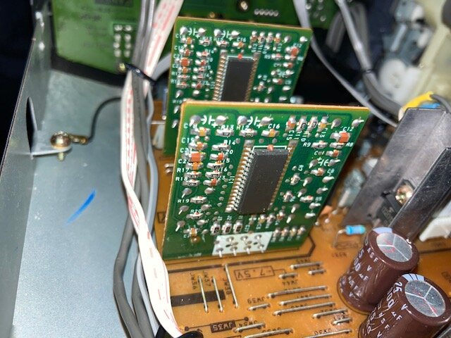

    Just posting a belated follow up on the calibration of my KA1ESA (cousin of the K411).
    Starting over with the Hans Peter Roth Dolby Level tape and a remade 47k load cable, I have been able to achieve the target 437mV RMS on line out.
    Checking voltage on pin 4 of the Dolby S daughter boards (which receive the output of the main Dolby IC), I am getting readings of around 392mVRMS at the same adjustment settings.
    That’s higher than the 324mV that you had said to adjust for @Valentin , but looking at the data sheet for Dolby IC CXA1563M, which the KA1ESA uses, the test voltage is stated as 388mV (at the REC Out pins)*.
    The unit's VU meter now shows peaks much closer to those on my D6 for known good tapes, both chrome and normal tapes.
    Am I good with these levels, then, before proceeding to check bias and record settings?
    *(Note, the CXA1331S Dolby IC chip that the K411 uses also states to test for 388mV at REC Out pins.)
    Valentin likes this.

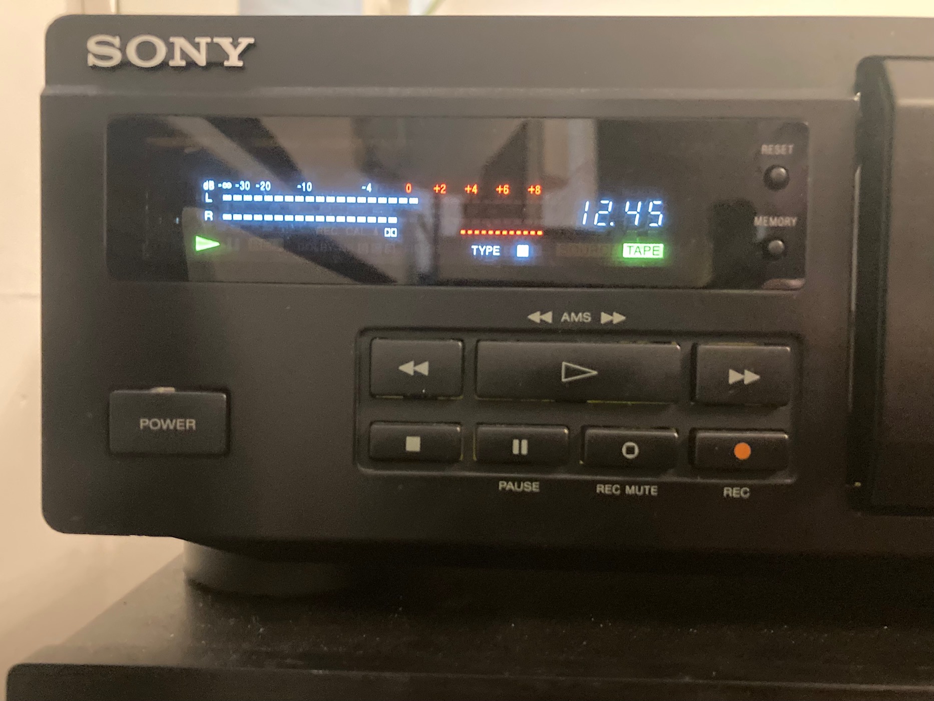

    One slight anomaly remaining on the Playback Level settings: when I set the voltages as described above, the VU meter on the deck displays a stronger left channel when playing back the Dolby Level tape, despite mV readings at line out and Dolby chip being equal left and right, see pic 1.
    That is when working with the deck disconnected from my receiver and speakers, and with no load at line out.
    However, when I reconnect the deck to the tape loop on my receiver and switch it on, the VU meter drops down in the left channel to read as balanced, left and right, as in the second image. Switch the receiver off again (or just turn off Tape-Monitor), and the VU channel imbalance returns.
    Voltage from Dolby chip remains the same, whether the deck is connected to the receiver or not.
    (Note, my receiver is a modern one: tape loop is not in-circuit when the receiver is switched off.)
  19. Valentin
    1,985
    As long as the voltages at the Dolby chip don't change, you're fine as far as the Dolby decoding goes.
    Read the Dolby IC datasheet myself, will correct the values stated at post #7. There are likely errors in the manual.
    It's the datasheet IC that is the most reliable source of information.
    As for line out, the M5218 op-amp has a pretty high output drive capability (can supply up to 50mA and has a slew rate of 3V/μs), so driving a 10kΩ line in shouldn't be a problem.
    As stated previously it's possible there's something wrong in the line amp circuit.
    C83 likes this.

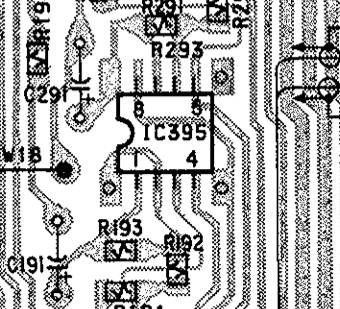

    Thank you Valentin. So that op-amp is IC395, is that correct, close to the line outs? It's a M5218AFP, and seems to be plentiful available online. But again, it is surface mounted on the underside of the main board on the KA1ESA, so getting at that to change it will be a challenge.
