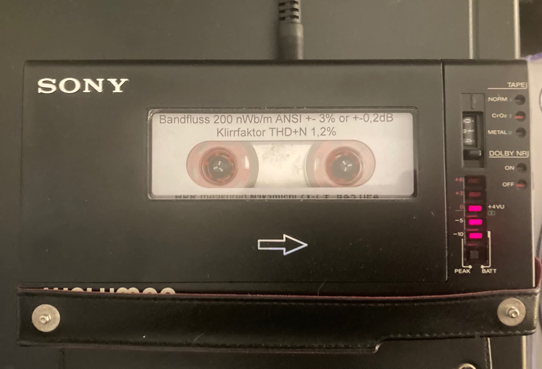

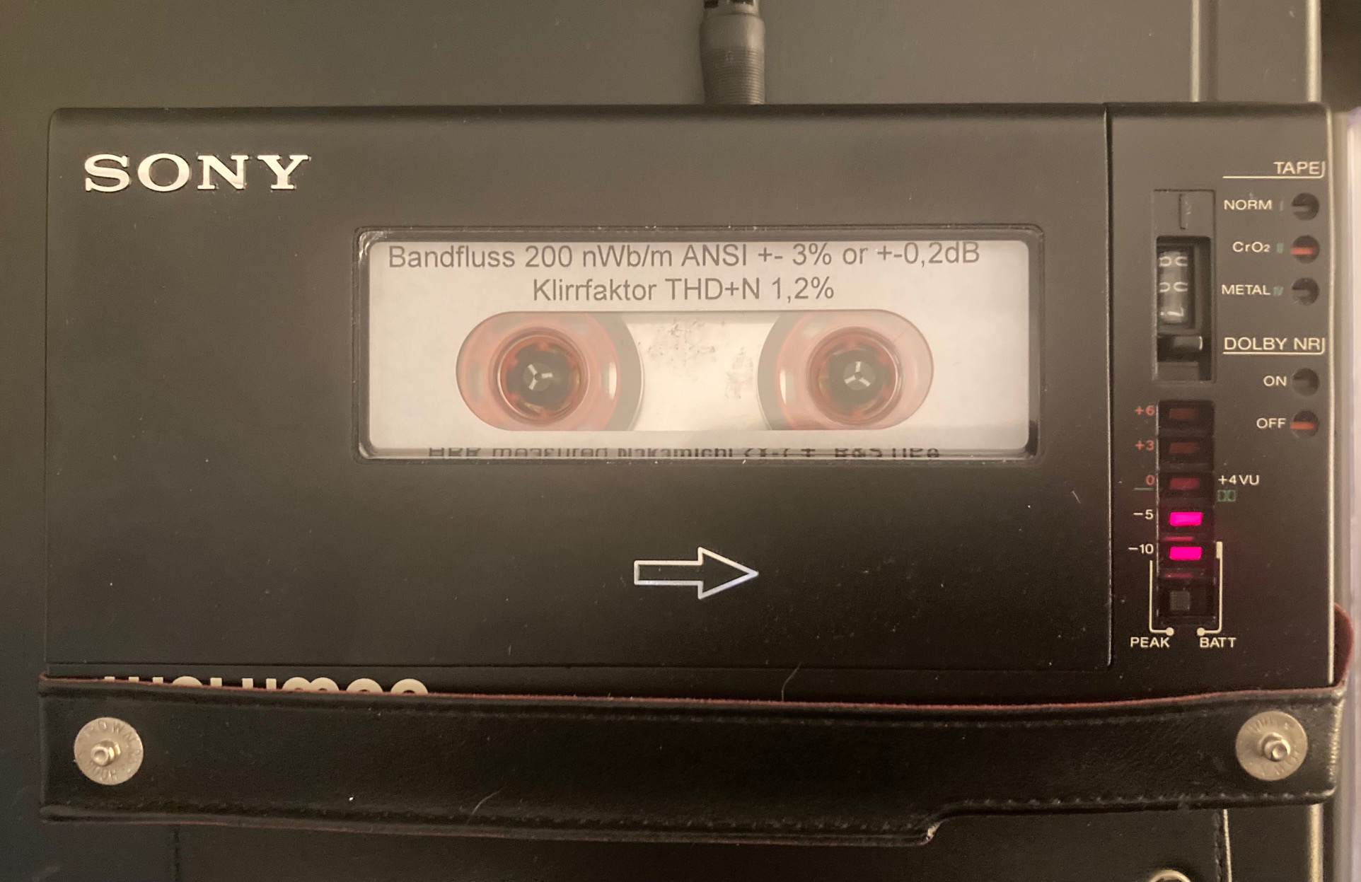

    Before doing that, though, I thought I would try the Dolby cassette in my D6—connected via the line out to my receiver tape-in. Guess what, the level meter drops a unit when the receiver is on, and jumps back up when receiver / tape loop is off, same as the KA1ESA...

    I haven’t had a chance to test the mV drop on output yet (need to customize a cable first). I had also read that dirty connectors and switches on the receiver can increase impedance, so I planned to pull that and clean it first. (I’ve also been having issues with the receiver briefly dropping signals - coax and HDMI - so another reason to clean connections first). I’ll try to get to that this weekend.
    But, yes, a channel imbalance was the original issue I was testing for. With the levels set correctly on the Dolby chip and line out on the KA1ESA, there is no audible channel imbalance, but as noted in post #18 above, the VU meters show a left channel imbalance with the deck disconnected from the receiver; but when I hook up the deck to the receiver, that VU imbalance resolves. It’s a head scratcher for sure.

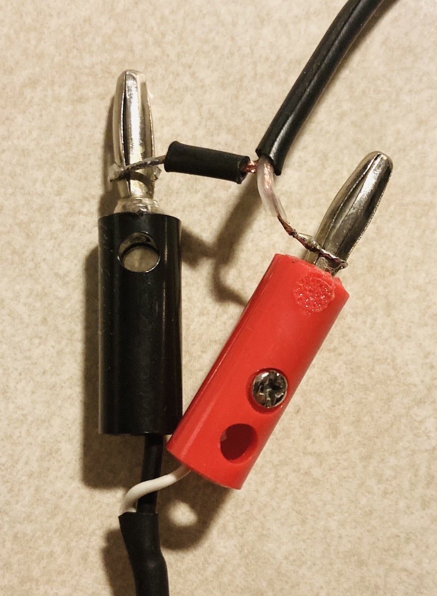

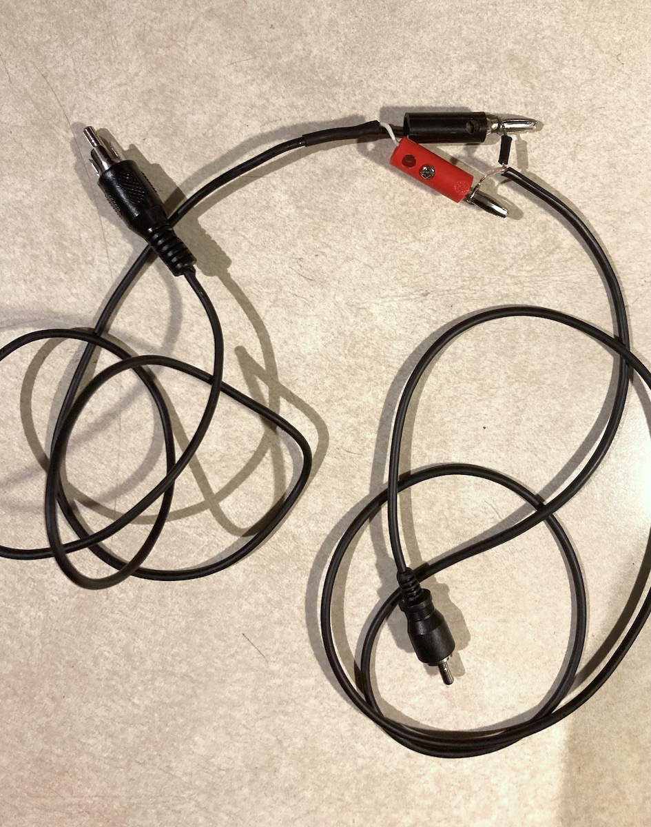

    Following up on the levels measurement on my KA1ESA. After giving all the inputs and switches a clean on my receiver, I made a testing cable to measure voltage drop on line out from the deck when connected to receiver tape loop (see pics).
    First of all, checked the playback levels on the deck again and confirmed:
    Levels on Dolby chip = 388mV
    Levels on line out (with 47k load, unconnected to receiver) = 432 mV
    Then, using the testing cable pictured, measured level at line out connected to receiver's tape loop (no load):
    With receiver off = 430 mV
    With receiver on = 390 mV
    So, a voltage drop of 40 mV
    VU meters still behaving same as in post #18 above...
