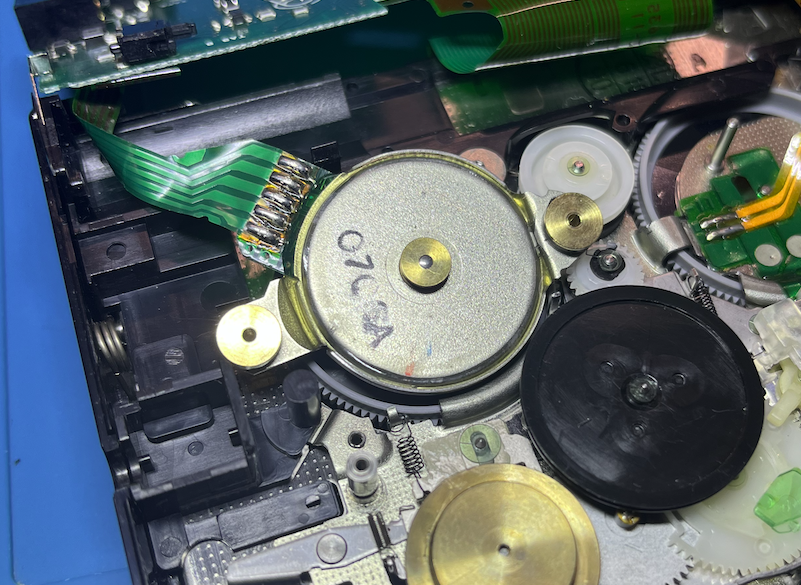

    Does anyone know where I can find a replacement motor for the Sony TCM-77V? I believe the TCM-77 uses the same one. I’m also open to alternative motors that would work, even if they’re not the original part.
    According to the service manual, the motor details are:
    M901 - 1-541-716-11 (NBL-122)
    Here’s a picture:

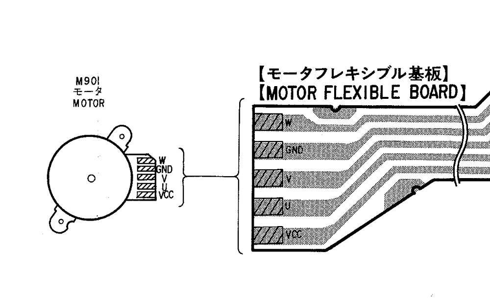

    And the pinout from the service manual:
    I measured the voltage between GND and VCC, and I’m getting 3.2V, but the motor isn’t running. So I’m guessing it needs to be replaced.
    Any help would be greatly appreciated!

    Apart from Vcc, you need the drive signals for the 3 phases U, V, W. It's a 3-phase brushless motor, not DC motor.
    So just because you have Vcc and motor does not run doesn't necessarily mean the motor is faulty.

    Yes, it does rotate freely when I move it with my fingers.
    Measuring the voltage on U, V, and W against GND gives me 3.2V.
    Also I've desoldered the motor and measured resistance between GND and any of the other pins and it reads open circuit. I would expect to get a some resistance reading right?

    Yes, you should have a low resistance between U, V, W and ground, something like 1.5Ω.
    But this is assuming those pads go directly to the coils, which I'm not sure is the case here. Given the additional Vcc pin, it's possible there's some electronic circuit inside the motor.
    This particular motor design I haven't seen before and did open many similar looking motors.
    The DC voltages at U, V, W will be similar to Vcc (a bit lower usually). But for proper insight you need to see the waveform (and need oscilloscope for that).
