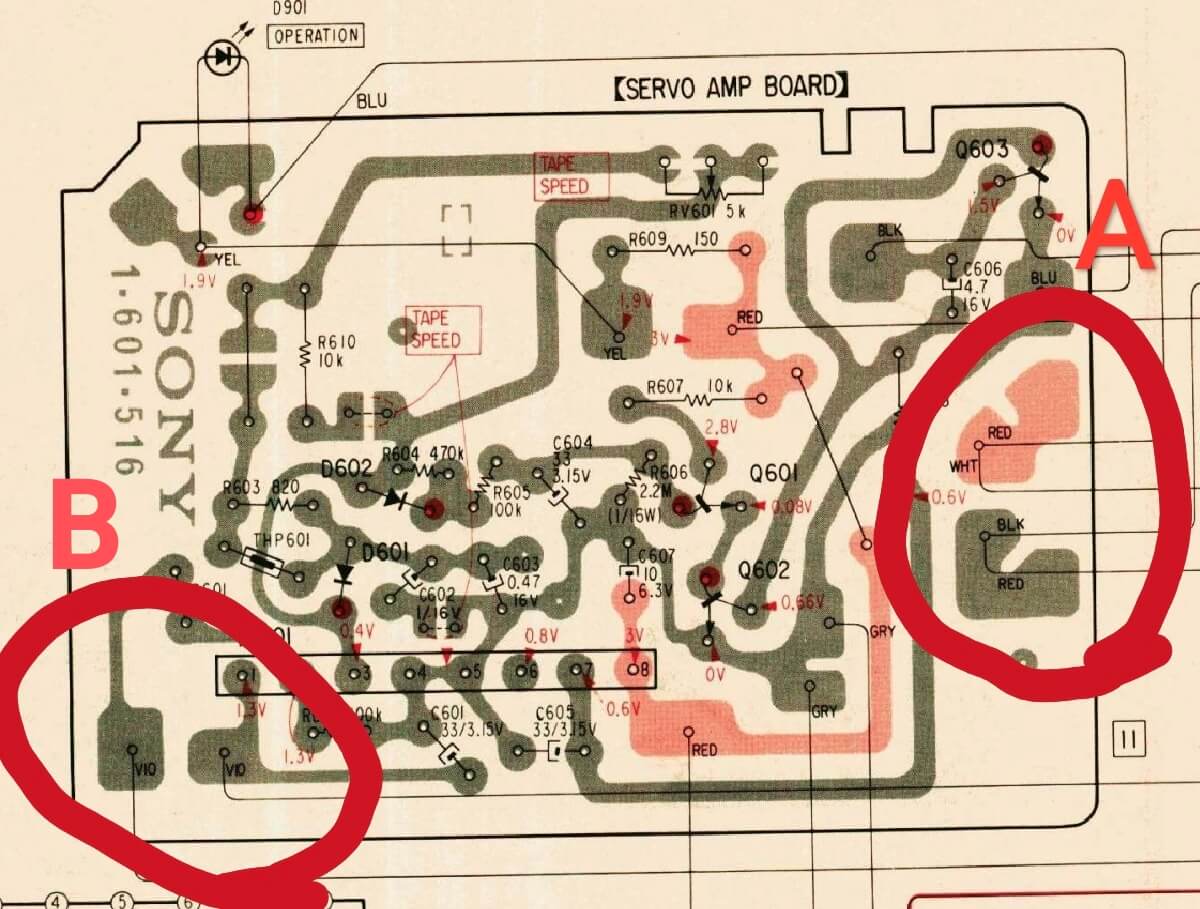

    Hi, I’ve been trying to repair a Sony Walkman TPS-L2 for a while. It arrived with a stuck motor and worn-out belts. I managed to free the motor using some watch oil and replaced the belts. Now the motor runs, but the Walkman stops after a short while. My hypothesis is that it’s an issue with the speed adjustment on the SERVO AMP BOARD. Here are my observations:
    During playback, the sound runs fast.
    The motor stops even when the belt is removed.
    If I wait a bit, the motor stays on longer (~5s); if I apply power again, it shuts off almost immediately.
    As shown in the photo, at point A I have 2.7V when powered on, and at B 1.4V. When off, B goes down to 0.5V and continues to drop (capacitor discharging).
    From these observations, I rule out the mechanical part since it stops even without the belt. I suspect it might be a capacitor issue, which could explain why letting it sit for a while (allowing the capacitor to discharge) lets it run longer — probably by opening the circuit on the transistor, I imagine. I might be on the right track, but I’m not 100% sure about this hypothesis.

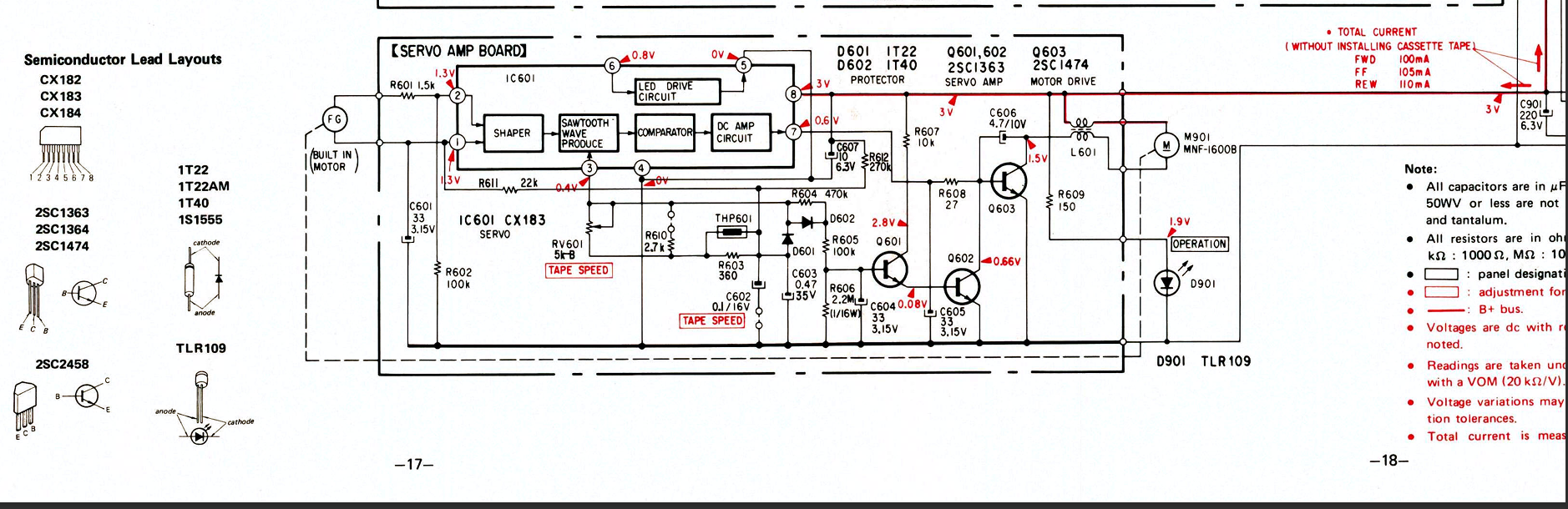

    check if you have these voltages marked in red
  3. Lorenzo B.
    Lorenzo B. New Member
    7
    Italia
    Ok, I did a check and indeed pin 3 outputs 2.7V instead of 0.4 (pin 2 also has a different value, but it’s correct when the motor is running). I also checked the whole part of the circuit around pin 3 and everything seems fine. At Q601 I’m getting wrong voltages at its terminals, but I think that’s due to the output voltage from pin 3
