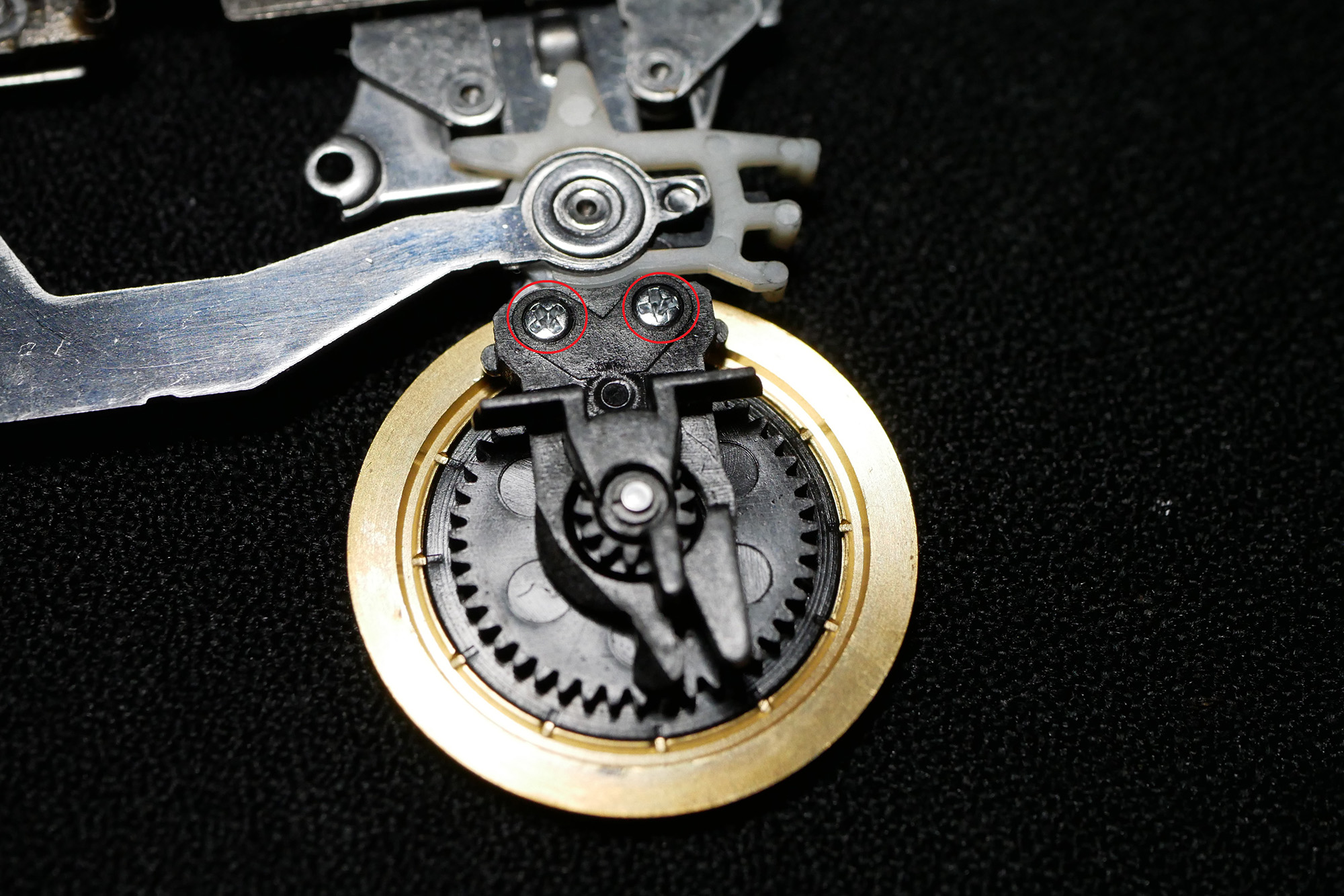

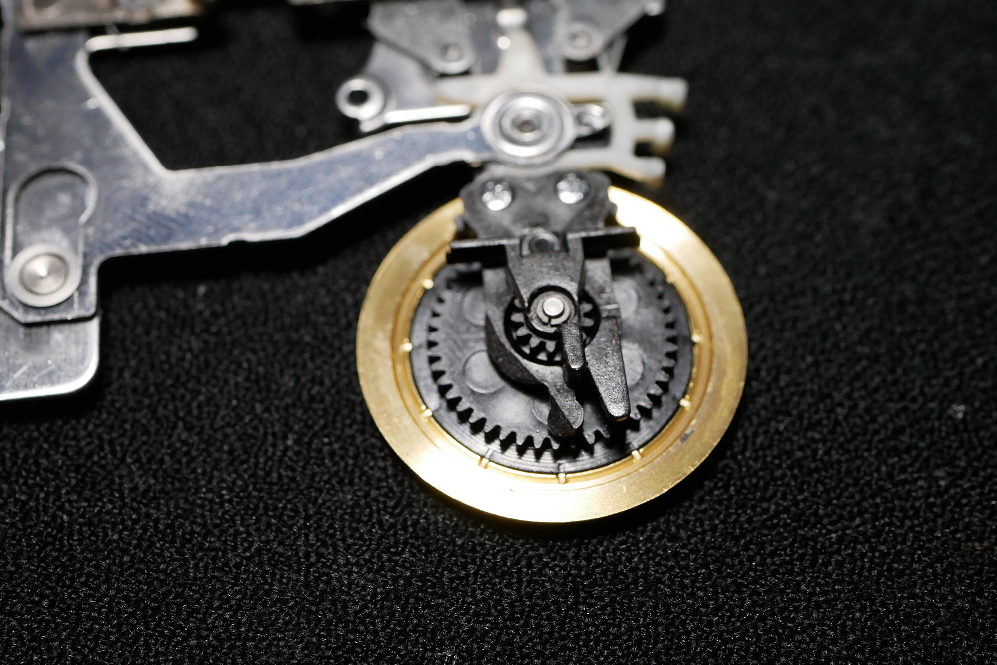

    This tutorial covers the adjustment of middle pulley in WM-10/20/30/WM-W800 mechanism.
    In these mechanisms the middle pulley sits at an angle when the belt is tensioned, causing very little clearance between the gear attached to the pulley and small reel drive gears.
    This can cause all sorts of problems ranging from grinding noise while running to very high W&F figures and even gear wear.
    That's why it's highly recommended to adress this design flaw when this walkman is serviced.
    It's an even better opportunity if the walkman is going to be disassembled to replace the table reel gear(s).

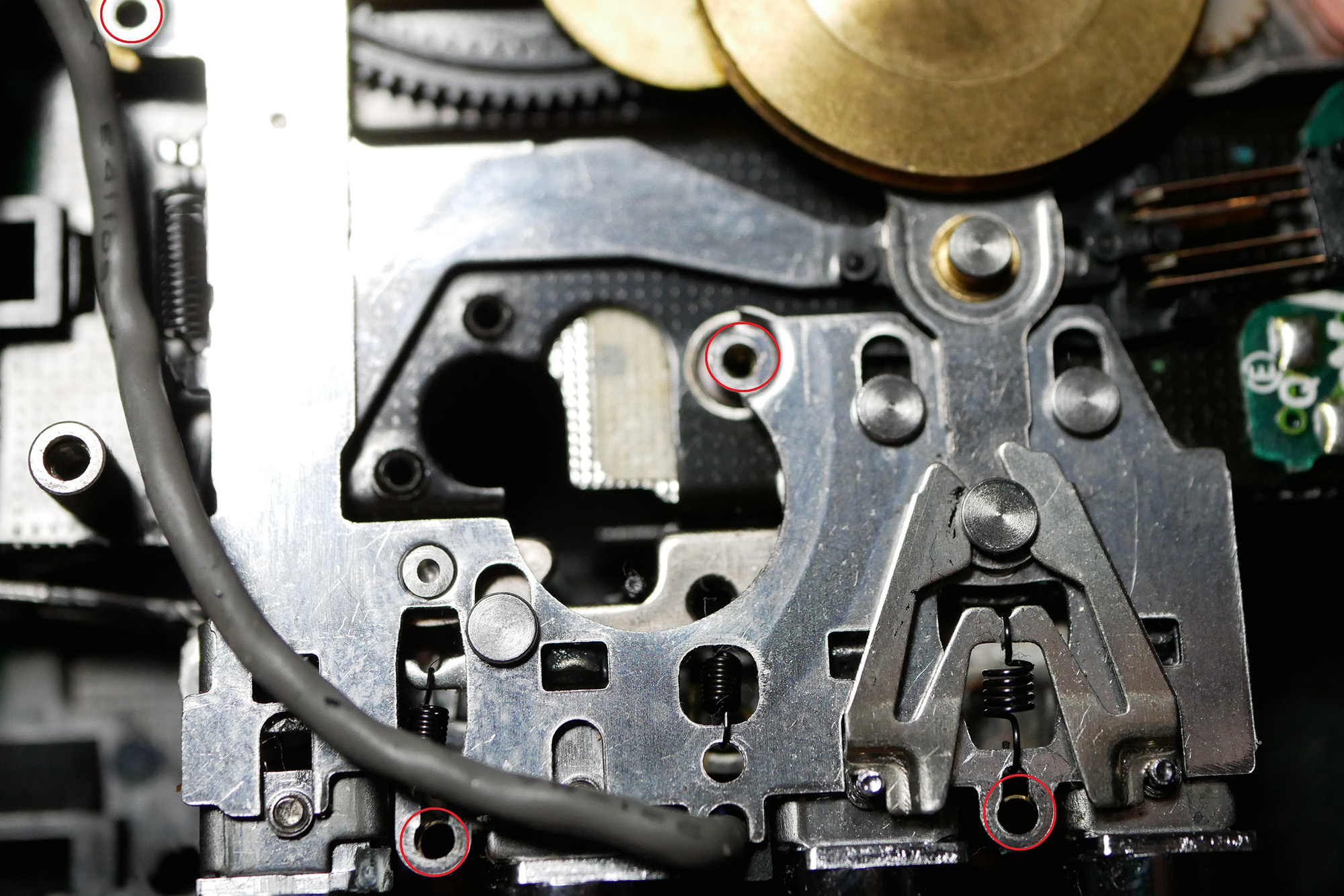

    Procedure goes as follows:
    1. Remove the back cover and belt.
    2. Remove the capstan retainer and flywheel/capstan assy. Note there is a washer either stuck on the capstan or on the bushing. If it's stuck to the bushing, remove it and put on the castpan instead.
    3. Remove the casptan bearing retainer (2 screws).

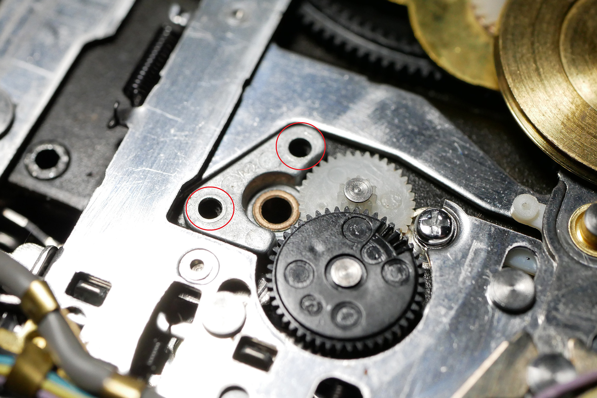

    4. Remove the buttons assy (4 screws- 2 long, 2 short).
    5. Remove the pulley assy from button assy (2 screws).

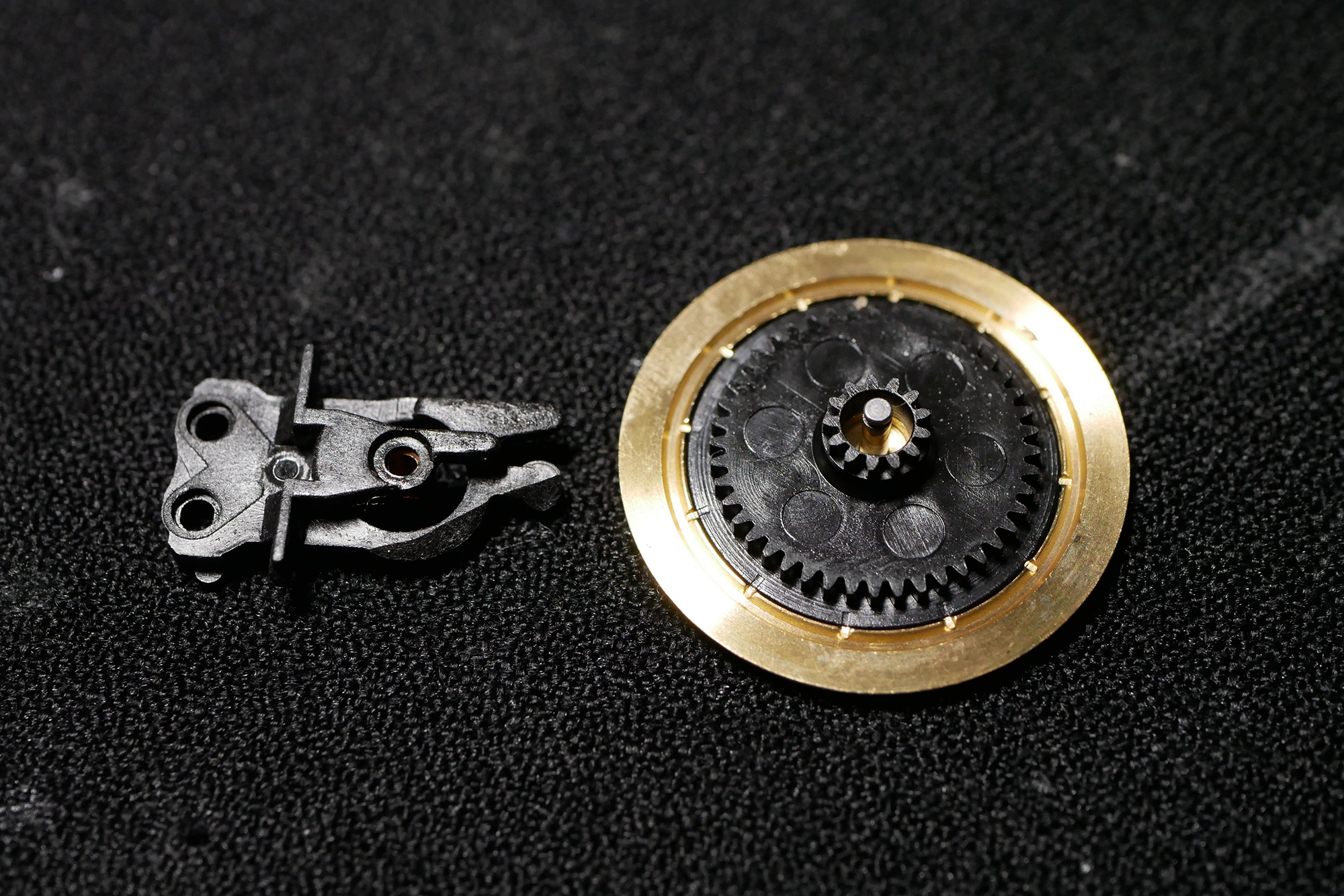

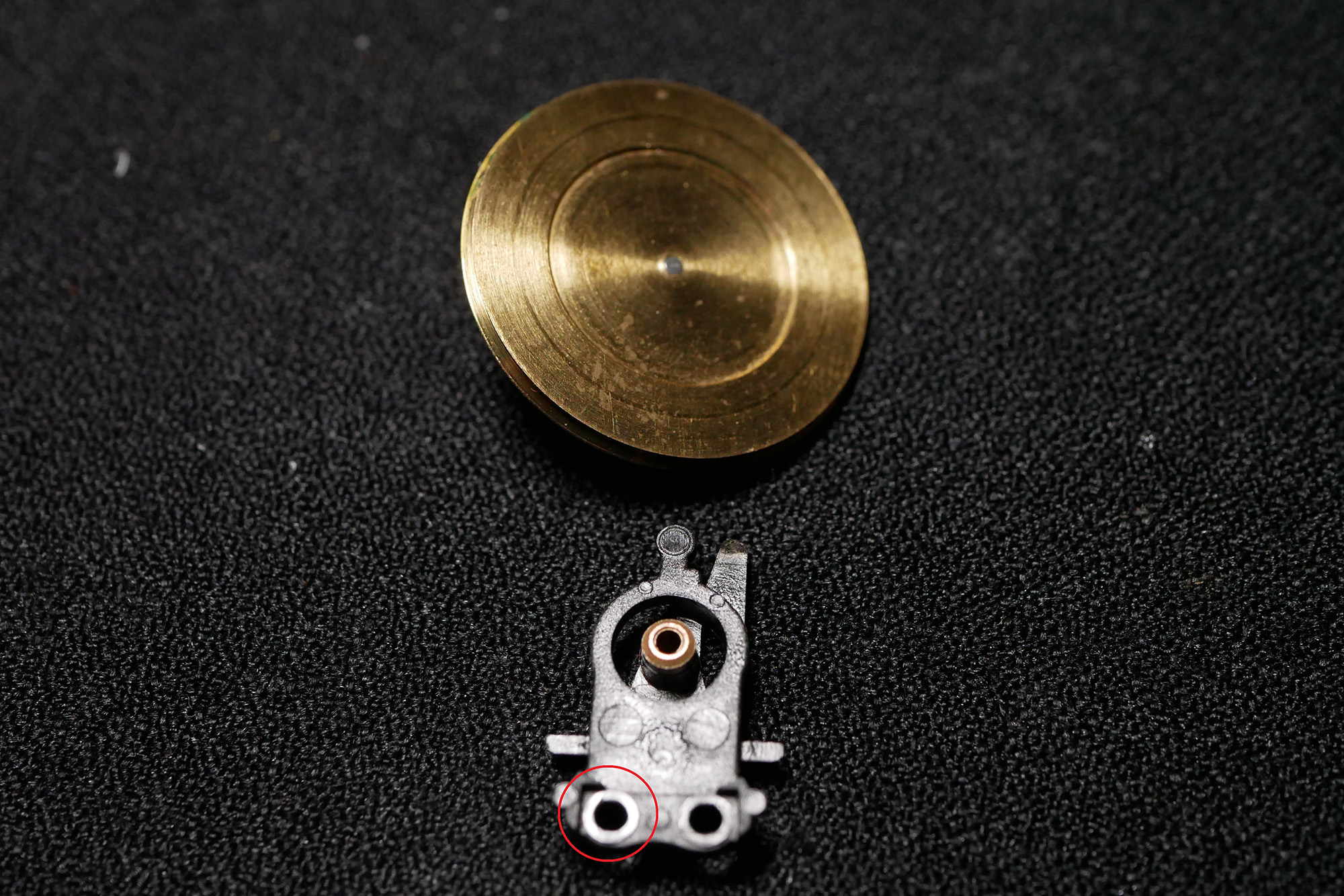

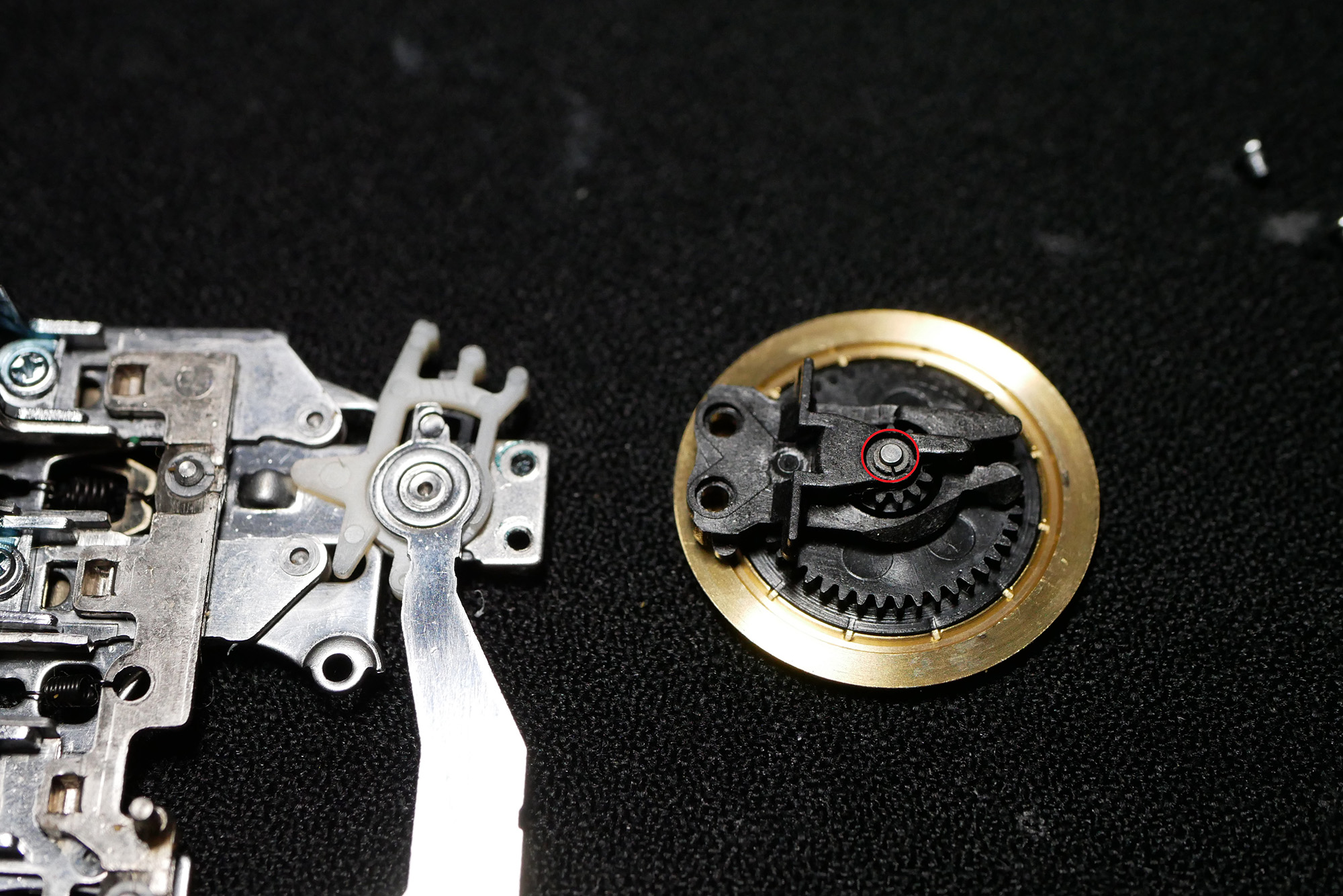

    6. Remove the pulley from its bracket. Pay careful attention to the split washer, it's a very small one.

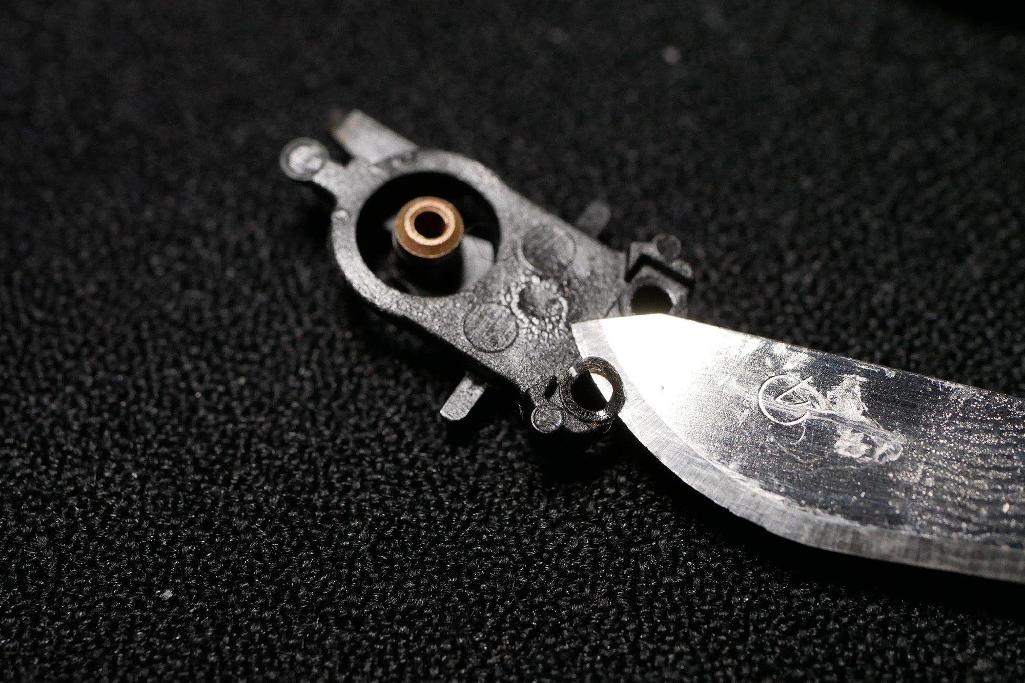

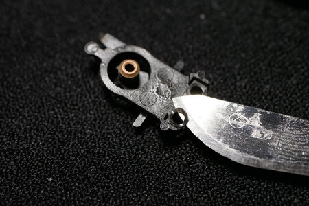

    7. Cut the left post as show in the picture.
    8. Bend the plate that holds the pulley in the vertical direction, opposite to the belt tension as shown in last picture.
    9. Oil the pulley bushing and re-install the pulley back to its arm.
    If any of the table reel gears need to be replaced, now is the moment to do so.
    10. Re-install the buttons assy, add grease to the pulley arm slider.
    11. Oil the capstan bearings (there are 2) and re-install the capstan/flywheel assy.
    Bottom (main) bearing shouldn't be lubricated, rather oil the capstan instead to make less of a mess.
    12. Clean the capstan with IPA while rotating the flywheel to remove any remaining oil.
    13. Re-install belt and re-assembly the case.

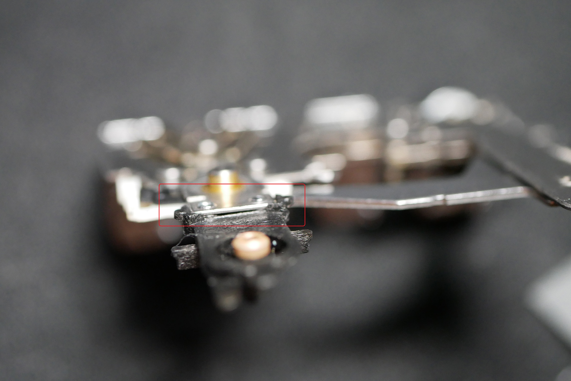

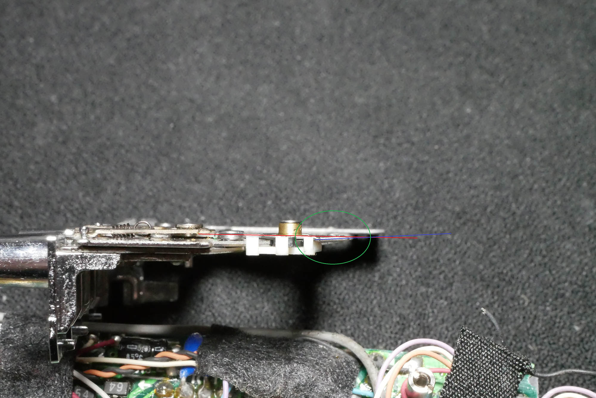

    I have this apart now while I'm waiting for my replacement uptake reel gear and was debating how to fix this:
    1) Add washer on the belt side of the pulley, or
    2) Trim the non belt side (what this post does).
    #1 is non destructive and also creates just the tiniest bit more clearance between the pulley and the back cover.
    #2 is probably easier to accomplish without having to source a small wash and possibly a longer screw?
    I had one of these back in 1983 and by 1984 this was already an issue. If you pressed on the back cover, the pulley would rub causing tape speed distortion. It has no doubt gotten worse with time. This and the shrinking uptake reel gear seems to be the two design flaws on this unit. Not sure why the rewind gear doesn't break as it's exactly the same.
  6. Alan Waterman
    Alan Waterman New Member
    Merced, CA
    radiorich likes this.
  7. Valentin
    1,985
    For lubrication use watch oil, the one in the link is fine. And where grease is needed (like the pulley arm) Molykote EM-30L.
    Yes, this is a design flaw which is made worse by wear. That pulley arm is thin and plastic, so it flexes under belt tension.
    Also the arm itself has some play both in the buttons assy and in the table reel assy, which will naturally make it sit on an angle when belt is tensioned.
    Solution is the one presented in the thread (#2) because adding washers will raise the gear too much creating poor engagement with the other gears.
    #1 is something I tried before and doesn't really work as expected, especially in FF/REW.
    Alan Waterman likes this.
  8. Alan Waterman
    Merced, CA
    Interesting. However, since, the gear assembly is attached underneath the arms, won't cutting part of the mounting post off raise the gear on that end, not lower it?
  9. Valentin
    1,985
    Yes it will raise the gear on that end, that's what we want in order to increase the clearance.
    In theory using a washer on opposite end should achieve a similar result if the thickness of the washer is adjusted correctly.
    However in practice it's hard to tune the thickness of the washer to exactly what is needed and such mod may also require a longer screw (as you already mentioned).
    From testing I've done this seems the simplest method to achieve the desired result.
    Ideal scenario would imply to machine the entire mounting post at a different angle (as the pulley angle is on 2 axis) , but that's easier said than done.
    So far, this is what worked best, that's why I posted it on the forum. If you find a better solution, please share it.

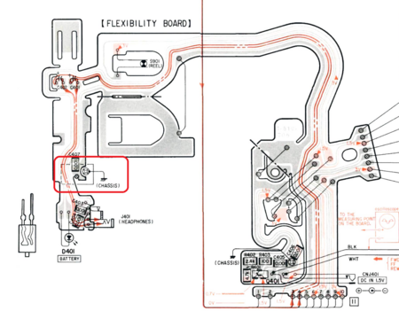

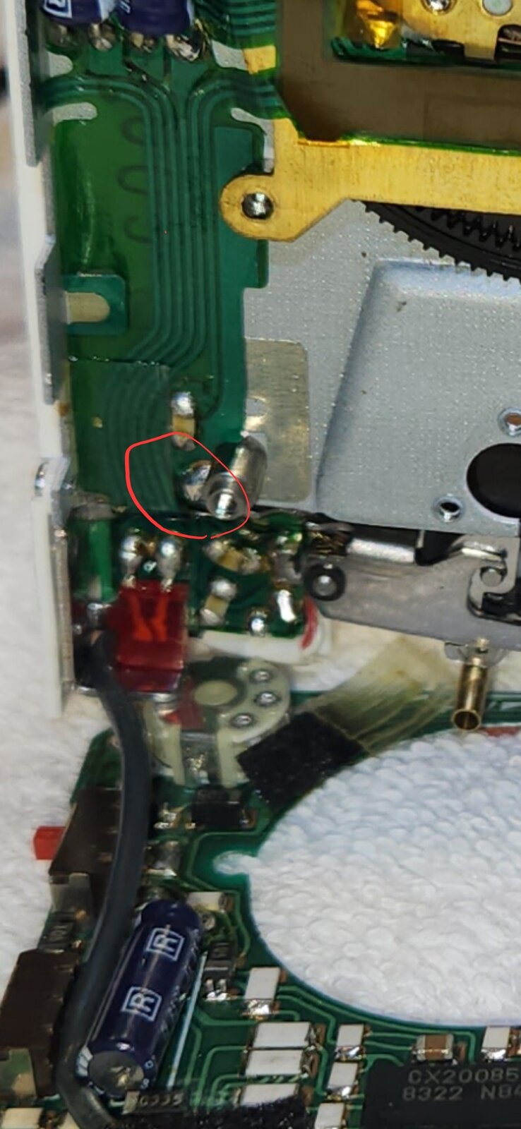

    When I was pulling the ribbon cable back, I think this solder point to the left of the pcb standoff was used to attach the ribbon cable to the chassis. It came off easily but it had that look underneath the cable that made it seem like it was soldered to the chassis at that point. I could be imagining it.
  11. Valentin
    1,985
    Yes that point needs to be connected to chassis.
    Also, as a sidenote, that part of the flex doesn't need to be removed to service the walkman.

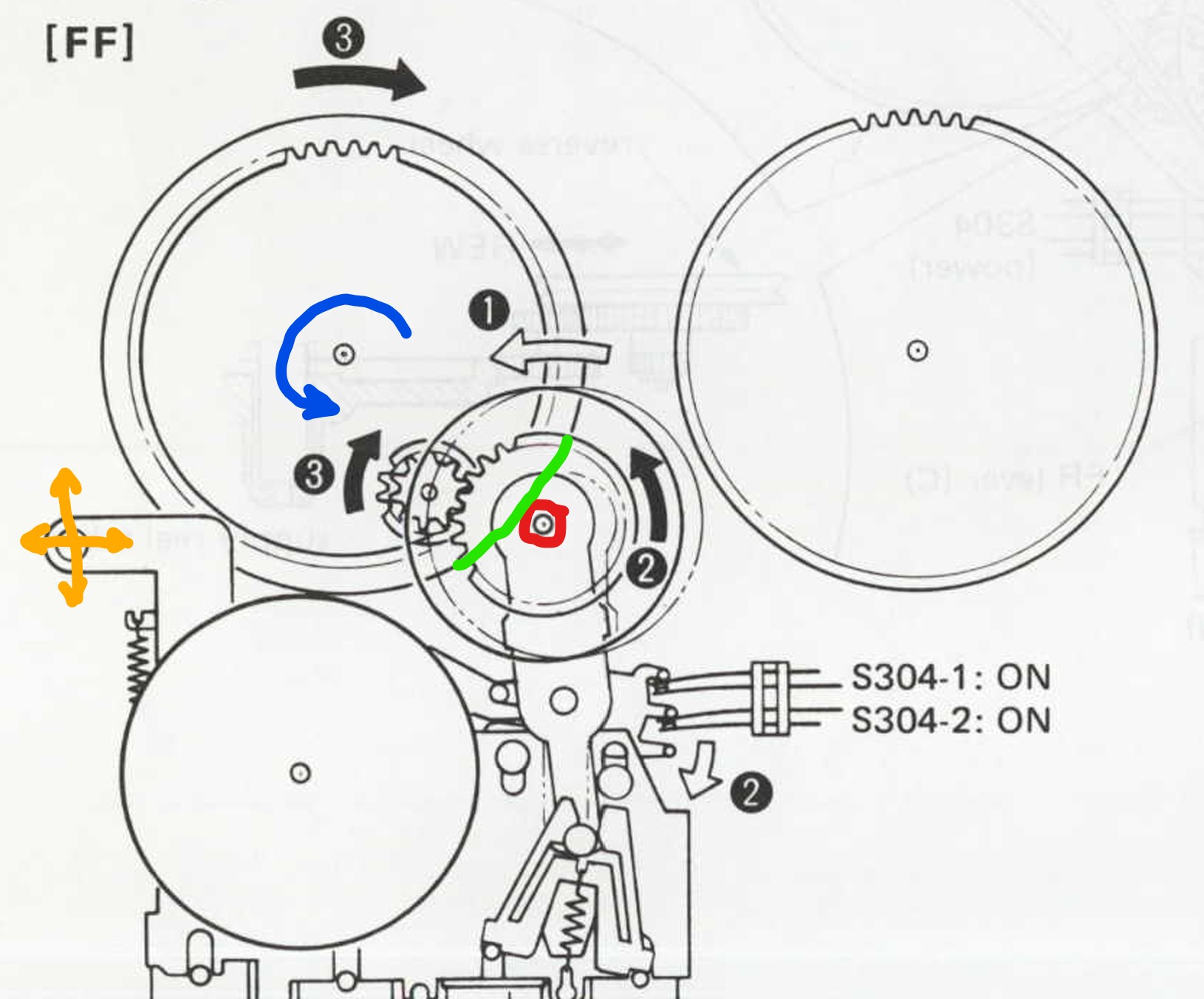

  12. Jehr
    Jehr Member
    74
    Canada

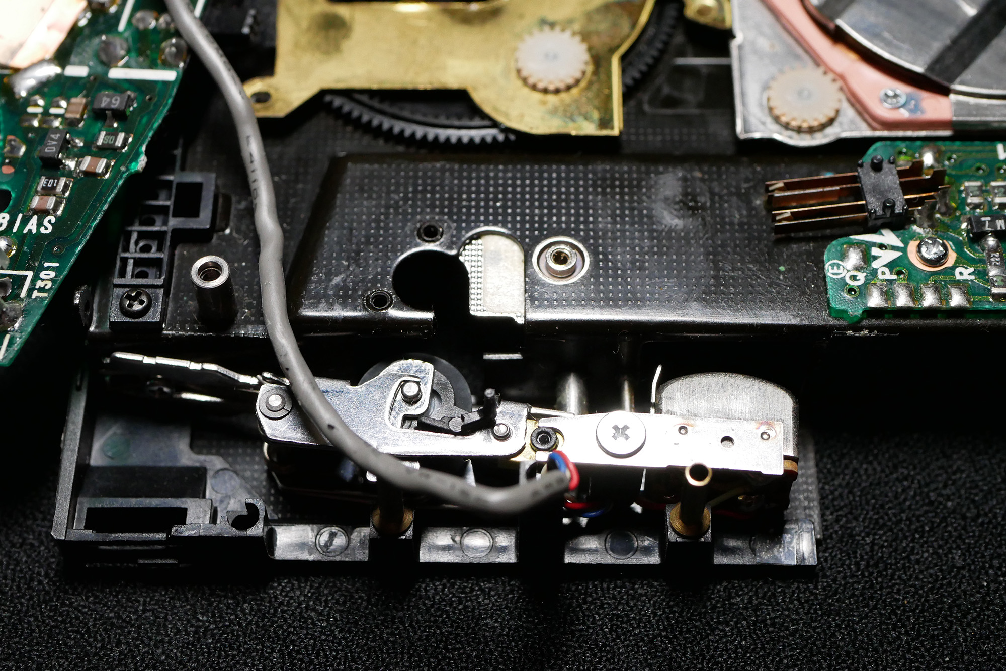

    Another observation regarding some rubbing/grinding in FF, is that the PLAY gear (green) is extremely close the the ring gear (red) and can actually touch when FF is engaged. You would think that the natural tilt of the middle gear would actually help prevent this but it doesn't really. I believe there is actually some level of deformation of the press-button bracket (after much use) or the whole brass assembly on this side has moved a bit (particularly if you have taken it apart). I have not found a perfect fix but there is a little play in both of these assemblies. It seems like you can rotate (not shift) the brass mount (blue) as much as possible to bring the small FF gear closer to the middle gear so it engages earlier. Playing a bit with the position marked in (orange) can also change of angle of engagement a bit. It doesn't take much as they can just barely rub and cause havoc in FF. The table reel may also not be perfectly round so it touches just a one point. Anyways, just thought I would share if you have a specific FF issue.
    Valentin likes this.

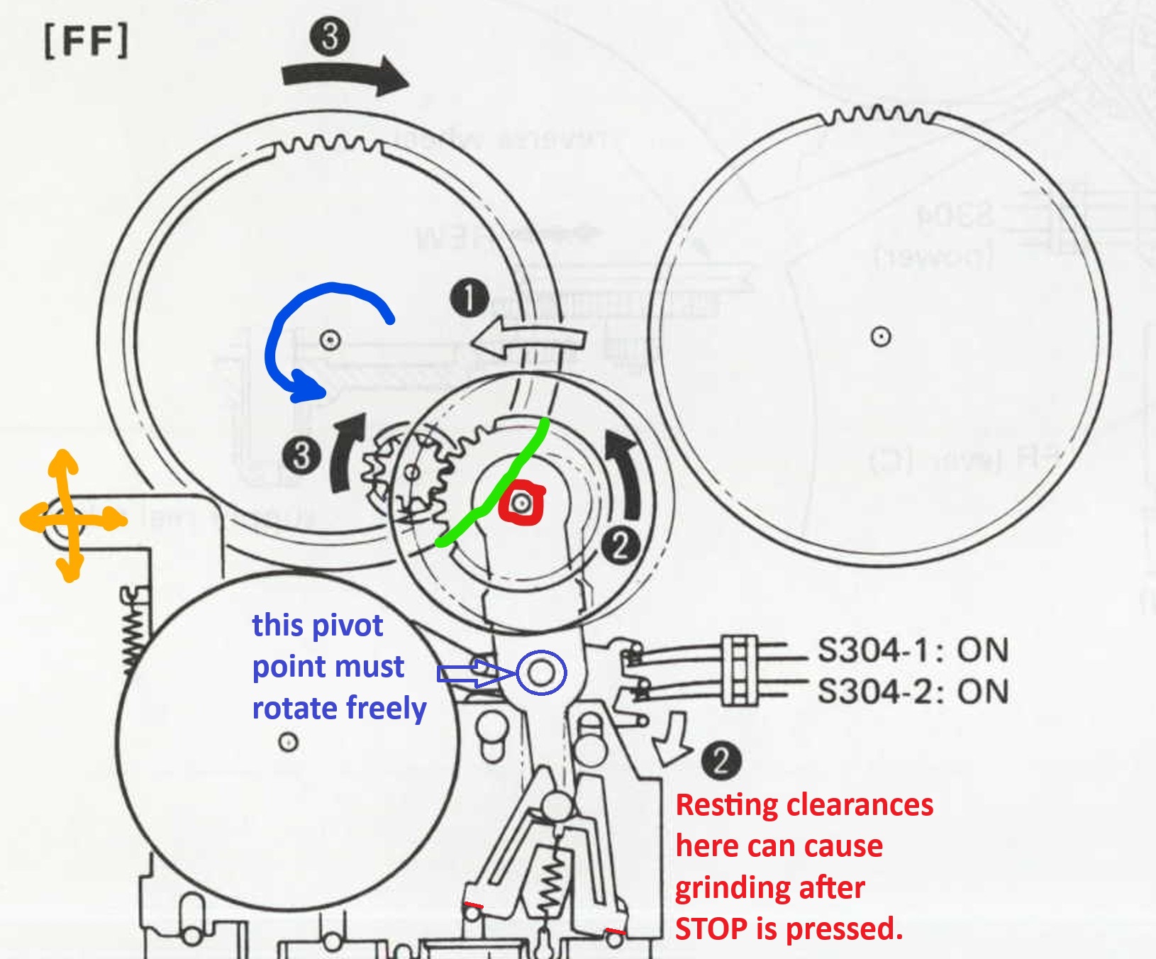

  13. Valentin
    1,985
    Table reels are not perfectly round (they have some up/down wobble at the edges), that is visible when you look at the metal part from the cassette compartment when runnning.
    Another thing I've seen is the pivot point of the middle pulley can move a bit hard in the sense it won't come back 100% in the same position after pressing STOP.
    This and some bends in the buttons mechanism probably caused grinding after STOP. Cleaning and re-lubricating the pivot point + adding a very thing tape at one of the red lines fixed the issue.
    There is a bit of a gamble also, as some allegedly work fine without doing anything. But in my experience most of them will have issues with this.
  14. Jehr
    Jehr Member
    74
    Canada
    Thanks Valentin, funny you say that about the middle gear not coming back enough. Same with the FF, when you initially press it, it can overextend, causing grinding and doesn not actually pull back enough, similar to your observation. When I have the mechanism out and fully lubed, it operates great (it pulls back no problem). Same when it is installed. However, when the PCB is put in, the engagement of the leaf switches causes enough torque/force to pull it down a bit and the gears can grind. Pretty crazy. Another risky move, but I bent the leaf switches a tiny bit to reduce the back pressure and it helped. Maybe a slightly stronger return spring on the PLAY mechanism could solve a couple of issues…
