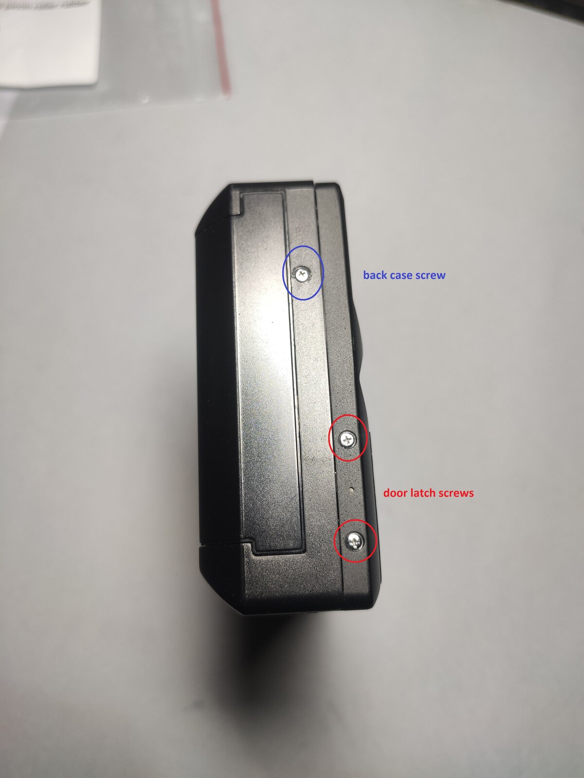

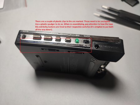

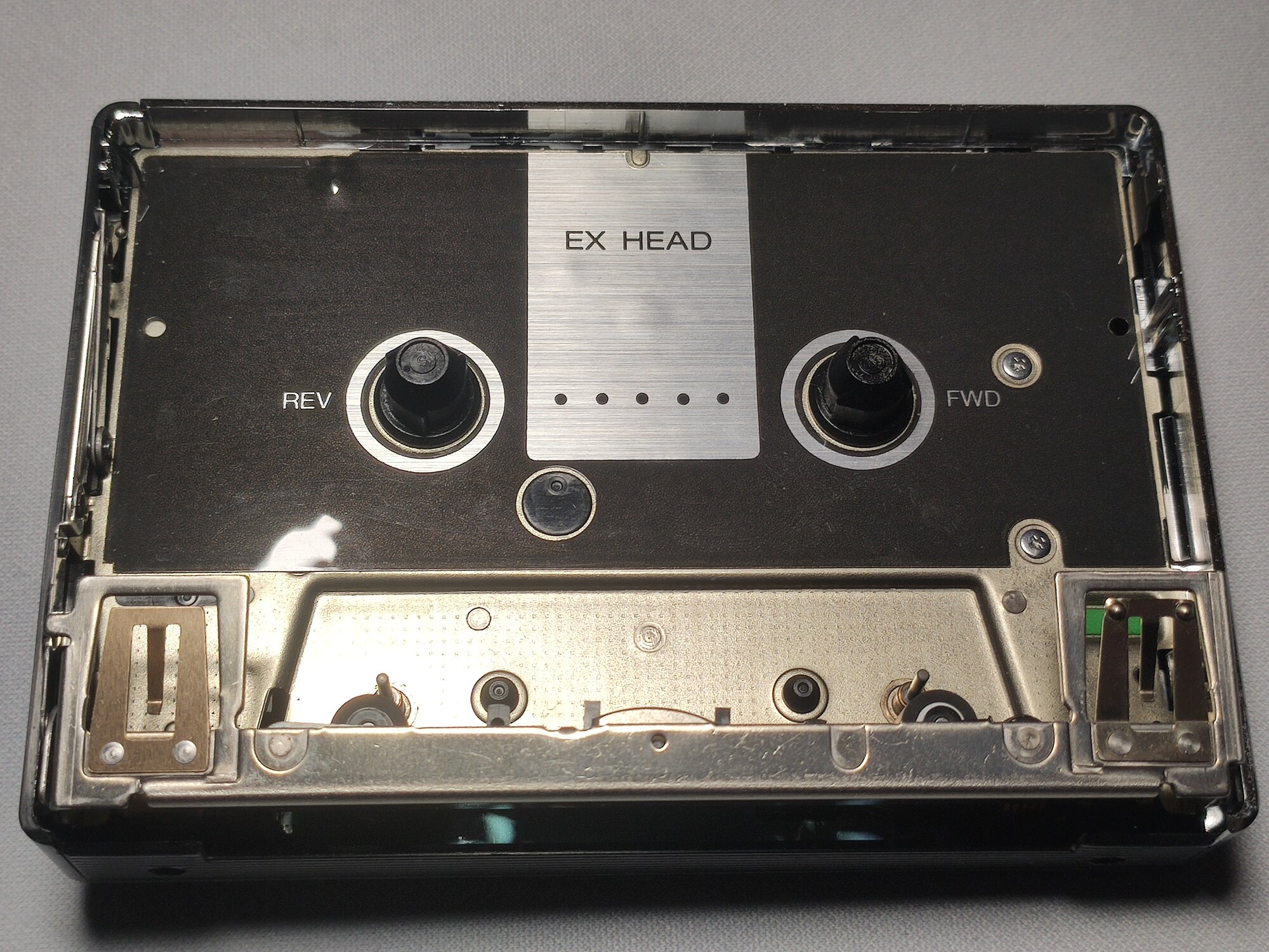

    PART1 (disassembly):

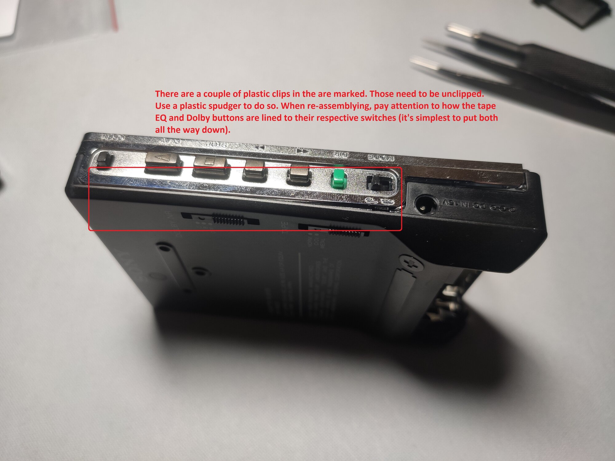

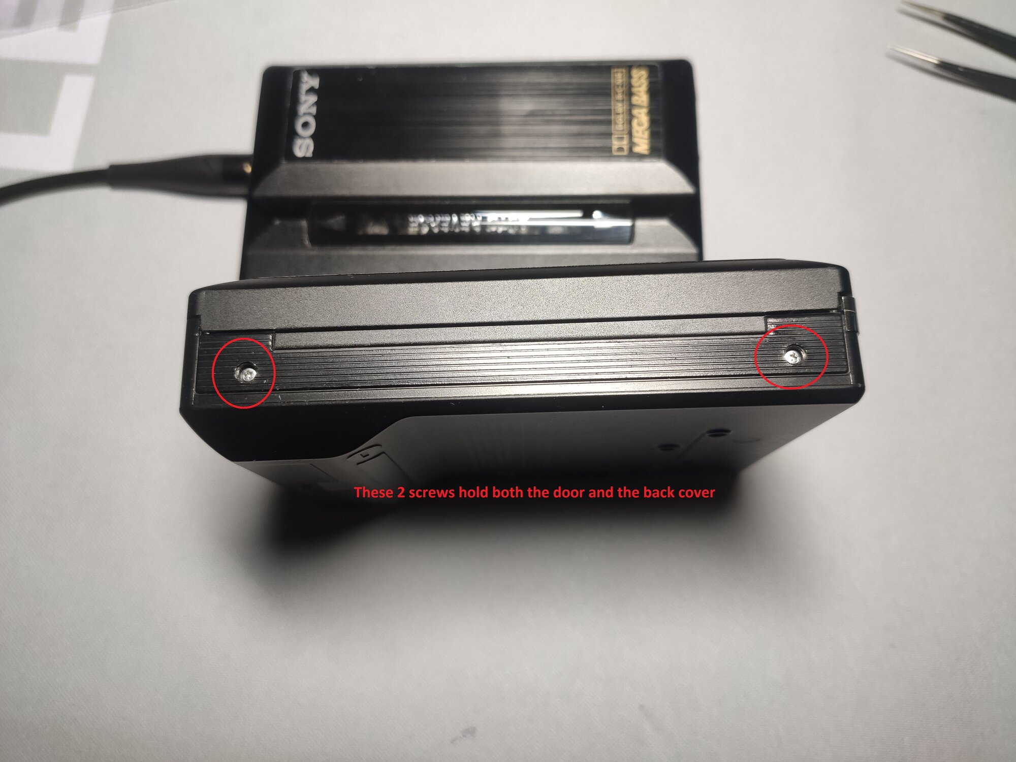

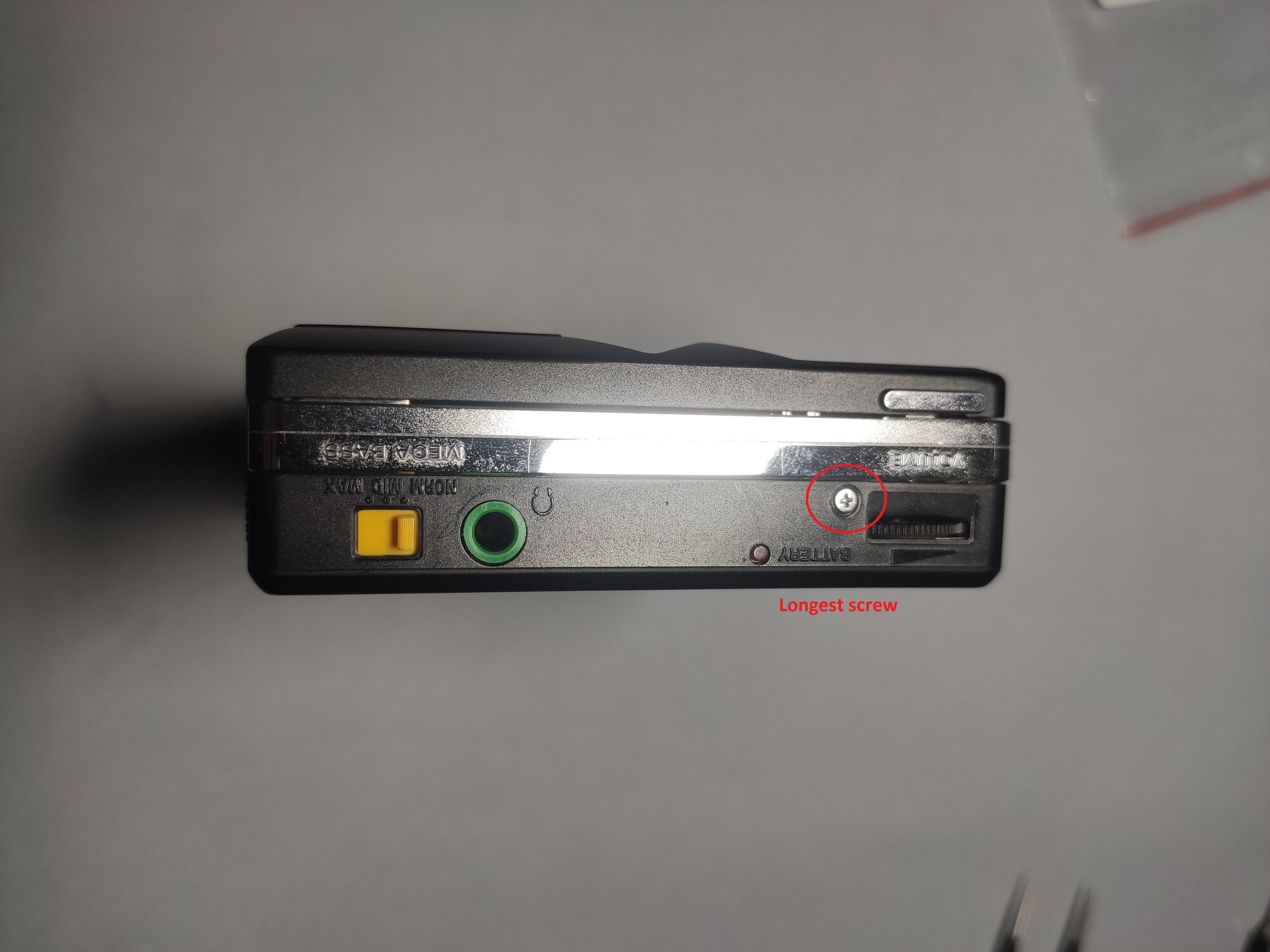

    1. Remove the door. There are 4 screws holding it: 2 small that hold the latch and 2 longer one that hold the hinge.

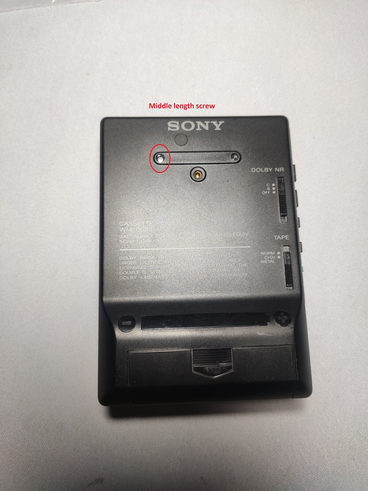

    2. Remove the back cover. There are more screws holding it: one small near the battery compartment, a middle one on the back and a long one near the volume potentiometer.

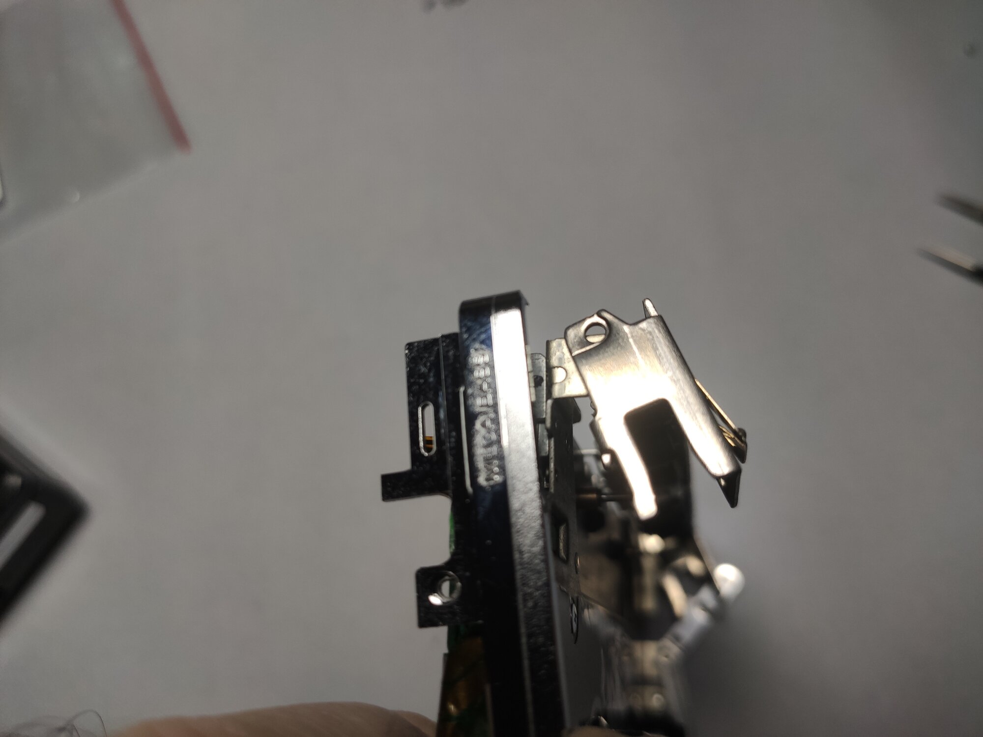

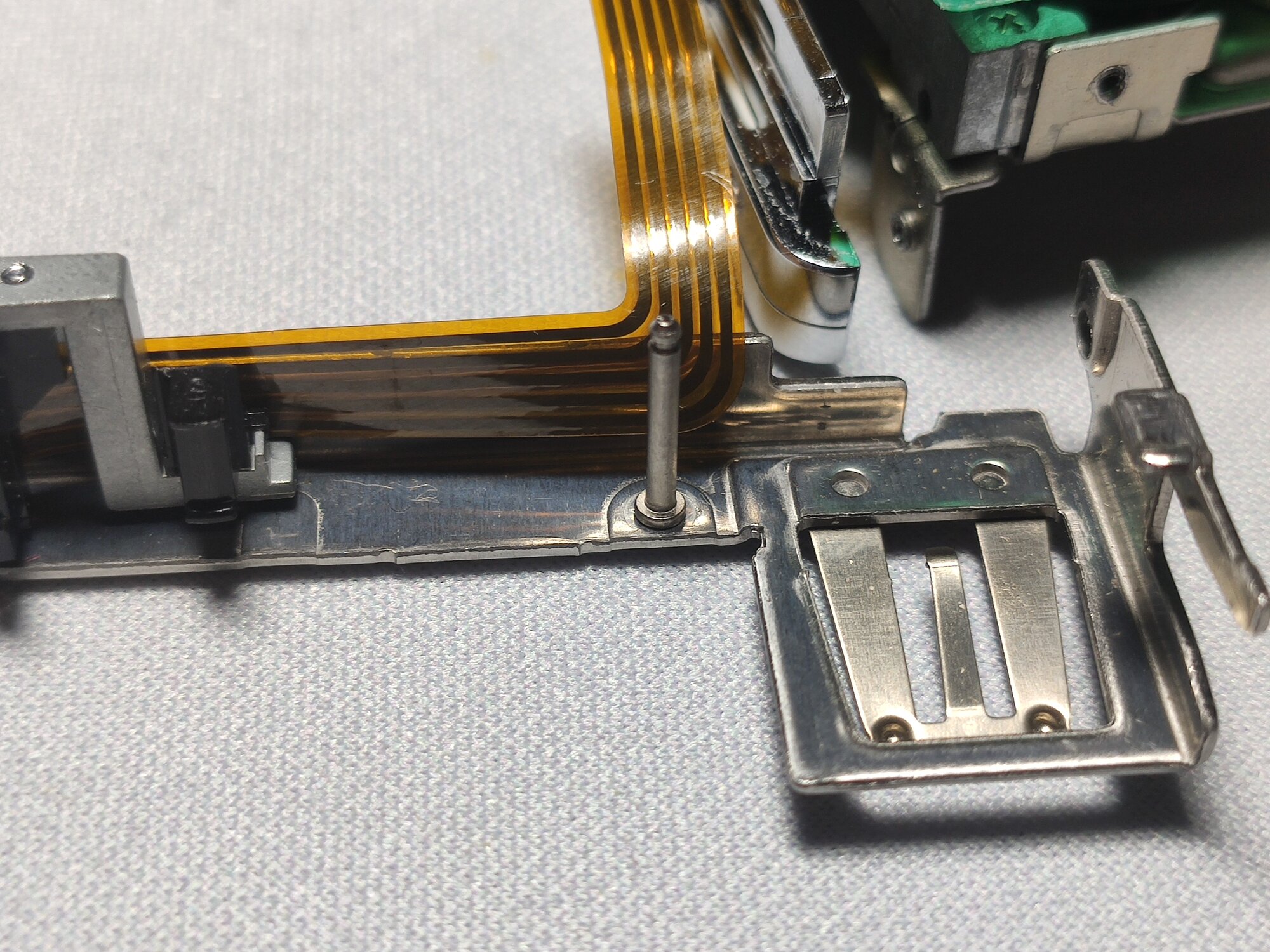

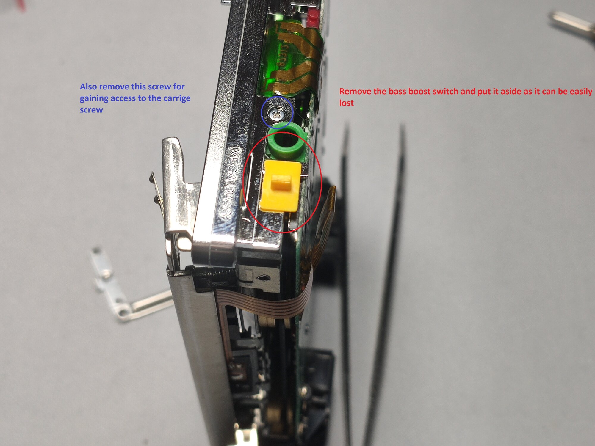

    3. Remove the screw holding the silver frame and move it aside.

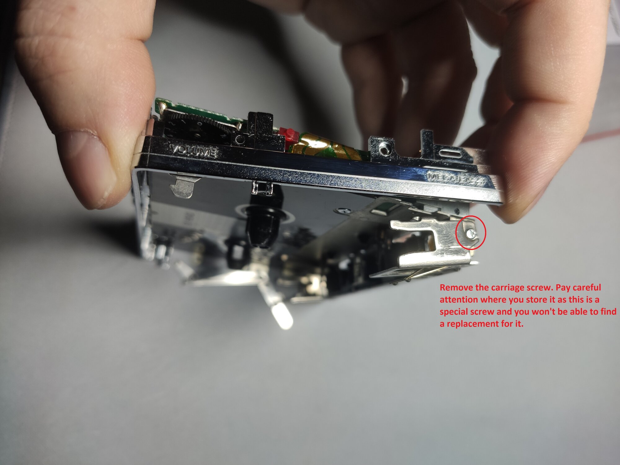

    4. Remove the head carriage screw.
    5. Remove the head carriage assembly.

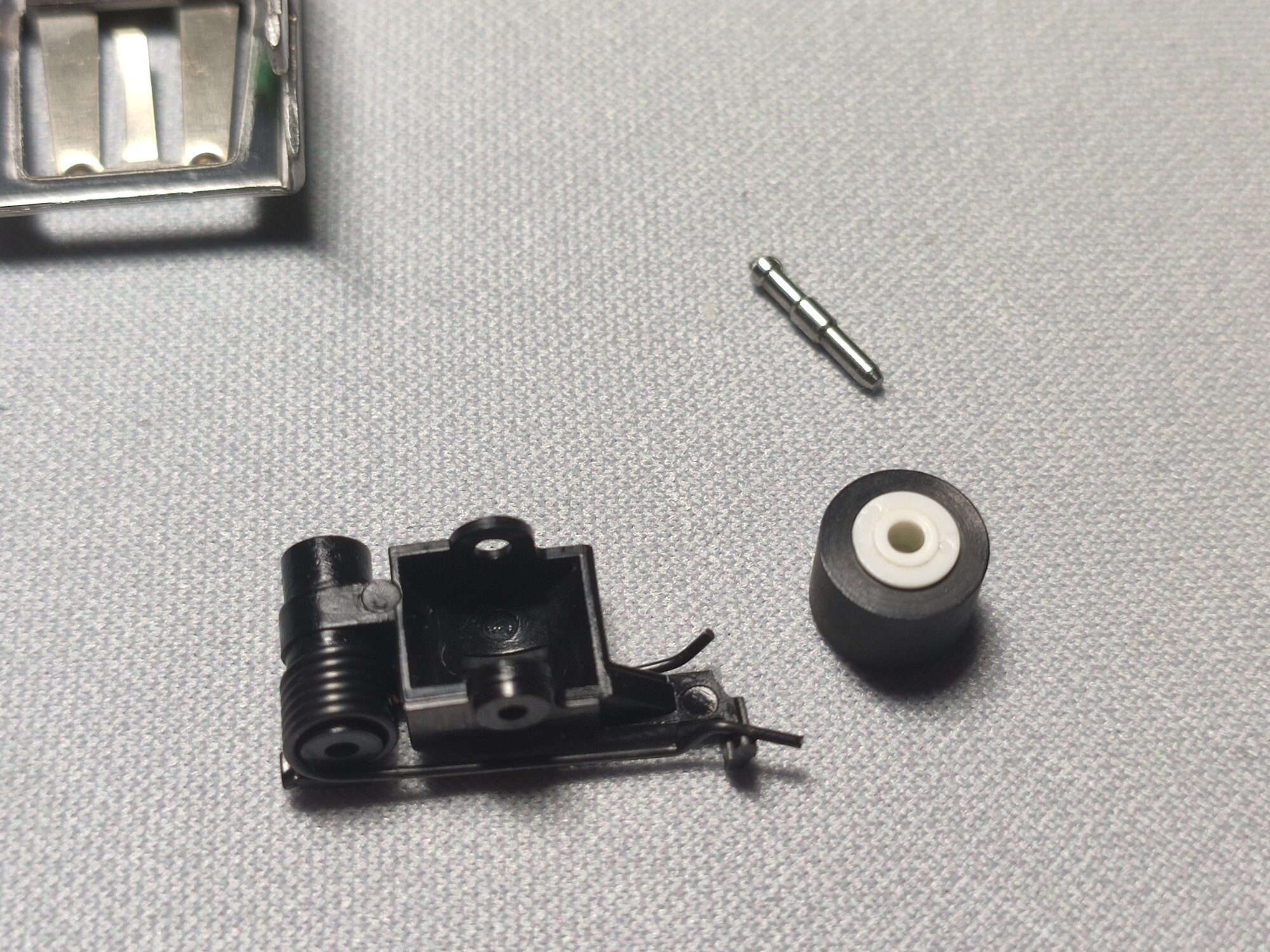

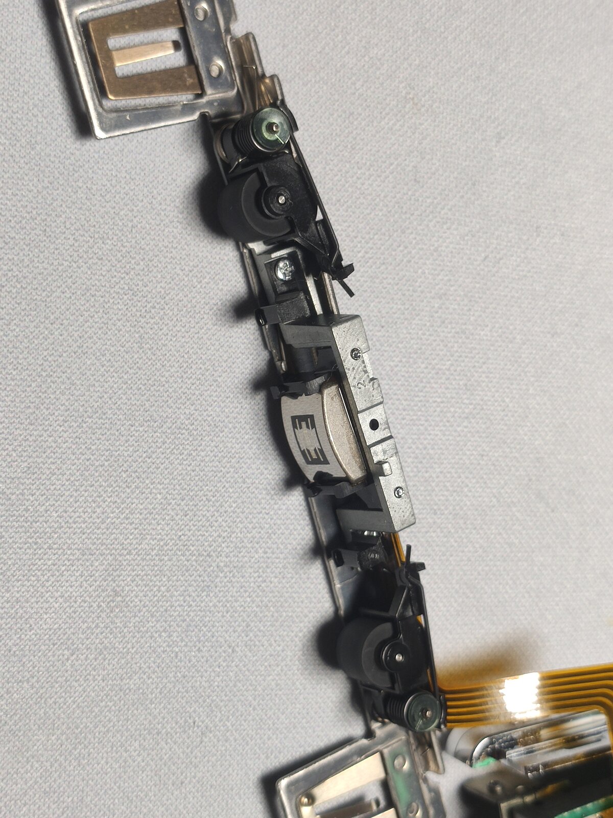

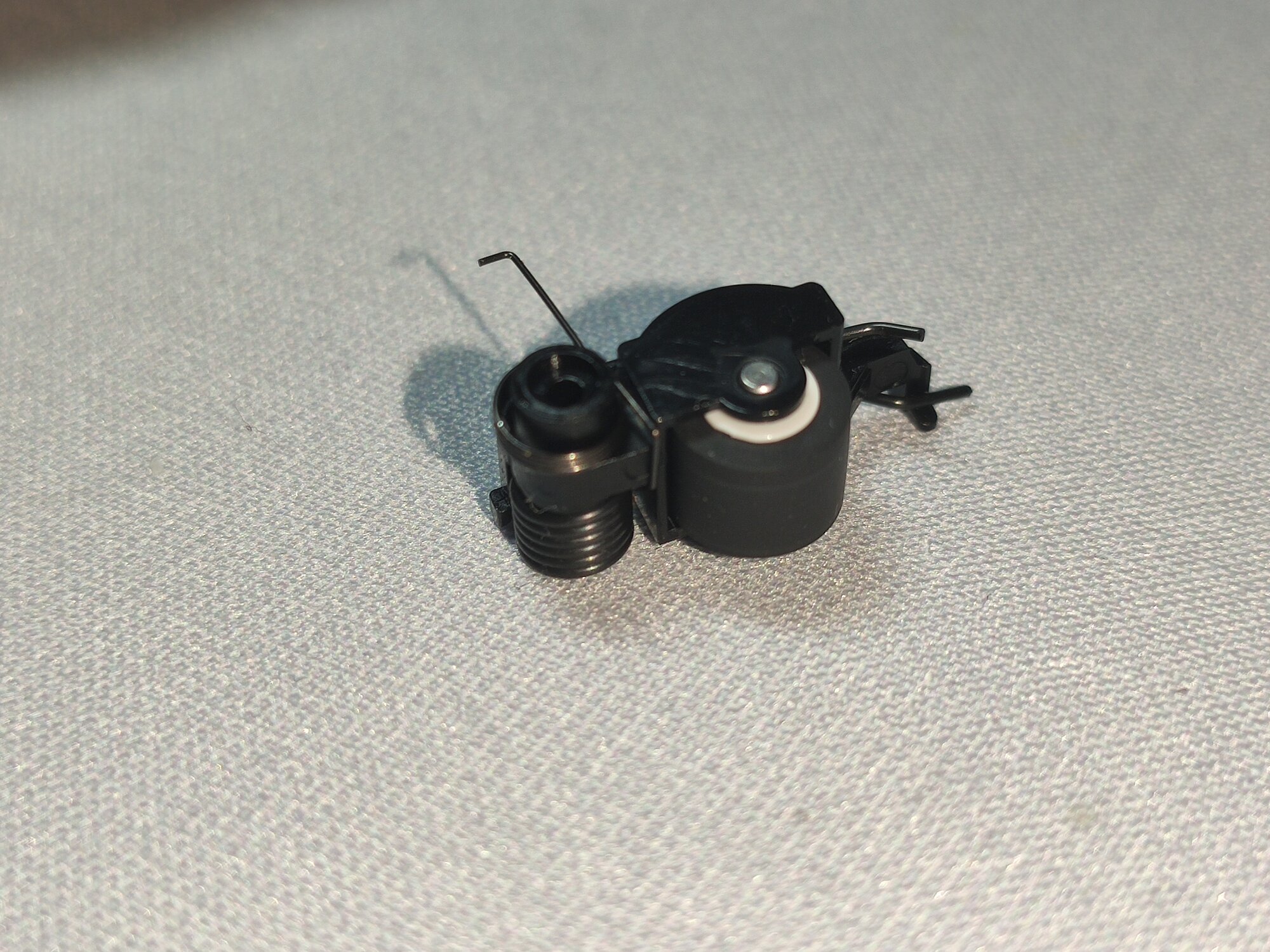

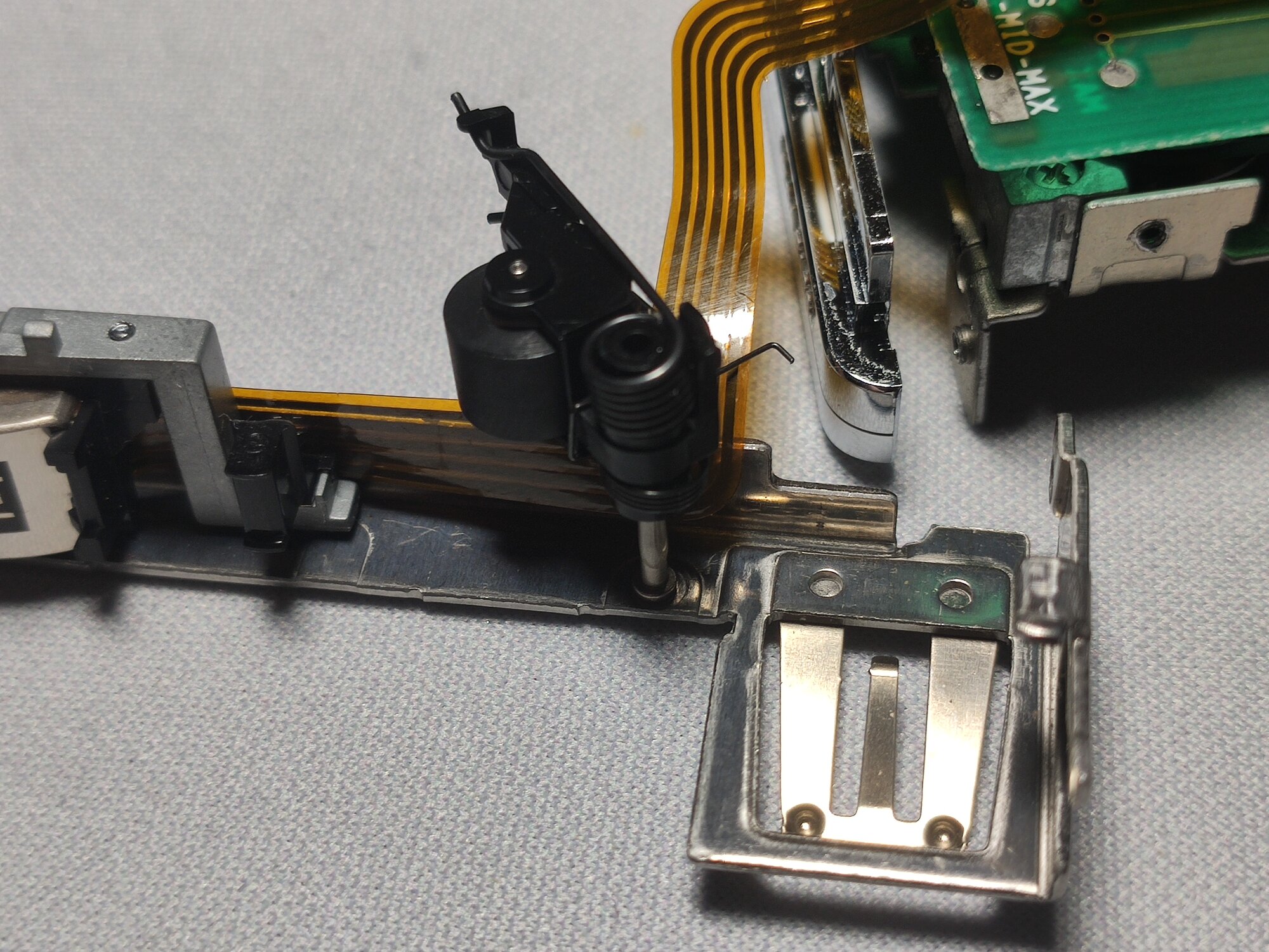

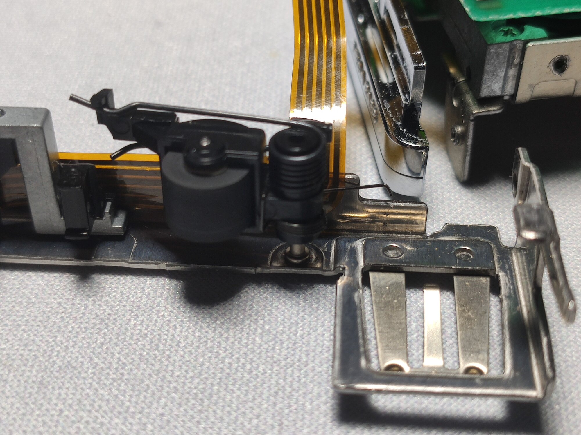

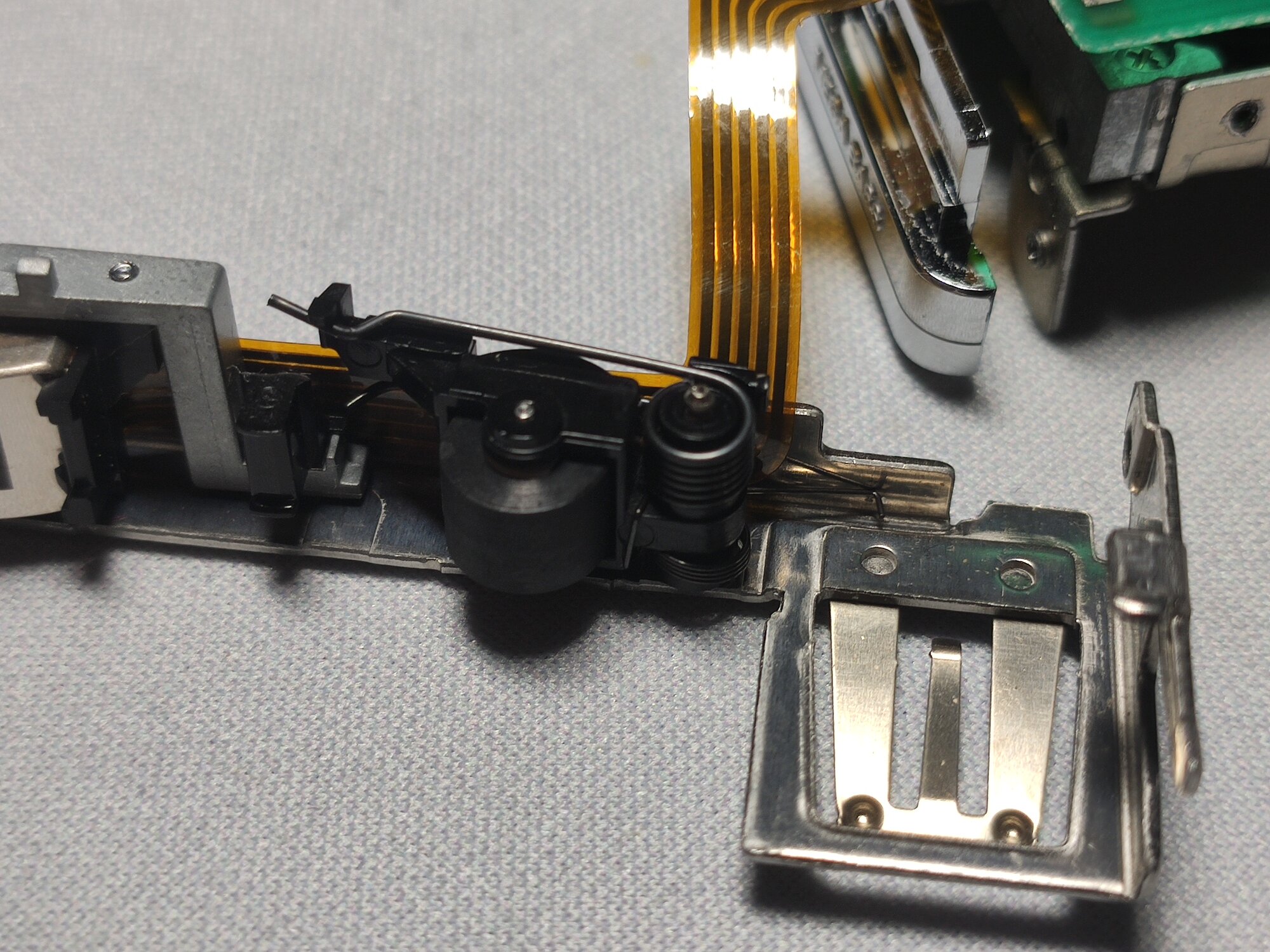

    PART2 (rollers replacement):
    1. Remove the cut washer holding the pinch roller assembly.
    2. Pull the pinch roller assy upwards. Note the small spring !
    3. Remove the small spring and put it aside.

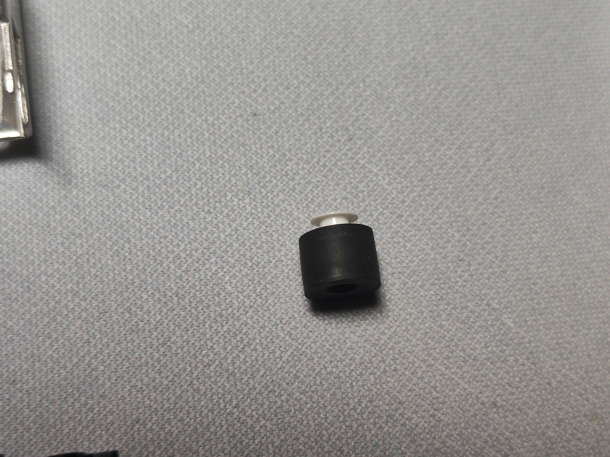

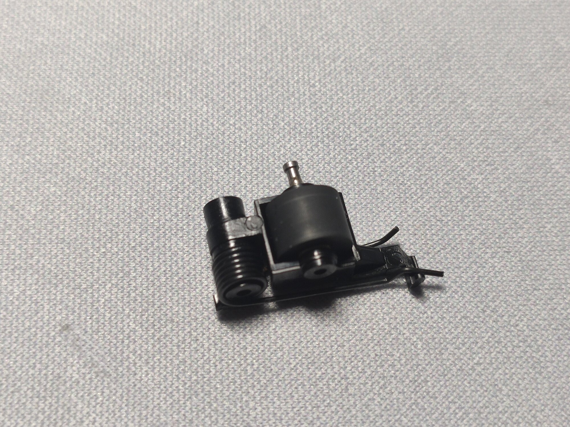

    4. Remove the roller itself.

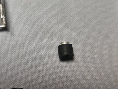

    5. Remove the old rubber from the plastic hub. Pay attention not to loose this hub !
    6. Install the new rubber on the plastic hub and lubricate the inside of the hub with watch oil.

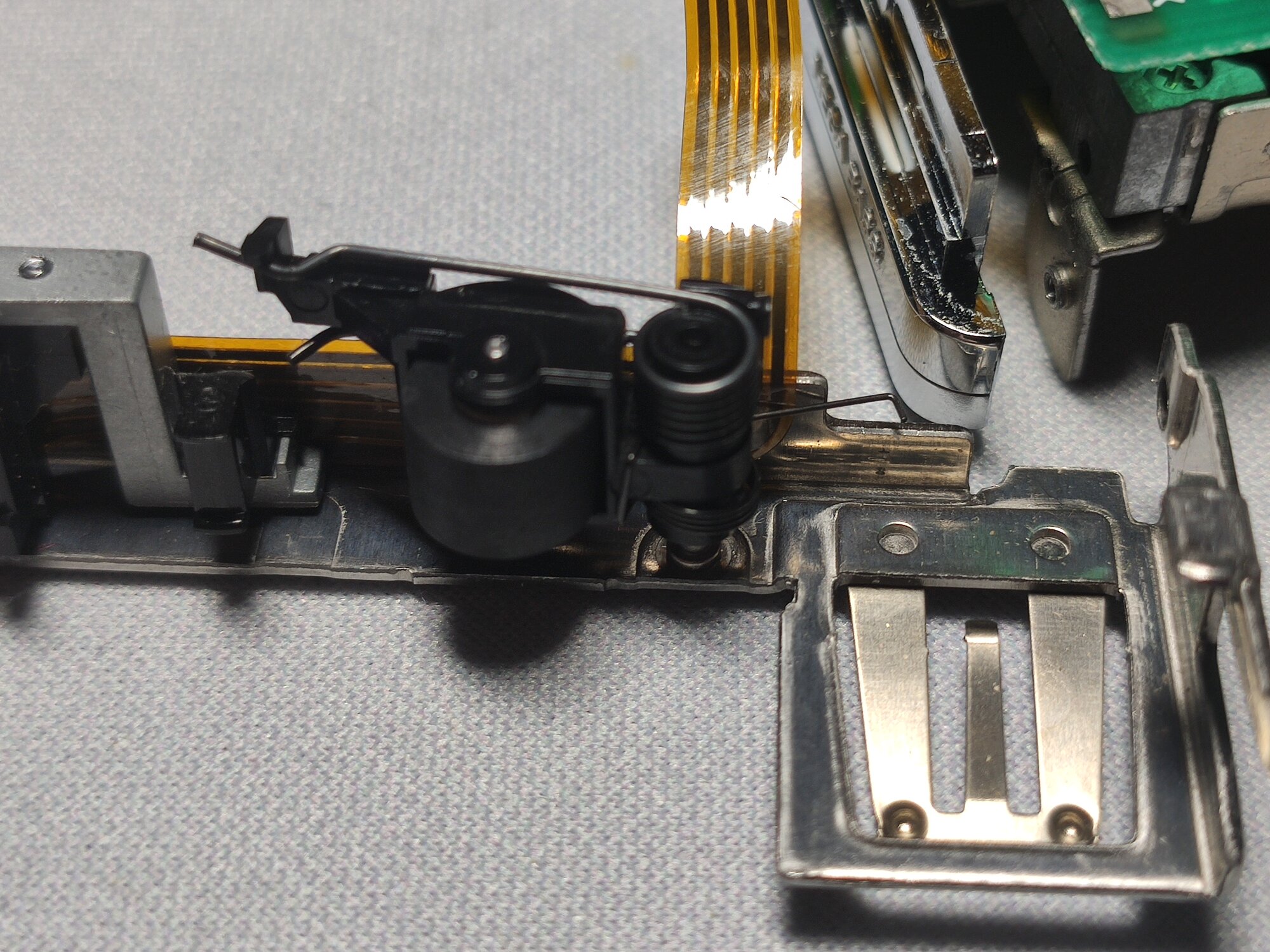

    7. Re-install the pinch roller in its bracket.
    8. Re-install the small spring.
    9. Lubricate the shaft on which the roller assy moves.
    10. Re-install the pinch roller assy on the head carriage and secure it with the cut washer.
    11. Repeat the process for the other side.
