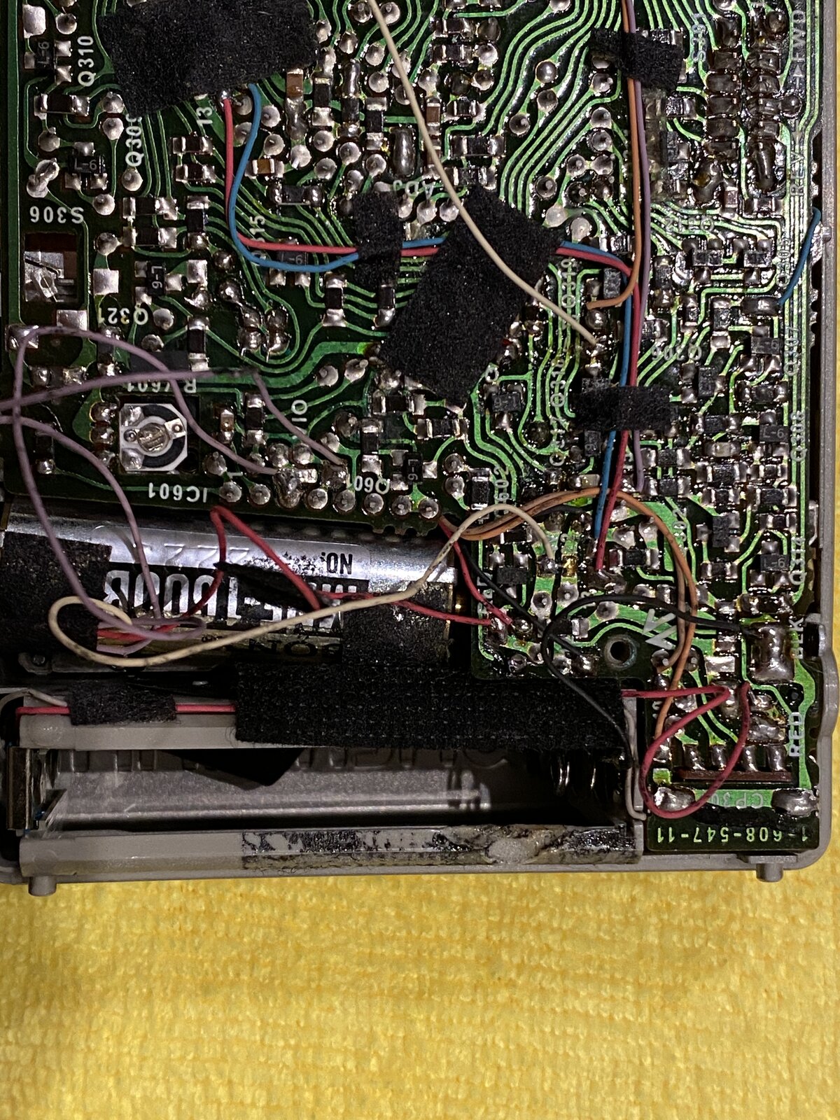

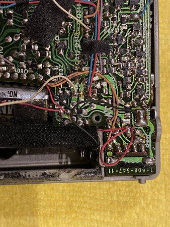

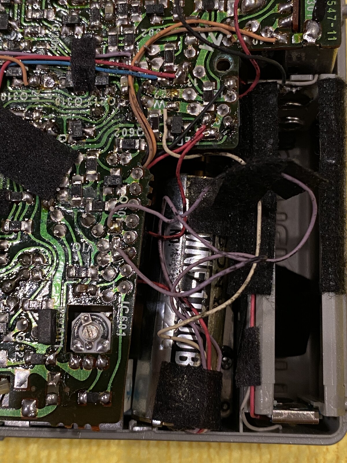

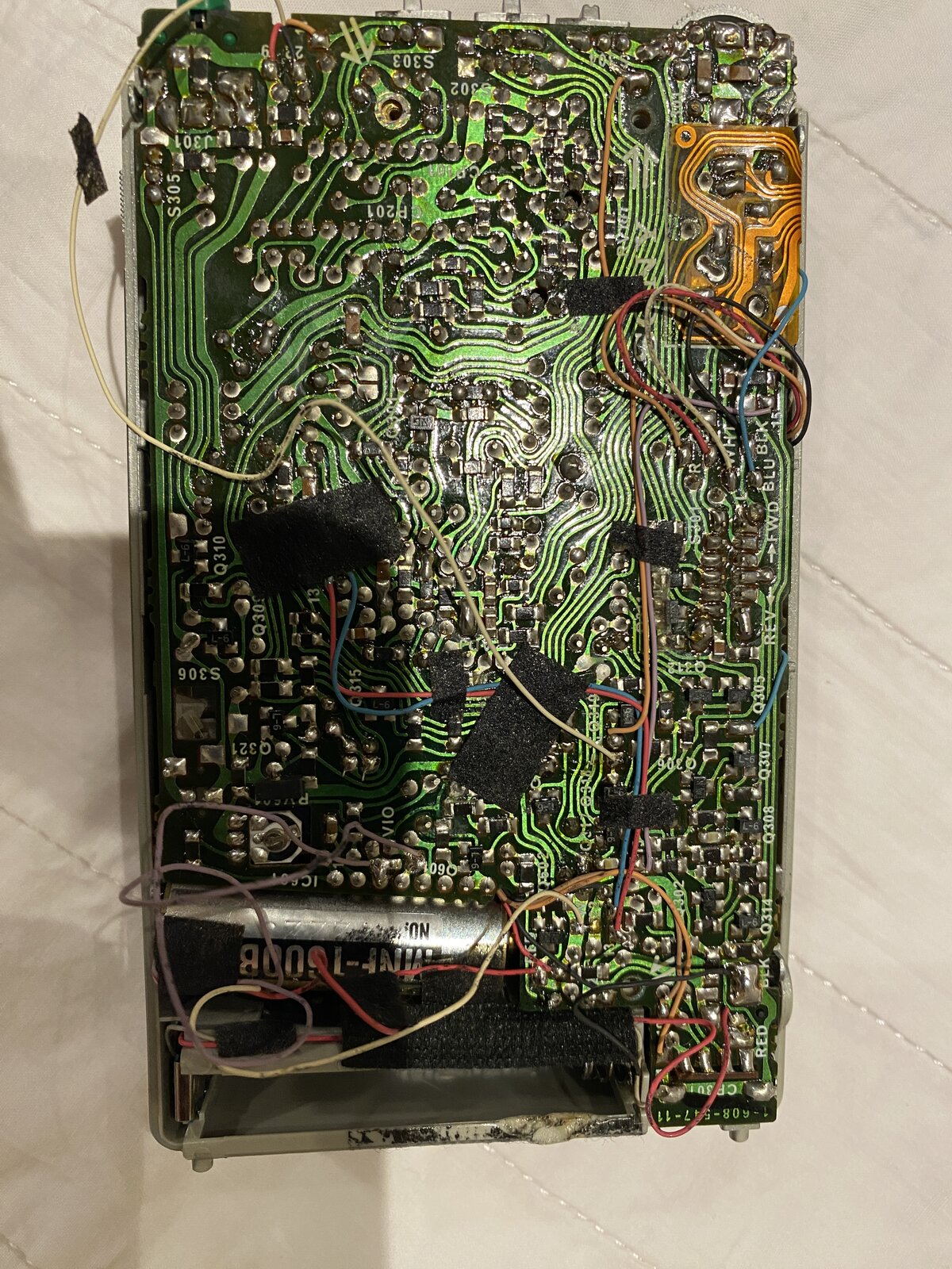

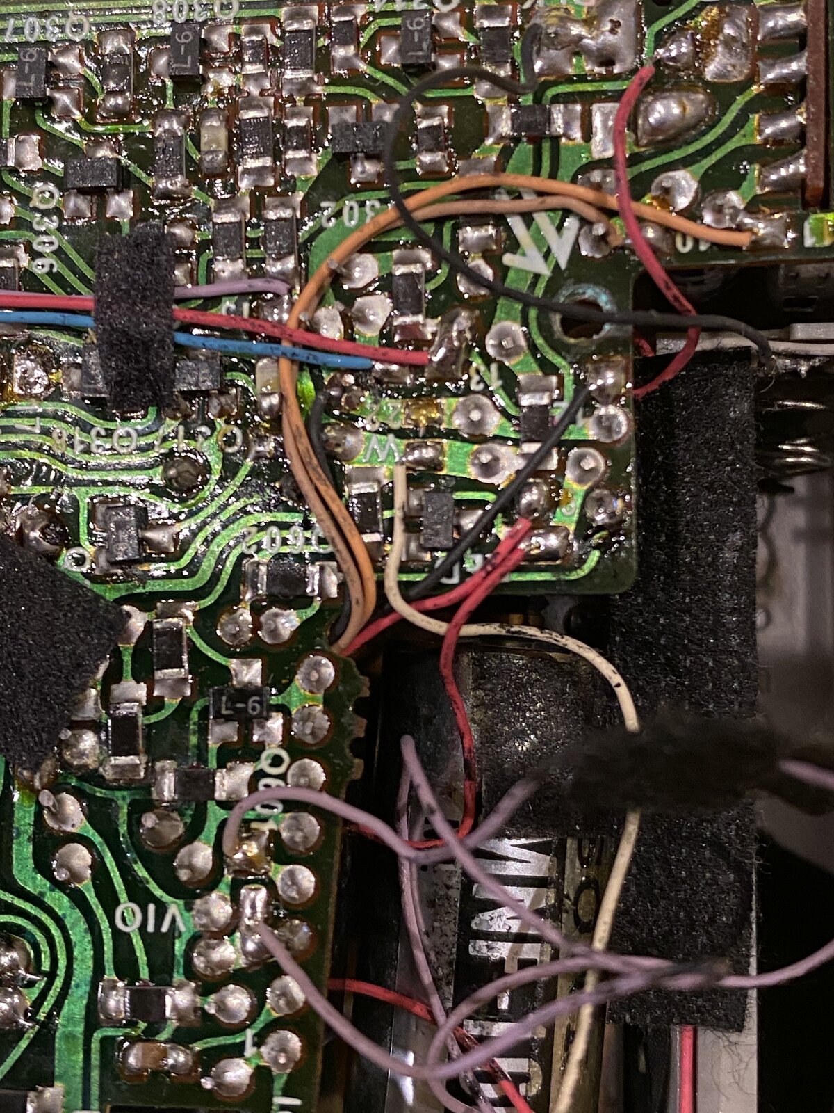

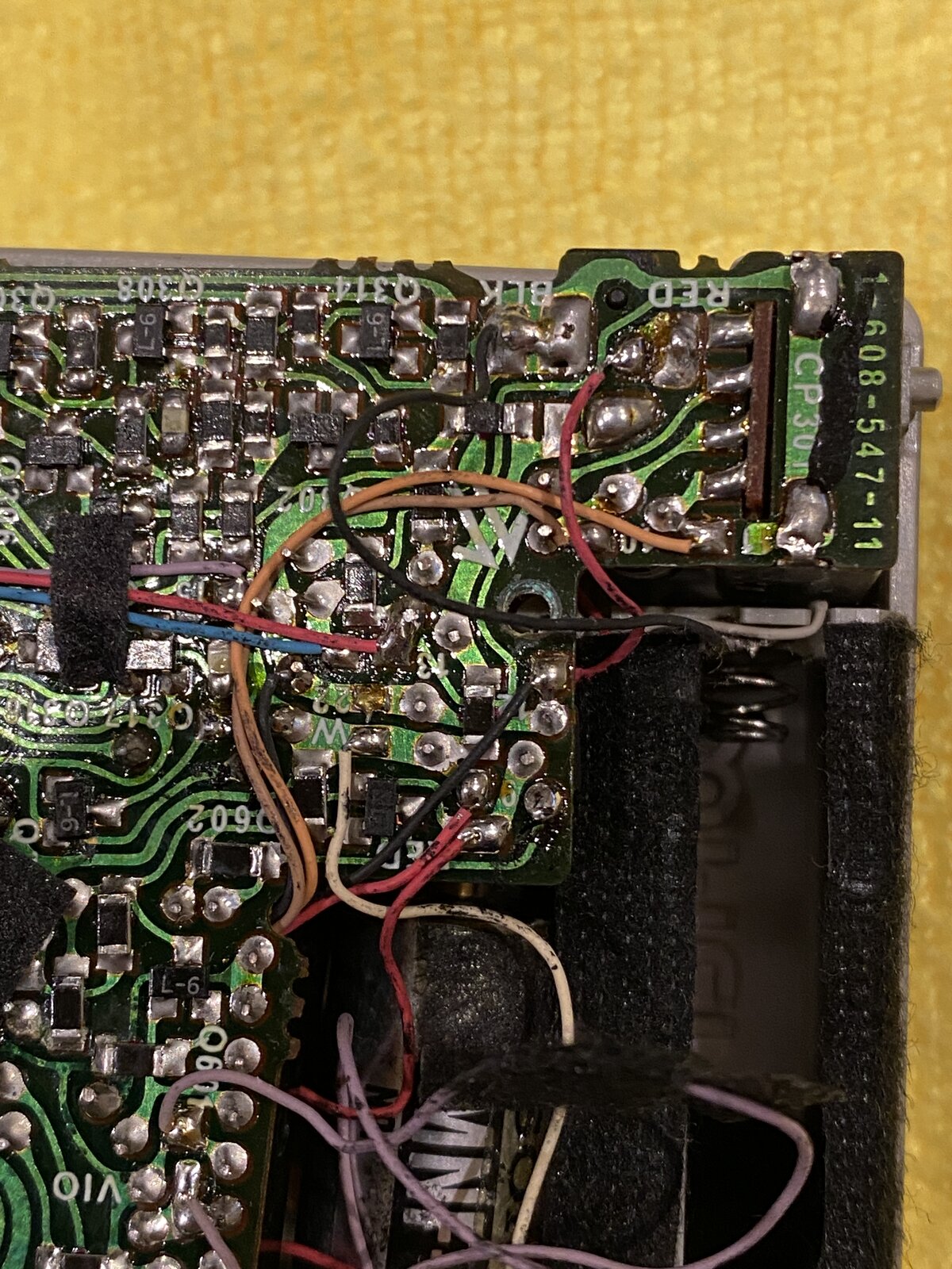

    I ordered a new belt for my WM-7.
    I disconnected the wires around the left hand side of the board near the motor to make it easier.
    All went well, i replaced the belt and resoldered the wires. Now its turning on and the batteries are getting very hot when i put them in!
    Im attaching pictures of the board area i took before desoldering and after. Im not sure whats going on :(
    Any advice appreciated.
    Thank you!!!!!!

    Can't see anything wrong at first glance.
    Batteries getting hot means one thing: there's a short circuit somewhere.
    You have to find where that short is coming from: maybe a battery wire got pinched and is touching something else, etc.
    Pay attention as something else is getting hot too (this is where the short is) given this.
    Electrolytic capacitors can also fail short-circuit (although very rarely). For example C305, C306 are connected directly to the main rail.
    Does Dolby NR work ? DC-DC converter only powers the Dolby circuit.
