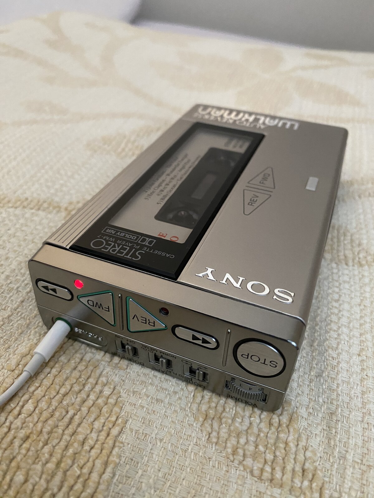

    Hi all,
    My WM 7 is working ok apart from fast forward does not engage. It engages sometimes which is strange.
    I have a new belt in there...
    I have this since 1982 (was a birthday present)
    Any help gratefully appreciated.
