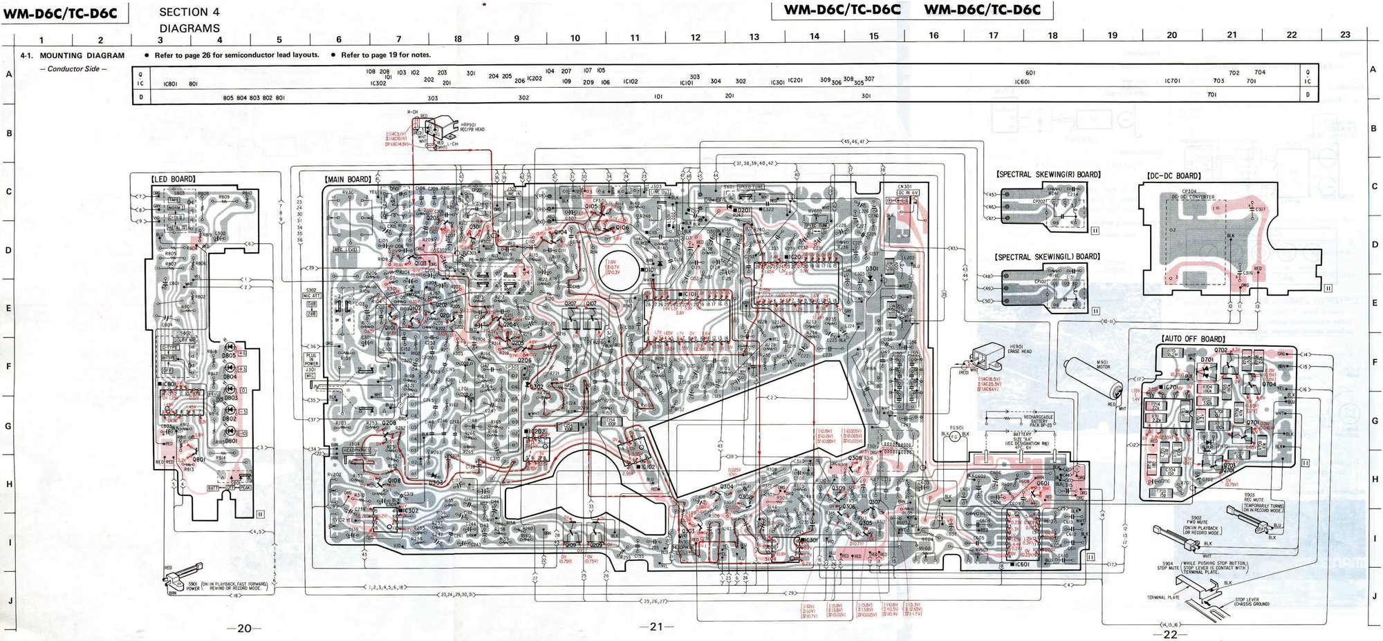

    With regard to your WM-D6C, if you're getting nearly 10V across the motor then there is something badly wrong.
    The motor is driven from an unswitched 6V supply, via a transistor (Q601), and the 11V rail isn't connected to the Cx20084 or motor drive circuit so, even if the CX20084 was faulty, you should not get 10V across the motor. Since the motor is only rated for 2.5V don't power it up until you have found the fault as you could damage the motor.
    I suspect you have a short from the 11V rail to part of the motor drive. You need to check over the board with a magnifier looking for solder bridges or loose whiskers of wire causing shorts. Check that all the wires are soldered into the correct places. Check that the orange wire from the DC-DC convertor (11V) is soldered to the correct pad. Take your time over this and be meticulous. Check everything, not just the parts which you have worked on. Maybe somebody has tried to repair it before and made a mess of it.
    I have attached a copy of the PCB layout which may help.
    Be aware that even if you find and clear the fault, depending on where the 11V was shorted to, it is possible that you may have damaged the new CX20084.
    There have been a few stories posted on the internet stating that there are some fake CX20084s in circulation.
