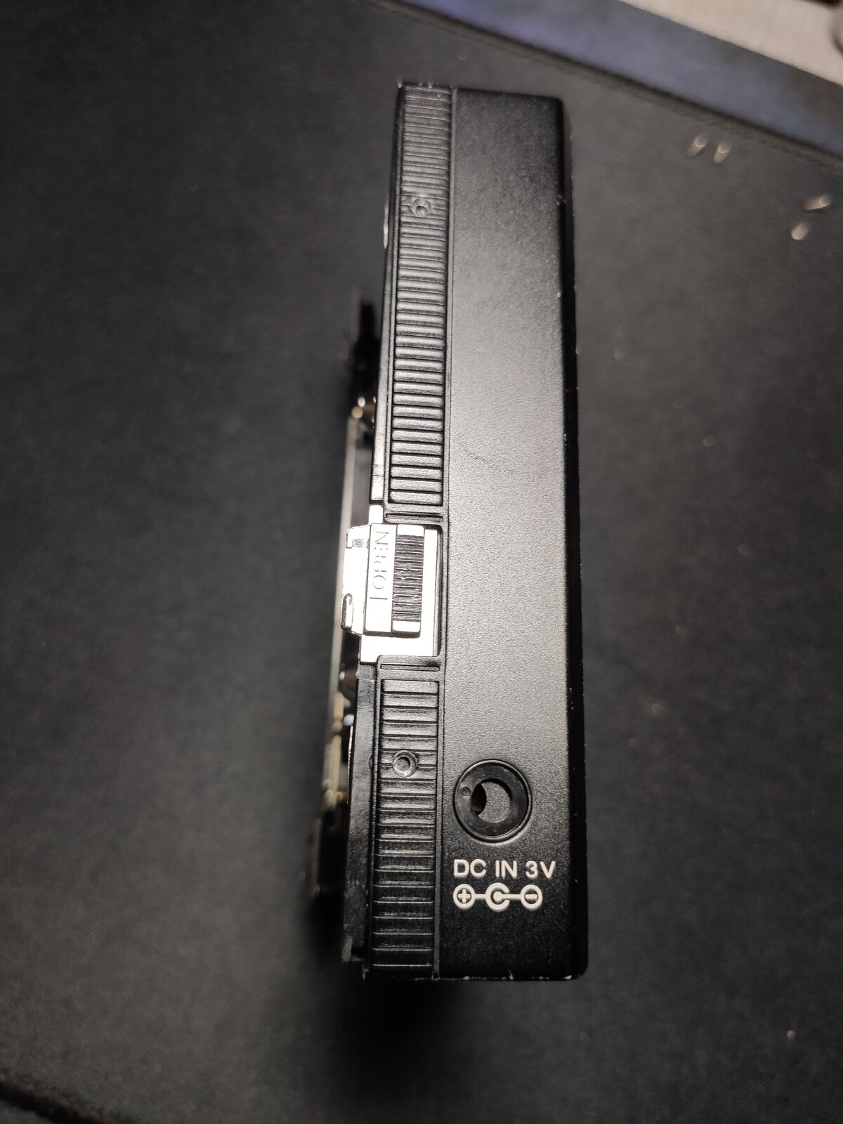

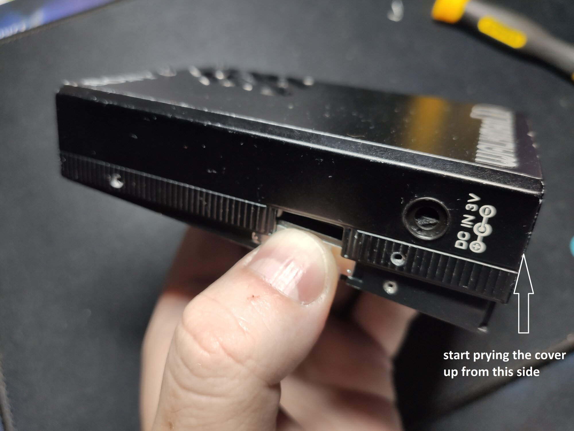

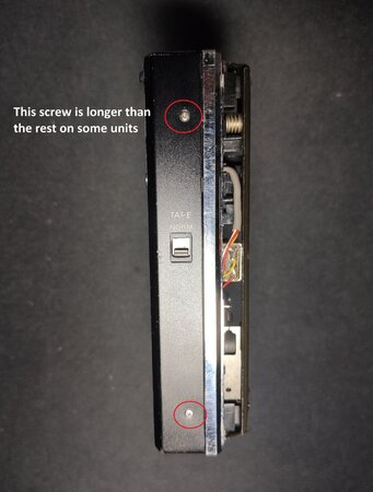

    DISASSEMBLY:

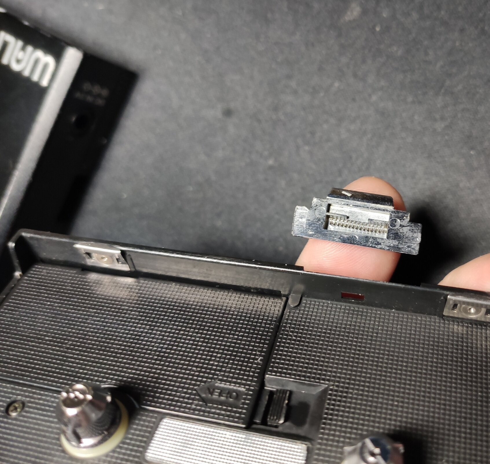

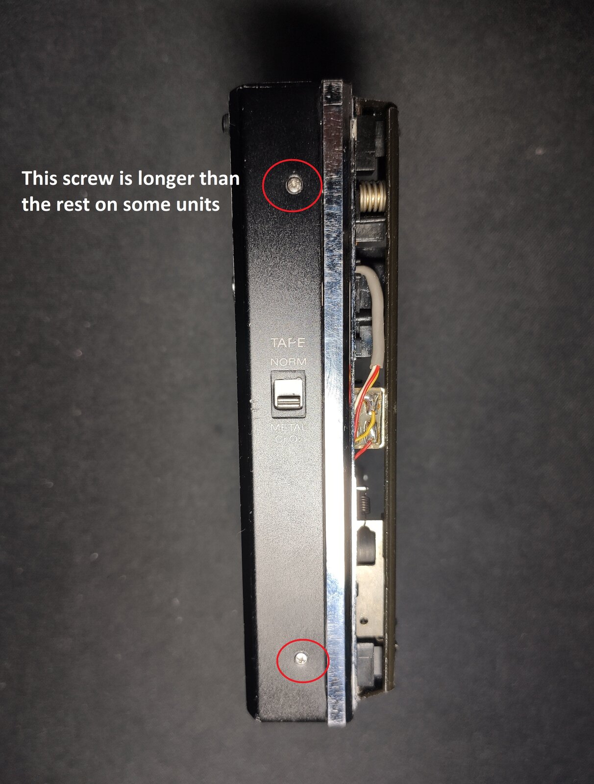

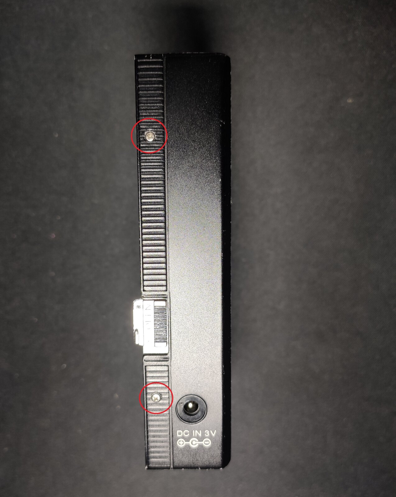

    - remove all 4 screws, noting that one of them is usually longer than the other 3;
    the 2 on the cassette door latch are shorter than the other 2;

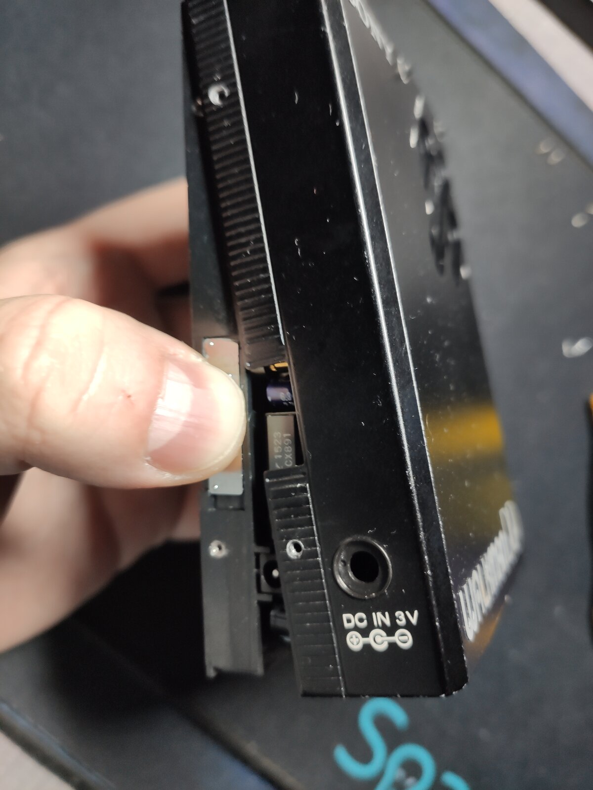

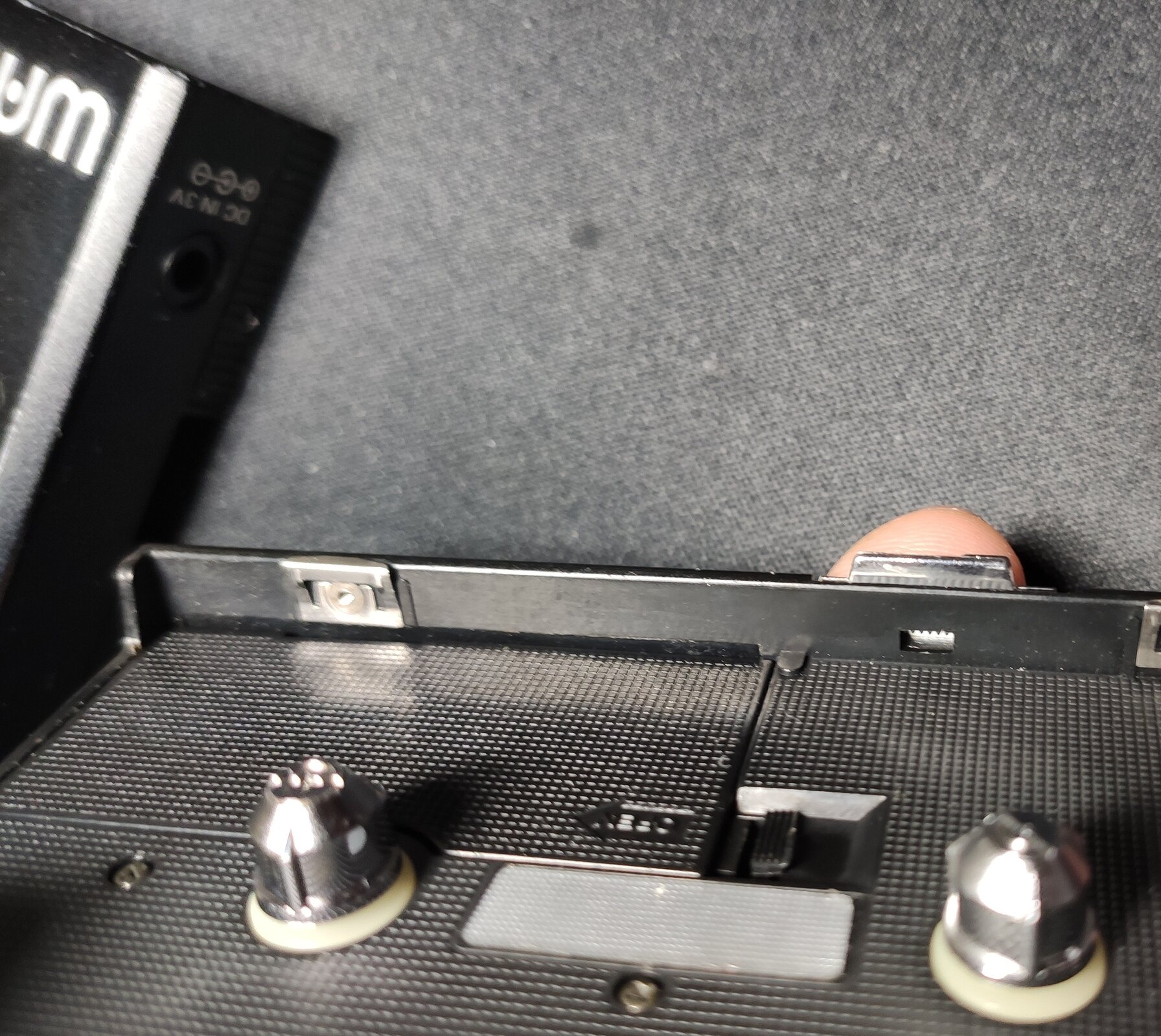

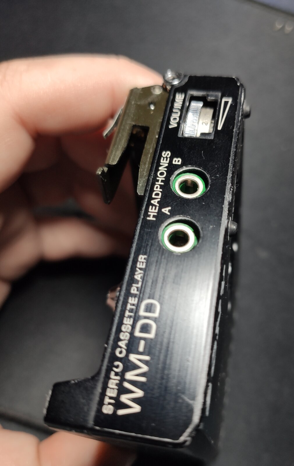

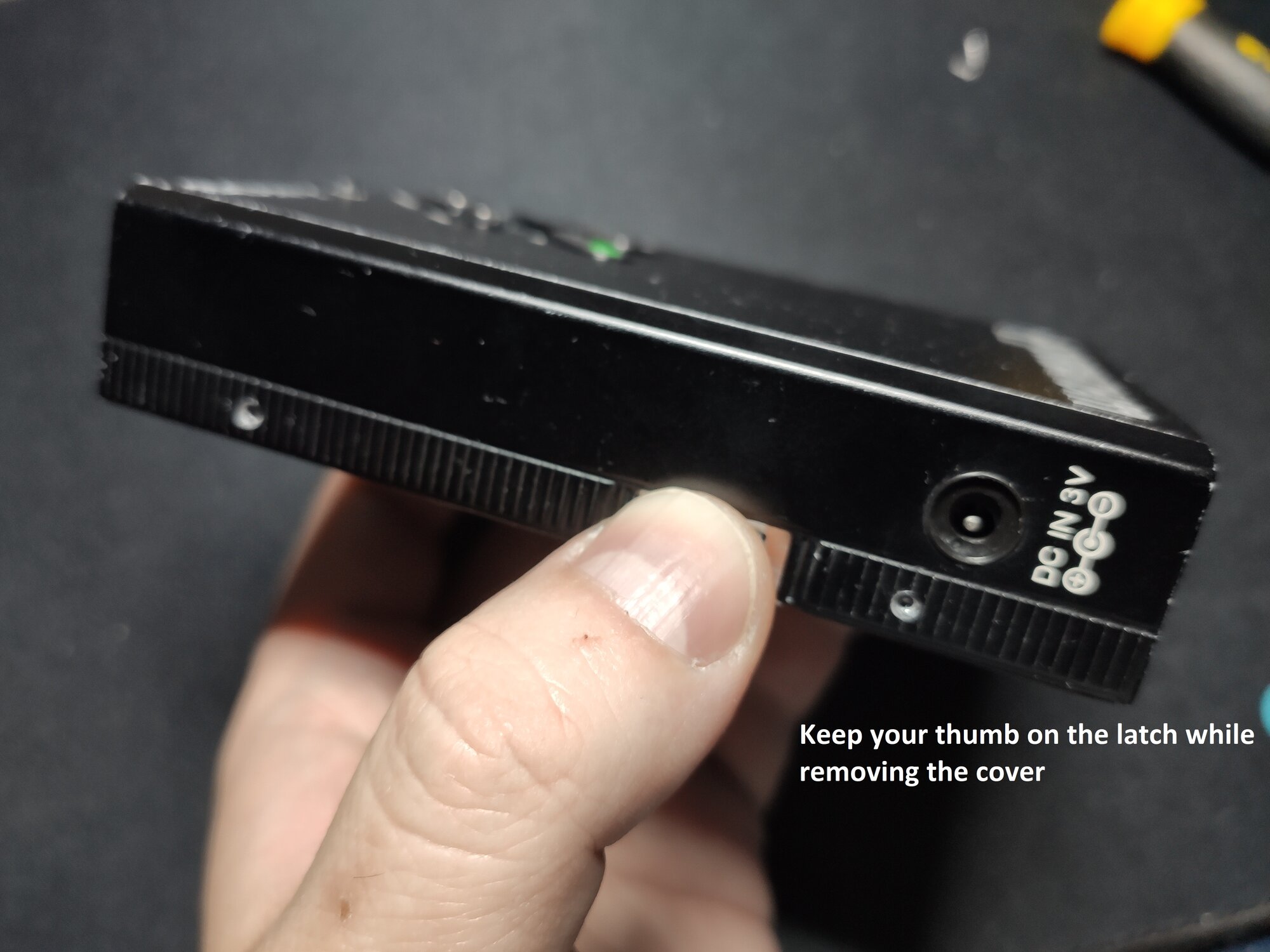

    - while keeping your thumb on the latch and other fingers on the head carriage, start prying to cover up from the side that contains the sticker with model number;

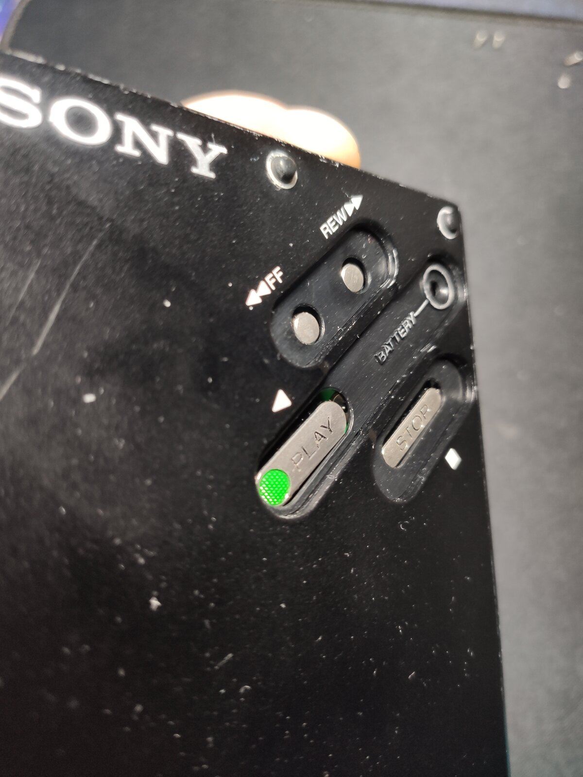

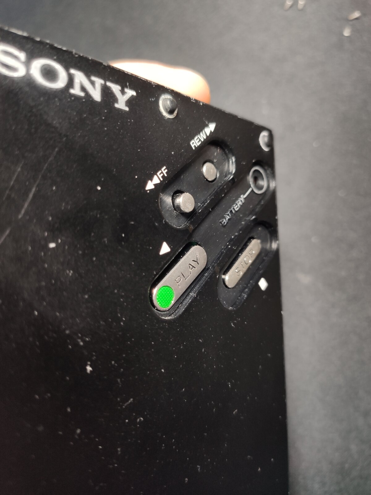

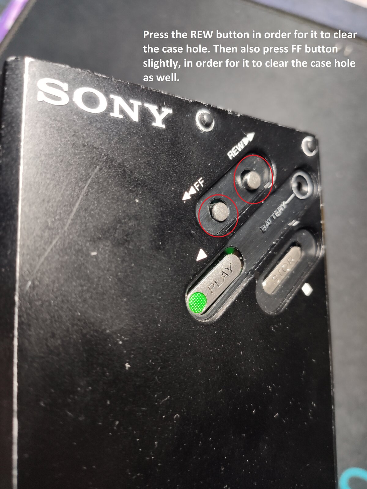

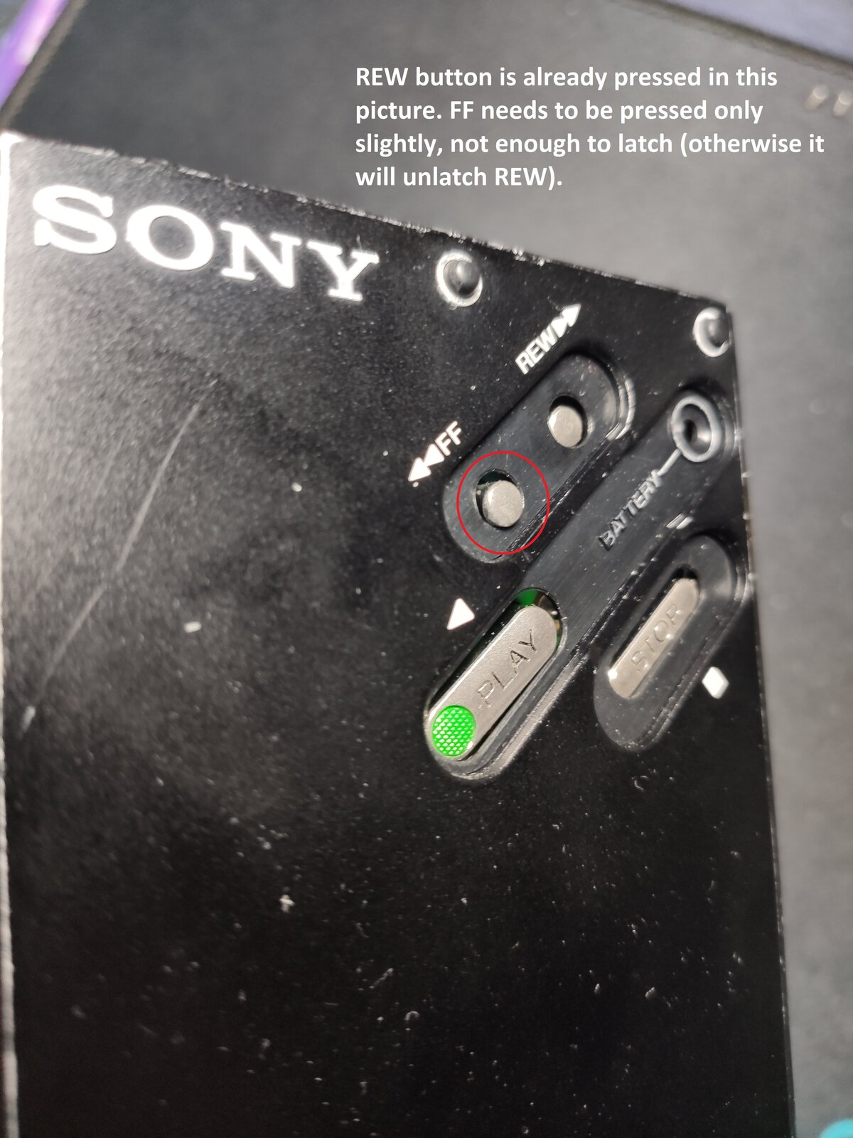

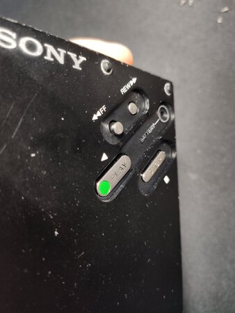

    - at a certain point you will start encountering resistance because of FF/REW buttons; press then REW button and then the FF button just slightly; this will let your remove the cover entirely without force;

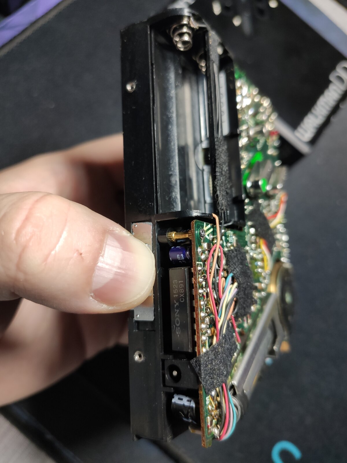

    - after the cover is removed, turn the unit with the latch facing down; slowly remove the latch, so the spring remains contained in the latch;

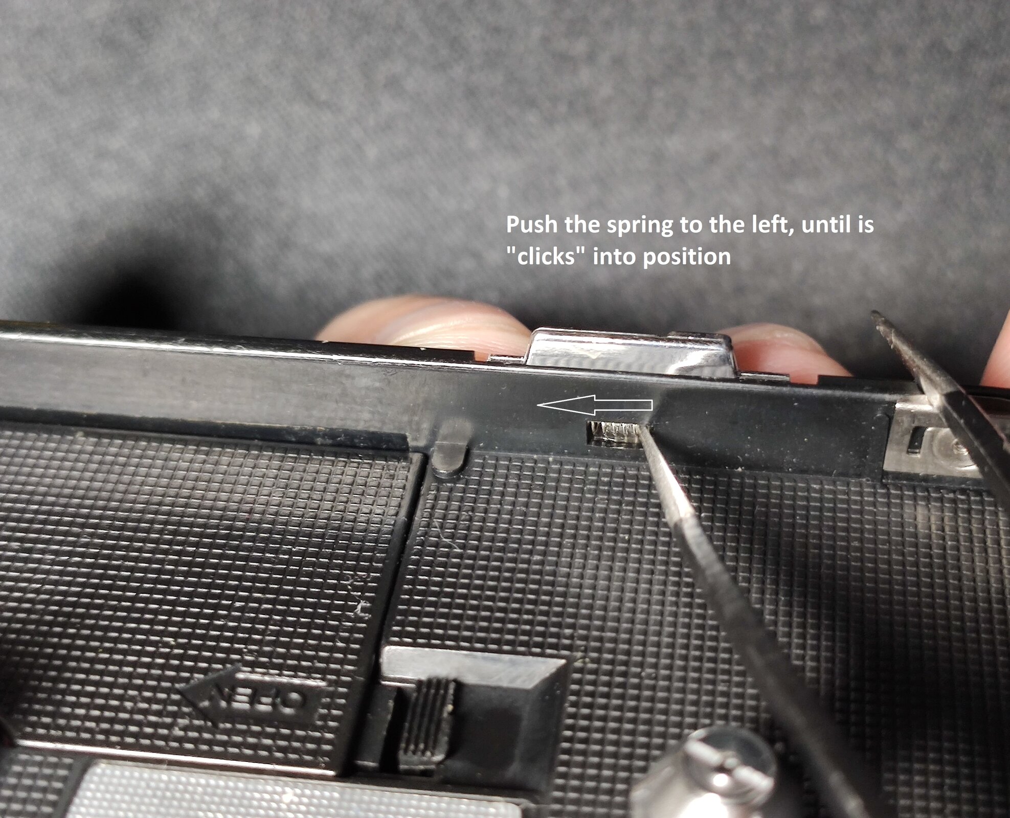

    REASSEMBLY:

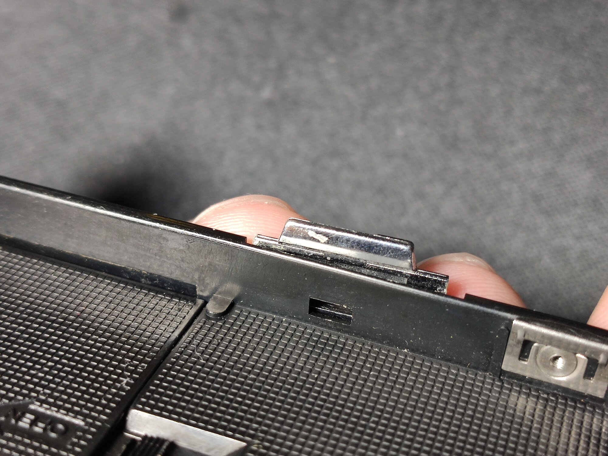

    - put the spring back into the latch;
    - put the latch back onto the case, it will sit at an angle, because the spring is not compressed;
    - with a thin pair of tweezers push the spring through the hole in cassette compartment in the direction of arrow;
    - while keeping your thumb on the latch, install the cover starting from headphone jacks; press firmly, so the cover it fully inserted on the jacks;
    - slowly push the cover, while keeping the unit tilted to the side where the switches position was chosen;

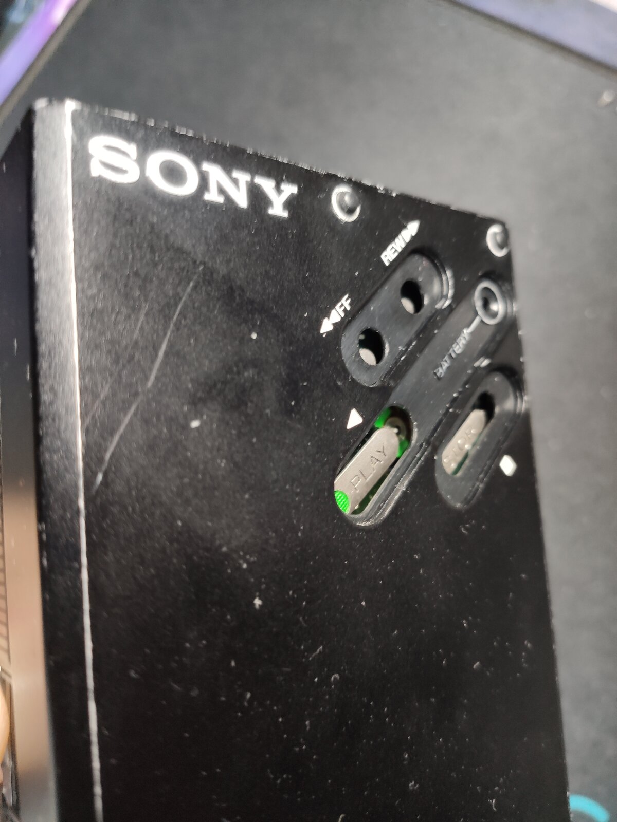

    - after the cover is fully seated, double check all the switches engage with internal ones; if not, slightly raise the cover and try to move the switch to correct position; keep the thumb on the latch at all times;
    NOTE: the EQ switch, Dolby switch and MegaBass switch (the last 2 are not present in all units) must be put all in the same position (either all up or all down, including corresponding switches on PCB);
    NOTE2: the REW button should be pressed before re-assembly.
