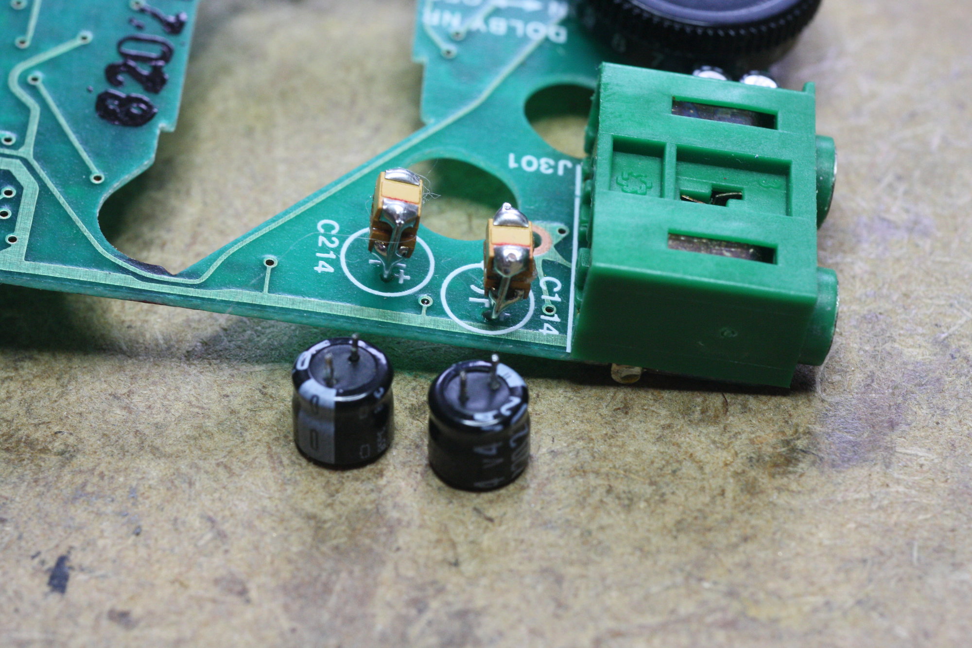

    Jut re-read your message and had another look at the photo. the larger board looks to be proto board (Veroboard).
    I agree, there looks to be 2 extra resistors or inductors (green colour) as well as an extra capacitor. I think the brown components towards the bottom are the 2.4M Ohm resistors.
    Hopefully @mihokm can clarify.

    Exactly, yes, the equivalent space on my own DDIII:
    [GALLERY=media, 1615]IMG_0062-crop by C83 posted Feb 12, 2021 at 11:36 AM[/GALLERY]
