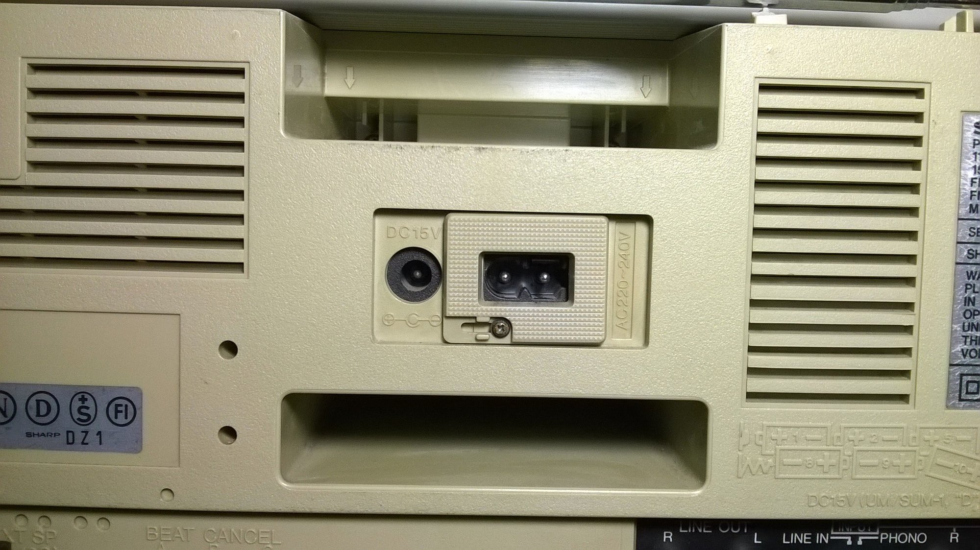

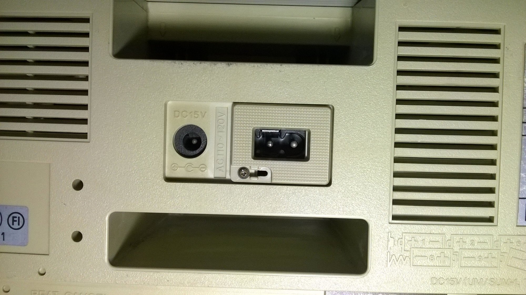

    Less than ten hours ago -- what with all the cares of family life around me, tensions with others and the like -- I suddenly realized that I hadn't done what the eBay seller of this Sharp GF-800H(S) advised that I do in a reply to an eBay message that I sent him. He advised me to adjust the voltage-selector switch from the 220V-240V position -- used all those years for the European circuitry -- to the 110V-120V setting, the voltage range of North American circuitry. In unpacking the stereo, I didn't see what seemed to be an "obvious" voltage-selector switch. (I probably didn't eagerly look.)
    I've used the GF-800 with the incorrect voltage setting for over twelve hours by now. I more or less hurried upstairs to my bedroom, hauled the big, still-assembled machine to my mostly cleared bedroom desk and examined the rear panel. That's when I realized what (or where) the voltage selector is and what (or where) it isn't: the voltage-selector switch of the Sharp GF-800 surrounds or "frames" the power-cord socket itself, next to the 15-volt DC socket. I took out my Kronus brand of (formerly) six small "star" screwdrivers. I used one of the green-sheathed screwdrivers -- certainly not the largest one -- and loosened the tiny screw holding what I suspected was the side-to-side-sliding voltage-selector panel with the knurled frame. I shifted the small, squared panel to the right, covering the 220V-240V etched characters. There the more appropriate 110V-120V setting was. I then re-tightened the voltage-selector screw.
    But is it too late? Has damage been done for using the stereo with the wrong voltage setting? The Sharp has been used for probably over fifteen hours on North America circuitry. AC voltage here in the United States is numerically half -- or a little more than half -- of the voltage typically used in Europe. I also used an E.U.-to-U.S. adapter, part of an assembled USB-to-AC "Switching Power Supply" unit that I rather conveniently found in the "Media Room" upstairs hours before the stereo was delivered. I have used that AC adapter all the time that I have operated the Sharp GF-800. (I need to; the stereo came with a round-prongs power cord, incompatible with U.S. electric sockets.) I don't think that the E.U.-to-U.S. adapter is a voltage converter; it's too small to have that sophistication and expense of design. But I still hope that it provides some measure of AC voltage protection. But is using it -- and is changing the rear-panel voltage-selector switch after the fact -- too little, too late?

    To further illustrate the prior message in this topic, I have taken photographs of the rear-panel knurled-frame voltage selector (the frame surrounding the socket itself being the "switch"). Before ...
    FIRST FEBRUARY 10, 2017 PHOTO' OF THE SHARP GF-800H(S) VOLTAGE-SELECTOR SWITCH.JPG
    ... and after. This photo' was a lot harder to obtain than was the "Before" image, with me struggling with the lighting angle of the Sharper Image lamp, me struggling with the positioning of the camera-mode smartphone, etc.
    SECOND FEBRUARY 10, 2017 PHOTO' OF THE SHARP GF-800H(S) VOLTAGE-SELECTOR SWITCH.JPG
    Oh, and there should be no great concern about the rear-panel end of the power cord fitting properly -- or at all -- in the rear-panel AC jack. Both the European receptacle and the North American (or U.S.) counterpart seem pretty much alike. In any case, I've already fit the panel end of the power cord into the 110V-120V receptacle (though it did seem like a bit of a struggle at the time), with the GF-800 working apparently just as well, with me playing the yellow-labelled Polydor International symphonic-music audiocassette for six minutes in Tape Deck 2 to be sure. The playback was timed with an inexpensive Taylor timer. No, the stereo didn't sound too fast or too slow, though at the time I did wonder if the volume was noticeably lower during playback. Uh .. did I simply forget that I turned the volume almost down to zero hours earlier while playing NPR music programming, or is there truly a voltage-mediated difference in same-setting loudness?

  6. Longman
    4,024
    I'm surprised it worked but I doubt if you have done any damage.
    Running a 230V box off 110V is equivalent to running it off very flat batteries.
    Making the mistake the other way round could lead to a bang or smoke very quickly
    (we once did that at work with a brand new £3000 disk drive :redface:).
