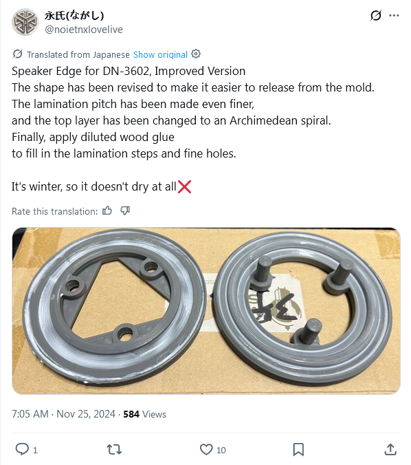

    This guy has a great X thread, he works on a ton of high-end tape decks and speakers, check out his 3-D printed molds for speaker surrounds. Unfortunately printing is really slow, my multiboard wall is taking a long time at 3 hours a panel. My wall is 9' and needs 13 panels just for the top but there's a door in the middle. Still it's 3 hours x 13 just for the top. I also have to remove the print to start a new one, with Multiboard Paid Subscription they will give you stacked prints to do multiple panels stack up for overnight printing.

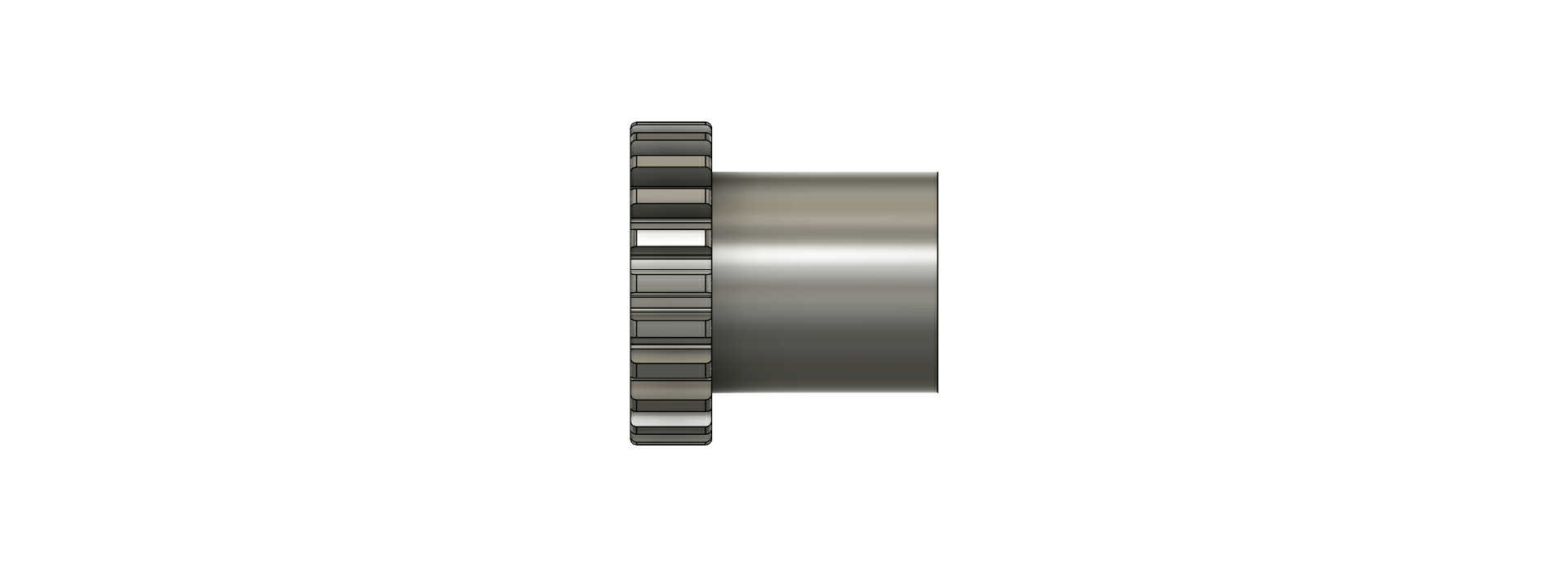

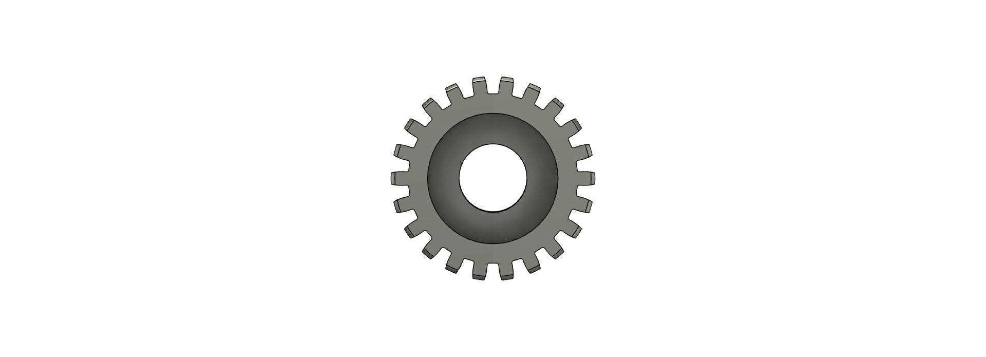

    Hello Guys,
    Here is a gear I designed for a antique radio tuning drive gear I designed from measurements of the original .

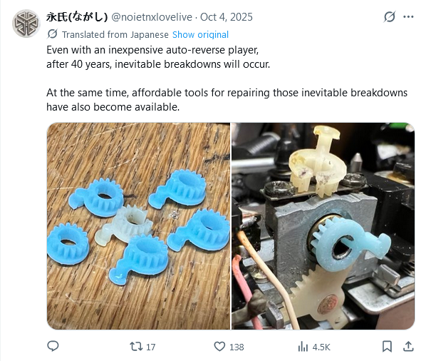

    I'm checking out some X Feeds from Japan, they're very excited with 3D printing for their tape deck repairs, especially with gears. I imagine once you have some CAD time in, it's pretty easy to crank the gears out.

    I wonder how strong they are, not just accurate. What filament do the use?
  13. radiorich
    radiorich Active Member
    271
    Washington state
    I used ABS but there other types to use too .

    abs is very rigid for printing (overall best for mechanical stuff- without paying a fortune for engineering grade iirc), but yeah its not super accurate coming out a regular ole' filament printer. i guess it depends on the size and application but for walkman parts atleast i would use resin for gears
    abs-like resin is what i think most are using for mechanical parts, mihkolm was/is experimenting with it for the infamous wm-10 reel gear problem which looks to be going well- https://fixyouraudio.com/product/sony-wm-10-walkman-take-up-reel-gear/
    i think a few years ago i was looking at getting nylon resin for printing smaller gears, but i never got around to it. it allegedly is pretty tough and has little surface friction so it sounds perfect for replacement gears in players
    i have a tendency to overthink small things, but i always figured the bigger layer lines from filament printers might increase wear on the printed part or other gears it interacts with over time. least i dont imagine those uneven edges would be very good on either for longevity sake or performance (again i might be overthinking it though)
    my thought process is they used plastic for the low friction (*and i guess weight to drive them/cost but thats secondary) between plastic parts- so if they have a surface that isnt totally smooth it might require slightly more torque to spin them and cause some extra wear over time from those edges rubbing into the other parts or the height inaccuracy caused by the means its printed. so say for important parts related to pulling tape or whatnot you could have extra W&F in those cases (but again, thats speculation)
    you can probably disregard all that for anything thats a super low rpm gear or knob, speaking purely higher rpm gears like say ones that might be at the base of the capstan or motor etc.
    thats just my thinking, wonder if you guys might have some thoughts as to whether im overthinking this way too much lol
