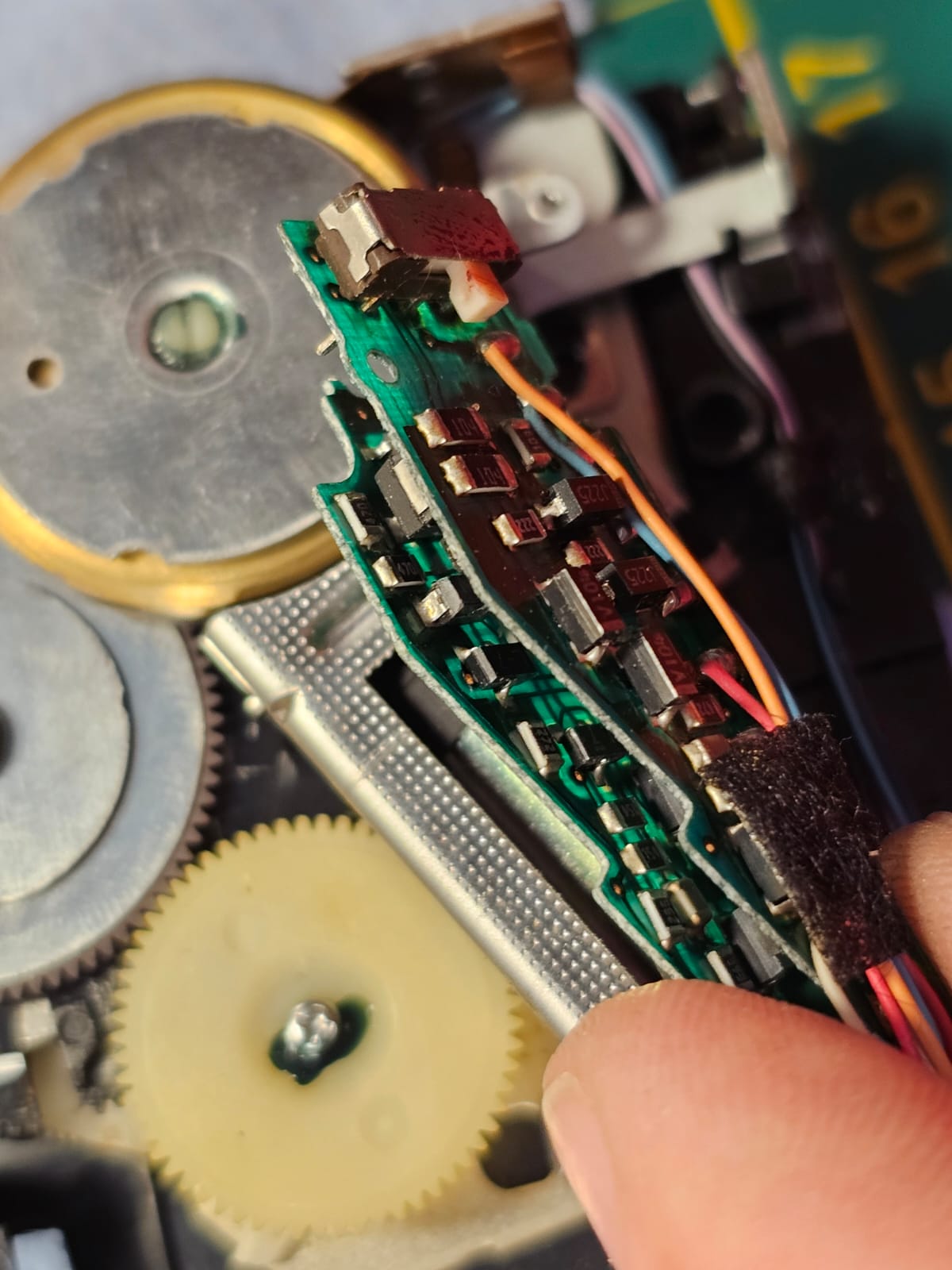

    The small PCB on the bottom left is the DOL circuit that set the DD-100 apart at that time.

    It's an interesting stack of PCBs with - fairly novel at that time - SMD only with PCB interconnects at the side. No PCB vias, just soldered elements to connect both sides. I guess dual-sided PCBs and SMT components were pretty new back then.
