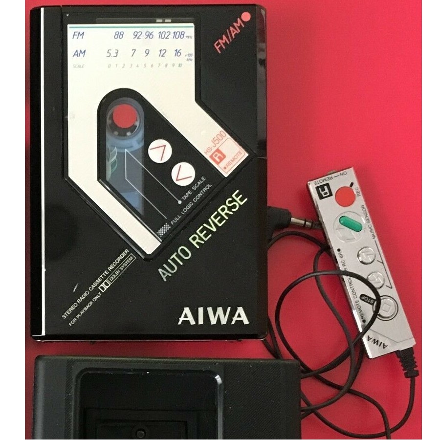

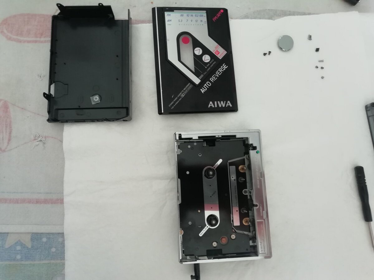

  5. Silver965
    Silver965 Well-Known Member
    724
    Torino
    Can I ask if when you disassembled it you noticed that it has two Sony chips?? ...mine and the J500 that I disassembled and refurbished a few months ago...I ask because externally they seem identical...
    do you have any photos of the inside?? to see if there are any differences

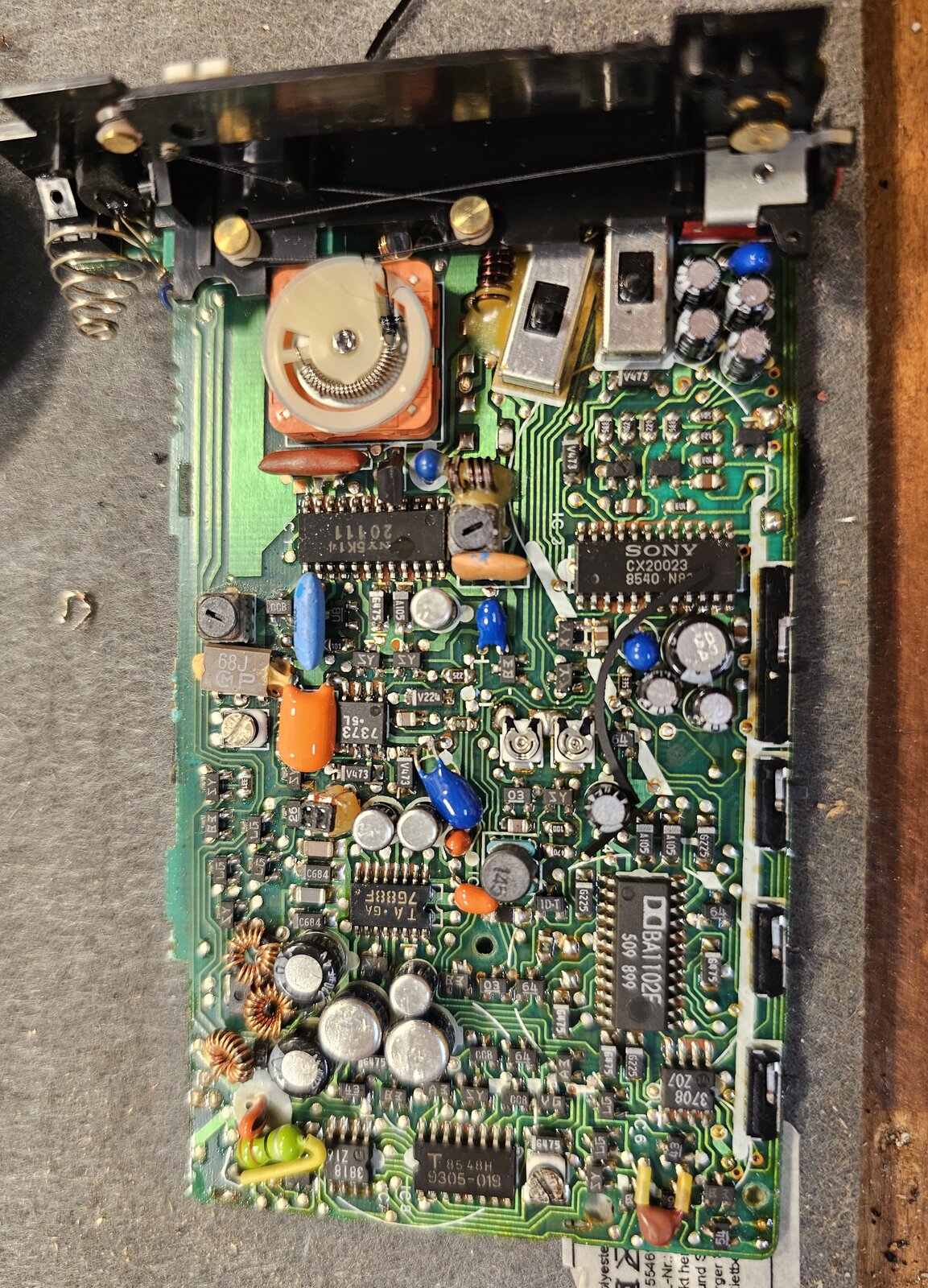

  8. Timewarp
    Timewarp Well-Known Member
    265
    The Netherlands
    Found it!

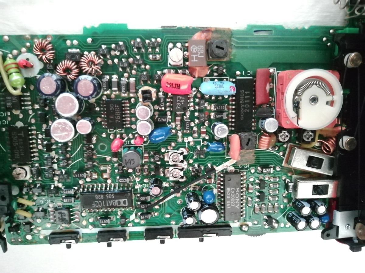

  15. Silver965
    724
    Torino
    Thanks @Timewarp for sharing this
    But putting the photos side by side .. there is a small difference on the radio
    Emiel and Michiel like this.
  16. Timewarp
    265
    The Netherlands
    Nice analysis Silver965.
    The J500 has 2 potentiometers, a different capacitor (tantalum/electrolytic) and some different coils.
    The potentiometers are presumably to calibrate upper and higher limits of the FM band corresponding to the region.
    It confirms the theory of country specific frequency range for the FM tuner.
    I guess:
    J8 - Japan tuner
    J08 - Europe tuner
    J500 - US tuner
    And other than that they're the same.
    Makes sense?
