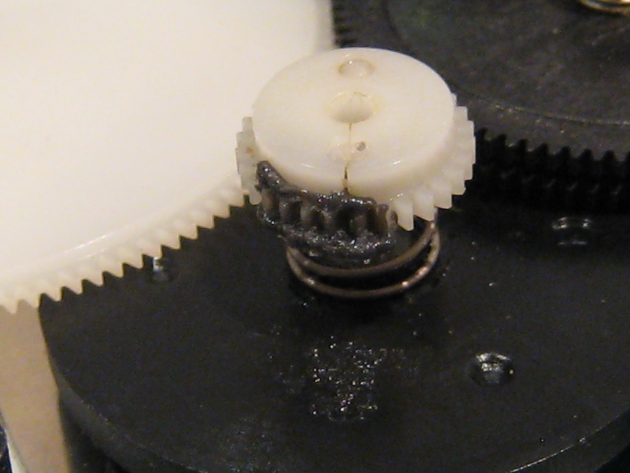

    Is the crack in the gear a radial crack (from the centre outwards)? It may be possible to repair it using polyester resin and carbon fibre.
    I repaired a cracked nylon gear on a WM-22 a while ago. Over time the nylon had shrunk and the steel spindle hadn't, so the gear eventually cracked. If a similar thing has happened on the KT-VS1, then if you buy a spare unit, it may well have the same problem.
    Somebody had previously tried to repair the WM-22 gear using a lump of glue. I cleaned off the old glue and scored a groove across the crack and filled it with carbon fibres and resin. Carbon fibres are very strong under tension. Once it had set I reamed out the centre hole so that it would fit snugly onto the spindle.

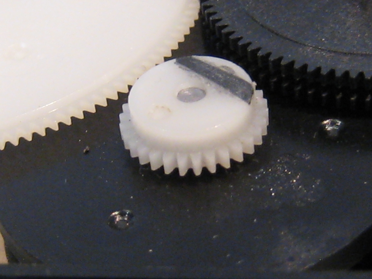

    Before repair.
    After repair.

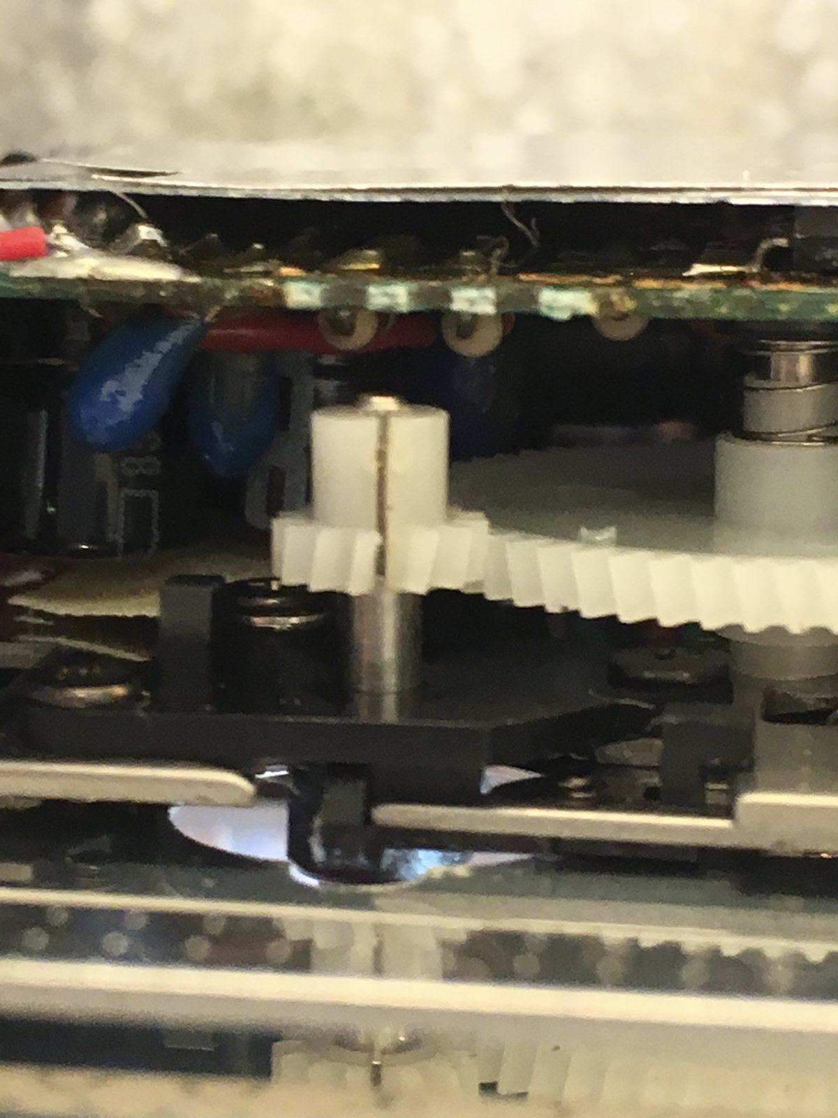

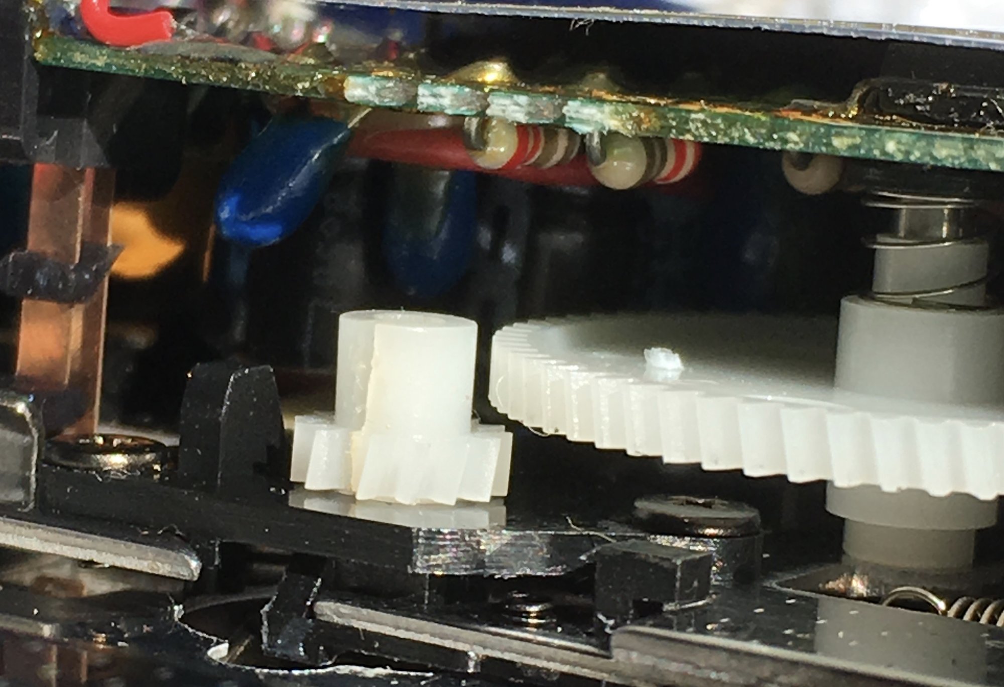

  6. Chestnut
    Chestnut Member
    39
    Cambridge UK
    So here now is a picture of the gear. It's tiny - approx 5mm diameter, and you can see the crack very clearly. I've now removed it from the spindle to repair it. I'm wondering how I'm going to get a 'thick' epoxy glue into the gap, and how best to clamp it to close the gap. Any advice anyone?

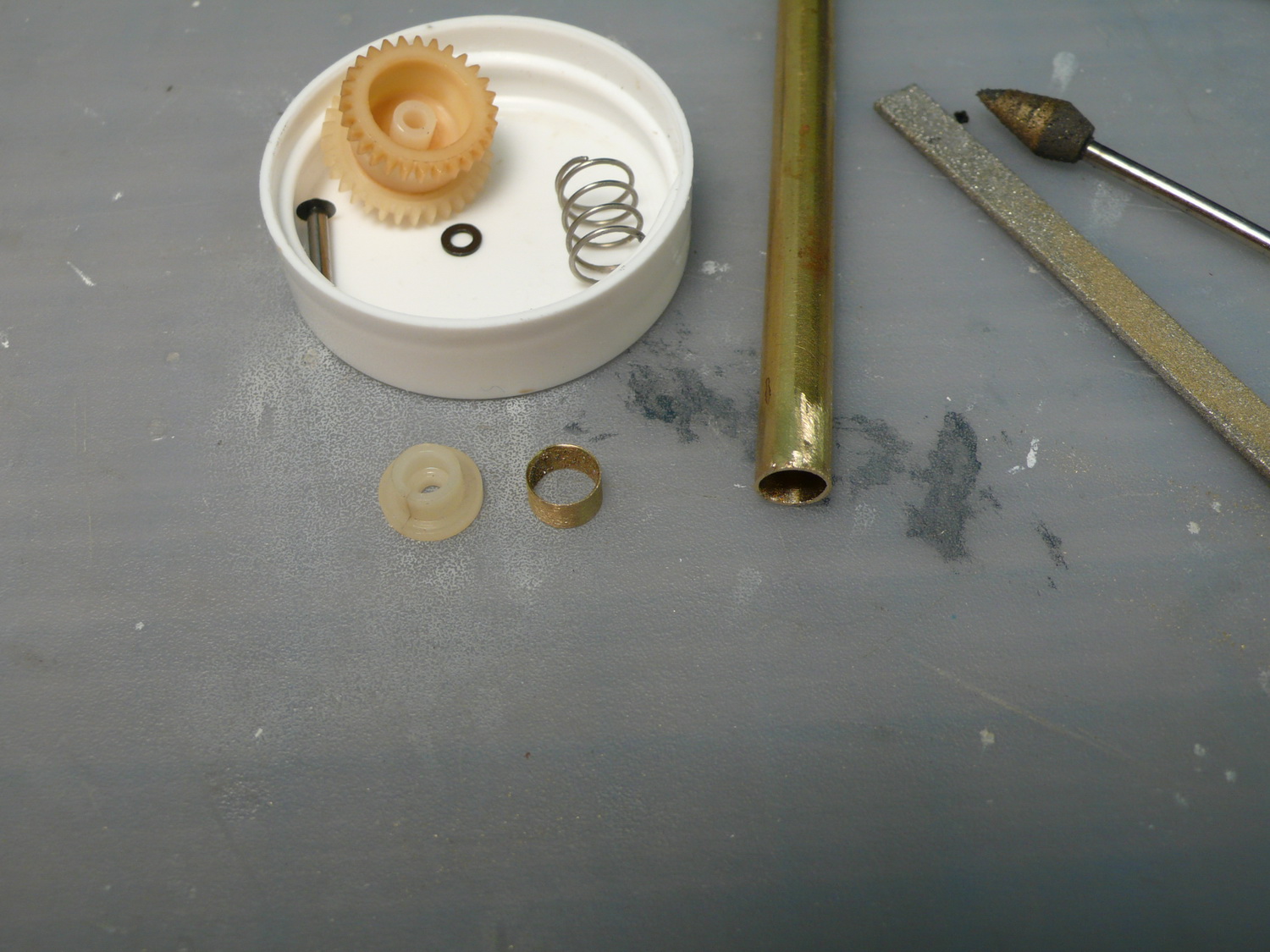

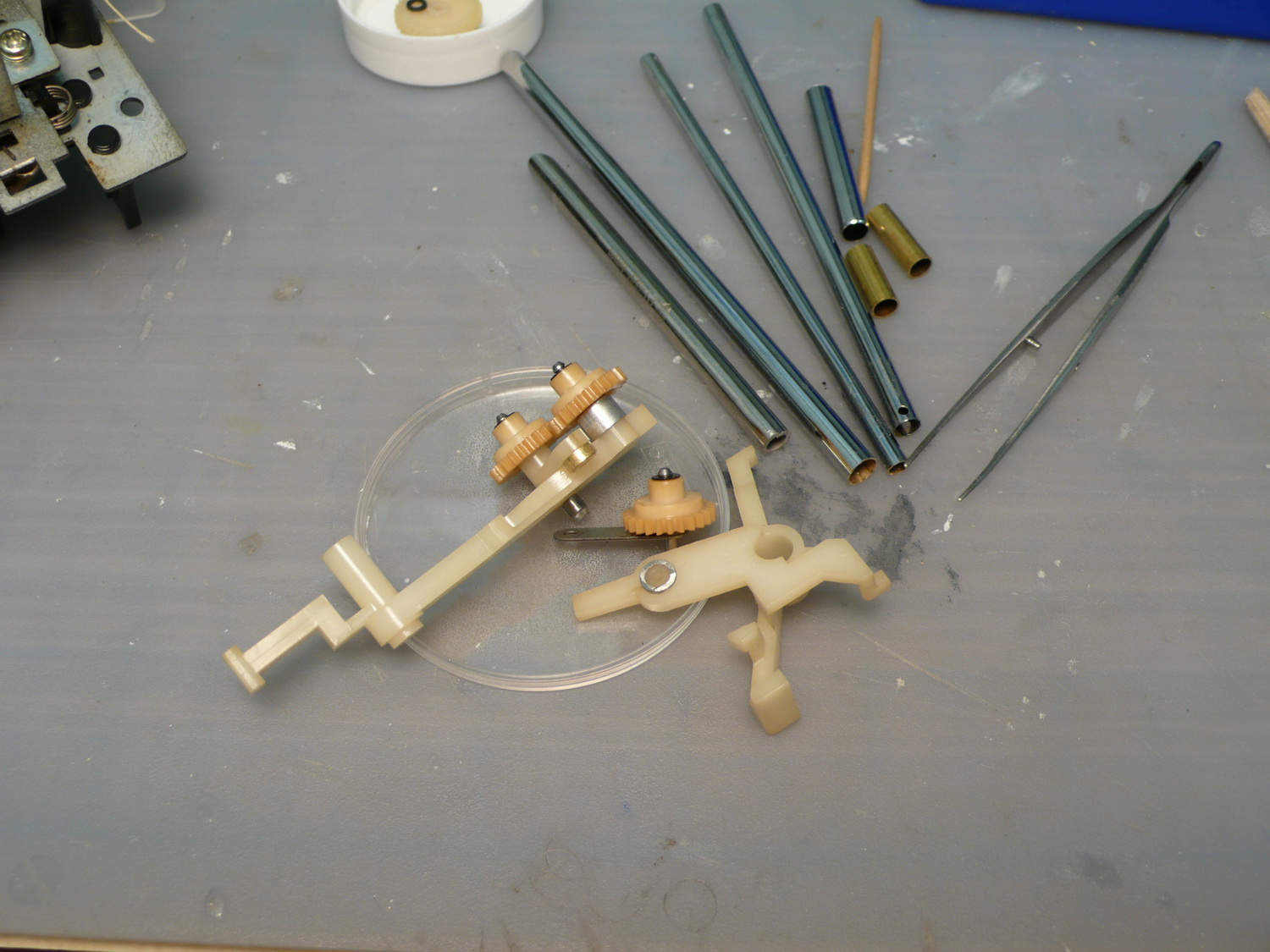

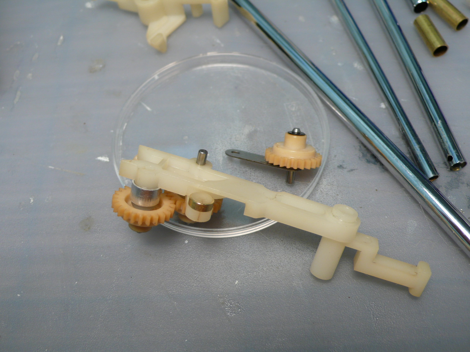

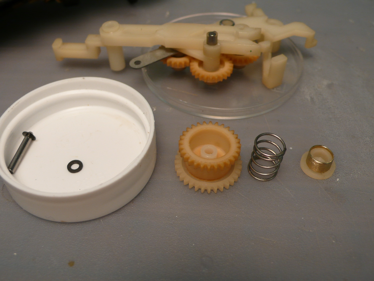

  9. Jorge
    1,794
    Not knowing about polyester resin, I used metal sleeves to fix cracked gears on Sencor S-4800. Discards of brass tubing available off eBay for next to nothing, old telescoping antennas supplement the set :)

  11. Chestnut
    Chestnut Member
    39
    Cambridge UK
    I like this option, but I have very little space to play with (see pic) and it would need a very thin-walled piece of tubing. I guess that if I could find a slightly undersized piece of tubing, I could gently remove some of the body of the plain part of the gear to get it to fit and not rub on the bigger gear. How best to cut the pipe when they are so small?
  12. Jorge
    1,794
    I used diamond Dremel cutting wheels and also X-ACTO Blades. X-Acto sold for wood but they cut brass/chromed brass/aluminum tubing like butter ;)
    From my last photo you can see that I had this same problem. I set brass tubing (over a drill-bit) into a drill, then at low speed shaved off extra thickness with diamond file.

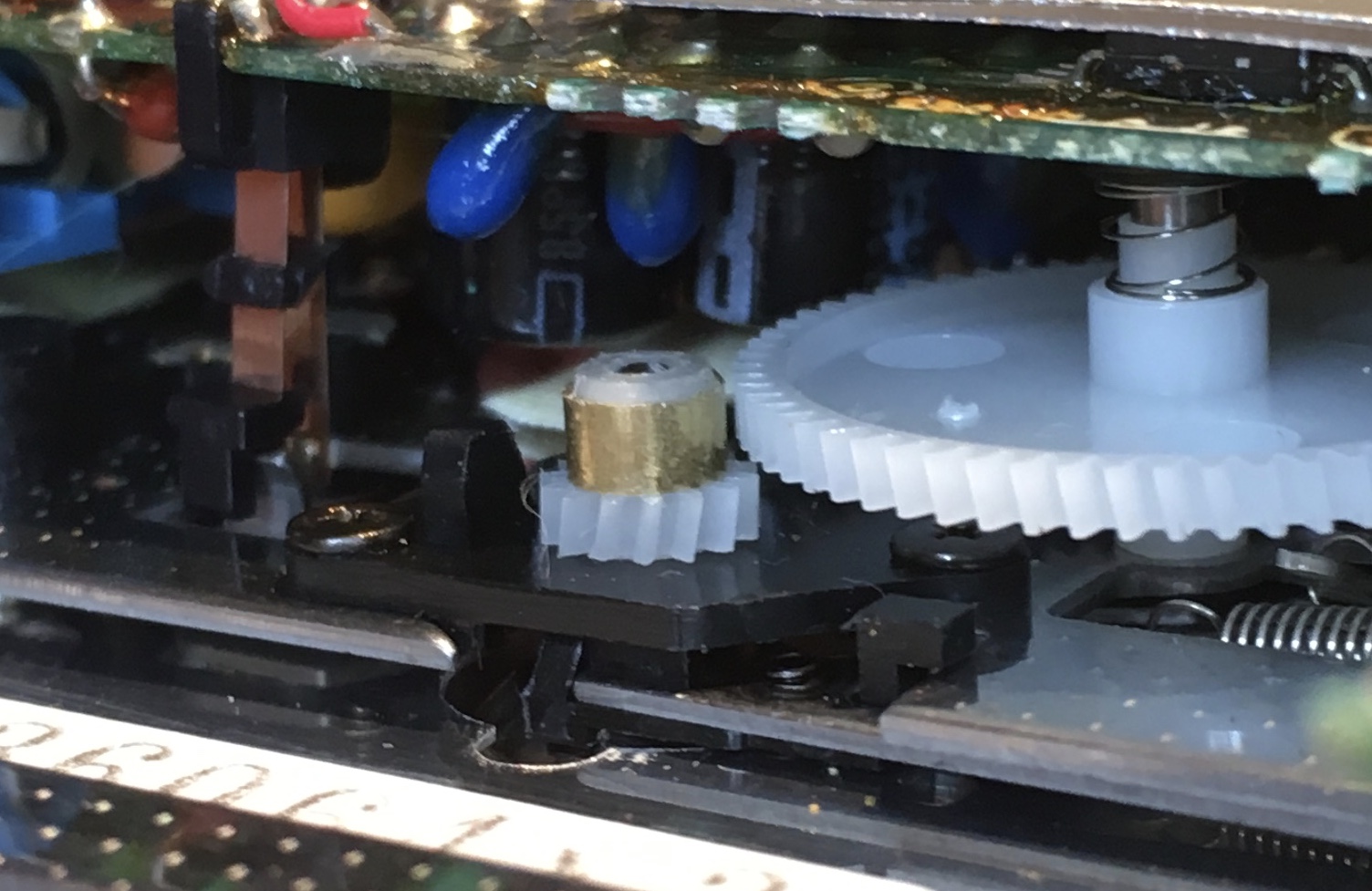

    OK, so here's an update, and I have to say I have a very pleasing outcome, pics attached. Once I'd seen the idea from Jorge about creating a metal sleeve, it immediately struck me as the best solution as it represented a very similar approach to how servos are strengthened in radio control stuff, which i used to be into. So I did the following:
    1) carefully measured the blank end of the gear piece and estimated what size it would be closed (bang on 3mm I thought).
    2) Purchased a 3.5mm outer diameter K&S brass tube, thin walled (0.225mm, as a needed to make sure this gear didn't snag the larger one, not much room to play with) off eBay for about £3.40 posted, which arrived today.
    3) The tube came in a 30cm length, which was great so I could hold it properly whilst squeezing the gear gently to close the crack and see if it fitted. It did, pretty much perfectly, though I tried both ends of the full length tube, and one end felt like a tighter fit.
    4) marked out the length of tube needed, using some masking tape wrapped around the tube to make it clear, and then cut it using a Dremel and appropriate circular blade
    5) applied a tiny amount of superglue via the tip of a pin into the crack, and fitted the tiny brass sleeve. Very fiddly but I got it on eventually.
    6) I then tried it on the spindle, and it was too tight, leading to the crack opening up on the gear-end of the gear, so the teeth were no longer uniformly positioned and so
    the winding action was noisy and clunky.
    7) I then used a 1.6mm drill bit on a slow setting on my Dremel, holding the gear on the bit, and gently increasing the size of the mounting hole. I did this 3 times, going back and forth with re-fitting the gear to the spindle, and eventually had a very nice snug fit but with no fractional opening up of the crack. Having tested the winding on this spindle, it is now smooth and quiet - perfect result.
    Job done, and thanks everyone for the advice! The player now functions perfectly, and sounds great too!
