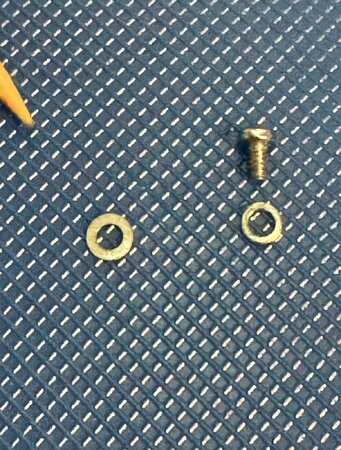

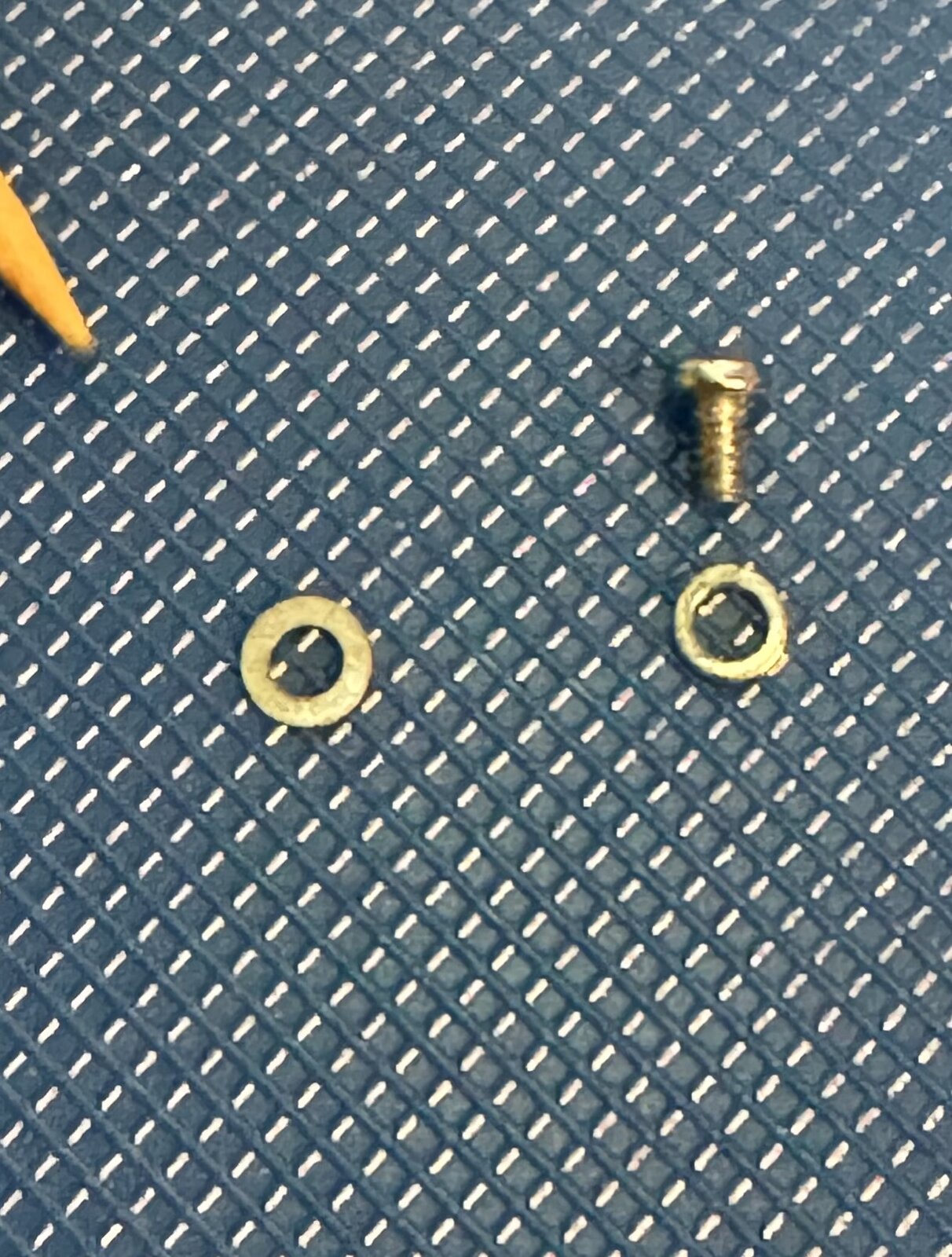

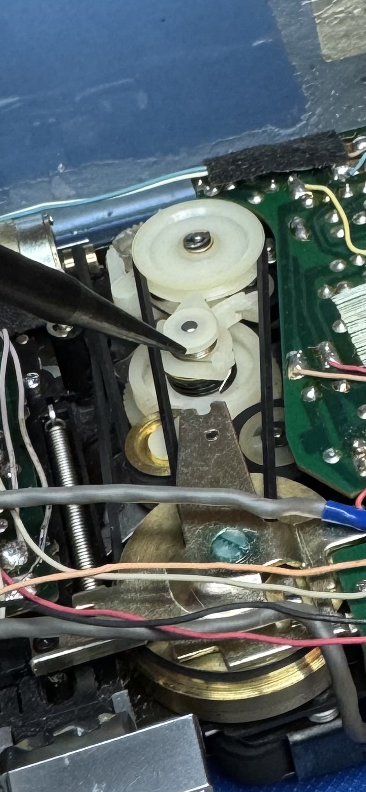

    I replaced the pinch roller and put a thin small amount of super lube on the auto stop cam lobe and the other cycling pin / slide plastic part of that assembly. It’s the same if not slightly worse. I’m currently at a loss of what to do next. Here are two more pictures. I didn’t disassemble or do anything with this portion of the auto stop. Is that possibly a source of friction? And embarrassingly, this METAL washer was stuck to the motor. I can’t find in the assembly drawing where there are metal washers other than on the ground connection screw on the main circuit board. The mystery one is on the left. I put the circuit board screw and metal washers other than next to it for scale. It had to have come from this unit but I don’t know where. I’m generally careful and put each screw or set of screw in their own plastic closable containers, labeled.
