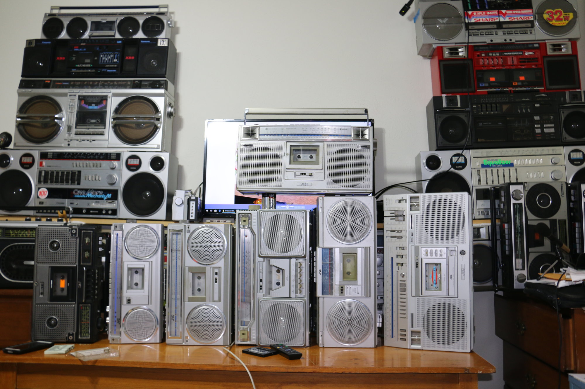

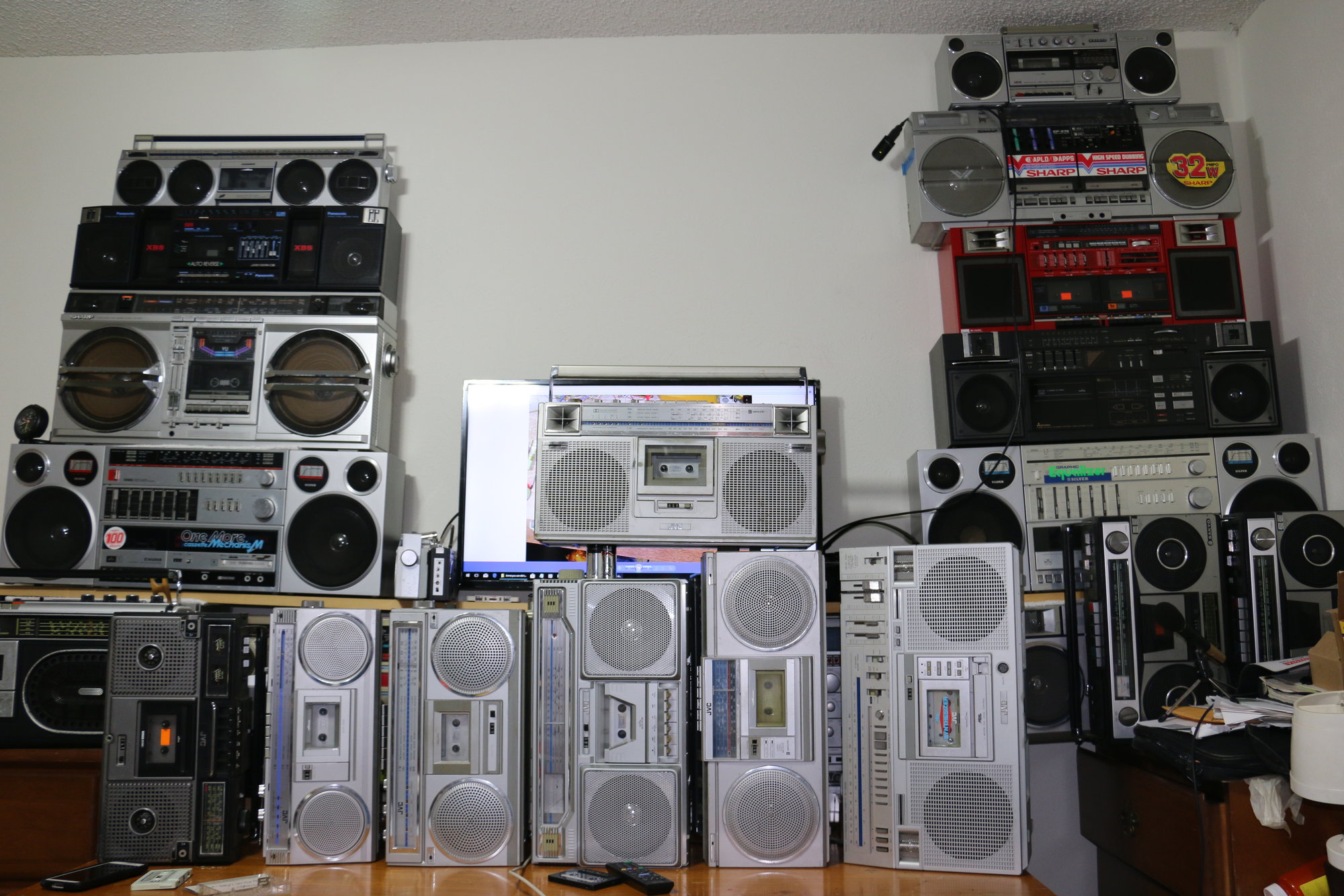

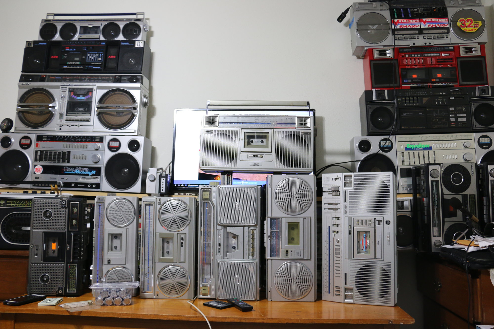

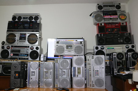

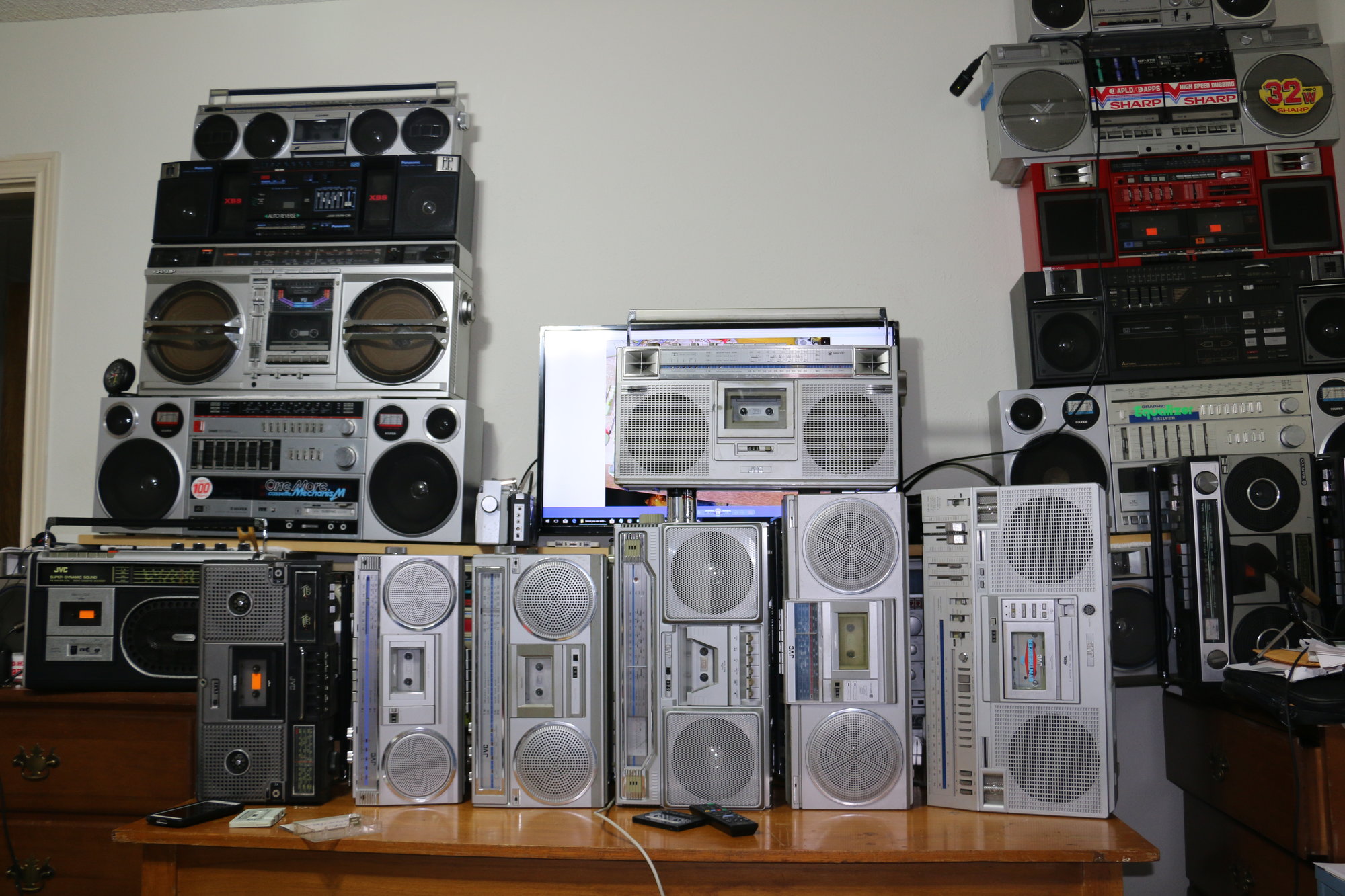

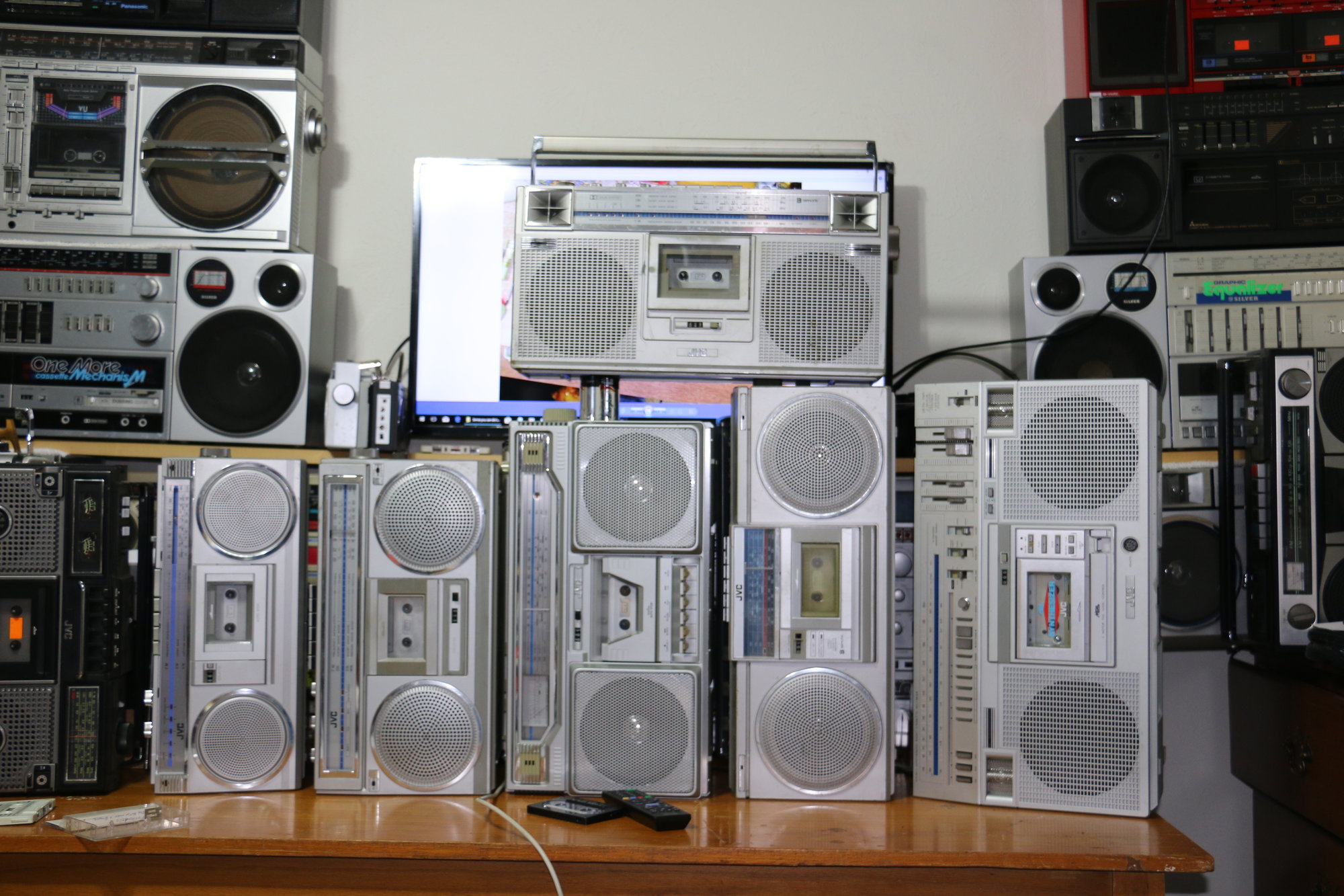

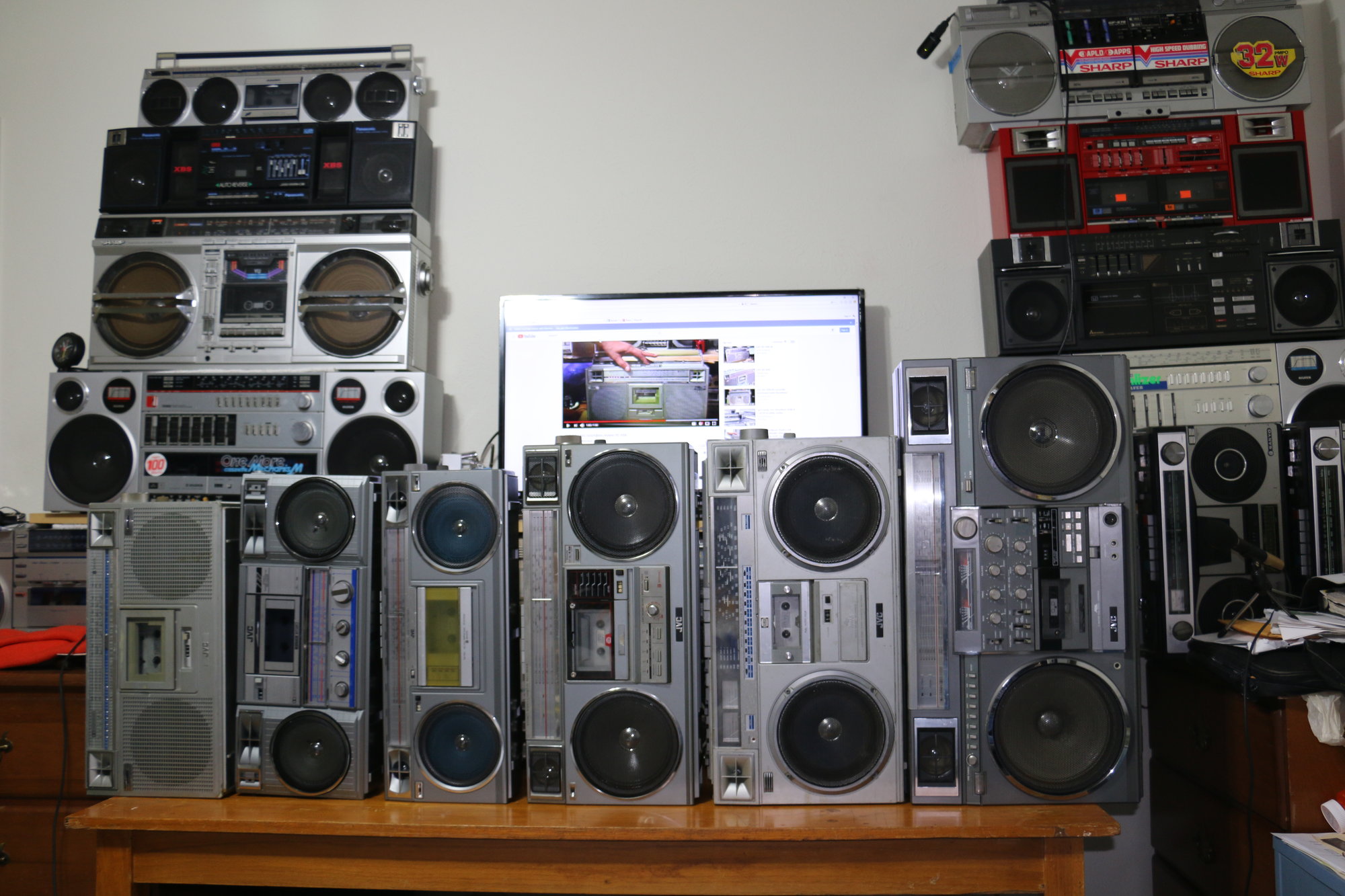

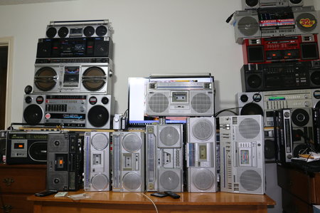

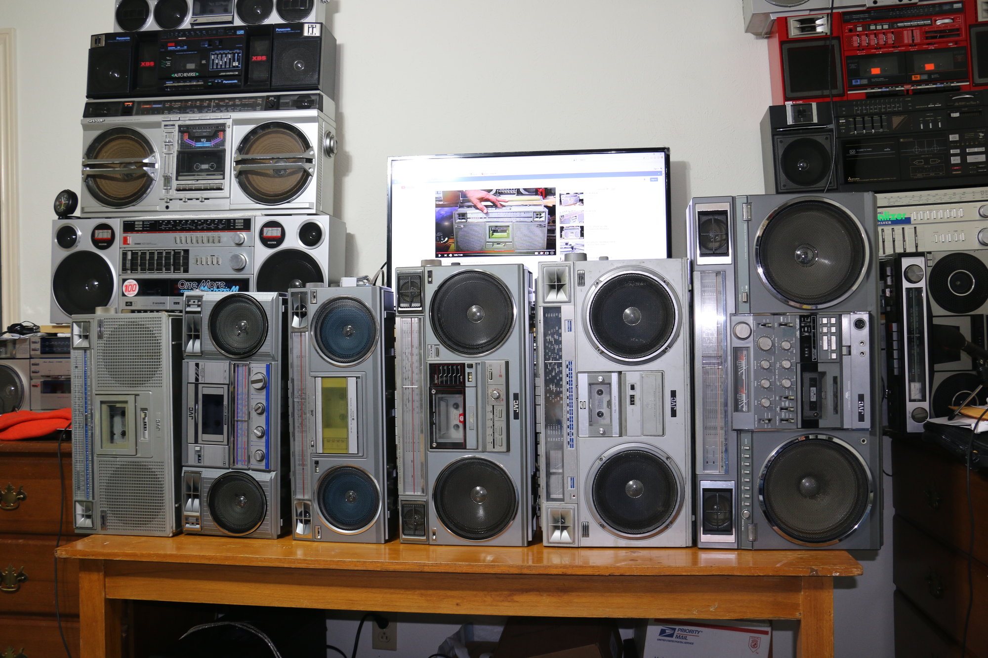

    I have a similar issue with a jvc rc-575 here is a few pictures of it as you can see with different exposures It is Green in color
    I wish I knew of a solution to get this back to clear too?
