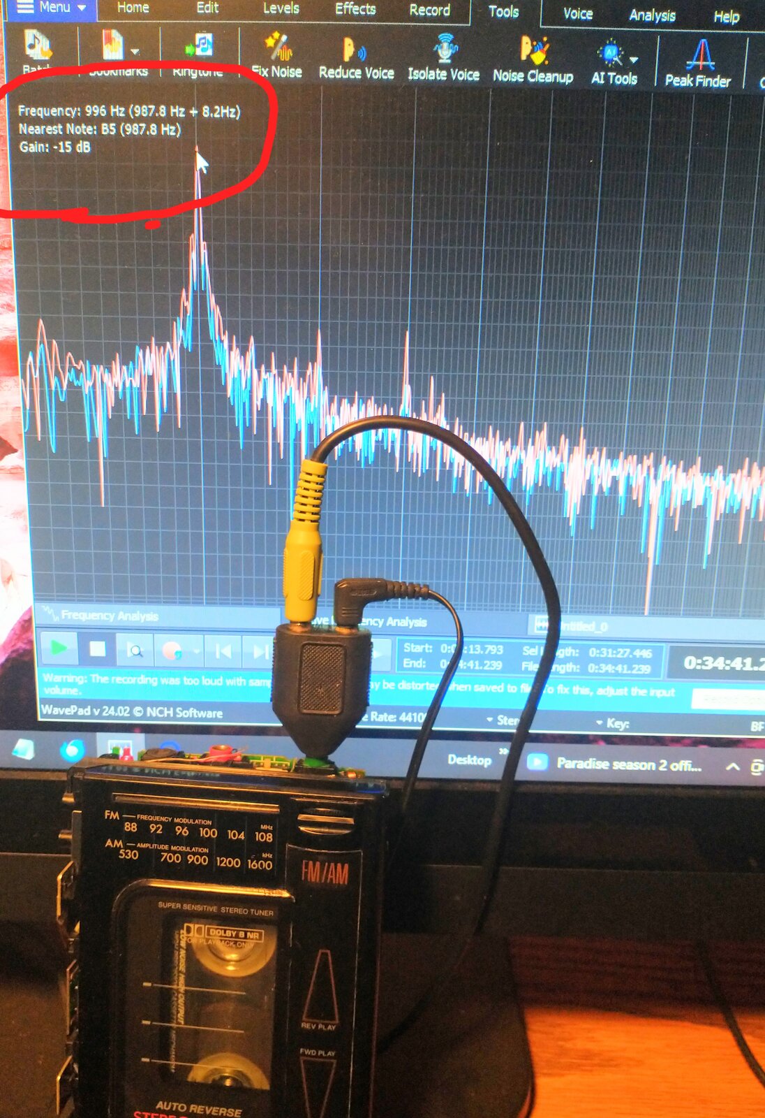

    I've been adjusting tape speed and azimuth on Aiwa HS-J9/09/600/36/360/10 by ear. I understand this is inferior to instrumented adjustment.
    My method was to adjust speed on a commercially recorded cassette so the music sounded "right". Adjusting the head comprised looking for the "brightest" tone while also trying to get the same volume from both channels. So prerecorded cassettes played in stereo, using earphones, would sound centered. Presumably commercial cassettes are properly balanced, and typically the lead vocalist is centered.

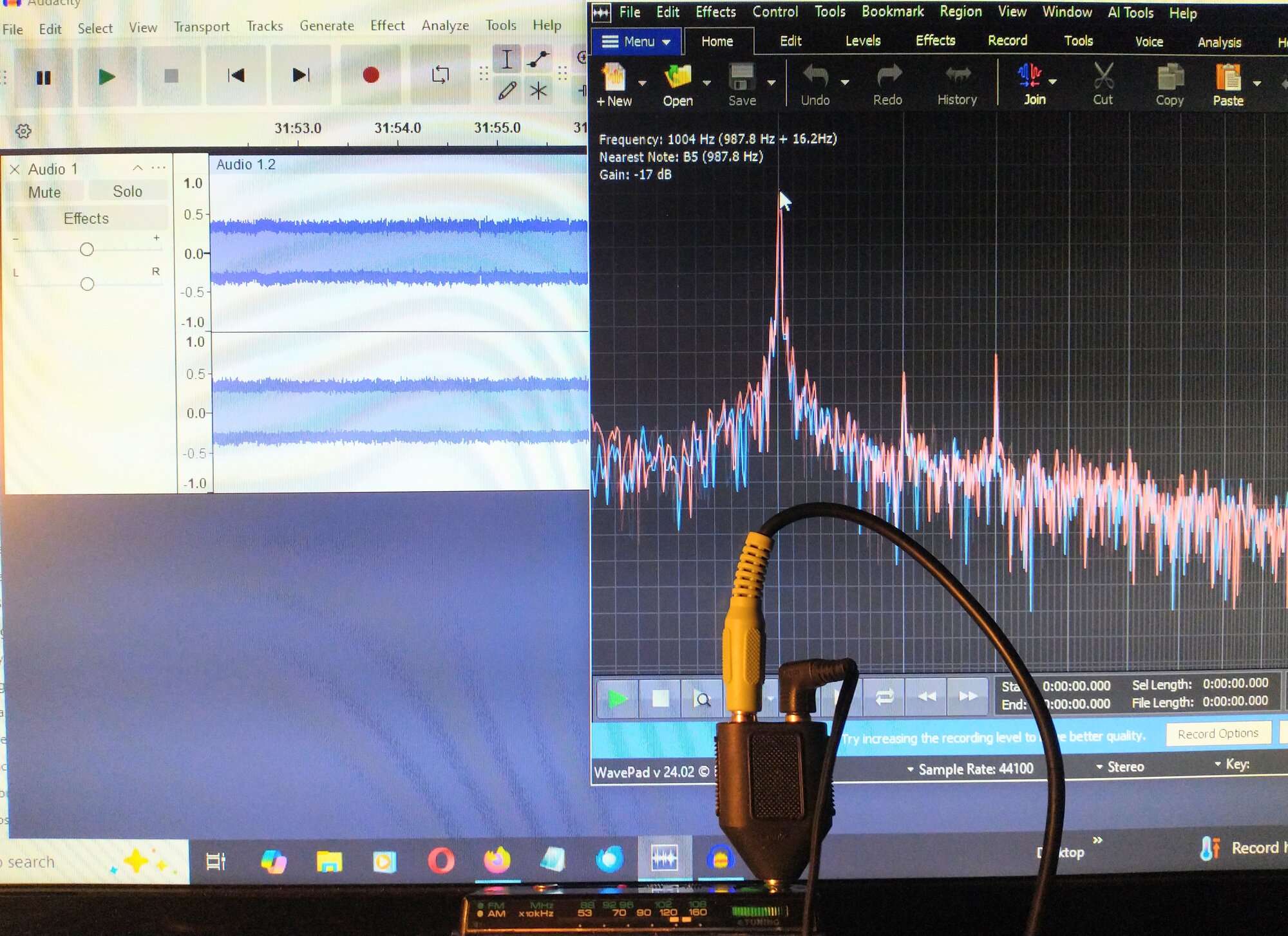

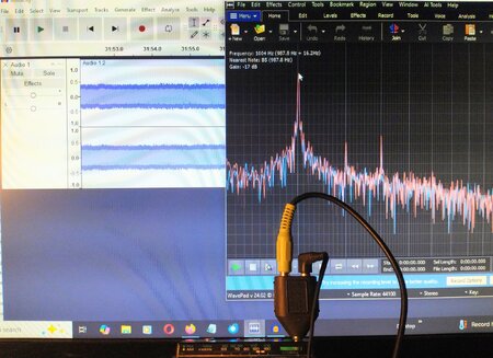

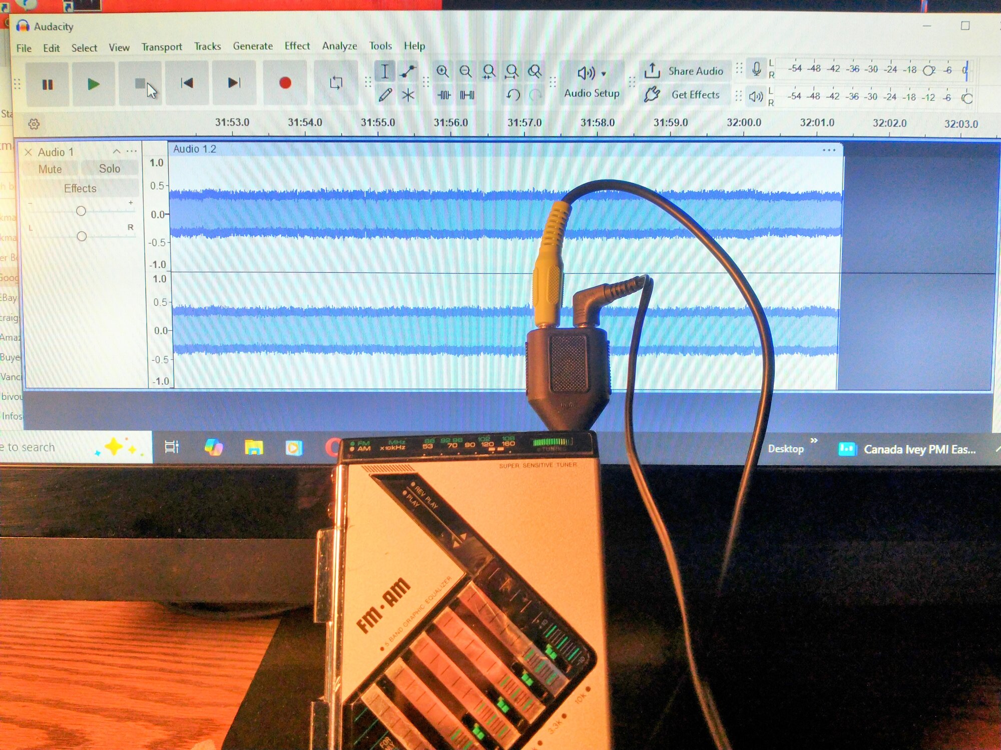

    I realized Audacity could be used to check channel balance. Channel balance should equate to head alignment.

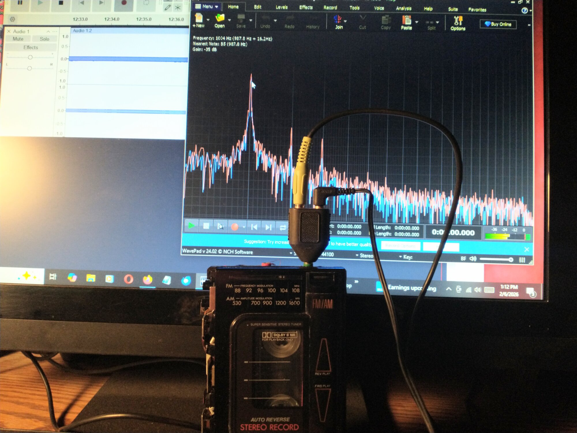

    I obtained a frequency test tape and installed an application with frequency display, on a pc. The application I used has a pro version with specialized frequency analysis tools, but I used the basic free version.
    I tested several of the players I've repaired and adjusted manually.
    I plugged the players' earphone jack into the computer's microphone jack and played the test tape. I boosted the volume to broaden the channel tracks for Audacity to see if the volume of the two channels was equal. They were.
    Turning to the tape speed and the frequency analyzer, all of them were bang on the 1000, 2000 and 3000 frequencies. (The application wouldn't let me center the cursor on the maximum peaks between 996 and 1004 hz.)
    I tested what was going on by pressing on a pulley to slow the tape. The peaks displaced to lower frequencies as would be expected.
    So. Is adjusting head positioning and tape speed by ear as effectively good as using fancy instruments? Is using the software as good as using fancy instruments?
    In fact I've found that just positioning the head in line with whatever it attaches to is pretty accurate.
    It seems odd these players don't need instrumented tape speed adjustment after an initial manual adjustment. Why are these players moving the tape at the right speed whatever their history? I find it hard to believe my perception music playback speed is that accurate. Or does the tape drive electronics in these players have a speed regulation function?

    As far as speed adjustment goes, if you use a song you know well, you can get within +/-10Hz just by ear.
    But there's another variable that has to be taken into consideration: the pre-recorded tape itself. How do we know the speed on that is correct ?
    After all, what we're doing is tune our device to that tape, whether that's a good reference or not.
    In my opinion, the best scenario for recording such a test tape is to use a quartz lock deck, since those don't have speed adjustment and the quartz itself is very stable and has minimal long-term drift.
    Of course, at the end of day, the by ear adjustment on a commercial tape can be good enough, but not perfect.
    As far as stability/drift, once the speed is set correctly wouldn't expect it to drift significantly since all these motor speed regulators use precision references and feedback.
    Azimuth indeed can be adjusted accurately just by making head parallel to the head bridge. That's what they did at the factory with all those non-adjustable units and with some adjustable ones too.
    Also the capstan plane has to be perfectly perpedincular to the head bridge plane. Which is not the case in center gear DDs for example, hence why on most of these the factory adjustment is wrong.
    Then the method of using a pre-recorded tape also can render good results, but has the same potential problem as in the speed case.
    Yes and no, depends on the frequency this balance is measured at. You can have perfect channel balance at 400Hz and singificant imbalance at 10kHz.
    When it comes to azimuth, the higher the frequency, the more precision in the adjustment. The minimum I would suggest is 6.3kHz for such adjustment.

    I redid the testing using 7000hz, and indeed there was room for more precise speed adjustment. I can't get the graph to register exactly 7000hz only because the granularity of the software jumps by ~15 hz at those frequencies . I figure 6996+hz is good enough. That also undermines my speculation these players have a built-in speed regulator.

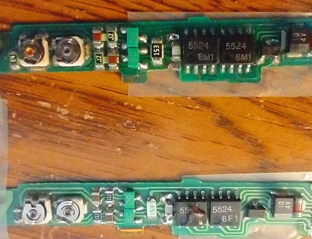

    [QUOTE="novrain2012, post: 90728, member: One thing I found about my J9 (maybe just this unit) is that the tape speed may drift up ~30hz or 1% on both directions, when the player is fully assembled. I guess it’s some heat stability issue when back cover is on. A little bit odd since J9 has a dedicated regulator circuit for each direction.[/QUOTE]
    These J9/09/600 and similar have minimal clearance between the rather flexible main board and the pulleys. But probably if something is rubbing because of fitting the back cover, there would be a scraping noise. Maybe not if it's a wire rubbing.
    I've been testing mine with the back cover off, so I can access the speed adjustment screws on the motor board. But given your observation I'll repeat the test with the cover installed.
    I have a bunch of these models. They are all slated for speed etc. testing. So I'll be able to determine if the change in speed with the cover installed is common.
    All of mine sound good to me, but it adds to their value if I can say they have been tested and fine tuned like this.
    Is the motor speed regulation circuitry on the motor board? Although the same board is used in many Aiwa's with the 2ME-7 mechanism, unfortunately there are no circuit diagrams for it.
  11. Valentin
    1,994
    Yes, the regulation circuitry is on the motor board.
    Seen that before motor + servo being treated as a single unit by the service manual.
    One possible reason for that is they got that manufactured by a 3rd party and they bought it as a complete assembly.
    These AIWA slim motors are made by Namiki and it's possible they designed the servo too based on AIWAs specifications.
    However these servos are pretty simple, using a single IC, sometimes even with the drive transistor integrated and some passives around. Should be easy to identify the chip itself.
  13. Valentin
    1,994
    It's an LA5524, seen this IC in a couple of other walkmans although not the most common.
    I think the drive transistor is also integrated into the chip, as the 3 discrete ones are a bit small.

    Replacement bare motor boards like this are being made in China. A lot of the Aiwa's that use this board mount it right next to the internal battery compartment. In fact the batteries rest against the board. So when the batteries leak the board is the first thing to be ruined. Which in turn would be common enough to make it worthwhile to reproduce the boards.
    They are available as a bare board, or with all the components except the two ic's. I've ordered two of the populated boards and hope the chips on my corroded boards are ok and that my soldering skills are up to swapping them over. The chips, or substitutes, are also advertised separately. It's surprising, so far as I can determine, that none of these populated motor boards are available with the ic's mounted.
