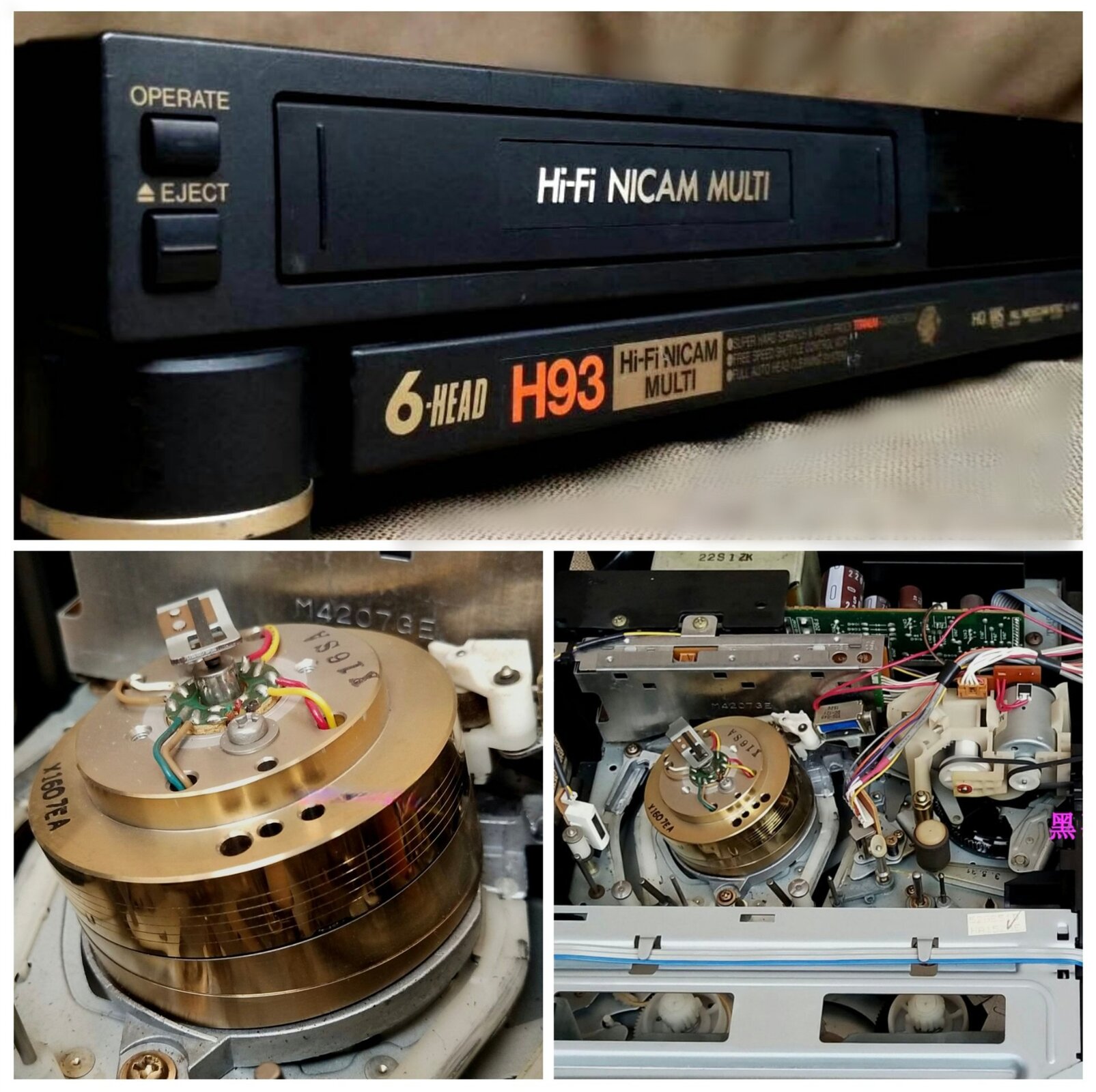

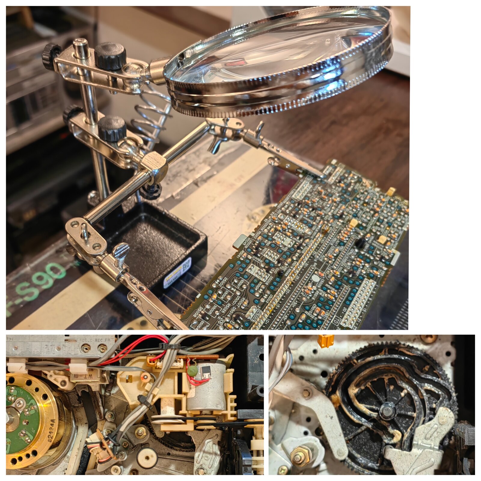

    Was never own one before but started collecting after getting my hands-on...out of curiosity. The analogue sound quality really blows my mind..much superior over cassette tapes. Just score another unit recently to my collections, spent hours of restoration. Now I have 4 units mostly Sony and I recommend one should try venture

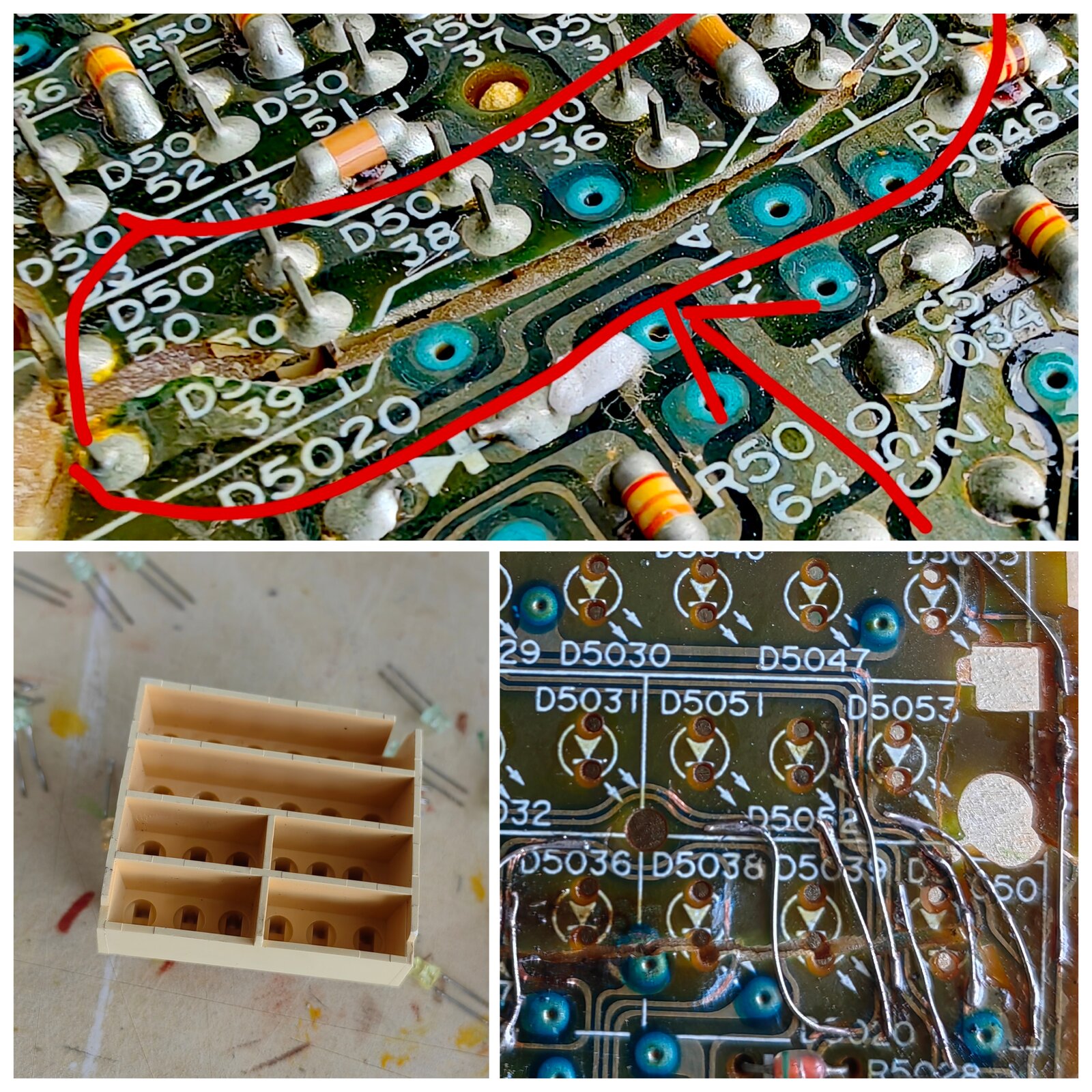

    This unit Sharp model VC-H93 (titanium head drum) from the late 80's, front control panel board cracked due to rough handling by the courier service.
    Painstakingly reattach back the broken traces..worst case this is a 2 layer board.

    Great work @Ken80s ! Several times I have come across broken pcb's , although dreadful to see, at the end had good results, certainly a painstaking job.
    I use cyanoacrylate glue to bond the broken parts , for me it works really well.
    Titanium coating to drum head , brilliant !

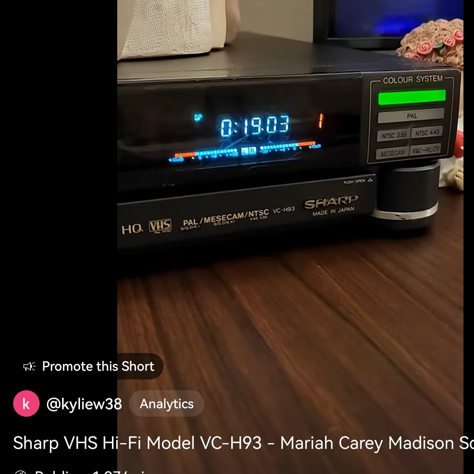

    The tv picture on your video looks also great.
