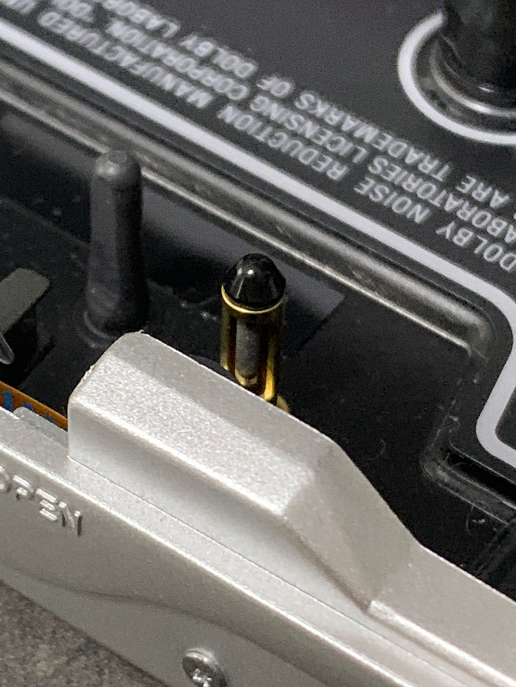

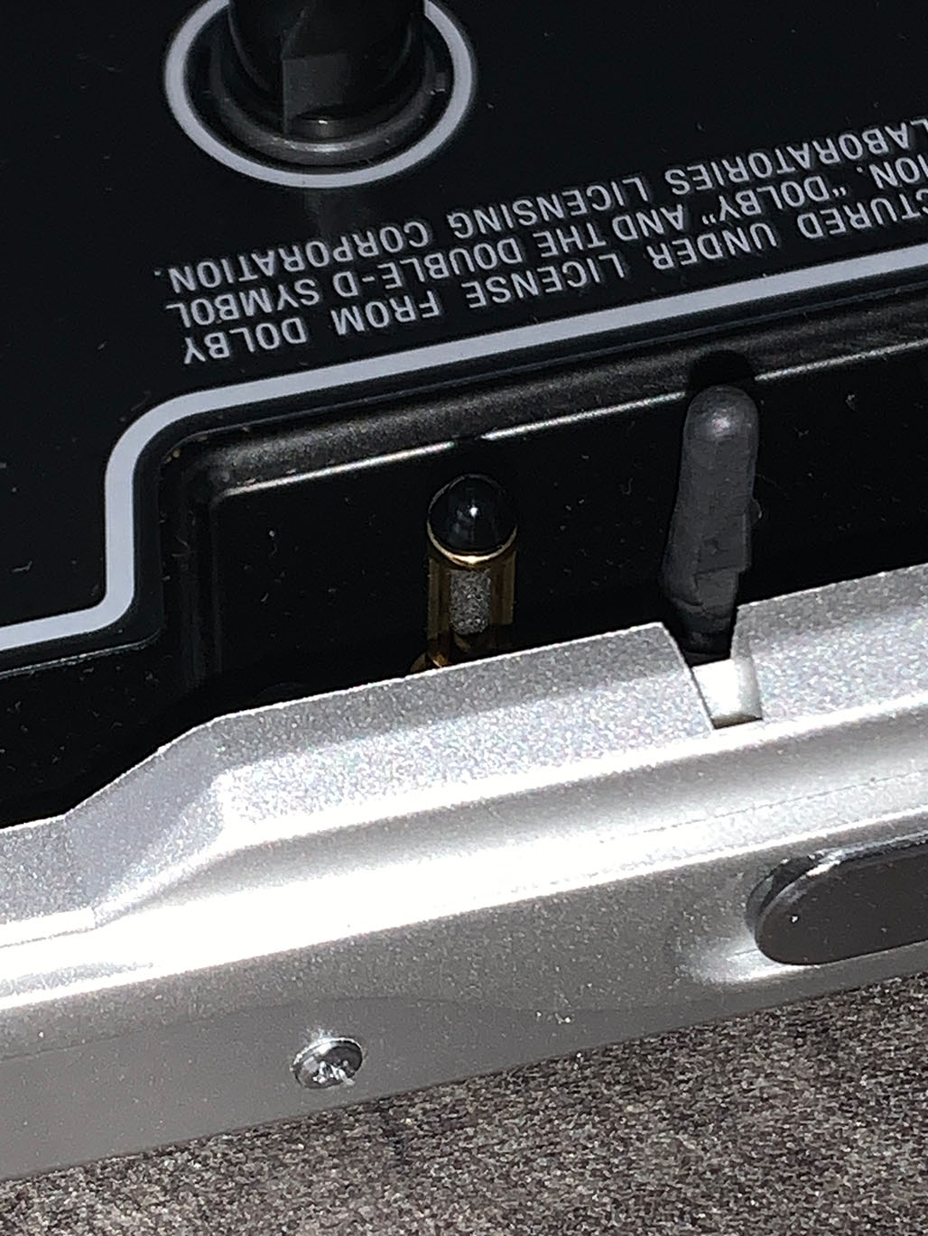

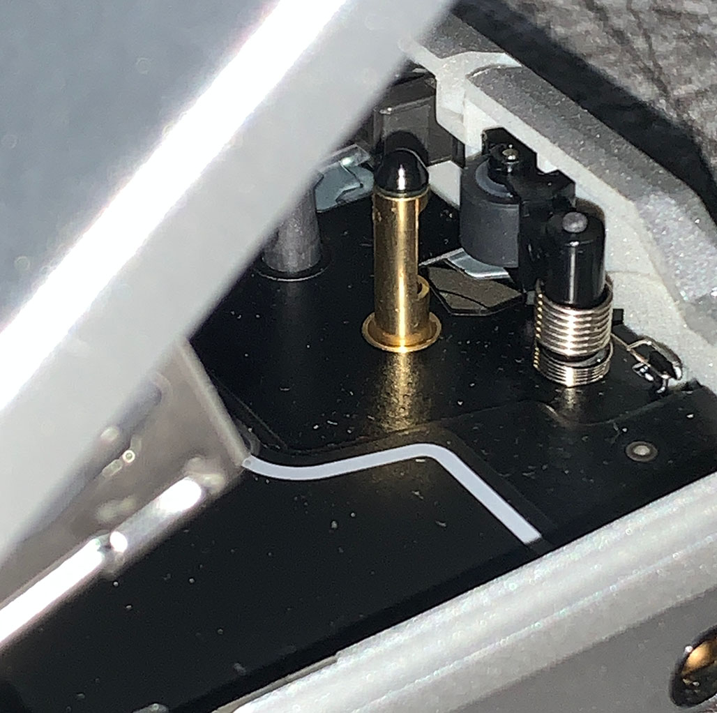

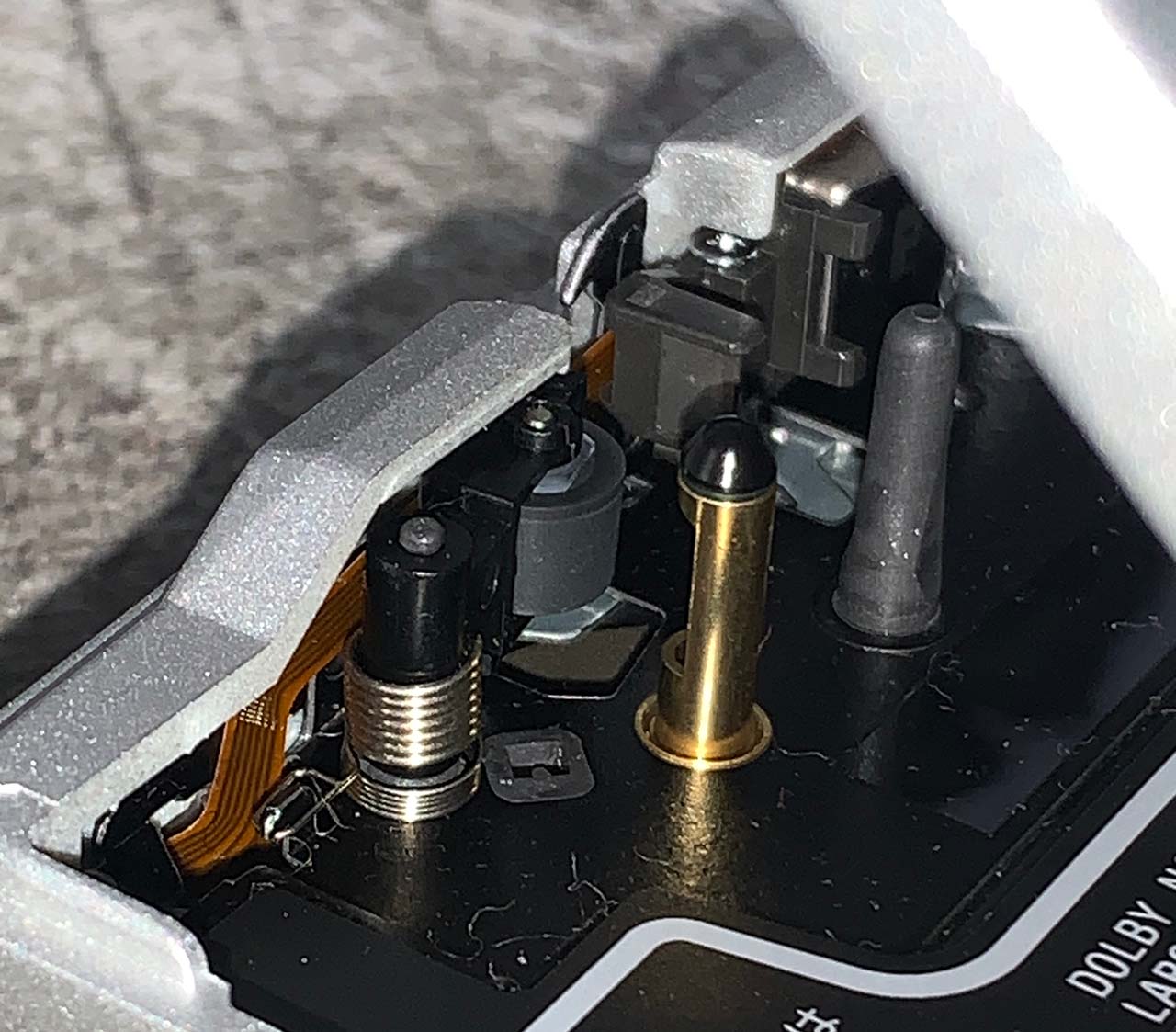

    Attached are 4 photos of the outside capstans and pinch rollers for reference. I don't have photos of the internals as it is a bit late for me and will most likely tinker around more tomorrow.
    Right Capstan
    rough surface is coating I presume.
    Left Capstan
    Right Pinch Roller
    Left Pinch Roller
    (I did clean the insides after these photos, sorry for the dust and some particles on the rollers)

    1. Would a lubrication of the capstan bearings provide a good start to troubleshooting this issue? If so:
    1.a. After I do so, during the cleaning phase whereby I need to get rid of any excess oil on the capstan itself, how would I go about doing this? Ideally I would run the machine with FF to turn the capstans, but what part or latch in the WM-EX633 would be responsible for tricking the machine into thinking there is a loaded tape to do so? If that makes sense of course.

    2. Finally, would the pinch rollers themselves have an issue regarding how much contact they have against the capstan? This could be a factor considering it seems like the issues stem from that contact spot. For example, when I rewinded a tape (luckily it was a spare tape I had for test purposes) within the machine, it seemed to stutter and chewed it up, rolling the tape into the pinch roller, or otherwise, the battery LED flickering. If so, what would I need to do to lessen or alleviate this factor?

    The pinch rollers seem okay, but definitely worth a closer look and maintenance.

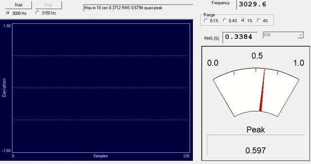

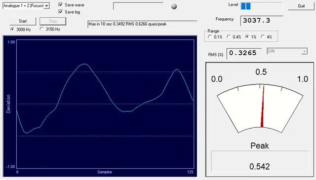

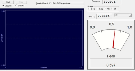

  6. Valentin
    1,985
    Looking at the W&F measurements, they actually don't look that bad. I expected to see something like 0.5-0.6% WRMS given the description.
    Average values are a bit above 0.3% WRMS with some peaks close to 0.4%. How much it lowered after the lubrication ?
    Tape speed has only a 7Hz difference FWD/REV which is well within spec, while W&F figures are about the same for both sides, expected REV to be much higher.
    Given the similarity between FWD/REV, this figure is likely not caused by the geartrain, rather something common to both sides (motor, belt).
    When the drive gear is worn, you would see way higher figures on FWD, like 0.45% on FWD and 0.2% on REV.
    Also, you need to set your expectations right. This mechanism is not going to obtain 0.1% WRMS figures, no matter what you do.
    On this mech actually a figure of 0.25-0.30% isn't that bad, but of course that will depend a lot on the type of music you're listening to as on some types even 0.2% will be very audible.
    Regarding the 3kHz you made yourself, that's more than good enough for this test as a deck will have W&F < 0.1%, while here you're measuring figures 3x that.
    The tape will only be a limitation when you measure units that obtain figures close to the deck it was recorded on, which is only the case for DDs.

    Hi Valentin! Thank you for your reply.
    I also expected a value around this range, as the listening experience postulated. I think the W&F experienced was a compounding issue of human error and the machine being inconsistent perhaps.
    Here are links to pastebins with each log for W&F after lubrication.
    https://pastebin.com/72snvF3b - FWD
    https://pastebin.com/t61MnNLQ - REV
    It seems regardless of my issues at the moment, the lubrication definitely helped. Sorry for the silly assumption if wrong, but the REV numbers being lower seems like a good sign.
