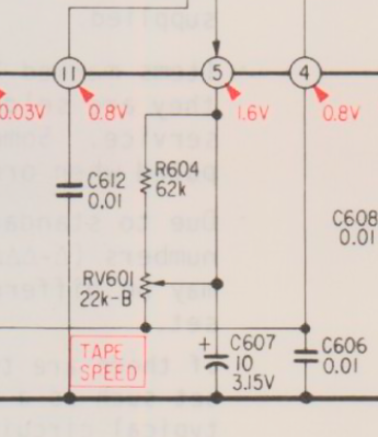

    EDIT: It seems if I touch RV601 (the speed pot) with anything conductive, even ever so slightly, the motor wakes up and runs full speed. I've tried cleaning the pot with deoxit already so I'm assuming it needs to be replaced. Looking at it under a microscope it looks like it has lots of green microscopic flakes on it. I also think the top piece of it was broken off already in a previous life - there's no notch for me to turn it with, I have to push it from the edge with a tool to get it to move at all.
    Looks like in the service manual its a 22K pot - I don't have any this physically small but I do have some I could use for testing at least - if that's the part I need then I'm sure I could source a smaller one to fit in here.
    EDIT 2: I replaced the pot and the replacement behaves identically. Grazing the wiper, even ever so slightly, with anything conductive boosts the speed past 3000Hz no problem. When I let go it falls back to something stupidly slow.... I even tried touching a pair of metal tweezers to the center leg of the pot (the wiper) and that also boosts the speed full blast. WTF? Is this causing some kind of extra capacitance that's fixing some other problem here? There's a tantalum filter capacitor directly nearby in the circuit (C607) - my ESR meter shows very high ESR, it fails the electrolytic chart... which is especially surprising for a tantalum... hmm...

    i was gonna say pretty much the same thing. spinning the reel lessens the impact on C607 a little, and keeps it running steadily for long enough that C607 can reach equilibrium and keep itself charged
    or somethin like that. most caps have their capacitance/charge rate go to stink with age. worth checking out the tant one atleast
    might be wrong and its one of the ~2-3 electrolytics around there. they look like bypass/decoupling ones so you might try testing those if the tantalum checks out after all.

    Looks like it. However these tantalum capacitors have higher ESR than electrolytics, that alone doesn't tell much.
    The unfortunate part is the symptoms point towards a faulty CX20084.
    Symptoms are very similar to what is described here https://stereo2go.com/forums/threads/sony-wm-dd33-speed-issues-and-more.9456/ and these do exist on units using CX20084 also.

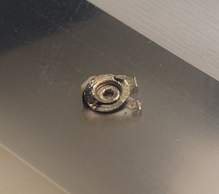

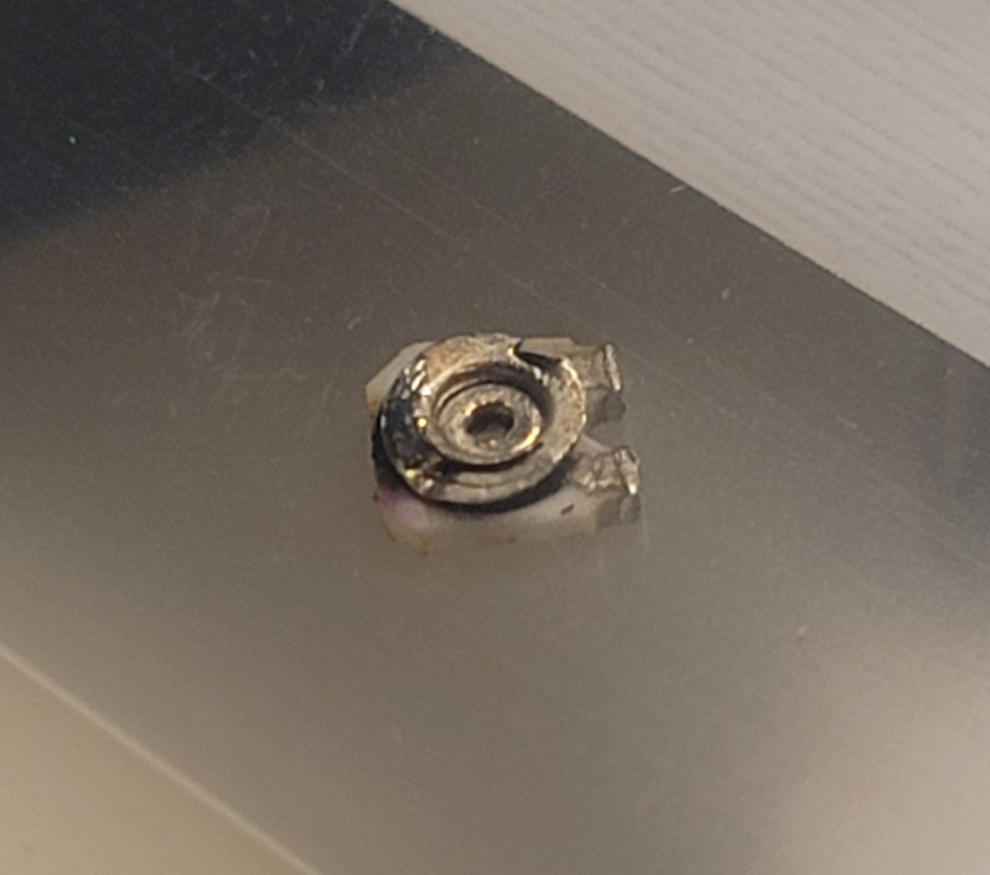

    Notice how the replacement clearly has a piece attached on its face to allow it to be turned by a screwdriver - mine (and some others I've seen online) have this piece missing and its nearly impossible to turn. Someone must have manhandled these pots back in the day. Here's what my broken pot looks like, for reference:
