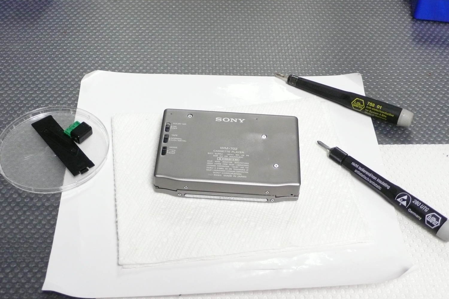

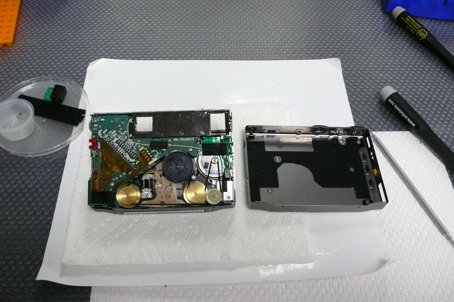

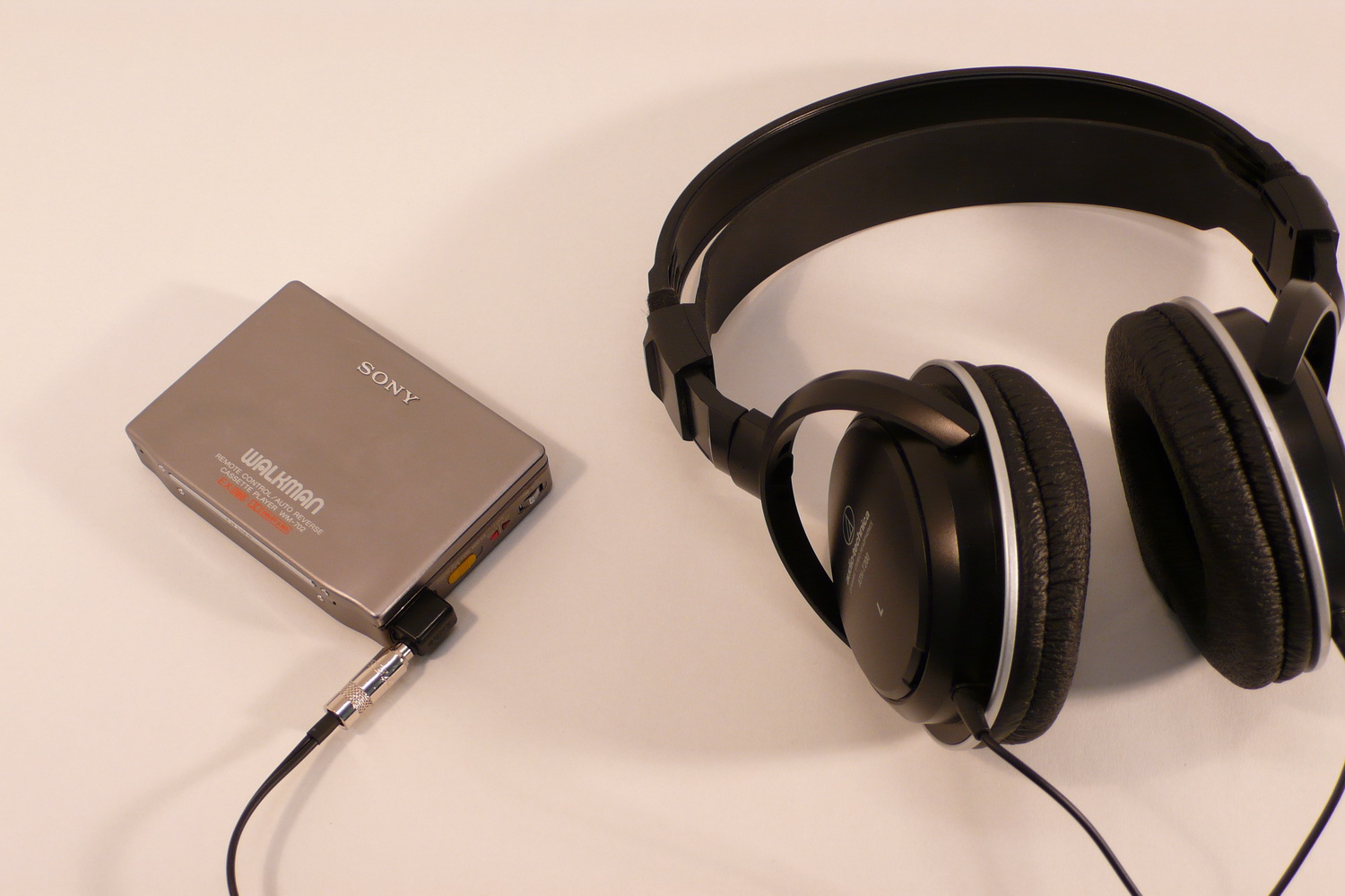

    Here is WM-702 that I borrowed from my friend @Boodokhan for this mini-project:
    The only difference between WM-702 and WM-701 seems to be a button for lid opening in 702 vs. a slider in 701.

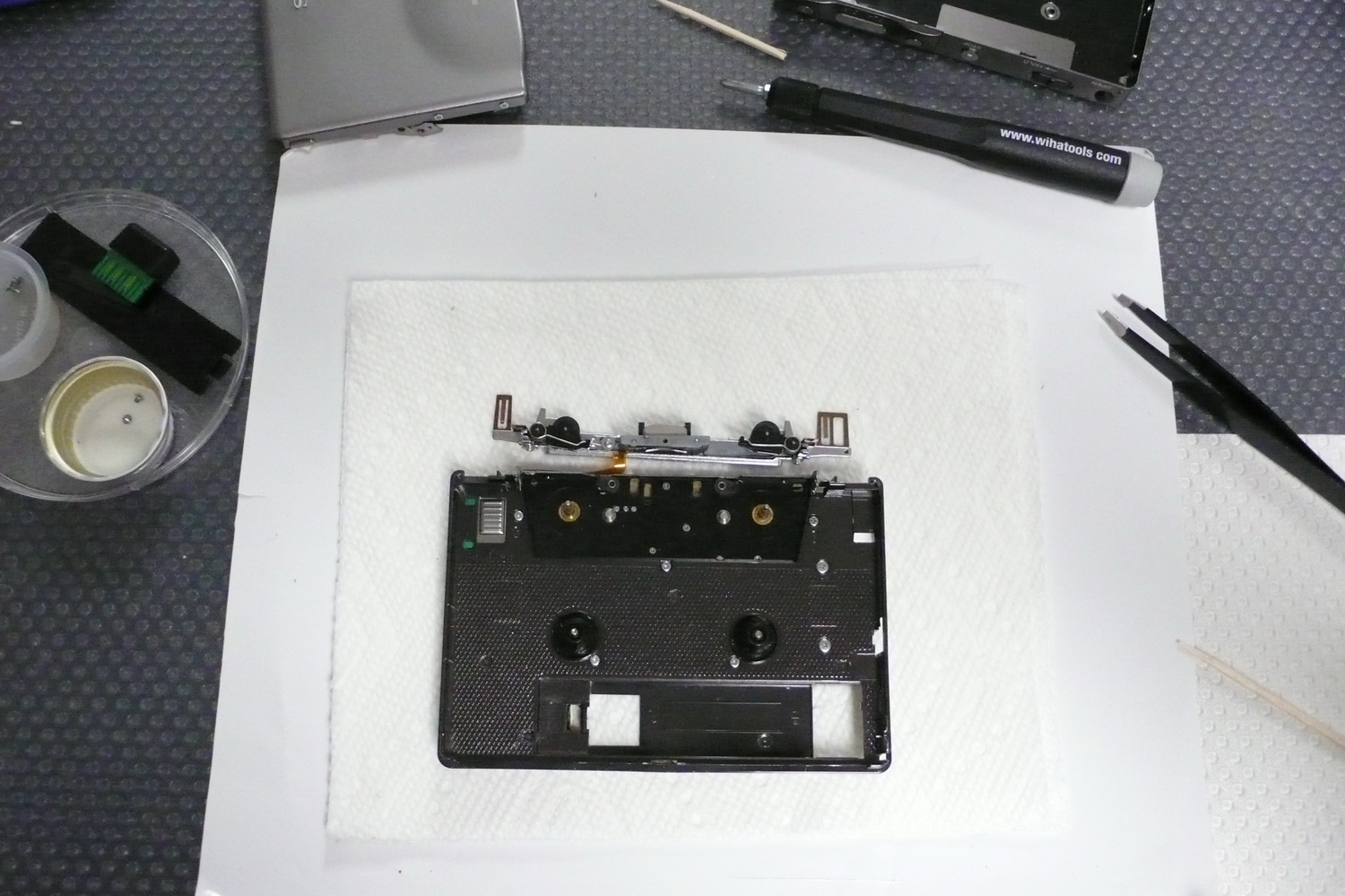

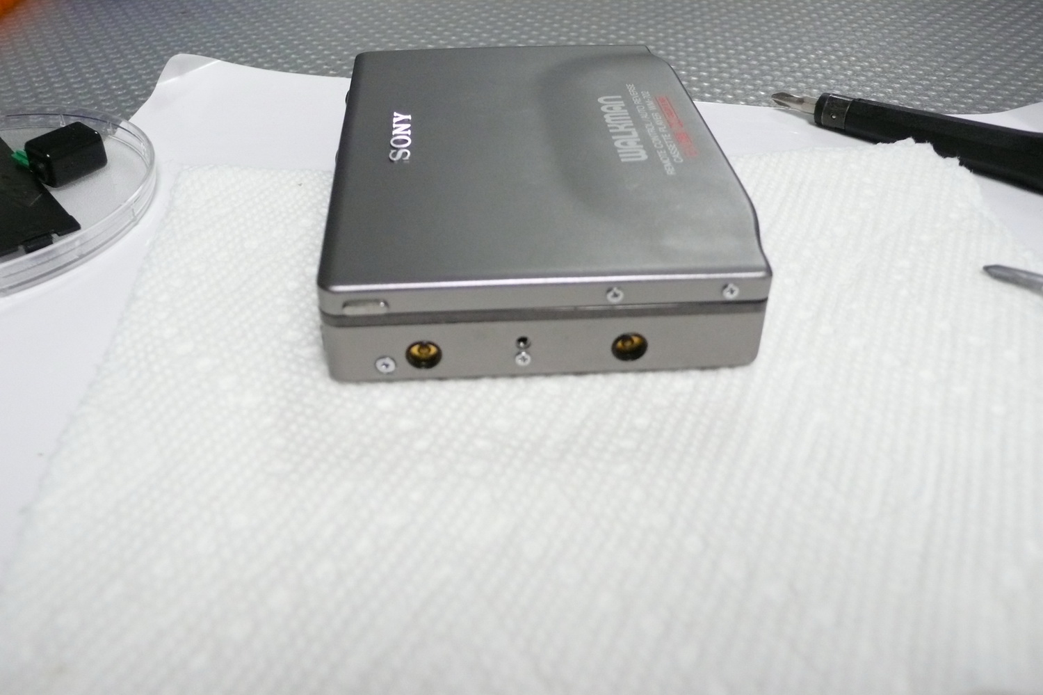

    3+2+2 screws to open its back (no need to touch the screws on the lid):

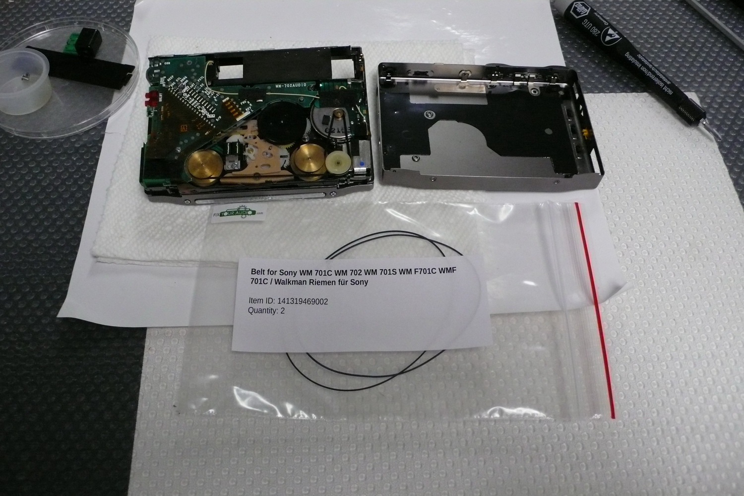

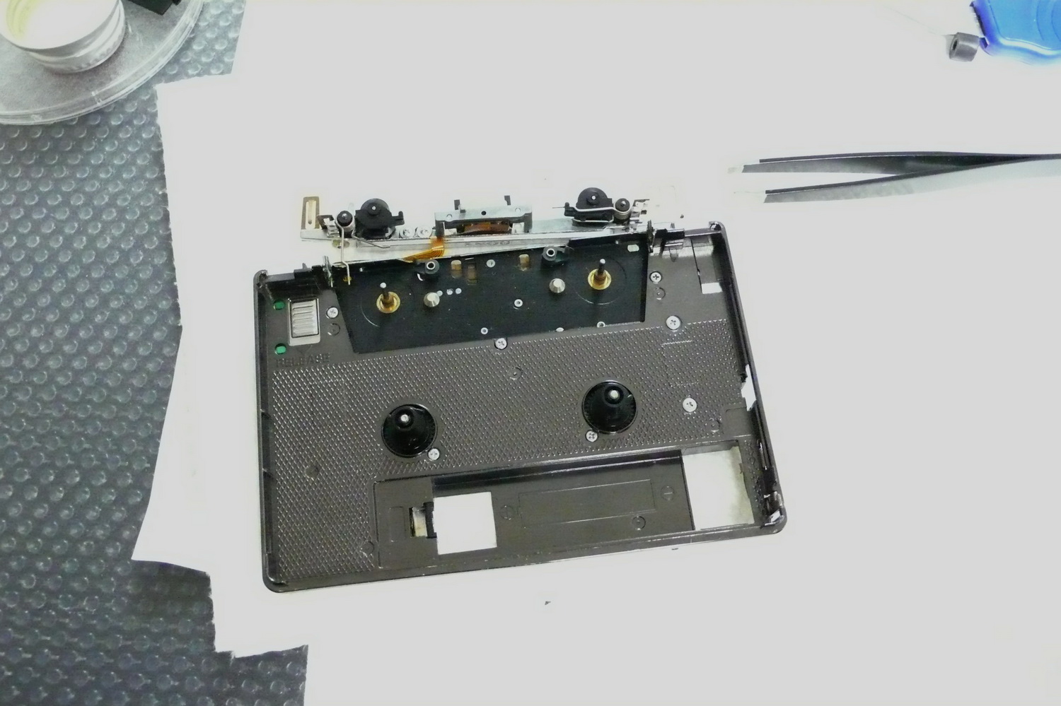

    Once opened (pull up from the "gondola side" then away from h/p jack and volume control) the belt is right in front of you:
    New belts from @mihokm seem to be a Gold Standard for Walkmans, as Marrscommunications is for the cassette decks. Unless your old belt had turned into goo, cleaning the path and rebelting is a 5-min job.

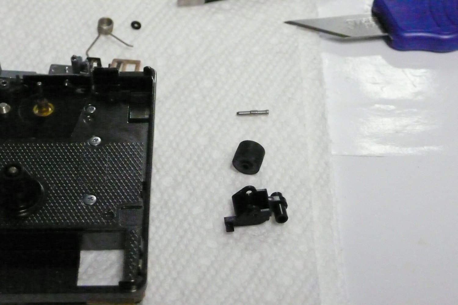

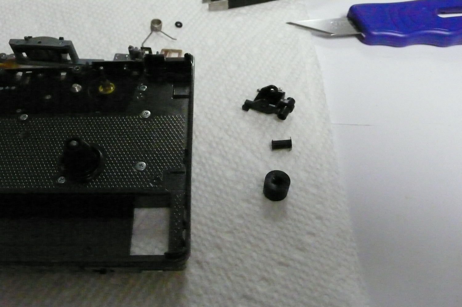

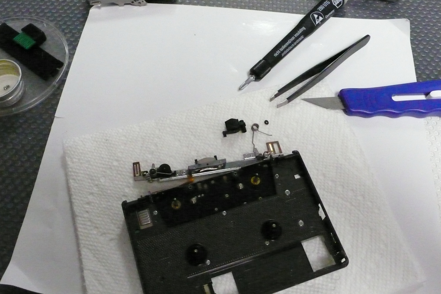

    Old pinchrollers look OK, with just a few shaved spots on them. Two screws flanking Sony logo release the lid, then you can unlock the head-pinchrollers block from the main body. One spring and one tiny washer per pinchroller, and it is all yours:

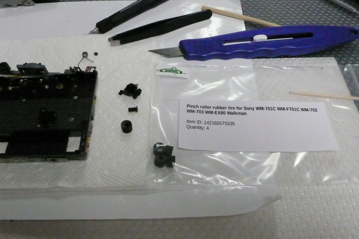

    Pin can be pushed out from plastic holder with a toothpick! Sliding rubber off the plastic hub takes only minimal effort:
    new pinchrollers from @mihokm installed:
    Looks GOOD, sounds ~OK:

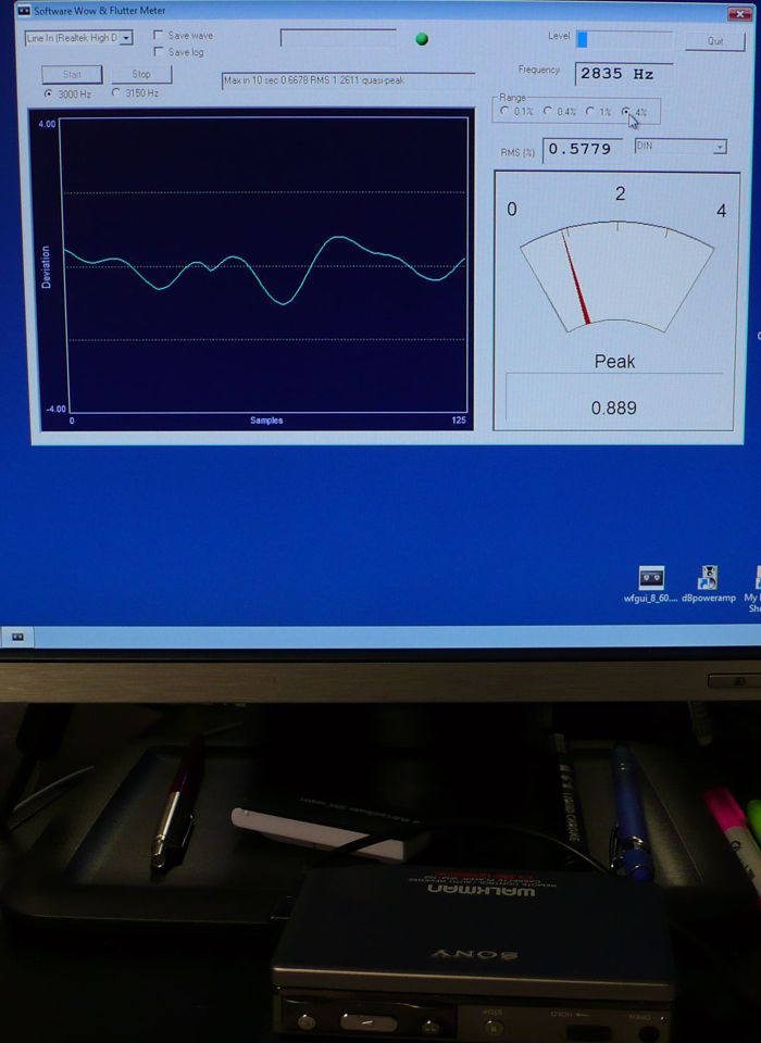

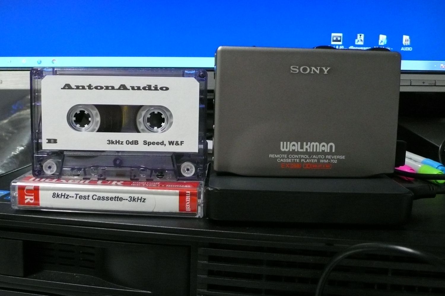

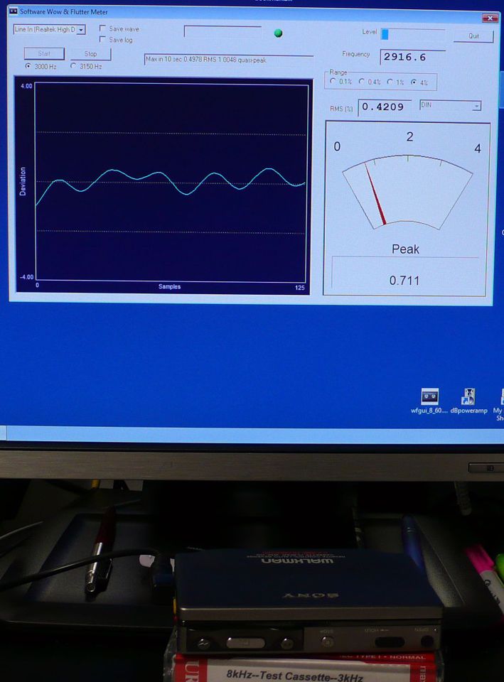

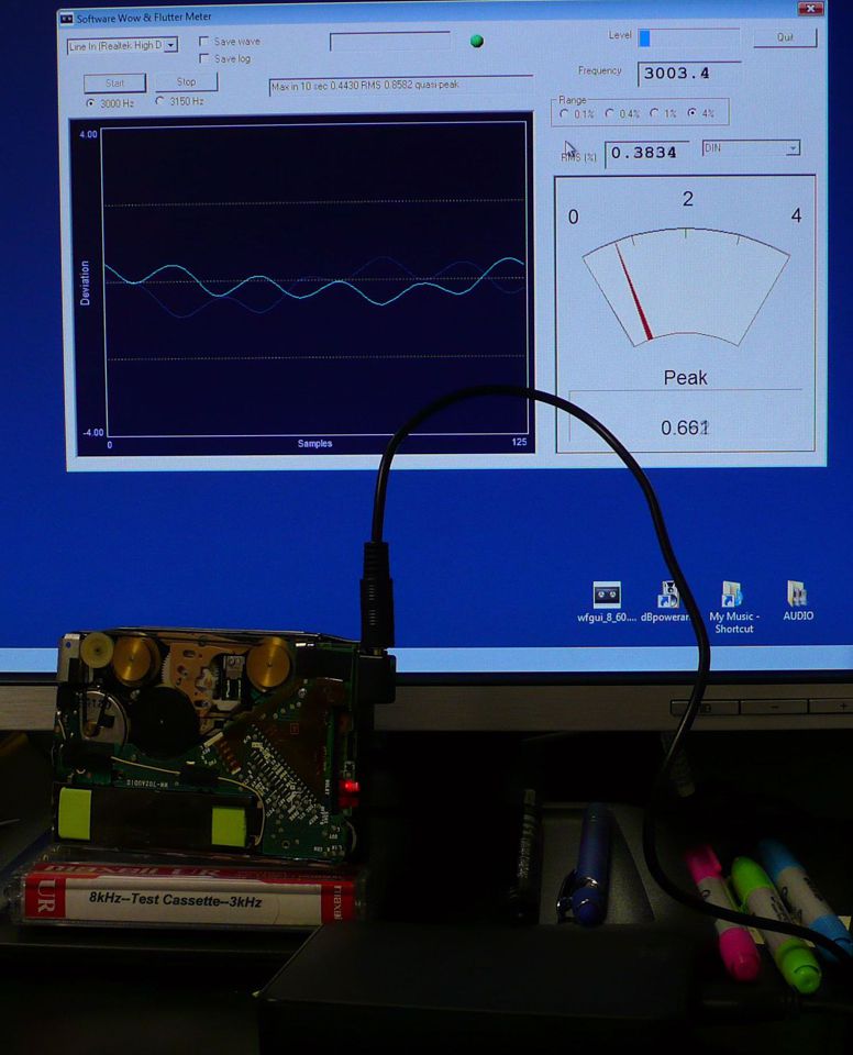

    W&F specs are NOT mentioned in WM-701/702 Service Manuals, usually this is an indicator that W&F is way over the roof! :mad:
    Lets see if we improved the specs, or at least did not do harm to the patient. W&F of WM-702 as received (L), after re-belt (center) and with new pinchrollers/speed adjustment (R):
    Speed is easily adjustable, but what else to do to improve W&F ???
