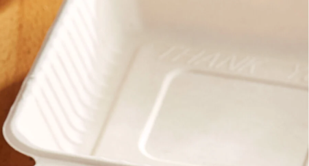

    Is this the natural fiber clamshell you suggested? I am sure I can dig one out and will follow your directions. Does the DIY fiber washer need to be oiled? My original "survivor" washer looks like it has a bit of oil or lubricant on it. I want to make sure I don't gum up the capstan shaft.

    No, the material I meant is clear plastic, like a soda or pop bottle. Only flatter. Shaped like the picture you posted.
    None of the players I have worked on have washers that I would describe as "fibrous". They do have tan-colored opaque washers. I haven't cut into one to see if they are fibrous inside. I think the clear plastic would be an entirely suitable replacement and would not be affected by lubricants.

    My Walkman is a late 90’s Sony model that used this fiber washer in the mech. I am not an engineer so I can’t tell you exactly what was the thinking behind its implementation. I’ve never seen this extra washer anywhere else either. But it has to be there , perhaps not in the original design form now. Your idea gave me some incentive to create something else instead of the unobtainium original part. At least this will give one capstan some vertical stability.
