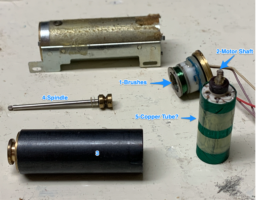

    Yesterday I disassembled the motor, using the Living Analog video, plus the many helper notes in this thread, gave me the encouragement to move forward. I'm writing to ask a couple of questions before I proceed. This is my first time working on anything like this, and I am not 100% clear on the naming conventions for the various parts. I see names in this thread such as motor shaft, spindle shaft, hub, front motor bearing, copper tube, back bearing, and others. While these may be clear to those who are experienced, it would be very helpful if someone were willing to point out these parts by name on a photo. I've added a few names to the parts that I feel confident about, can someone point to others that I have left out?
    Also, is there a best oil to use, or an oil to stay away from?
  6. Valentin
    1,994
    I edited the picture for clarity.
    What is marked 4 is the shaft + pulley. The type that drives a belt is called pulley, a spindle looks different.

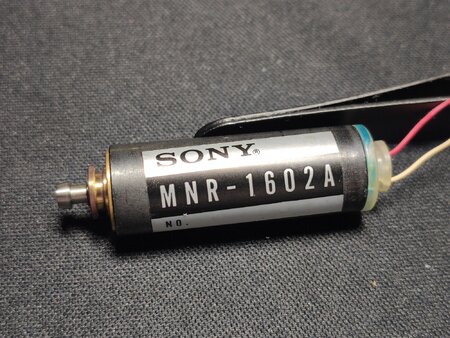

    See picture attached with MNR-1602A motor used in DD walkman, which is essentially the same motor but with a spindle instead of a pulley and without an FG coil.
    What is marked as 5 is the rotor. Being just coils, with no metal parts, it's what makes it a coreless motor.
    The small copper contacts marked 2 is the commutator, which switches between coils. This exists on any DC brushed motor.
    Below it there is a magnet that generates the varying magnetic field picked up by the FG coil (what is marked 1, the green coil).
    The brushes are within the back assembly with FG coil.
    Do note you will need to compress these brushes with a pair of tweezers before pushing the back cover back, so the brushes slide nicely over the commutator.
    What was reffered as the copper tube is likely the combination of the 2 bearings (front and back). But from what I have seen there are 2 independent bushings, it's not a tube.

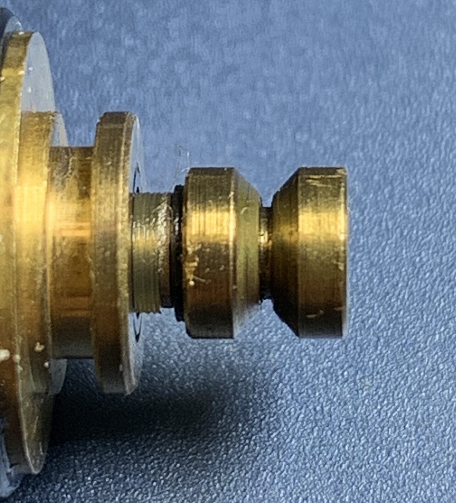

    Valentin - I've been away from this project for the past several days with health issues, I'm now back and ready to continue, but I have two questions before I proceed.
    For clarification, I've added a red arrow to the included image, is that the place where I add the small piece of paper to create the 0.1mm clearance?

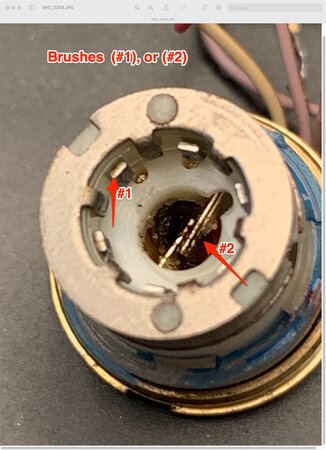

    Also, in step 3 - "Install the back cover with brushes while compressing the brushes with a pair of tweezers." In the other image that I am attaching, it would be helpful if you could indicate what the brushes are. Are they the six metal pieces that encircle the inner circumference of the housing? Or, are they the two metal pieces spanning the center of the opening deeper down? Either way, it is not clear to me how to compress them while installing the back cover.

    Yes, that is correct.
    In regard to re-installing the back cover, this part is where you should pay the most attention to. Bend the brushes and motor is gone. Brushes are what you marked as #2.
    The brushes need to slide over the commutator, but given they're in the compressed position, the clearance between them is not high enough for the commutator to slide between them.
    So you need to spread them apart ("compress" was not the best word to describe this) while pushing the cover down at the same time.
    If the process doesn't go as expected, pull the cover back and start again, don't force it down.
    Have attached a couple of generic images (not of coreless motors, but normal DC motors) showing how the brushes go over the commutator.
    Pretty sure I have some close-up pictures of this particular motor somewhere, but unfortunately can't find them now.

    Well, I have had several sessions trying to reinstall, but I am pulling my hair out trying to find someway to position the commutator between the brushes. In looking at the "Living Analog" video at the beginning of this thread, for a very brief second, I can see that the brushes have a gap between them when the commutator is removed. Unfortunately, that is not the case with mine, the brushes are literally right up against one another. I can easily create a gap using a toothpick to spread them apart, but as soon as I remove the toothpick, they spring back together.
    I am trying so very hard not to damage the brushes, but I'm left scratching my head trying to figure this out. Is there a trick to spreading the brushes and having them remain open so that I can insert the commutator?

    Are there holes on the back cover that are aligned with the brushes?
    Sometimes I've seen a couple of tiny holes in the back where needles can be inserted to spread the brushes apart during installation.

    Johny, in checking I do not see any openings, unless there might be something under the rubber grommet. It looks like the grommet could be easily removed, is that something that I would want to try?

    Unfortunately this type of motor has no holes to keep the brushes spreaded apart.
    First, one has to remove that red plug in order to have access to the brushes from outside.
    Then, use a pair of tweezers to spread apart the brushes while installing the cover. It's a bit tricky, but can be done.
    Suggest to leave that black rubber part in place, it won't reveal anything.

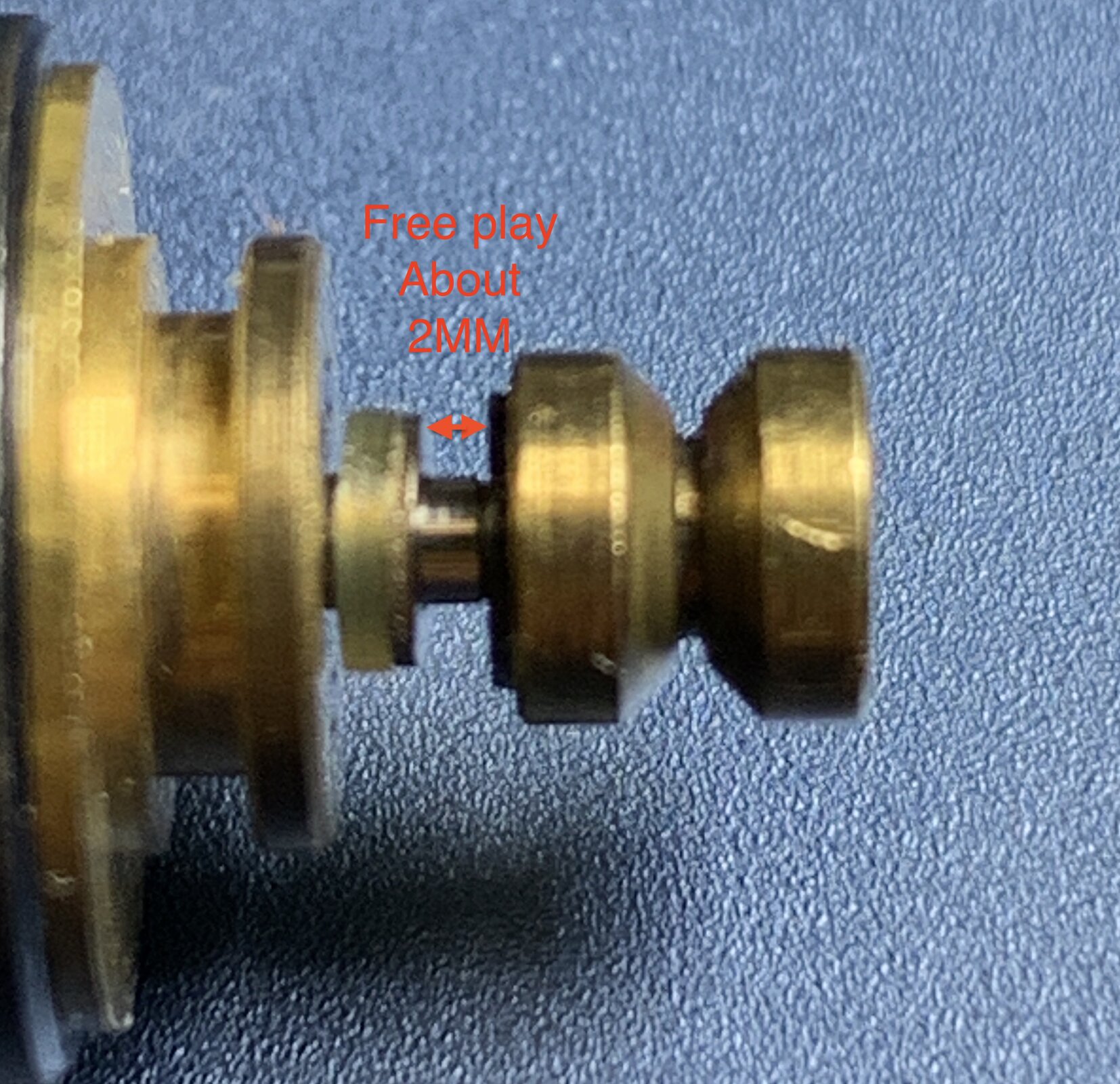

    I am still struggling to reassemble the motor, what seems so simple on the surface is turning into a real ordeal. Using Valentin's suggestion, I removed the red plug to gain access to the brushes, that worked beautifully, thank you. Looking through the opening where the red plug had been, I could see that the commutator was in position between the brushes, so I put everything back together.
    The problem is the spindle can be removed with very little pressure, I don't think it could fall out, but it is certainly very easy to pull it out. I believe that I have followed Valentin's exactly, installed shaft in case, added an extra washer, (this instead of paper), put the rotor inside and pressed with a socket. Pushing with a socket does not really cause any movement, the spindle and the rotor appear to be in place without any pressure from the socket. I've use more force in pushing the rotor than I feel comfortable with and there is no movement whatsoever. I could push harder with the socket, but my instincts are telling me that something is going to break. Is there an "ah ha" moment that will tell me when the rotor is pushed in to the proper position?
    I've attached a couple of photos showing my setup, the spindle has about 2MM of free play, I am aware that this is too much, so maybe I do need to exert more force on the rotor with the socket. I get a great deal of satisfaction in being a DIY'er, but maybe I've taken on too much with this project.
