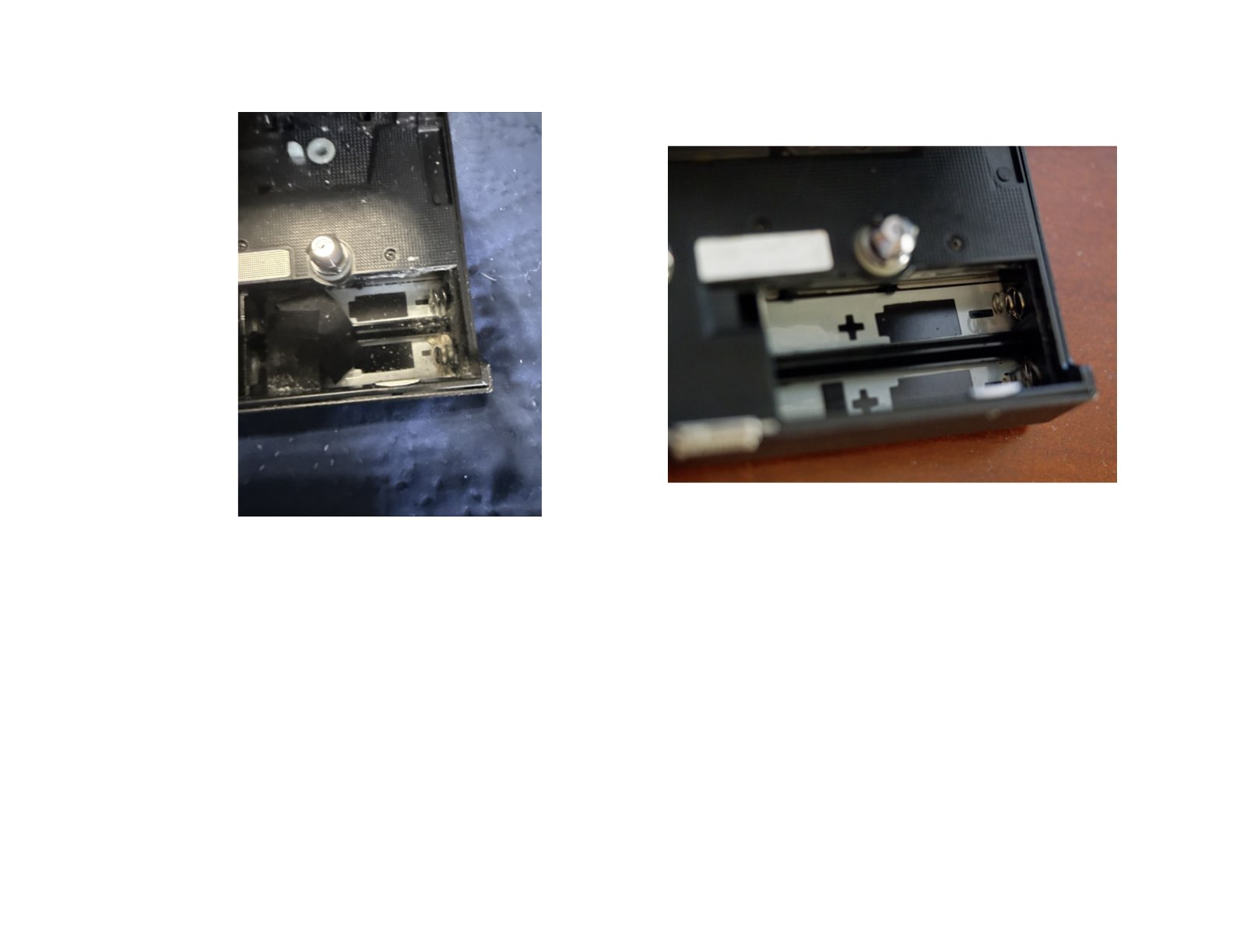

    Well Folks, when do you throw in the towel? Thus far, I've replaced all the electrolytic capacitors, cleaned and lubed the mechanism, new belt and several hours in time. Every time I move the PCB, a wire separates from some solder point. This unit had some corrosion in the battery box which cause light corrosion in other places. I think I'm about to take this project at a loss and just use whatever parts on this unit as spares. This has by far and large been my worst restore project, first unsuccessful. Anyone else had similar experience? Would love to hear your story. Cheers! Norm

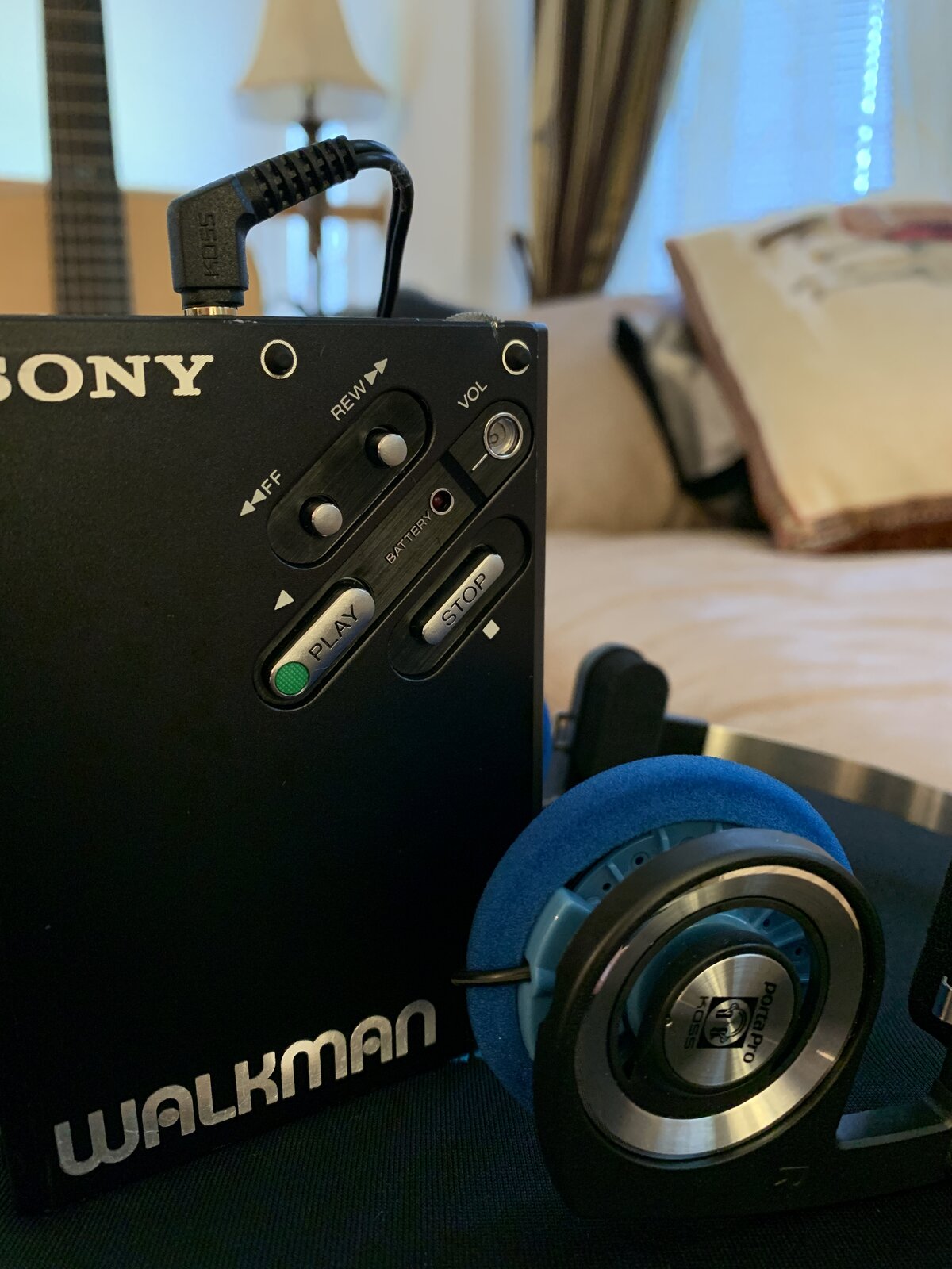

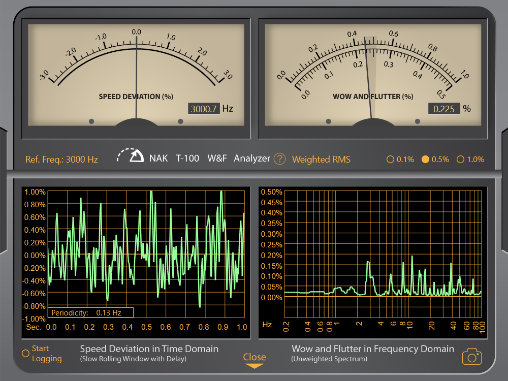

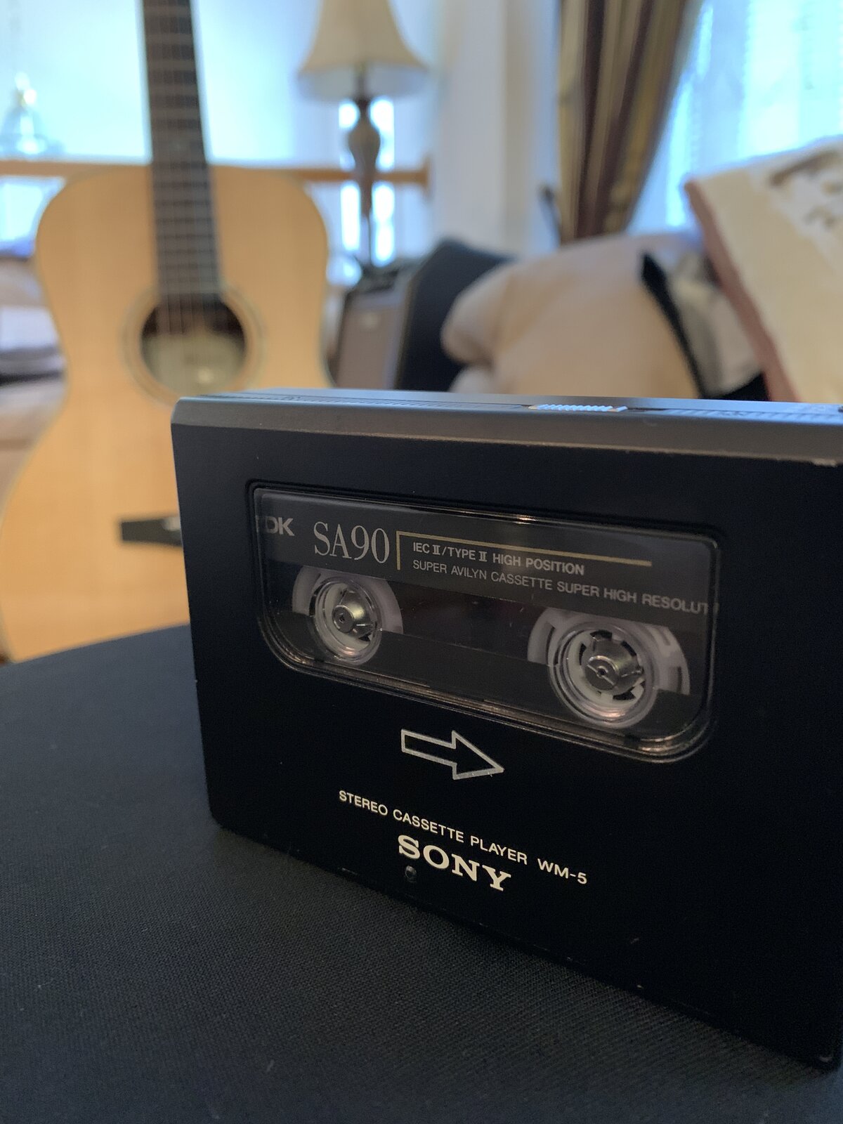

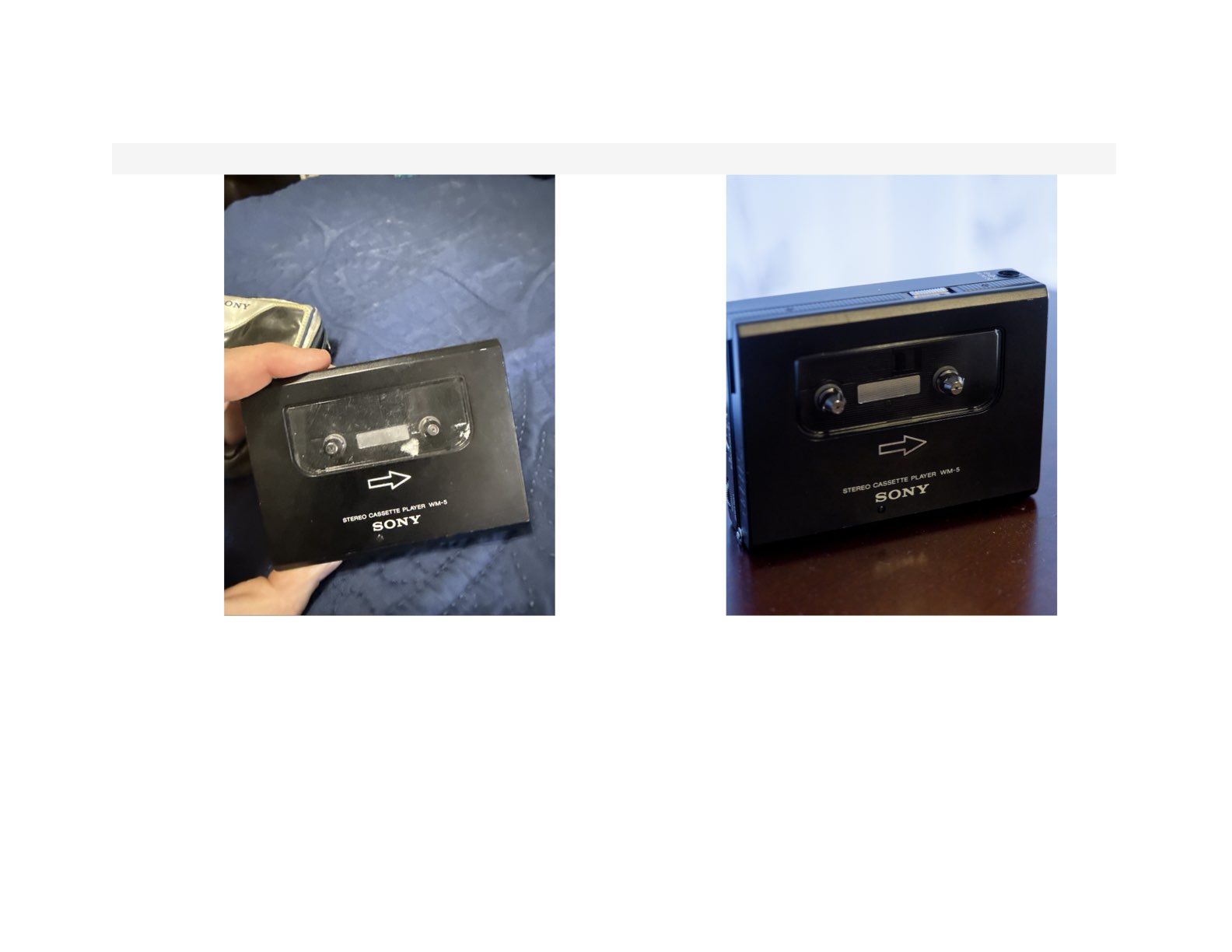

    Okay, Good People, after many frustrations and a bit of good luck, I've managed to resuscitate another Walkman from dirtiest of all trash cans. This patient was initially determined not live to see tomorrow but she pulled through in the end. I've been listening to this thing for about 6 hours and it appears to be stable. I think I'm going to call this one good before anything else happens, lol. As always, nothing is complete without the paperwork. Not fantastic numbers but this one has gone through hell and back. I'm fine with it, sounds great - there's a little more sparkle on the high end and tighter bass than the WM-2 that I restored earlier. Cheers! Norm
    Addendum:
    I did not change the pinch roller but did recondition it. Maybe I can get the W&F down just a tiny bit if I replace it. I might try that at a later time.

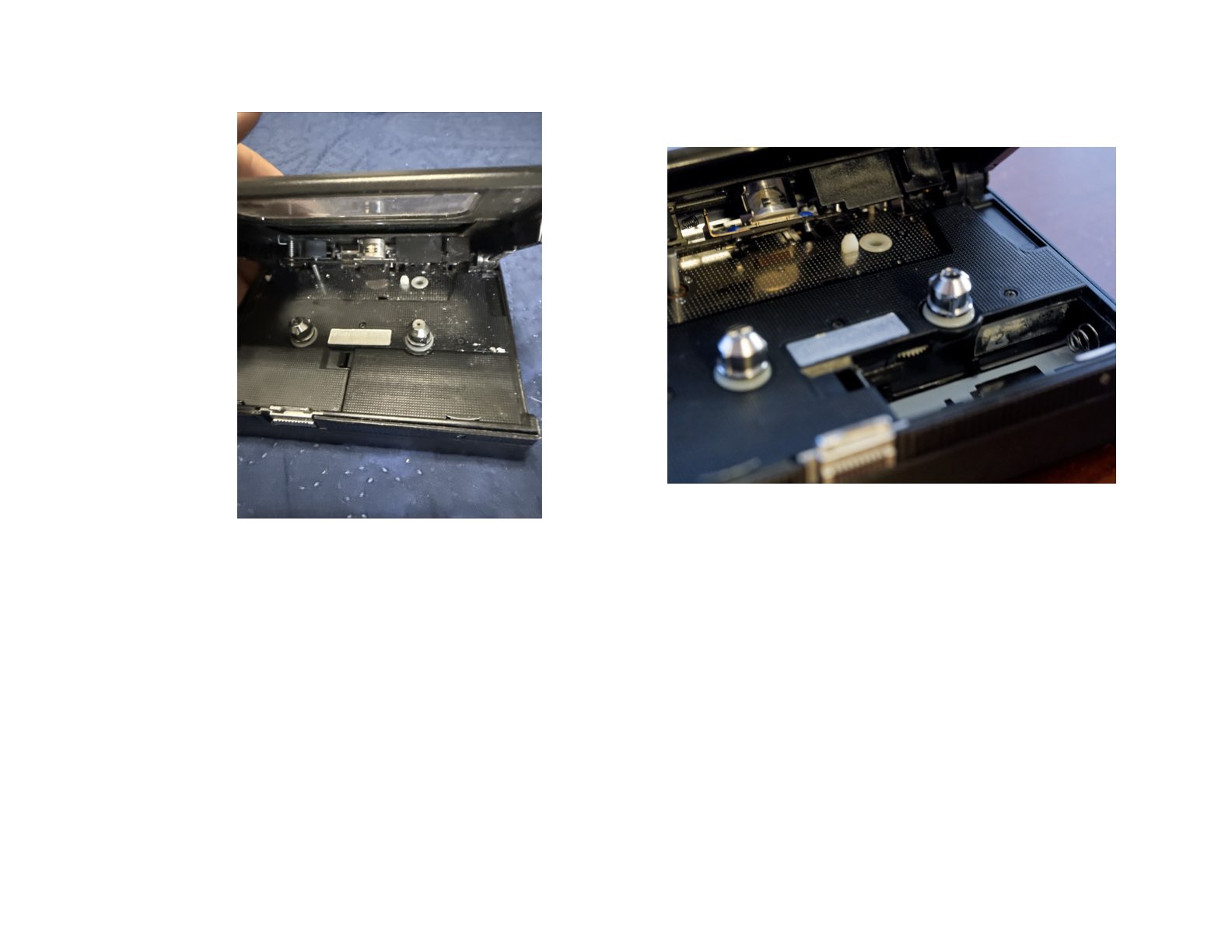

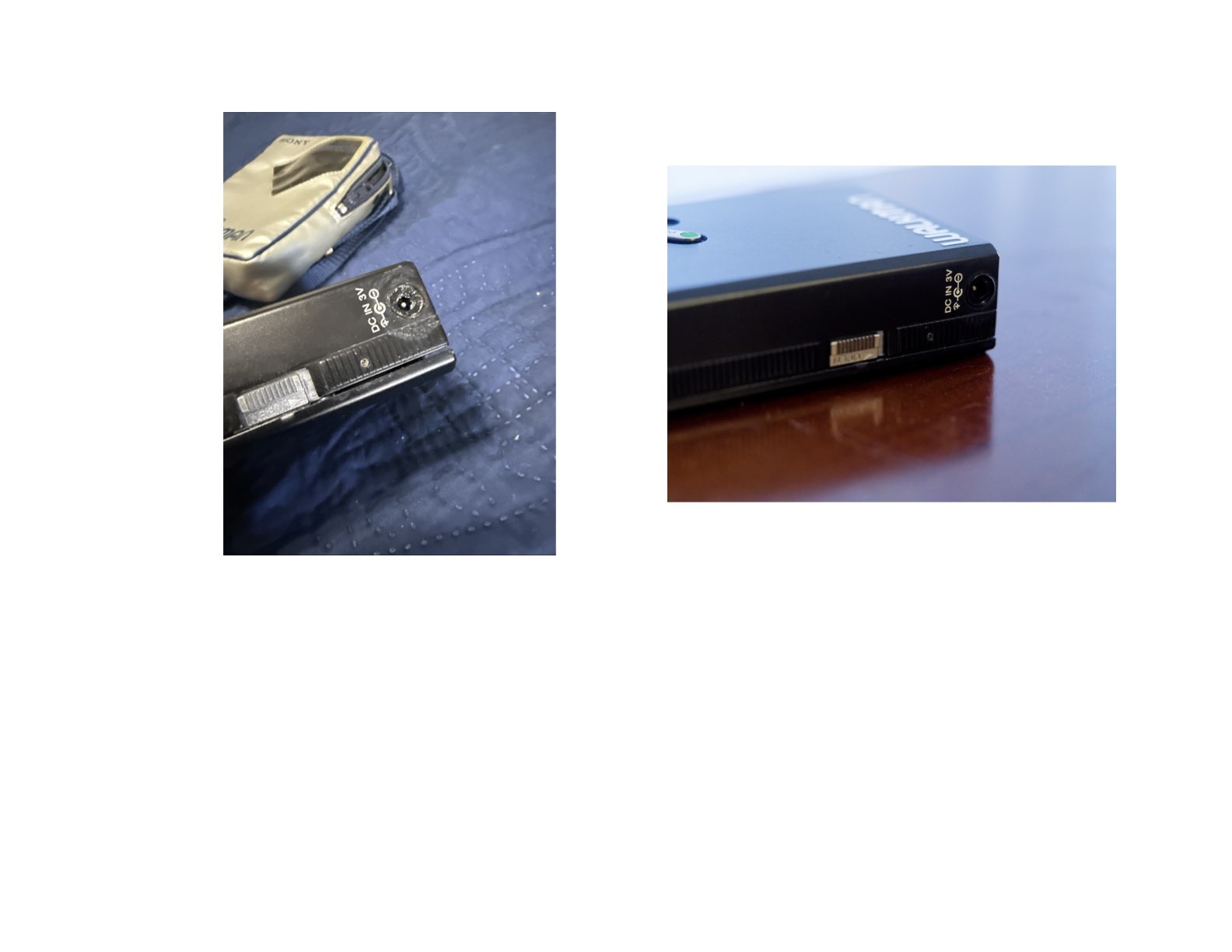

    Just getting around to taking some pics. Here are some before/after pictures. The before pics are from eBay. Cheers!

  6. euroflash
    euroflash Member
    92
    18
    Oregon
    @worldwide137 Congrats, Norm! Excellent work on the restoration and corrosion remediation—and great W&F results for this series.

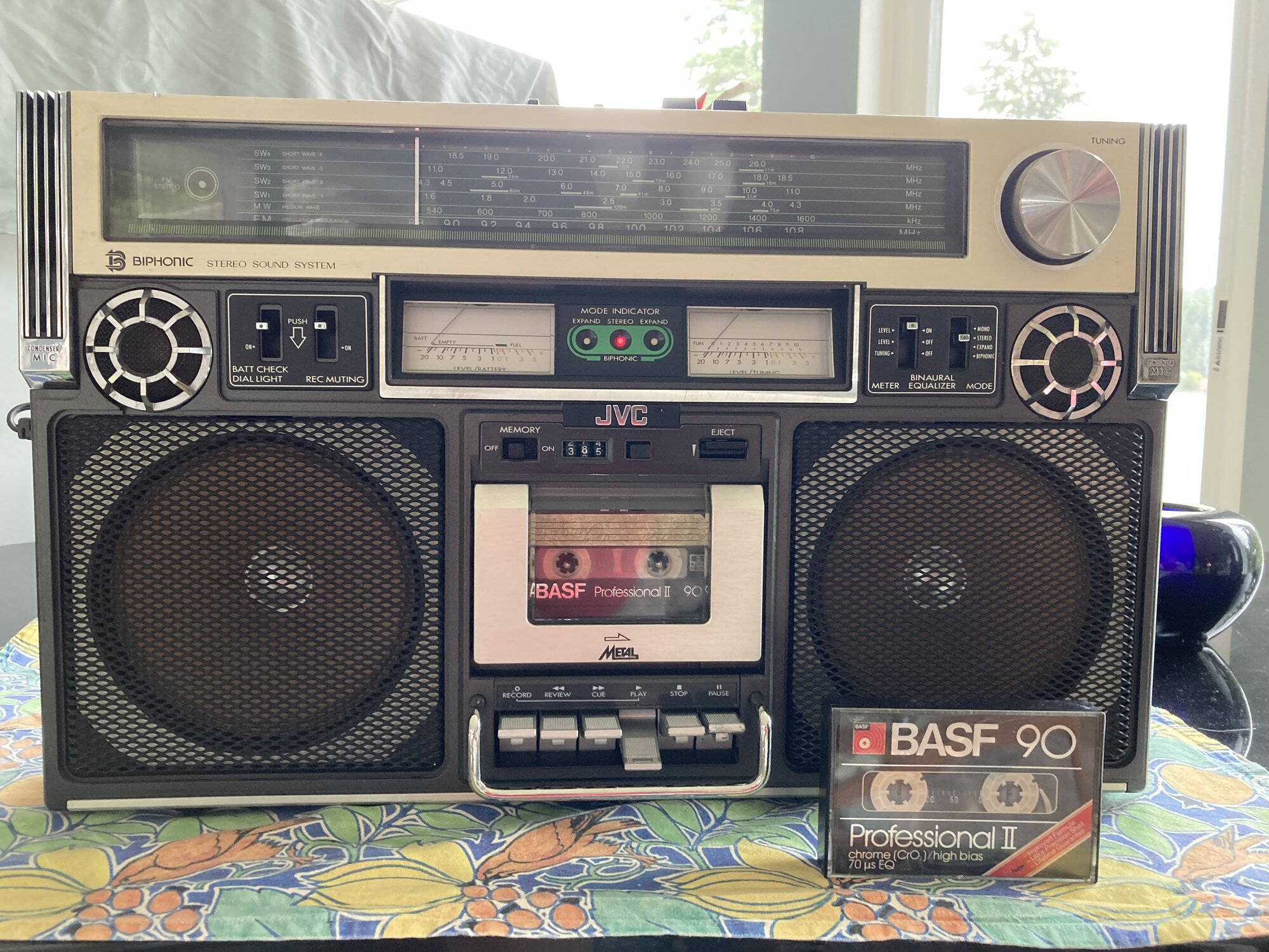

    Marian's package just arrived right on time. While waiting for the Sony WM-2 parts, I completed a full teardown and restoration of my JVC RC-838 JW II boombox this morning. Easily my toughest repair/resto yet, but sentimentally worth every minute since it was my first college boombox.
    Regarding the static on your Aiwa JX719—I had a similar issue on another deck, and it turned out to be a weak chassis ground contact. Might be worth checking the ground traces or frame connections! Who knows?

    this is my JVC RC-838 JW II after resto. I am pondering if it is worth it to make a thread with some pics and observations I had during the restoration.

    Beautiful and a very capable unit. I bet it sounds like a million bucks. Did you do a full recap? Yes, I’d be interested in following your journey into the restoration.

    Surprisingly, I did not have to replace a single capacitor to make it work and also calibrated. (Rubycon caps were factory installed here). But the restoration story is interesting in other different ways, and could be useful for some others who love this particular lineage of JVC b-boxes, (RC-M70 included.) and thinking of buying one.
    I will make a separate post on the restoration of my RC-838 JW II. Stay tuned!
