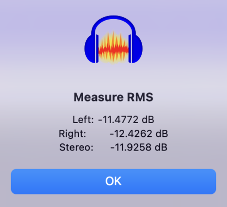

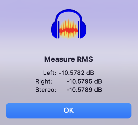

    I've installed Audacity and tried to replicate your measures (as part of my learning curve and understanding your analysis). I see the following:
    Known Good Cassette
    • WM-DD 33: Left -15.7213 dB, Right -17.4881 dB, diff 1.7668 dB
    • WM-D3 Line Out: Left -15.9141 dB, Right -18.8385 dB, diff 2.9244 dB
    • WM-D3 Phone Out: Left -14.6506 dB, Right -18.5005 dB, diff 3.8499 dB
    Dolby Test Tape
    • WM-DD 33: Left -14.8668 dB, Right -15.1734 dB, diff 0.3066 dB
    • WM D3 Line Out: -10.5782 dB, Right -10.5795 dB, diff 0.0013 dB
    • WM-D3 Phone Out: -11.4772 dB, Right -12.4262 dB, diff 0.949 dB
    I guess the way I calculate the differences is not the correct one (just substracting one number from the other) but the way I understand this is:
    • there is always a difference between Line Out and Phone Out on the WM-D3, Phone Out seems to amplify any issue
    • the Dolby Test Tape is spot on on all units (no noticeable difference between the 2 channels)
    • the recorded tape however shows imbalance - as well on the WM-DD 33 ???
    I must say I'm a bit confused now :(

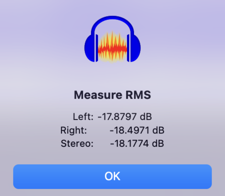

    I've captured the recording, the RMS analysis, and uploaded the visual tape path check: https://www.swisstransfer.com/d/dca59085-fe10-4168-aa62-4779a291ca5b
    All springs are back to their location, pinch roller was oiled, I followed everything... Any idea what I'm facing now?
    EDIT: I forgot to tell that I went through the whole adjustment procedure as well (PB & recording levels), and adjusted the left channel, before my recording attempt.

    Have you thoroughly cleaned the pinch roller and capstan after replacing it ? How does the roller look now relative to the capstan ? Are they parallel ?
    Watched the video, indeed can't see any tape pull but there's a catch. What cassette have you used ?
    As from what I remember, it didn't have any pull with the test tape even before, but it did with pre-recorded cassettes.
    Personally, I'm skeptical just replacing the pinch roller solved the misalignment problem... hence why I would test visually with 5-10 different cassettes before drawing the conclusion.
    The RMS analysis isn't that relevant if it's only valid for that specific tape. If we look at the measurement, imbalance is below 0.5dB yet something is clearly audible (at 0.3dB it won't be).
    Have you re-adjusted the playback levels ? Azimuth may also need some small adjustment.
