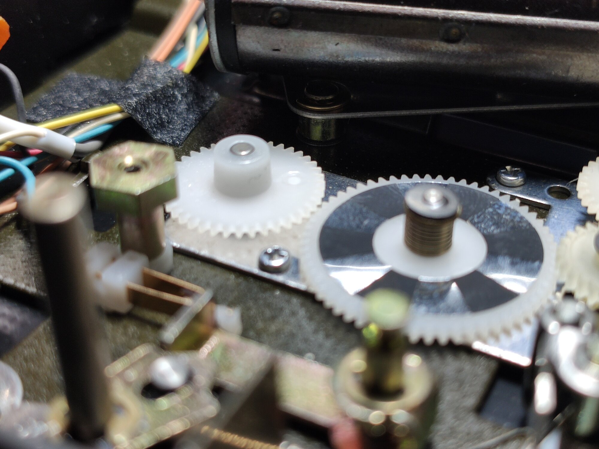

    Problem manifests as follows: the supply reel rotates while there is no cassette inserted, but as soon as load is put on the reel (a cassette inserted) a loud gear noise can be heard and reel stops rotating.

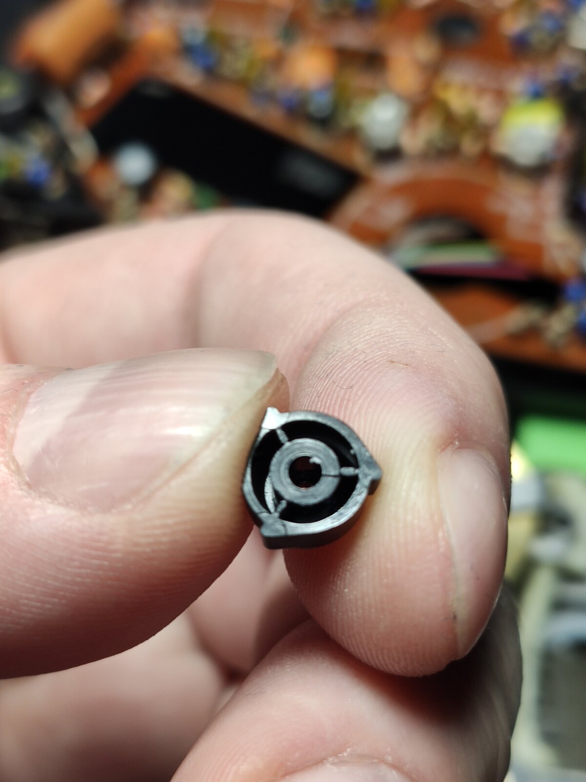

    The root cause of this problem is a cracked table reel.
    What happens is the shaft becomes loose in the reel hence creating up-down play in the drive gear as seen in attached picture.
    Solution is to glue the shaft to the reel with super glue.

    - remove the drive gear/shaft assembly, clean and re-lubricate with watch oil;
    - insert the drive gear/shaft assembly back into the brass bushing;
    - clean any excess oil on the other side in order to make sure glue will grip;
    - put a drop of glue inside the reel, making sure the surface that comes into contact with nylon washer is free of any glue;
    - put the reel back on its drive shaft, while keeping a finger on the white gear on the opposite side;
    Push the reel all the way in. Do not that a small up-down play (0.1mm or so) is normal.
    - clean any excess glue on the visible part of the reel;
    After letting the glue dry, you can re-assemble the unit and use it as normal.
