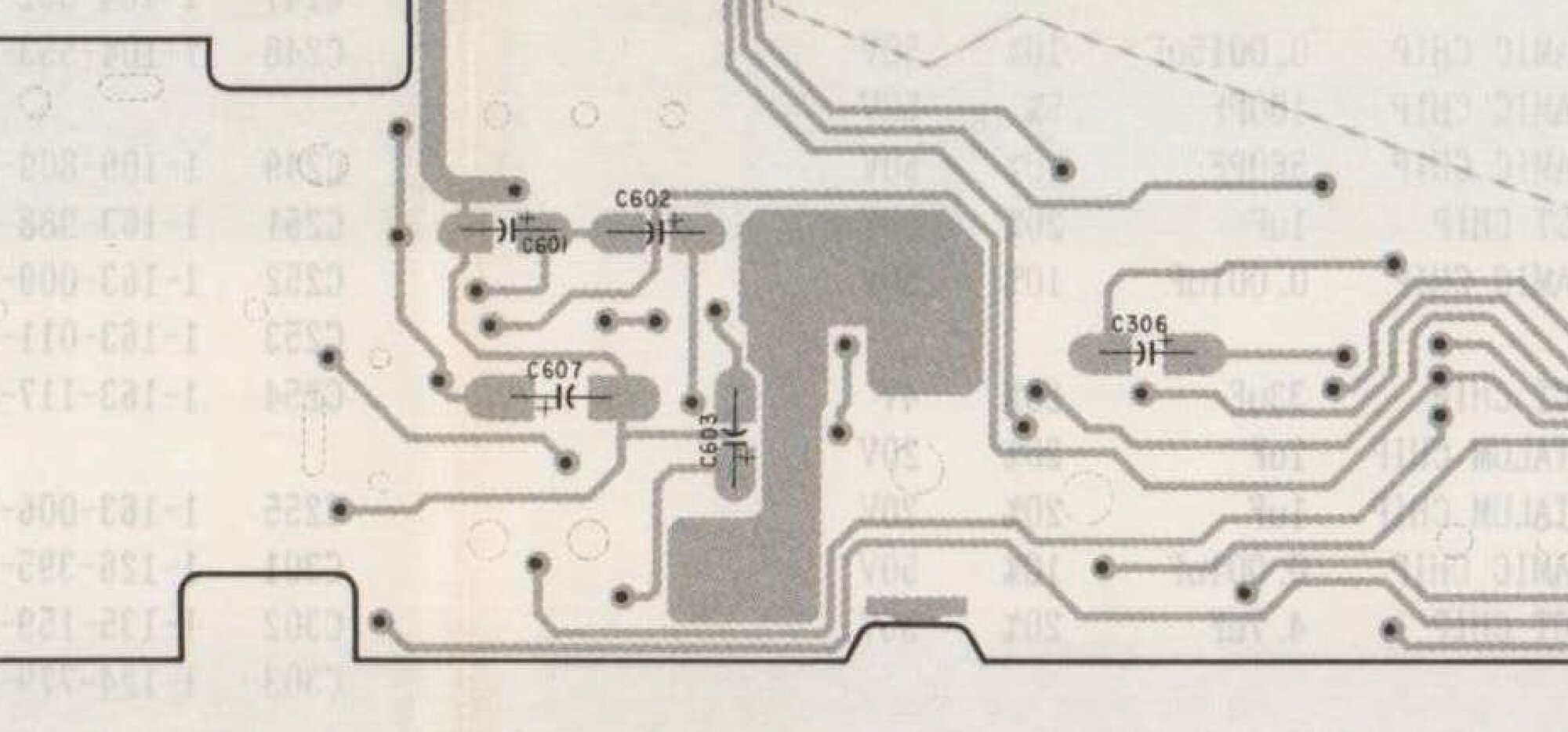

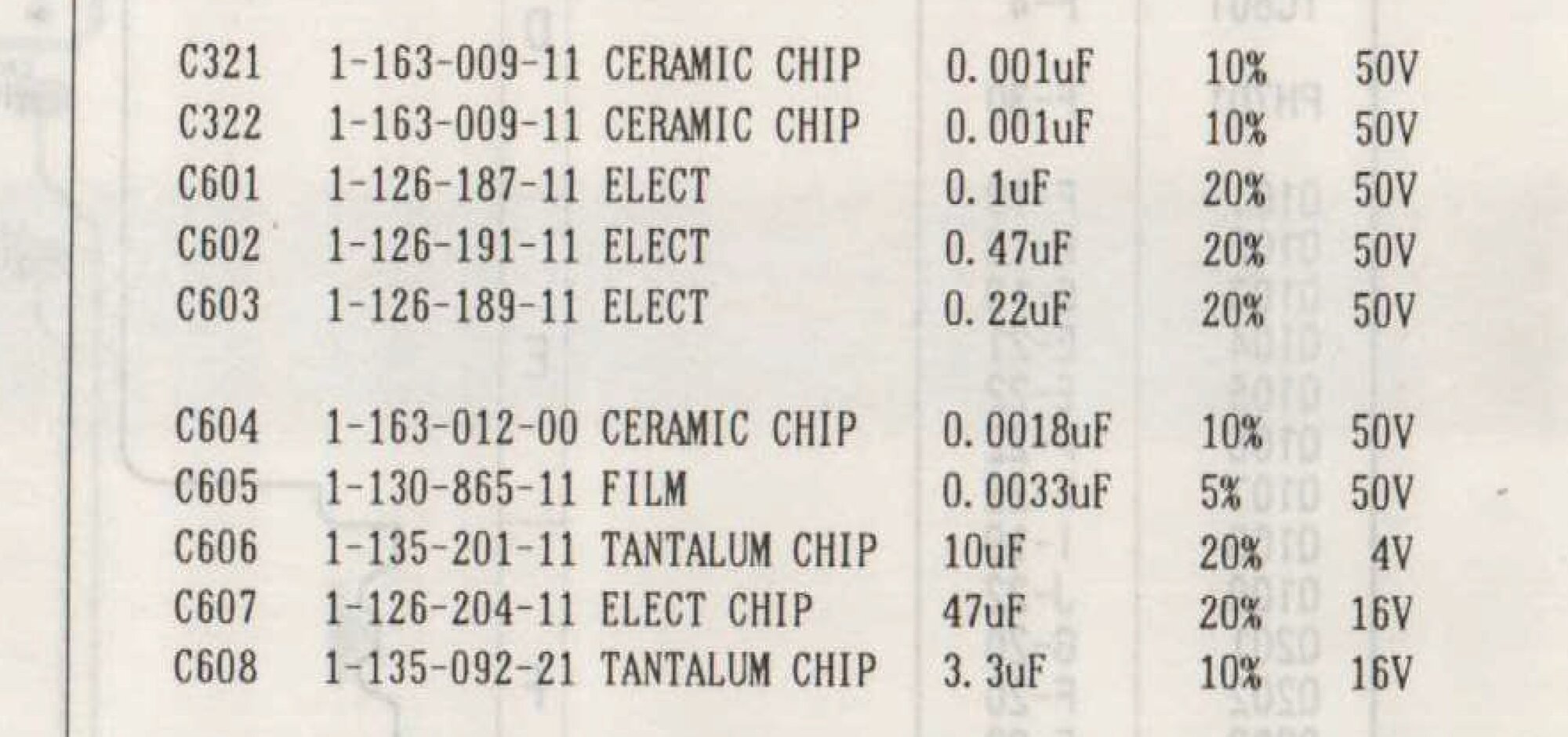

    Appreciate your quick response! Where are those caps located, and what are their respective values?
  9. Deb64
    301
    Leicestershire, England
    Cap values and locations attached.
    This information is all in the service manual, along with the setup procedure, which you need to carry out after the repair.
    If you don't have the service manual, you should find it on-line and download it before you go any further.
    Maxbg996 likes this.
