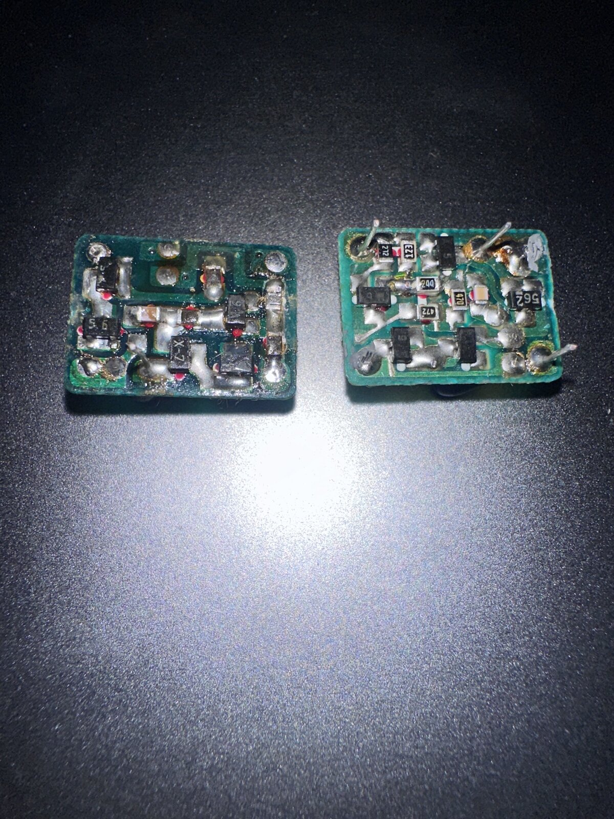

    • I found the DC-DC repair guide. I will replace the tantalums, inductors, and the transistor. On the guide they show which transistor to replace but the chip I have from the D6 is slightly different. Should I replace one of the transistors on that one as well? If yes which one and what is the value? (I attached a picture of both chips. D6 on the left and D6C on the right) IMG_9883.jpeg

  2. Valentin
    1,985
    If you want to be sure, check the continuity of the transformer coils with a multimeter. It can go open-circuit, although not common.
    Apart from the input tantalum, input inductor and switching transistor there's nothing else that gets damaged.
    So best course of action is proceed in replacing those components.
    febrice likes this.
