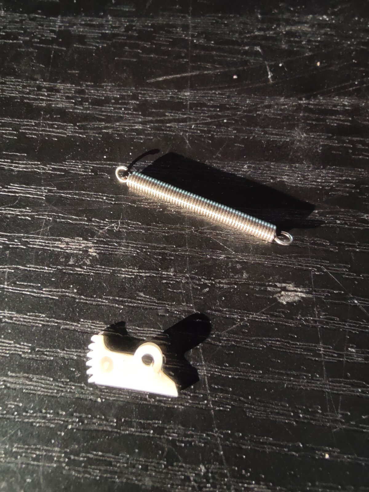

    Opened it up, got the spool spinning perfectly now. That was the belt. But these fell clean out without touching them. And now the player's stop button can't eject tapes. The button part that retracts? It doesn't anymore. Not all the way. So tapes get stuck on it.

    Though, I still don't know where the plastic piece came from, I found and returned the spring. The eject mechanism works properly now.

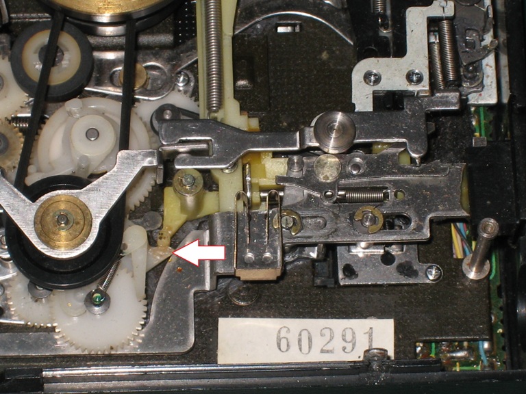

    The loose plastic piece is part of the auto-stop mechanism, which releases the play mechanism when the end of the tape is reached in Play and Record modes. I have marked it up on the attached photo.
    If it was loose inside the walkman then somebody has previously taken it apart and not re-assembled it correctly.

    Oh, I see! Yeah, the previous seller noted that they had personally replaced the belts and rubbers before shipping it. And when I removed the back, it simply fell out. Now I'm having more trouble with the play function, though, as the small, black wheel on the inside isn't consistently touching the large wheel when Play is pressed, if at al, even though FF and RW are working flawlessly.
