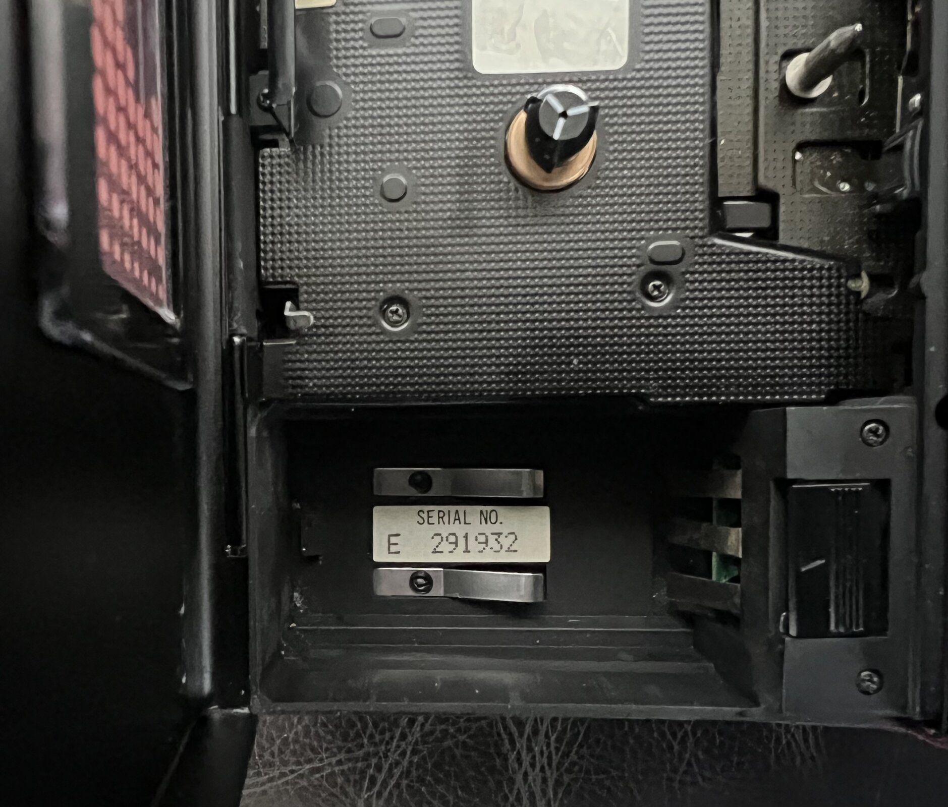

    Question on serial numbers why does mine have the letter E in front of the number?
    My other D6C doesn’t. Does the E stand for something? this does have the 35711 head. IMG_4062.jpeg
  19. Emiel
    1,115
    It looks like a very late model, looking at the print quality of the serial sticker. I don’t seem to have a Sony Walkman with serial number including an E.

    My other one serial number 514757 and that’s really late and has the permalloy head where as I said this has the 35711 head but I have struggled for find one that has a letter in front and I always thought that this was a mid 90’s number (E291932)?
    Cheers Kiwinut
