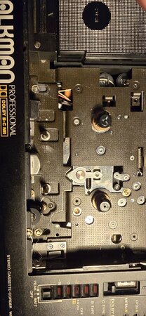

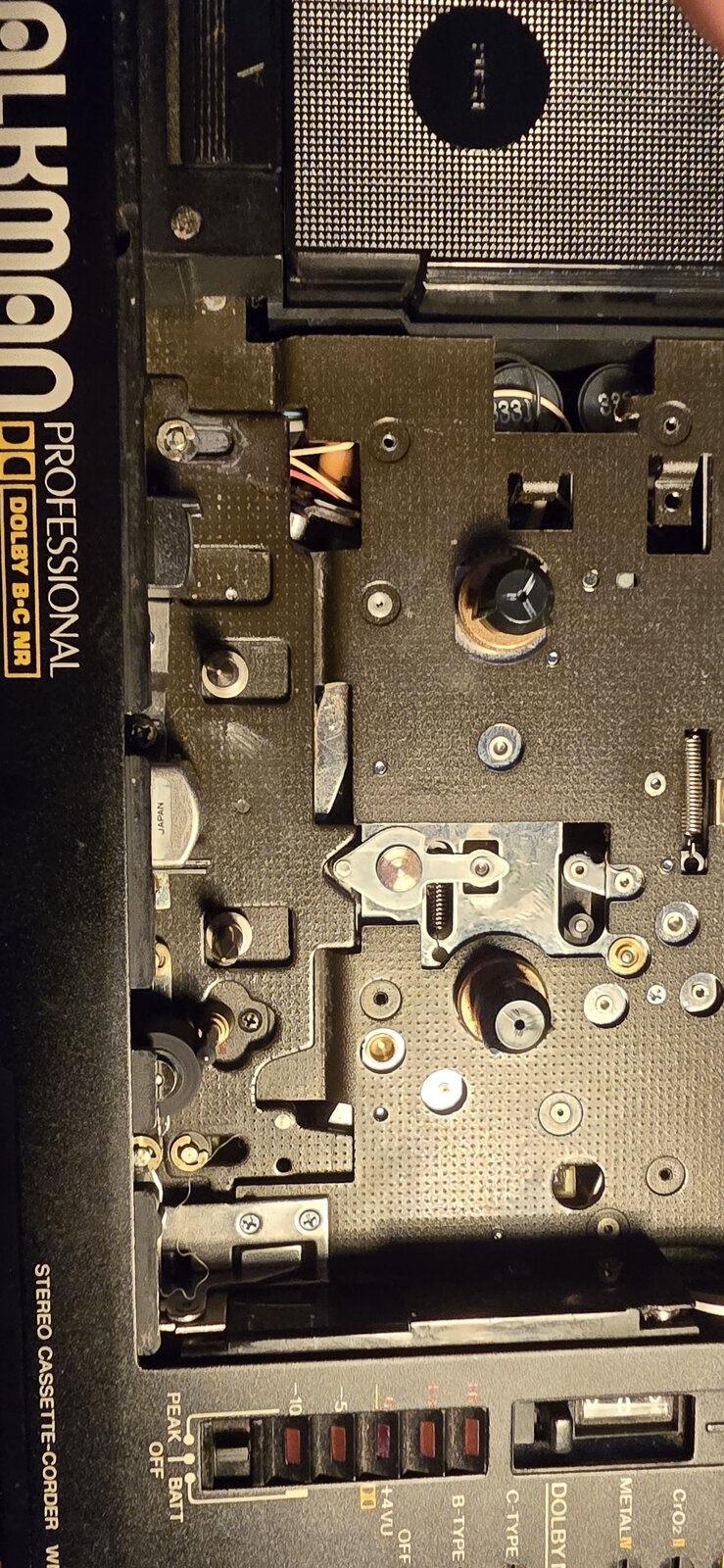

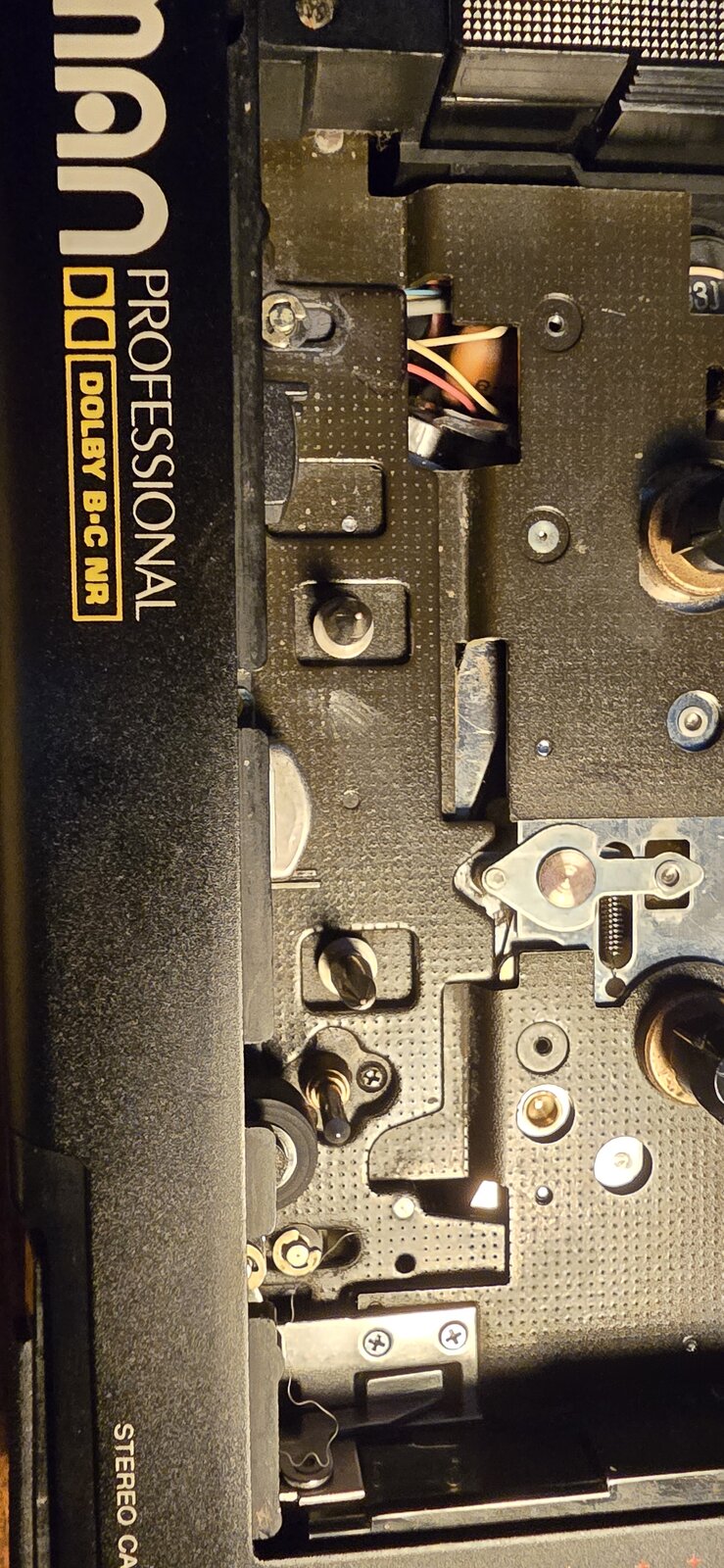

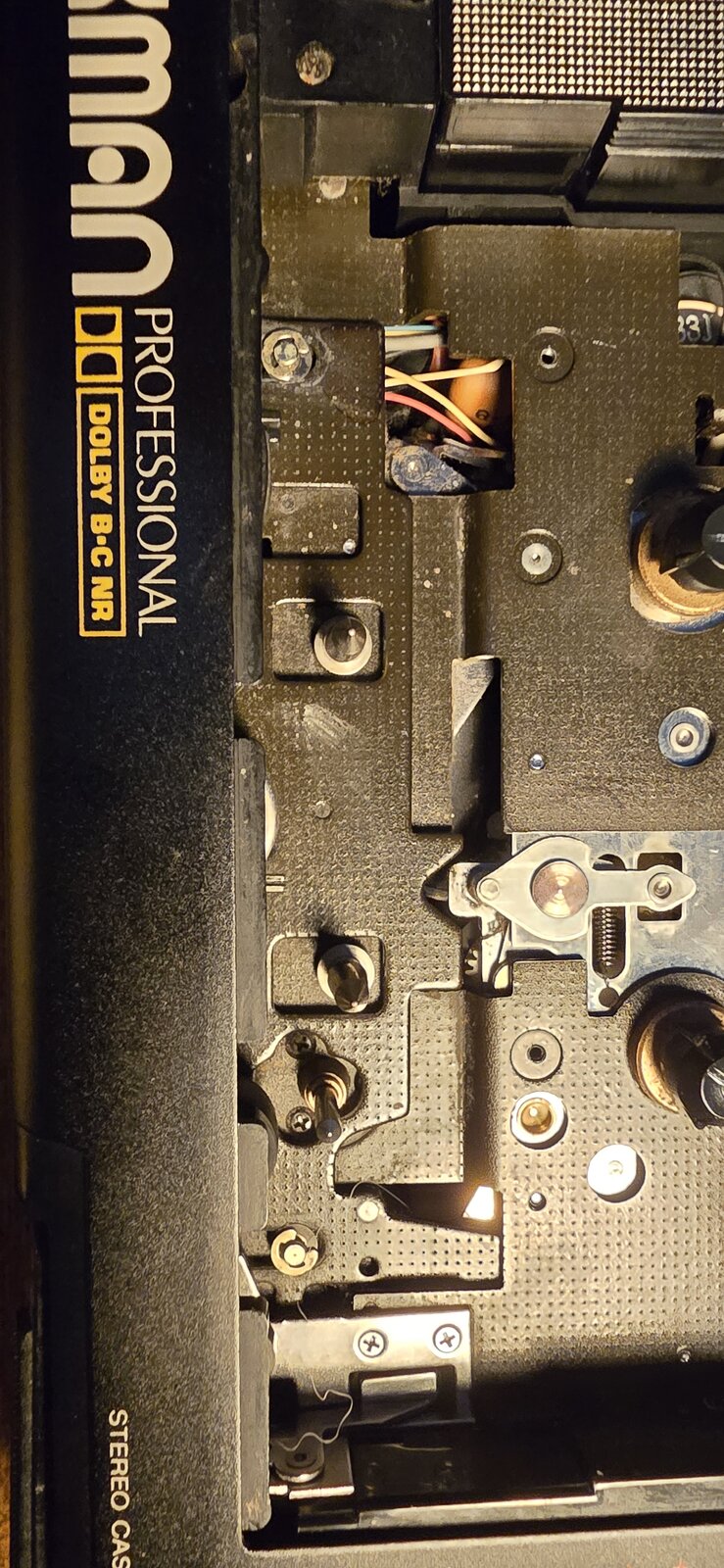

    Hello,
    I've identified the main problem with my WM-D6C as a stuck head assembly in the tape tray (not sure what the part is actually called). It's the lower plate that pops up when play is hit and down when stop is pressed, carrying with it the heads and the pinch roller.
    Simply put, it doesn't travel fully in either direction. With the back open, it can be shoved up into contact with a tape--whereupon it plays fine--or down into the off position, which allows a tape to be ejected. Otherwise, the tape just gets stuck and the auto-off triggers after a few seconds.
    I tried cleaning the surface and beneath the pivot arm with 99% IPA, and obviously I've pressed the buttons about a hundred times now. But it hasn't seemed to do anything. Furthermore, these components are buried so deeply that I'm concerned about my ability to correctly reassemble everything if I have to fully explode the Walkman to clean in between the links on the pivot arm, for example.
    Attached are some pictures of what it looks like with the the tray plate removed. As you can see, there are mm gaps on either side whether playing or stopped. The first one is having pushed it into full extension.
    Any help would be appreciated.

    The travel back problem can be caused by a missing spring on the PLAY button, it's something I've seen on some D6Cs.
    Spring either missing or not installed, rattling around inside the walkman. Probably someone forgot to install it correctly when re-installing the flywheel bracket.
    If this is the case, you should be able to push the head bridge assy back with your fingers by pushing back on it. If pushing it back by hand works, means problem is the missing spring.
    Then as far as the other problem is concerned, in pictures it seems the bridge is travelling to the max position, but thr roller is disengaged. This could be caused by PAUSE being stuck into the engaged position.
