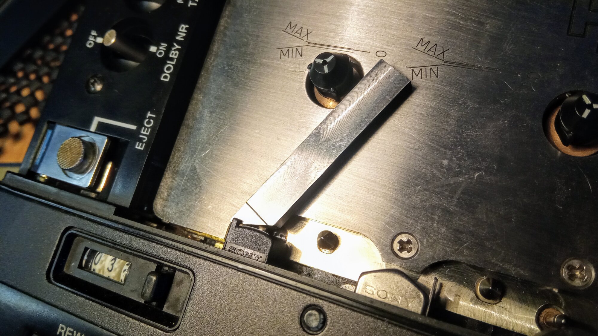

  8. MBentefor
    MBentefor New Member
    Ukraine
    Here, check this:
    Seems that when engaging, the head set is not lifted up evenly: back part (closer to the case) is lifted higher than the front part.
    What can be the reason for this? I tried with my nail and there is nothing which would block the head from lifting further.
    I checked thoroughly and can't see any option here...
  9. MBentefor
    Ukraine
    Even though there is nothing to report, I will report anyways:
    I've disassembled the head carriage and found 2 tiny thin rectangular plastic sheets behind the head (between the head and the carriage itself). They look like something off factory, however there is no such thing in the service manual. When I removed them, finally the head and tape guides were inline. However the entire head carriage was still at a serious angle (as seen in the video).
    After thorough inspection, I wasn't able to find anything suspicious. Also I wasn't able to reason what could possibly lead to head being lifted unevenly (in theory eveyrthing should have been working fine...). So I did some bending job. As a result - the head carriage is now completely inline with pinch rollers/capstans and perpendicular to their axis.
    However not a single thing that I've done made any change to the HF loss effect.
    At this moment, if I gently lift the front (outward facing) part of the head just a tiny bit, the HF are back.
    However if I do that gentle lifting, the opposite playing direction starts losing HF a bit...
    Also I wasn't able to make up any option on how to preserve that gentle lift.
    Right now all of this makes little sense to me.
    Maybe my 1989 copy is somehow faulty... Maybe it lacks something...
    Sad :(

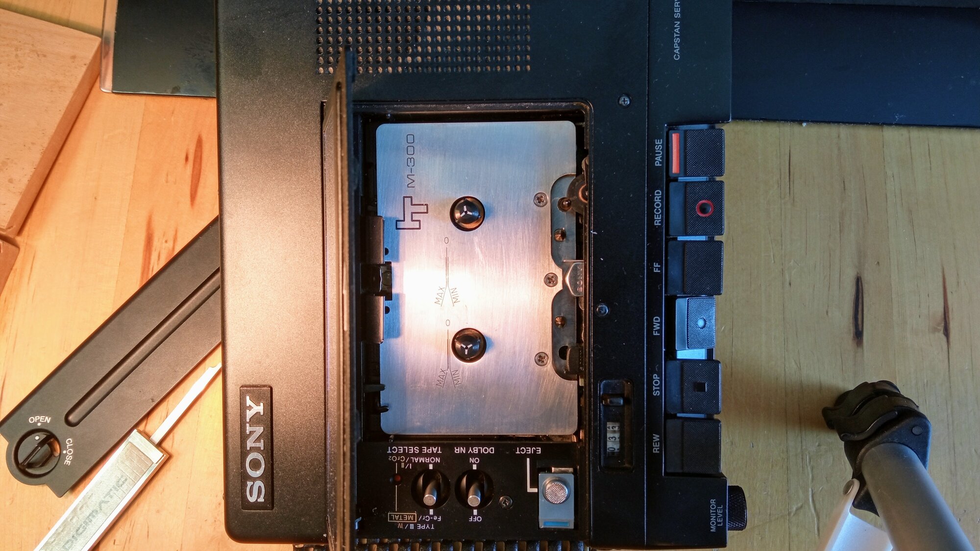

    Reading this thread I summise that you're just shooting blind into a haystack without really effectively diagnosing what the issue could be.
    No offence to Valentin for his helpful suggestions but I would respectfully suggest either investing in the correct tools that could help you pinpoint and diagnose the issue; service manual (first and foremost, if there is one) ... calibration tapes, mirror tape, M300 gauge, oscilloscope, etc.
    or send it to someone who knows what they're doing. Deb64 has refurbed my D6C. I'm not sure if she is au fait with the DD9 but you could always ask!
  12. MBentefor
    Ukraine
    @Chris_D Thank you for your reply! Actually I do have several calibration tapes, four oscilloscopes, DD9 service manual and some experience in addition to that :)
    So I am not doing this naked! But thanks for your input anyways!
    P.s. I wasn't able to find a mirror tape for sale, when I started with this issue :(
  13. Chris_D
    Chris_D Active Member
    156
    Netherlands
    The M300 gauge in combination with an FR calibration cassette and oscilloscope could help you rectify the frequency imbalance issue.
    Someone on TH was selling home-made mirror tapes here
    They're also all over ebay here
