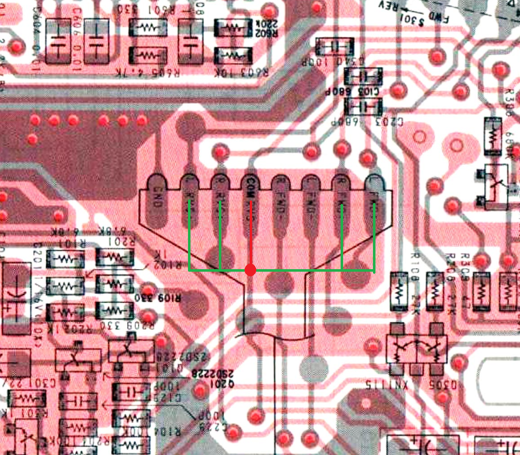

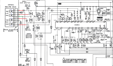

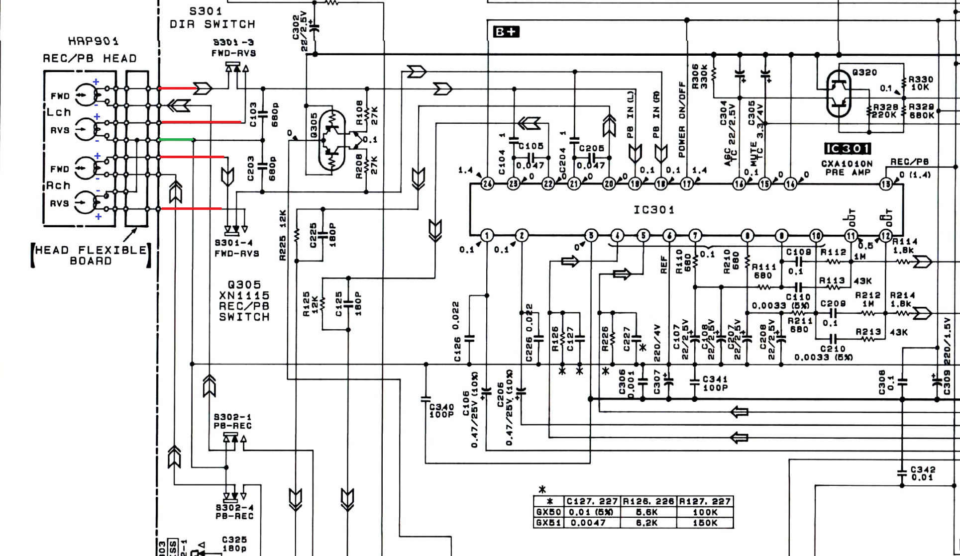

    Ok, so connect the + side of the head coils input to the COM. But make sure you only use the unit in PLAY this way, not record, as in record you'll short the output of the bias oscillator.
    See if doing this makes that oscillation disappear or not.

    OK, I have had a chance to start on this again. Thank you Valentin, shorting the pads as you noted did completely remove the oscillation. The issue still remains so I am assuming that the head is not contributing to the problem. It is very very faint but still remains a curiosity that it is in only one direction. Again, if I touch the capstan, the noise will change pitch. However, in the other direction, pressure on the motor does not create any motor noise so you could conclude the mechanism is not contributing. Any further thoughts Valentin or others before I close this one up?

  8. Valentin
    1,985
    It's hard to point out what the exact problem could be.
    Something as simple as corrosion inside the FWD/REV switch creating a small parasitic capacitance can be enough to cause weird problems.
    What I can tell for sure is problem isn't the preamp/REC amp IC, since there is only one amp which is switched externally.
    And since the head was also excluded, it has to be something in the adjacent circuits or the PCB.
