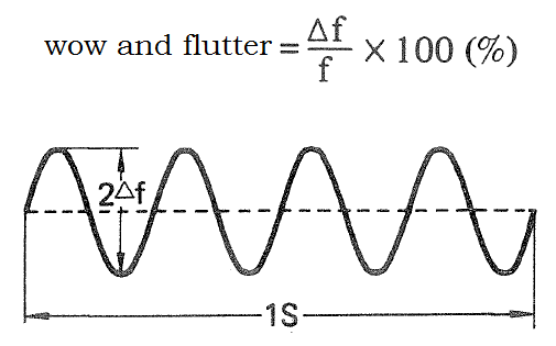

    @Valentin, I suggest you read my article on Medium. I spent quite a lot of time researching it with more than two dozen sources, cross-referenced. I am not an electronics engineer, and my math skills have long faded, so if you find an error please do not hesitate to alert me - article on Medium are editable :)
    Scroll to the bottom and you will see:
    • Effective value or root mean squared (RMS) value: for a pure sine wave it comes down to 0.707 × peak value
    • Average value or mean value: equals to 0.637 × peak value for a pure sine wave.
    • Peak to peak value: 2 × peak value for a pure sine wave.
    On this picture you can see that peak to peak = 2 × Δf, and only either a positive or a negative portion of a cycle (Δf) is used to calculate wow & flutter number. So, in ±0.17% DIN, the number 0.17 is Δf/f, not 2Δf/f. You can see from the picture that this is a 4 Hz wave, it is the frequency where W&F number is the highest and is not adjusted for weight. 4 Hz - highest weight.

    @CDV I have read again you article on Medium: it's great, probably the best wow&flutter reference to read out there.
    There is nothing wrong with it with one minor exception: the statement that the DIN value should be about double the WRMS value. Don't know where that statement comes from, if it's taken from somewhere else or it's a deduction made from empirical observation.
    After doing multiple measurements on different units and also taking the WFGUI picture from your article as a sample as well, it became clear to me that the ratio betwee WRMS and DIN is NOT a constant number and will vary depending on the shape of the speed variation waveform.
    Let me explain more clearly: as I stated in the previous post, for a pure sinewave, the ratio between RMS and peak-to-peak is 0.35 (it will be 2.8 if we put it the other way around, peak-to-peak over RMS).
    Of course, it should be pretty obvious that, in practice, the speed variation waveform (that is displayed in WFGUI) will, in most cases, be different from a pure sinewave and will be more or less random like.
